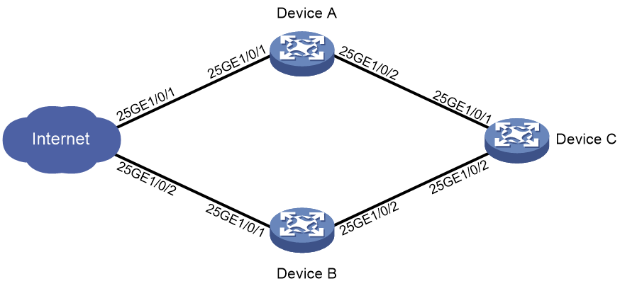

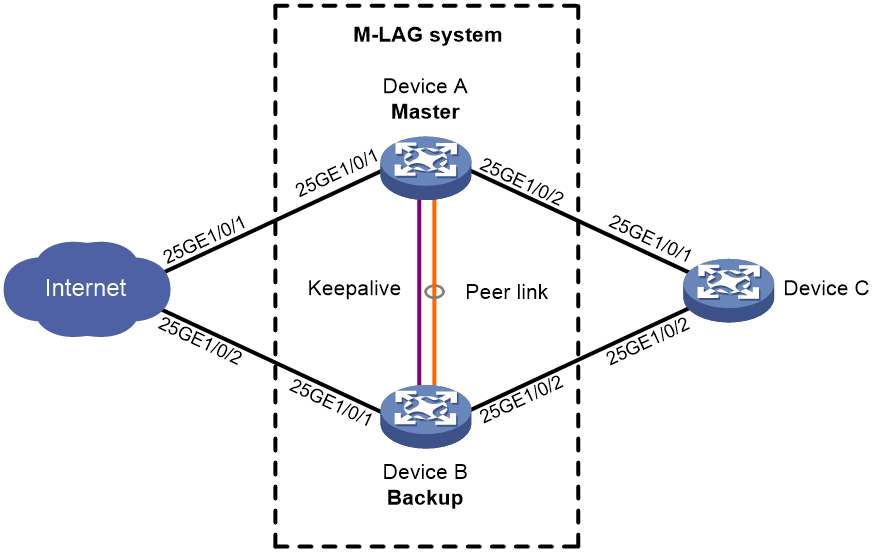

How GIR works
Overview
When you place the device in maintenance mode, GIR instructs each affected protocol (for example, BGP) to remove the device from the network. Then, each protocol takes action as instructed to isolate the device and switch over to the redundant path. When you change the device back to normal mode, GIR instructs the affected protocols to add the device back to the network. These protocols are called GIR-capable protocols.
To record the configuration before and after a GIR operation, GIR takes a snapshot of protocol data when the device changes to maintenance mode and when the device changes back to normal mode. You can compare the snapshots to verify configuration data consistency for each protocol.
GIR-capable protocols include LACP, BGP, IS-IS, OSPF, and OSPFv3. For more information about how each protocol isolates the device, see its configuration guide.
Protocol isolation methods
GIR-capable protocols typically use the isolate and shutdown methods to isolate the device from the network. The following information uses OSPF for example to describe the isolation procedures.
·     Isolate switching:
a.     When you place the device in maintenance mode, GIR executes the isolate enable command for OSPF to increase the link cost in the LSAs advertised by the device.
b.     Each OSPF neighbor of the device reselects an optimal route based on the LSAs and stops forwarding traffic to the device. After the device is fully isolated from the network, you can upgrade the device.
c.     When you revert the device back to normal mode, GIR executes the undo isolate enable command for OSPF to restore its original link cost and gracefully add the device back to the network.
·     Shutdown method:
a.     After a process is shut down by using the shutdown process command, it sends 1-way hello packets to its neighbors
b.     On receipt of the packets, the neighbors disconnect from the OSPF process and use the backup path to forward traffic.
c.     The process stops receiving and sending OSPF packets.
d.     The process clears its neighbor, LSDB, and OSPF route information.
Compared with the shutdown method, the isolate method uses more resources, but it can faster restore a protocol to the state before the isolation. For more information about the isolate enable and shutdown process commands for OSPF, see OSPF commands in Layer 3—IP Routing Command Reference.

Example: Configuring GIR in an ECMP-based node redundancy environment
As shown in Figure 1, Device A and Device B have ECMP routes for traffic between Internet and Device C. Before upgrading Device A, use GIR to place it in maintenance mode to prevent packet losses during upgrade. Then, change Device A back to normal mode after its software is upgraded.
Figure 1 Network diagram
1.     Configure IP addresses and a unicast routing protocol (for example, OSPF). Make sure ECMP routes are available for traffic between the Internet and Device C to traverse Device A or Device B to reach the destination. (Details not shown.)
2.     Isolate Device A from the network before you upgrade it.
# Change Device A from the normal mode to the maintenance mode.
<Device A> display system stable state summary
System state      : Stable
Redundancy state  : No redundancy
NSR     state     : No standby
<Device A> system-view
[Device A] gir system-mode maintenance
Collecting commands... Please wait.
Configuration to be applied:
   ospf 1
     isolate enable
Do you want to continue? [Y/N]: y
Generated a snapshot: before_maintenance.
Applying: ospf 1
Applying: isolate enable
Waiting 120 seconds to release the CLI.
Changed to maintenance mode successfully.
# Verify that the mode switching is successful on Device A.
[Device A] display gir system-mode
System Mode: Maintenance
Revert-delay time: 0min
Maintenance-delay time: 120s
Snapshot-delay time: 120s
# Verify that traffic switching has completed on Device A.
[Device A] display counters rate inbound interface
Usage: Bandwidth utilization in percentage
Interface            Usage (%)   Total (pps)   Broadcast (pps)   Multicast (pps)
25GE1/0/1                    0             0                --                --
25GE1/0/2                    0             0                --                --
 Overflow: More than 14 digits.
       --: Not supported.
3.     Upgrade Device A after saving the configuration. (Details not shown.)
4.     Restore forwarding services on Device A:
# Change Device A from the maintenance mode back to the normal mode after it is upgraded and rebooted.
[Device A] undo gir system-mode maintenance
   ospf 1
     undo isolate enable
Applying: ospf 1
Applying: undo isolate enable
Waiting 120 seconds to generate a snapshot.
Generated a snapshot: after_maintenance.
Changed to normal mode successfully.
System Mode: Normal
25GE1/0/1                  100           100                --                --
25GE1/0/2                  100           100                --                --
       --: Not supported.
Example: Configuring GIR on an M-LAG system
As shown in Figure 2, Device A and Device B form an M-LAG system.
Use the following method to upgrade the M-LAG system to prevent packet loss during the upgrade:
1.     Upgrade Device B.
2.     Perform a forward switching operation by using the isolate method on Device A.
3.     Upgrade Device A.
Figure 2 Network diagram
1.     Upgrade Device B. (Details not shown.)
2.     Isolate Device A from the network before upgrading it.
   ospf 1
     isolate enable
   sleep instance 1 interval 30
   link-aggregation lacp isolate bagg
Applying: ospf 1
Applying: sleep instance 1 interval 30
Applying: link-aggregation lacp isolate bagg
# Verify that the traffic switching has completed on Device A.
25GE1/0/1                    0             0                --                --
25GE1/0/2                    0             0                --                --
25GE1/0/3                    0             0                --                --
       --: Not supported
4.     Restore forwarding services on Device A.
   undo link-aggregation lacp isolate bagg
   ospf 1
     undo isolate enable
Applying: undo link-aggregation lacp isolate bagg
Applying: ospf 1
System Mode: Normal
25GE1/0/3                  100           100                --                --
       --: Not supported.
