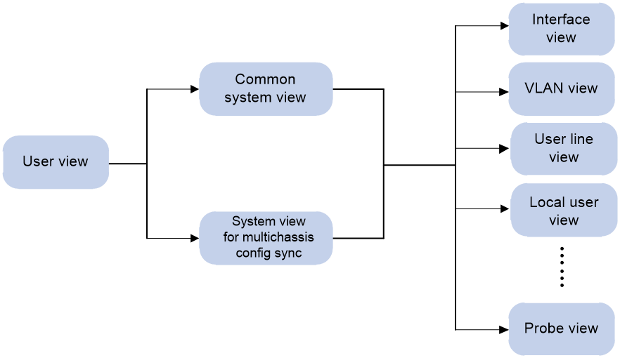

Using CLI views
About CLI views
Commands are grouped in different views by feature. To use a command, you must enter its view.
CLI views are hierarchically organized, as shown in Figure 1. Each view has a unique prompt, from which you can identify where you are and what you can do. For example, the prompt [Sysname-vlan100] shows that you are in VLAN 100 view and can configure attributes for that VLAN.
Figure 1 CLI views
You are placed in user view immediately after you log in to the CLI.
In user view, you can perform the following tasks:
·     Perform basic operations including display, debug, file management, FTP, Telnet, clock setting, and reboot.
·     Enter system view.
In system view, you can perform the following tasks:
·     Configure settings that affect the device as a whole, such as the daylight saving time, banners, and hotkeys.
·     Enter feature views.
For example, you can perform the following tasks:
¡     Enter interface view to configure interface parameters.
¡     Enter VLAN view to add ports to the VLAN.
¡     Enter user line view to configure login user attributes.
A feature view might have child views. For example, NQA operation view has the child view HTTP operation view.
·     Enter probe view by using the probe command.
The probe view provides display, debugging, and maintenance commands, which are mainly used by developers and testers for system fault diagnosis and system operation monitoring.
For more information about the commands in probe view, see the probe commands manual for each feature.

Entering common system view from user view
In common system view and its lower-level views, settings are written to the running configuration and take effect immediately.
To enter common system view from user view, execute the following command:
Entering system view for multichassis configuration sync from user view
In a network configured with multichassis configuration synchronization, such as an M-LAG network, some commands must be executed on both member devices. For these commands, you have to execute them separately on the local and peer member devices. This is cumbersome and might cause configuration errors.
To resolve this issue, you can execute the system-view mc-config command to enter system view for multichassis configuration sync. In system view for multichassis configuration sync and its lower-level views, settings on the local member device are synchronized to the peer member device. This ensures configuration consistency on the local and peer member devices and avoids repeated configuration. For more information about multichassis configuration synchronization, see "Configuring multichassis configuration synchronization."
To enter system view for multichassis configuration sync from user view, execute the following command:
