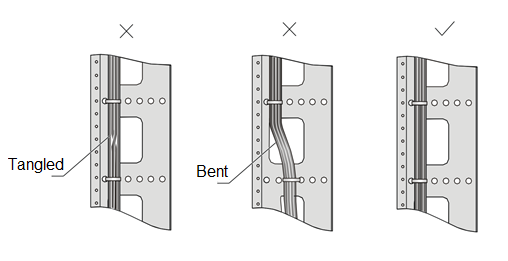

·     Bind and route the cables neatly inside the rack, and make sure they are not kinked or bent.
Figure7-1 Correct and incorrect cable binding

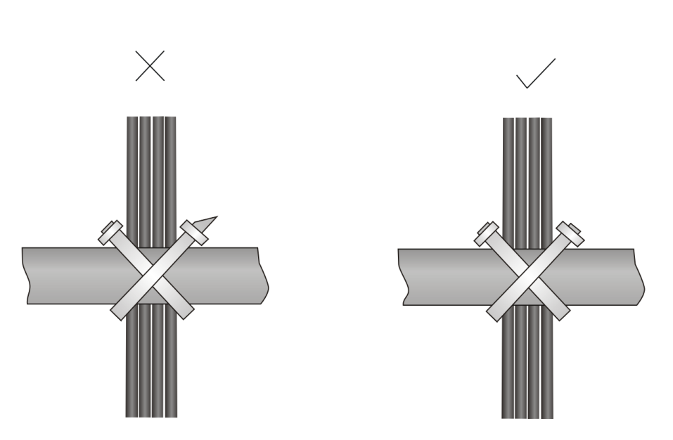

·     After binding the cables, cut the excess from the ties, leaving no sharp or angular tips. See Figure7-2.
Figure7-2 Cutting cable ties

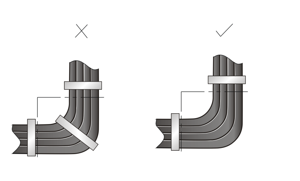

·     When you bend cables, bind them as shown in Figure7-3. To avoid excessive stress causing cable core break, do not tie up the cables in the bending area.
Figure7-3 Binding cables where they must be bent
