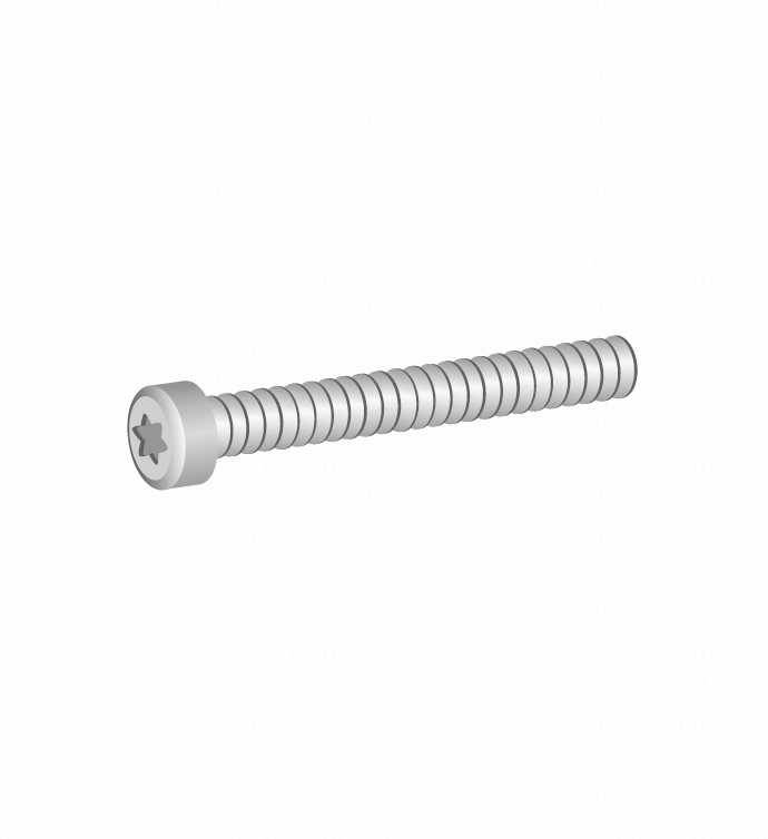

·     Install an M3 × 23.5 security screw as required.

4.     Thread the M3 × 23.5 security screw through the security hole in the mounting bracket. Make sure the screw does not block the keyhole slot.

8.     Use a security Torx screwdriver to fasten the M3 × 23.5 security screw.

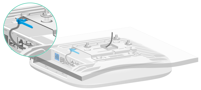

(Optional.) You can use a cable tie to secure the cable before attaching the AP to the mounting bracket. First thread the cable tie through the auxiliary hole in the mounting bracket, leaving the cable tie unfastened, and then adjust the cable length and fasten the cable tie to secure the cable.
No cable tie is provided with the AP. Prepare one yourself as required.
Figure3-12 Using a cable tie to secure the cable (using the WA7539 as an example)

5 (Optional.) Installing the cable management plate
This chapter is applicable only to the WA7220-HIWA7338-HI, WA7539 and WA7638.
After connecting all the cables, install the cable management plate. If an optical fiber is connected to the fiber port, you can remove the U-shaped plastic plate to facilitate cable routing as shown in Figure5-1.
Figure5-1 Removing the U-shaped plastic plate (using the WA7539 as an example)
