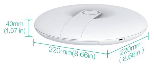

WA7220-HI
AP views
Figure3-1 WA7220-HI
Ports
The AP provides the following ports:
·     One 2.5GE2/PSE port.
·     One 2.5GE1/PoE+ port.
·     One console port.
·     One power port.
·     One USB port.
The AP also has a reset button and a security slot. The security slot is 7 × 3 mm (0.28 × 0.12 in) in size.

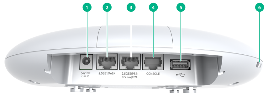

Figure3-2 Ports on the WA7220-HI AP (1)
(1) Power port
(2) 2.5GE1/PoE+ port
(3) 2.5GE2/PSE port
(4) Console port
(5) USB port
(6) Security slot

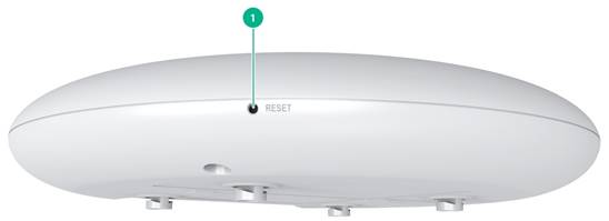

Figure3-3 Ports on theWA7220-HI AP (2)
(1) Reset button
Technical specifications
Table3-1 Technical specifications
Item
Description
Dimensions (H × W × D) (without the mounting bracket)
40 × 220 × 220 mm (1.57 × 8.66 × 8.66 in)
Weight
0.67 kg (1.48 lb)

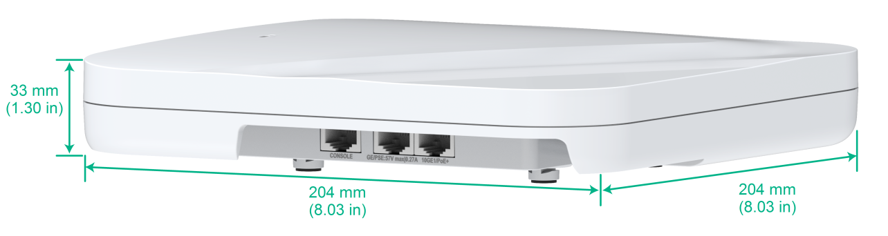

WA7320i
AP views
Figure3-4 WA7320i
Ports
·     One GE/PSE port.
·     One 10GE/PoE+ port.
·     One 10GE/P+SFP port.
·     One console port.
·     One power port.
·     One USB port.

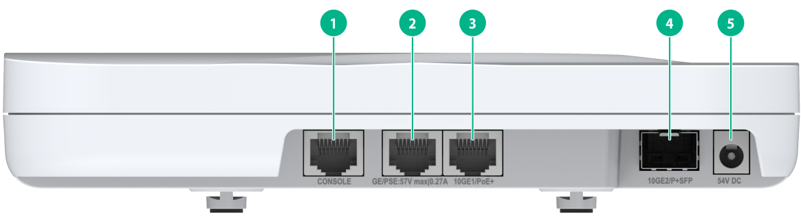

Figure3-5 Ports on the WA7320i AP (1)
(1) Console port
(2) GE/PSE port
(3) 10GE1/PoE+ port
(4) 10GE2/P+SFP port
(5) Power port

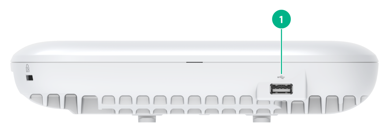

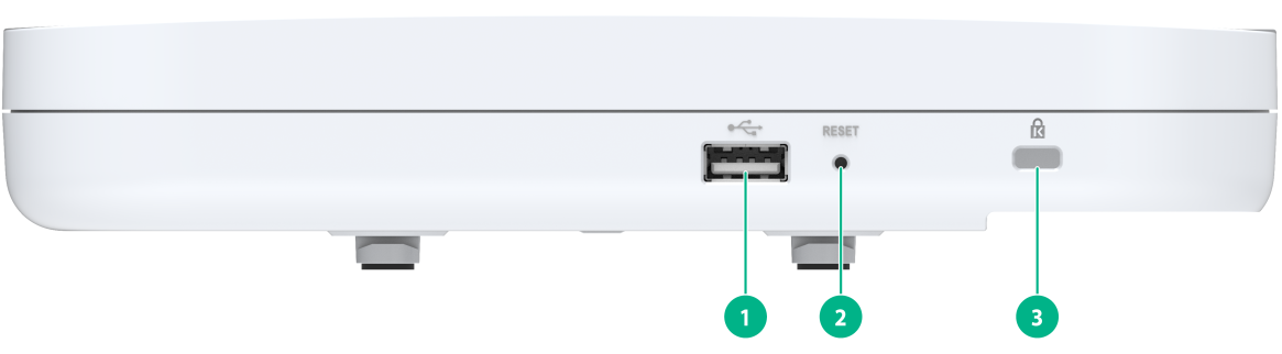

Figure3-6 Ports on the WA7320i AP (2)
(1) USB port
(2) Reset button
(3) Security slot
Table3-2 Technical specifications
Item
Description
33 × 204 × 204 mm (1.30 × 8.03 × 8.03 in)

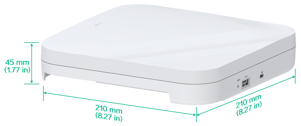

WA7330i
AP views
Figure3-7 WA7330i

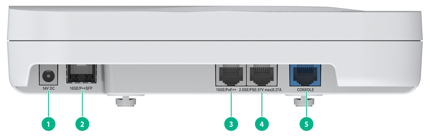

Ports
·     One 2.5GE/PSE port.
·     One 10GE/PoE++ port.
·     One 10GE/P++SFP port.
·     One console port.
·     One power port.
·     One USB port.
Figure3-8 Ports on the WA7320i AP (1)
(1) Power port
(2) 10GE/P++SFP port
(3) 10GE/PoE++ port
(4) 2.5GE/PSE port
(5) Console port
Figure3-9 Ports on the WA7320i AP (2)
(1) Reset button
(2) USB port
(3) Security slot
Table3-3 Technical specifications
Item
Description
45 × 210× 210 mm (1.77 × 8.27 × 8.27in)
Weight
1.1 kg (2.43 lb)

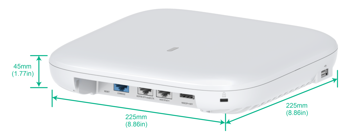

WA7338-HI
AP views
Figure3-10 WA7338-HI
Ports
·     One GE/PSE port.
·     One console port.
·     One power port.
·     One USB port.

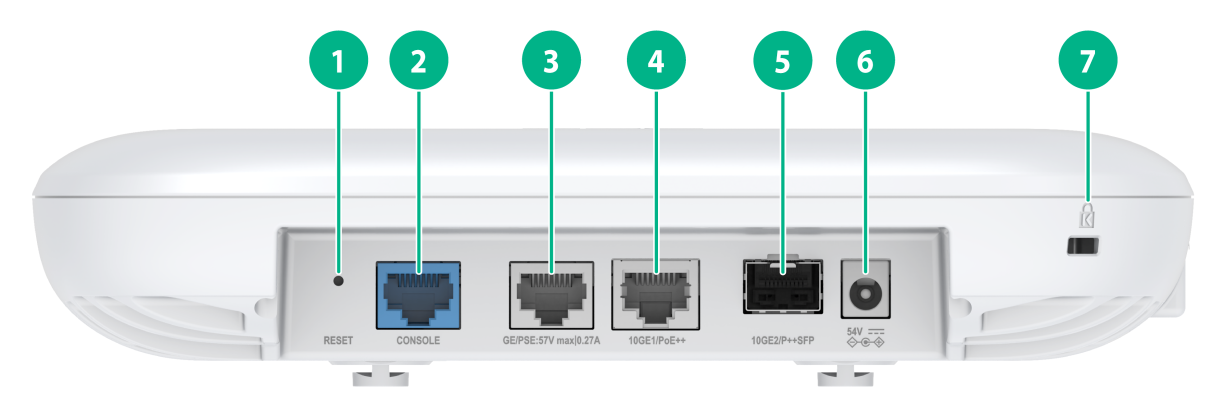

Figure3-11 Ports on the WA7338-HI AP (1)
(1) Reset button
(2) Console port
(3) GE/PSE port
(4) 10GE1/PoE++ port
(5) 10GE2/P++SFP port
(6) Power port
(7) Security slot

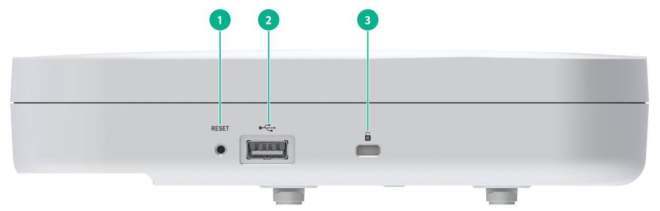

Figure3-12 Ports on the WA7338-HI AP (2)
(1) USB port
Table3-4 Technical specifications
Item
Description
45 × 225 × 225 mm (1.77 × 8.86 × 8.86 in)
Weight
1.45 kg (3.20 lb)

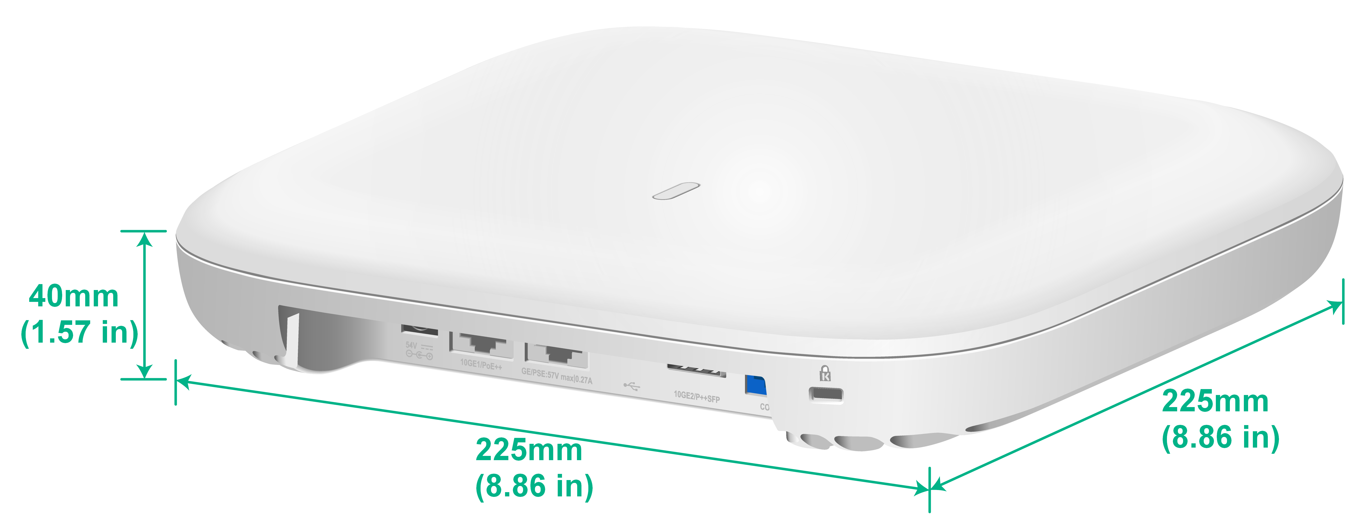

WA7539
AP views
Figure3-13 WA7539
Ports
·     One GE/PSE port.
·     One console port.
·     One power port.
·     One USB port.

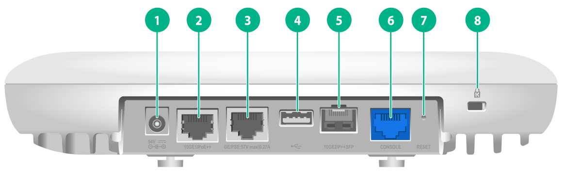

Figure3-14 Ports on the WA7539 AP
(1) Power port
(2) 10GE1/PoE++ port
(3) GE/PSE port
(4) USB port
(6) Console port
(7) Reset button
(8) Security slot
Table3-5 Technical specifications
Item
Description
40 × 225 × 225 mm (1.57 × 8.86 × 8.86 in)

Console port
Control port, used for debugging by the maintenance personnel
10GE2/P++SFP port
1000M/2.5G/5G/10G photoelectric hybrid port
10GE1/PoE++ port
100M/1000M/2.5G/5G/10G Ethernet copper port that can act as the device uplink port to connect to the Internet or MAN and as the standard PoE port at the same time.
When the AP operates in fit AP mode, the port is represented by interface number 10GE1/0/1 in the MAP file and Ten-GigabitEthernet 1 for configuration on the AC.
GE/PSE port
100M/1000M Ethernet copper port, used for connecting a downlink device. The AP can supply power through this port to a device with a maximum power consumption of 15 W.
When the AP operates in fit AP mode, the port is represented by interface number GE1/0/1 in the MAP file and gigabitethernet 1 for configuration on the AC.
USB port
USB-compliant USB port.
By default, the USB port is disabled. To enable the USB port, execute the usb enable command in AP view.
Power port (54VDC)
Used for receiving power from a local power source.
Reset button
For more information, see "Appendix B  LEDs and buttons."

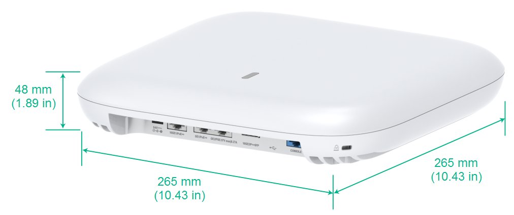

WA7638
AP views
Figure3-15 WA7638
Ports
·     One GE/PSE port.
·     One GE/PoE++ port.
·     One console port.
·     One power port.
·     One USB port.
Figure3-16 Ports on the WA7638 AP
(1) Power port
(3) GE1/PoE++ port
(4) GE2/PSE port
(6) USB port
(7) Console port
(8) Reset button
(9) Security slot
