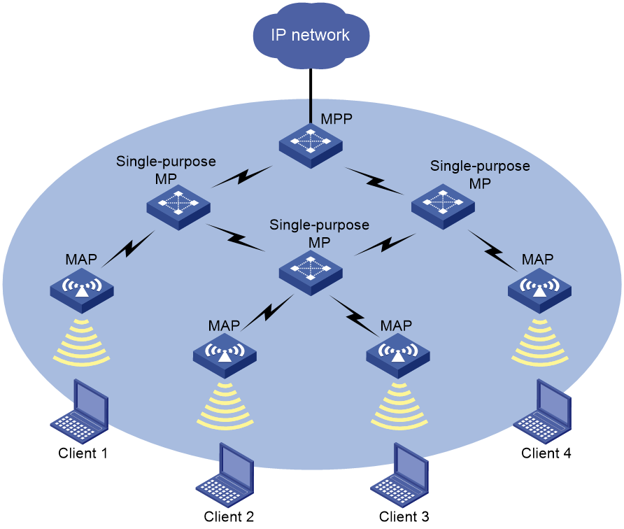

WLAN mesh network
Figure 1 shows a WLAN mesh network.
APs on a WLAN mesh network are mesh points (MPs). MPs play the following roles:
·     Single-purpose MP—Provides only mesh services.
·     Mesh access point (MAP)—Provides both mesh and access services.
·     Mesh portal point (MPP)—Provides a wired connection to a wired network.
Figure 1 WLAN mesh network diagram

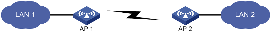

Point-to-point topology
As shown in Figure 3, you can set up a mesh link between two APs to connect two LANs.

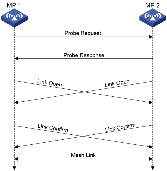

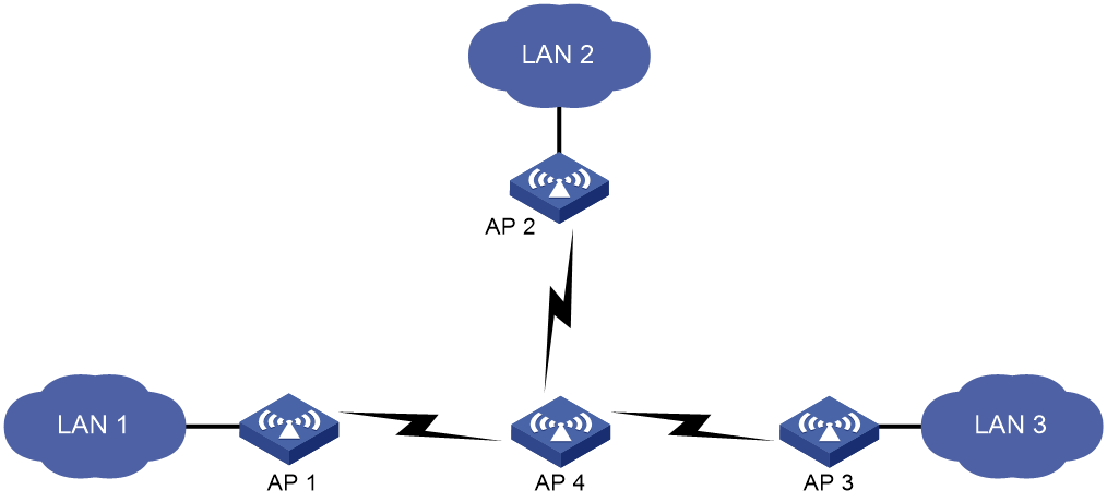

Star topology
As shown in Figure 4, you can set up mesh links between one central AP and multiple leaf APs to connect multiple LANs. In this topology, all data between LANs must traverse the central AP (AP 4 in this example).
Figure 4 Star topology

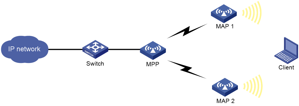

Topology created without administrative intervention
Without administrative intervention, the WDS topology depends on the result of automatic neighbor discovery and mesh link establishment between APs.
Figure 5 Automatic topology setup

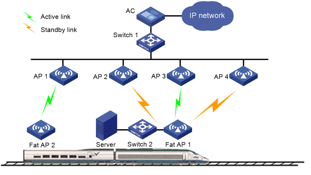

Mobile Link Switch Protocol (MLSP) is designed for subway application to provide stable data transmission through mesh links between onboard and trackside MPs. The onboard MPs are responsible for link selection, maintenance, and switchover.
With MLSP enabled, each onboard MP maintains one active link and multiple standby links at the same time. Only the active link is used for data transmission. An onboard MP keeps switching its active link during train movement to ensure stable data transmission.
In subway applications, signals can be transmitted over the air, in waveguides, or in linking coaxial (LCX) cables. Signals transmitted over the air are called air signal and signals transmitted in waveguides or LCX cables are called waveguide signals. As a best practice to avoid signal interference, deploy waveguides or LCX cables in areas with strong interference.
As shown in Figure 6, AP 1 through AP 4 are trackside MPs, and fat AP 1 and fat AP 2 are onboard MPs.
Figure 6 MLSP mesh network diagram
Air signal link switchover
An onboard MP uses a mesh link as a standby link if the RSSI on the link reaches or exceeds the sum of the link establishment threshold and the mesh link hold RSSI. If the MP does not have an active link, it uses the link as the active link.
An onboard MP switches to the optimal standby mesh link when one of the following conditions is met:
·     The link hold timer expires and a standby link has an RSSI higher than the active link for a value that reaches or exceeds the link switchover threshold.
·     The RSSI on the active link is lower than the mesh link hold RSSI.
·     The RSSI on the active link reaches or exceeds the link saturation RSSI.
If no standby link is available, the MP keeps using the active link when the RSSI on the active link is lower than the mesh link hold RSSI. The MP terminates the active link when the active link RSSI reaches or exceeds the link saturation RSSI.

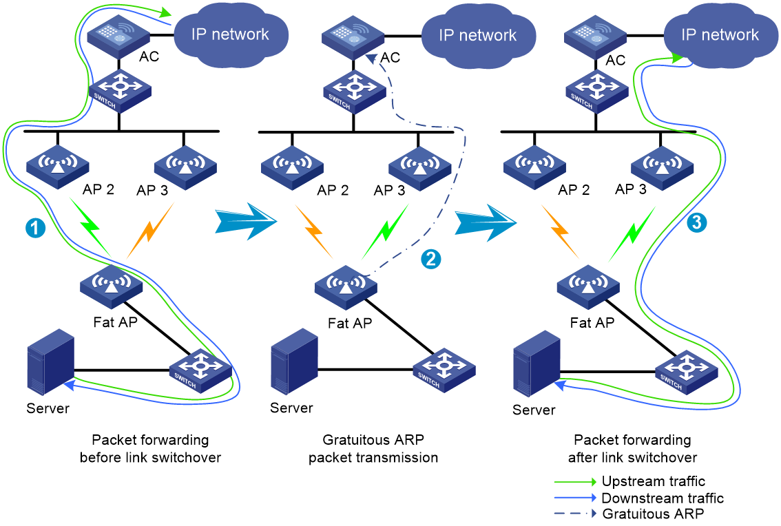

MLSP proxy
This feature enables an onboard MP to proxy an onboard device (typically an onboard server) for fast downlink packet forwarding path change when link switchover occurs.
As shown in Figure 7, an onboard MP uses the MAC address of the proxied device to send gratuitous ARP packets for MAC address table update of trackside MPs. This ensures fast transmission of downlink packets over the new active link after a link switchover.
Figure 7 Fast packet forwarding path change
MLSP link switchover optimization
In subway applications, RSSIs on onboard MPs might be greatly larger than RSSIs on trackside MPs when the train passes the trackside MPs and the MPs' antennas point to the same direction. This might cause loss of packets from onboard MPs to trackside MPs. Mesh link switchover optimization enables onboard MPs to switch to the optimal standby links in advance to avoid packet loss.
With this feature enabled, an onboard MP switches to the optimal secure standby link whose RSSI exceeds the optimization threshold after the link hold time is reached. A secure standby link is a link that has never been replaced by MLSP link switchover optimization. If the active link is replaced by MLSP link switchover optimization, the link is marked as unsecure.

Configuring multi-link transmission of mesh unicast data packets
In MLSP scenarios, to enhance the reliability of mesh links and reduce the packet loss rate, you can enable multi-link transmission of unicast data packets on trackside APs and onboard APs, and enable centralized forwarding for mesh data packets on trackside APs.
After you enable multi-link transmission of mesh unicast data packets on trackside APs and onboard APs, the APs transmit the same mesh unicast data packets through multiple mesh links.
After you enable centralized forwarding of mesh data packets on trackside APs, the trackside APs pass the received mesh data packets through the CAPWAP tunnel to the AC for processing, facilitating the AC to eliminate duplicate mesh data packets.
After you specify an ACL, any mesh unicast data packets that match the ACL will be transmitted over multiple mesh links, regardless of whether the packets are allowed or denied in the ACL.
Procedures
2.     Create a mesh policy and enter mesh policy view.
wlan mesh-policy policy-name
By default, a default mesh policy named default_mesh_policy exists.
3.     Enable multi-link transmission of mesh unicast data packets.
mesh multi-link-transmit enable [ acl acl-number ]
By default, multi-link transmission of mesh unicast data packets is disabled.

WLAN mesh configuration examples
Example: Configuring WLAN mesh
As shown in Figure 8, establish an 802.11n 5GHz WLAN mesh network to provide network access for the clients. Configure the MP and MAPs to establish mesh links on channel 149.
Figure 8 Network diagram
1.     Configure the MPP:
# Create a mesh profile.
<MPP> system-view
[MPP] wlan mesh-profile 1
# Set the mesh ID to 1.
[MPP-wlan-mesh-profile-1] mesh-id 1
# Enable SAE for authentication and key management.
[MPP-wlan-mesh-profile-1] akm mode sae
# Configure a preshared key.
[MPP-wlan-mesh-profile-1] preshared-key pass-phrase simple 12345678
# Enable the mesh profile.
[MPP-wlan-mesh-profile-1] mesh-profile enable
[MPP-wlan-mesh-profile-1] quit
# Bind the mesh profile to the radio interface WLAN-Radio 1/0/1.
[MPP] interface wlan-radio 1/0/1
[MPP-WLAN-Radio1/0/1] mesh-profile 1
# Set the radio type to 802.11n (5GHz) on the interface.
[MPP-WLAN-Radio1/0/1] type dot11an
# Set the working channel of the radio to 149.
[MPP-WLAN-Radio1/0/1] channel 149
# Enable the radio.
[MPP-WLAN-Radio1/0/1] undo shutdown
[MPP-WLAN-Radio1/0/1] quit
2.     Configure MAP 1:
<MAP1> system-view
[MAP1] wlan mesh-profile 1
[MAP1-wlan-mesh-profile-1] mesh-id 1
[MAP1-wlan-mesh-profile-1] akm mode sae
# Configure the same preshared key as the MPP.
[MAP1-wlan-mesh-profile-1] preshared-key pass-phrase simple 12345678
[MAP1-wlan-mesh-profile-1] mesh-profile enable
[MAP 1-wlan-mesh-profile-1] quit
# Configure a service template.
[MAP1] wlan service-template service1
[MAP1-wlan-st-service1] ssid mesh-network
[MAP1-wlan-st-service1] service-template enable
[MAP1-wlan-st-service1] quit
[MAP1] interface wlan-radio 1/0/1
[MAP1-WLAN-Radio1/0/1] mesh-profile 1
# Bind the service template to the radio interface WLAN-Radio 1/0/1.
[MAP1-WLAN-Radio1/0/1] service-template service1
[MAP1-WLAN-Radio1/0/1] type dot11an
[MAP1-WLAN-Radio1/0/1] channel 149
# Add the MAC address of a radio on the MPP to the mesh peer whitelist to avoid loops. MAP 1 can set up a mesh link only with the MPP.
[MAP1-WLAN-Radio1/0/1] mesh peer-mac-address 4a1b-517d-23ff
# Enable the radio.
[MAP1-WLAN-Radio1/0/1] undo shutdown
[MAP1-WLAN-Radio1/0/1] quit
[MAP1] quit
3.     Configure MAP 2 in the same way you configure MAP 1. (Details not shown.)
# Verify that the MPP can establish mesh links to the MAPs.
<MPP> display wlan mesh-link
Peer Name Peer MAC       RSSI BSSID          Interface        Link state    Online time
 map1      7b2d-23bb-e56f 22   4a1b-517d-23ff WLAN-MeshLink1   Active(an)    00h 08m 31s
 map2      6a3b-cc5a-e215 22   4a1b-517d-23ff WLAN-MeshLink2   Active(an)    00h 40m 56s
# Verify that MAP 1 can establish a mesh link to the MPP.
<MAP1> display wlan mesh-link
 mpp       4a1b-517d-23ff 22   7b2d-23bb-e56f WLAN-MeshLink1   Active(an)    00h 08m 31s
# Verify that MAP 2 can establish a mesh link to the MPP.
<MAP2> display wlan mesh-link
 mpp       4a1b-517d-23ff 22   6a3b-cc5a-e215 WLAN-MeshLink1   Active(an)    00h 08m 31s
Example: Configuring point-to-point WDS
As shown in Figure 9, deploy a point-to-point WDS of two fat APs to provide Layer 2 wireless connectivity between two LANs. Configure the APs to use 802.11a to establish a WDS link on channel 149.
Figure 9 Network diagram
1.     Configure AP 1:
<AP1> system-view
[AP1] wlan mesh-profile 1
[AP1-wlan-mesh-profile-1] mesh-id 1
[AP1-wlan-mesh-profile-1] akm mode sae
[AP1-wlan-mesh-profile-1] preshared-key pass-phrase simple 12345678
[AP1-wlan-mesh-profile-1] mesh-profile enable
[AP 1-wlan-mesh-profile-1] quit
[AP1] interface wlan-radio 1/0/1
[AP1-WLAN-Radio1/0/1] mesh-profile 1
# Set the radio type to 802.11a on the interface.
[AP1-WLAN-Radio1/0/1] type dot11a
[AP1-WLAN-Radio1/0/1] channel 149
# Enable the radio.
[AP1-WLAN-Radio1/0/1] undo shutdown
[AP1-WLAN-Radio1/0/1] quit
[AP1] quit
2.     Configure AP 2 in the same way you configure AP 1. (Details not shown.)
# Display mesh link information on AP 1.
<AP1> display wlan mesh-link
 ap2       482b-c01d-e87f 22   a503-cc9b-418f WLAN-MeshLink1   Active(a)     00:01:10
# Display mesh link information on AP 2.
<AP2> display wlan mesh-link
 ap1       a503-cc9b-418f 22   482b-c01d-e87f WLAN-MeshLink1   Active(a)     00:01:10
Example: Configuring MLSP
As shown in Figure 10, trackside MPs (AP 1 and AP 2) are connected to the AC through Switch 1, and the onboard MP (fat AP) is connected to the onboard server through Switch 2. Configure MLSP for the onboard MP to communicate with trackside MPs.
Figure 10 Network diagram
·     If multiple servers exist on the train, and each server must be connected to a different VLAN, configure the following settings:
¡     Create VLANs and VLAN interfaces on Switch 2. The VLAN interfaces are used as the gateways for the servers.
¡     Configure a static route from the IP network to each server.
¡     If onboard devices and devices on the IP network communicate at Layer 3 and onboard MPs are deployed at both ends of the train, OSPF is required for traffic between these devices to be dynamically forwarded by the MP at the front or rear. You must configure the network type as NBMA on VLAN interfaces on Switch 1 and Switch 2, and manually specify the neighbor for the interfaces.
1.     Specify the IP address and gateway of the onboard server as 192.168.20.3 and 192.168.20.2, respectively. (Details not shown.)
2.     Configure the onboard MP:
# Create VLAN 30 and VLAN-interface 30, and specify an IP address for the VLAN interface. This VLAN will be used as the management VLAN.
<FatAP> system-view
[FatAP] vlan 30
[FatAP-vlan30] quit
[FatAP] interface vlan-interface 30
[FatAP-Vlan-interface30] ip address 30.1.1.2 255.255.255.0
[FatAP-Vlan-interface30] quit
# Create VLAN 40. This VLAN will be used as the service VLAN.
[FatAP] vlan 40
[FatAP-vlan40] quit
# Configure Ten-GigabitEthernet 1/0/1 that connects the fat AP to Switch 2 as a trunk port, and assign the port to VLANs 30 and 40.
[FatAP] interface ten-gigabitethernet 1/0/1
[FatAP-Ten-GigabitEthernet1/0/1] port link-type trunk
[FatAP-Ten-GigabitEthernet1/0/1] port trunk permit vlan 30 40
[FatAP-Ten-GigabitEthernet1/0/1] quit
[FatAP] wlan mesh-profile 1
[FatAP-wlan-mesh-profile-1] mesh-id 1
[FatAP-wlan-mesh-profile-1] akm mode sae
[FatAP-wlan-mesh-profile-1] preshared-key pass-phrase simple 12345678
[FatAP-wlan-mesh-profile-1] mesh-profile enable
[FatAP-wlan-mesh-profile-1] quit
# Create mesh policy 1 and enable mesh link initiation.
[FatAP] wlan mesh-policy 1
[FatAP-wlan-mesh-policy-1] link-initiation enable
# Enable MLSP.
[FatAP-wlan-mesh-policy-1] mlsp enable
# Set the mesh link establishment threshold to 3.
[FatAP-wlan-mesh-policy-1] link-establish-threshold 3
# Set the mesh link hold RSSI to 20.
[FatAP-wlan-mesh-policy-1] link-hold-rssi 20
# Set the mesh link saturation RSSI to 100.
[FatAP-wlan-mesh-policy-1] link-saturation-rssi 100
# Set the mesh link hold time to 4000.
[FatAP-wlan-mesh-policy-1] link-hold-time 4000
# Set the mesh link keepalive packet limit for the active link to 5.
[FatAP-wlan-mesh-policy-1] active-link keepalive-count 5
# Set the mesh link switchover threshold to 5.
[FatAP-wlan-mesh-policy-1] link-switch-threshold 5
# Set the probe request interval to 100.
[FatAP-wlan-mesh-policy-1] probe-request-interval 100
# Configure the MP to proxy the gateway for the onboard server. The gateway is VLAN-interface 40 on Switch 2.
[FatAP-wlan-mesh-policy-1] mlsp-proxy mac-address 000f-e201-0101 vlan 40 ip 192.168.20.2
# Configure the MP to proxy the management VLAN interface VLAN-interface 30 on Switch 2.
[FatAP-wlan-mesh-policy-1] mlsp-proxy mac-address 000f-e201-0101 vlan 30 ip 30.1.1.3
[FatAP-wlan-mesh-policy-1] quit
# Bind mesh profile 1 to radio interface WLAN-Radio 1/0/1.
[FatAP] interface wlan-radio 1/0/1
[FatAP-WLAN-Radio1/0/1] mesh-profile 1
# Set the radio mode to 802.11ac (5 GHz).
[FatAP-WLAN-Radio1/0/1] type dot11ac
# Set the working channel to 149.
[FatAP-WLAN-Radio1/0/1] channel 149
# Bind mesh policy 1 to radio interface WLAN-Radio 1/0/1.
[FatAP-WLAN-Radio1/0/1] mesh-policy name 1
# Enable the radio interface.
[FatAP-WLAN-Radio1/0/1] undo shutdown
[FatAP-WLAN-Radio1/0/1] quit
# Create a mesh interface.
[FatAP] interface wlan-mesh 1
# Configure the mesh interface as a trunk port.
[FatAP-WLAN-Mesh1] port link-type trunk
# Assign the port to VLANs 30 and 40, and remove the port from VLAN 1.
[FatAP-WLAN-Mesh1] port trunk permit vlan 30 40
[FatAP-WLAN-Mesh1] undo port trunk permit vlan 1
[FatAP-WLAN-Mesh1] quit
# Bind the mesh interface to WLAN-Radio 1/0/1.
[FatAP-WLAN-Radio1/0/1] mesh-interface 1
# Configure a static route to the IP network.
[FatAP] ip route-static 192.168.10.0 255.255.255.0 30.1.1.1
3.     Configure Switch 2.
<Switch2> system-view
[Switch2] vlan 30
[Switch2-vlan30] quit
[Switch2] interface vlan-interface 30
[Switch2-Vlan-interface30] ip address 30.1.1.3 255.255.255.0
[Switch2-Vlan-interface30] quit
# Create VLAN 40 and VLAN-interface 40, and specify an IP address for the VLAN interface. This VLAN interface will be used as the gateway for the onboard network.
[Switch2] vlan 40
[Switch2-vlan40] quit
[Switch2] interface vlan-interface 40
[Switch2-Vlan-interface40] ip address 192.168.20.2 255.255.255.0
[Switch2-Vlan-interface40] quit
# Configure GigabitEthernet 1/0/1 that connects Switch 2 to the fat AP as a trunk port, and assign the port to VLANs 30 and 40.
[Switch2] interface gigabitEthernet 1/0/1
[Switch2-GigabitEthernet1/0/1] port link-type trunk
[Switch2-GigabitEthernet1/0/1] port trunk permit vlan 30 40
[Switch2-GigabitEthernet1/0/1] quit
# Assign GigabitEthernet 1/0/2 that connects Switch 2 to the onboard server to VLAN 40.
[Switch2] interface gigabitEthernet 1/0/2
[Switch2-GigabitEthernet1/0/2] port access vlan 40
[Switch2-GigabitEthernet1/0/2] quit
[Switch2] ip route-static 192.168.10.0 255.255.255.0 192.168.20.1
4.     Edit the AP's configuration file.
# Edit the configuration file of the AP, name the file as map.txt, and upload the file to the AC.
vlan 30
vlan 40
interface gigabitethernet 1/0/1
5.     Configure the trackside MPs:
# Create VLAN 10 and VLAN-interface 10, and specify an IP address for the interface. The AP will use an IP address in the same network as this IP address to establish a CAPWAP tunnel with the AC.
<AC> system-view
[AC] vlan 10
[AC-vlan10] quit
[AC] interface vlan-interface 10
[AC-Vlan-interface10] ip address 172.16.1.2 255.255.255.0
[AC-Vlan-interface10] quit
# Configure GigabitEthernet 1/0/1 that connects the AC to Switch 1 as a trunk port, and assign the port to VLAN 10.
[AC] interface gigabitethernet 1/0/1
[AC-GigabitEthernet1/0/1] port link-type trunk
[AC-GigabitEthernet1/0/1] port trunk permit vlan 10
[AC-GigabitEthernet1/0/1] quit
[AC] wlan mesh-profile 1
[AC-wlan-mesh-profile-1] mesh-id 1
[AC-wlan-mesh-profile-1] akm mode sae
[AC-wlan-mesh-profile-1] preshared-key pass-phrase simple 12345678
[AC-wlan-mesh-profile-1] mesh-profile enable
[AC-wlan-mesh-profile-1] quit
# Create mesh policy 1 and disable mesh link initiation.
[AC] wlan mesh-policy 1
[AC-wlan-mesh-policy-1] undo link-initiation enable
[AC-wlan-mesh-policy-1] link-establish-threshold 3
# Set the mesh link hold RSSI to 5.
[AC-wlan-mesh-policy-1] link-hold-rssi 5
[AC-wlan-mesh-policy-1] link-saturation-rssi 100
# Disable temporary mesh link establishment.
[AC-wlan-mesh-policy-1] undo temporary-link enable
[AC-wlan-mesh-policy-1] quit
# Create manual AP ap1 and specify its serial ID.
[AC] wlan ap ap1 model WA5620E-T
[AC-wlan-ap-ap1] serial-id 210235A29G007C000050
# Bind mesh profile 1 to radio 1.
[AC-wlan-ap-ap1] radio 1
[AC-wlan-ap-ap1-radio-1] mesh-profile 1
# Bind mesh policy 1 to radio 1.
[AC-wlan-ap-ap1-radio-1] mesh-policy name 1
[AC-wlan-ap-ap1-radio-1] type dot11ac
[AC-wlan-ap-ap1-radio-1] channel 149
# Enable the radio.
[AC-wlan-ap-ap1-radio-1] radio enable
[AC-wlan-ap-ap1-radio-1] quit
[AC-wlan-ap-ap1] quit
# Create manual AP ap2 and specify its serial ID.
[AC] wlan ap ap2 model WA5620E-T
[AC-wlan-ap-ap2] serial-id 210235A29G007C000090
[AC-wlan-ap-ap2] radio 1
[AC-wlan-ap-ap2-radio-1] mesh-profile 1
[AC-wlan-ap-ap2-radio-1] mesh-policy name 1
# Set the radio mode to 802.11c (5 GHz).
[AC-wlan-ap-ap2-radio-1] type dot11ac
[AC-wlan-ap-ap2-radio-1] channel 149
# Enable the radio.
[AC-wlan-ap-ap2-radio-1] radio enable
[AC-wlan-ap-ap2-radio-1] quit
[AC-wlan-ap-ap2] quit
# Create a mesh interface for AP ap1.
[AC] wlan ap ap1
[AC-wlan-ap-ap1] interface wlan-mesh 1
[AC-wlan-ap-ap1-wlan-mesh-1] mesh-port link-type trunk
[AC-wlan-ap-ap1-wlan-mesh-1] mesh-port trunk permit vlan 30 40
[AC-wlan-ap-ap1-wlan-mesh-1] undo mesh-port trunk permit vlan 1
[AC-wlan-ap-ap1-wlan-mesh-1] quit
# Bind the mesh interface to radio 1 on AP ap1.
[AC-wlan-ap-ap1-radio-1] mesh-interface 1
# Upload the AP's configuration file.
[AC-wlan-ap-ap1] map-configuration map.txt
# Create a mesh interface for AP ap2.
[AC] wlan ap ap2
[AC-wlan-ap-ap2] interface wlan-mesh 1
[AC-wlan-ap-ap2-wlan-mesh-1] mesh-port link-type trunk
[AC-wlan-ap-ap2-wlan-mesh-1] mesh-port trunk permit vlan 30 40
[AC-wlan-ap-ap2-wlan-mesh-1] undo mesh-port trunk permit vlan 1
[AC-wlan-ap-ap2-wlan-mesh-1] quit
# Bind the mesh interface to radio 1 on AP ap2.
[AC-wlan-ap-ap2-radio-1] mesh-interface 1
[AC-wlan-ap-ap2] map-configuration map.txt
6.     Configure Switch 1.
# Create VLAN 10 and VLAN-interface 10, and specify an IP address for the VLAN interface. This VLAN will be used for forwarding traffic between the AC and APs.
<Switch1> system-view
[Switch1] vlan 10
[Switch1-vlan10] quit
[Switch1] interface vlan-interface 10
[Switch1-Vlan-interface10] ip address 172.16.1.1 255.255.255.0
[Switch1-Vlan-interface10] quit
# Create VLAN 20 and VLAN-interface 20, and specify an IP address for the VLAN interface. This IP address will be used as the address for the communication between Switch 1 and the IP network.
[Switch1] vlan 20
[Switch1-vlan20] quit
[Switch1] interface vlan-interface 20
[Switch1-Vlan-interface20] ip address 192.168.10.1 255.255.255.0
[Switch1-Vlan-interface20] quit
[Switch1] vlan 30
[Switch1-vlan30] quit
[Switch1] interface vlan-interface 30
[Switch1-Vlan-interface30] ip address 30.1.1.1 255.255.255.0
[Switch1-Vlan-interface30] quit
# Create VLAN 40 and VLAN-interface 40, and specify an IP address for the VLAN interface. This VLAN will be used as the service VLAN.
[Switch1] vlan 40
[Switch1-vlan40] quit
[Switch1] interface vlan-interface 40
[Switch1-Vlan-interface40] ip address 192.168.20.1 255.255.255.0
[Switch1-Vlan-interface40] quit
# Configure GigabitEthernet 1/0/1 that connects Switch 1 to the AC as a trunk port, and assign the port to VLAN 10.
[Switch1] interface gigabitEthernet 1/0/1
[Switch1-GigabitEthernet1/0/1] port link-type trunk
[Switch1-GigabitEthernet1/0/1] port trunk permit vlan 10
[Switch1-GigabitEthernet1/0/1] quit
# Configure GigabitEthernet 1/0/3 that connects Switch 1 to AP 1 as a trunk port, assign the port to VLANs 10, 30, and 40, and remove the port from VLAN 1.
[Switch1] interface gigabitEthernet 1/0/3
[Switch1-GigabitEthernet1/0/3] port link-type trunk
[Switch1-GigabitEthernet1/0/3] port trunk permit vlan 10 30 40
[Switch1-GigabitEthernet1/0/3] undo port trunk permit vlan 1
# Set the PVID to VLAN 10 for GigabitEthernet1/0/3.
[Switch1-GigabitEthernet1/0/3] port trunk pvid vlan 10
[Switch1-GigabitEthernet1/0/3] quit
# Configure GigabitEthernet 1/0/4 that connects Switch 1 to AP 2 as a trunk port, assign the port to VLANs 10, 30, and 40, and remove the port from VLAN 1.
[Switch1] interface gigabitEthernet 1/0/4
[Switch1-GigabitEthernet1/0/4] port link-type trunk
[Switch1-GigabitEthernet1/0/4] port trunk permit vlan 10 30 40
[Switch1-GigabitEthernet1/0/4] undo port trunk permit vlan 1
# Set the PVID to VLAN 10 for GigabitEthernet1/0/4.
[Switch1-GigabitEthernet1/0/4] port trunk pvid vlan 10
[Switch1-GigabitEthernet1/0/4] quit
# Configure GigabitEthernet 1/0/2 that connects the device to the IP network as a trunk port.
[Switch1] interface gigabitEthernet 1/0/2
[Switch1-GigabitEthernet1/0/2] port link-type trunk
[Switch1-GigabitEthernet1/0/2] port trunk permit vlan all
[Switch1-GigabitEthernet1/0/2] quit
[Switch1] quit
# Enable DHCP.
[Switch1] dhcp enable
# Configure DHCP address pool 1 to assign IP addresses to APs on subnet 172.16.1.0/24, and specify gateway addresses in the DHCP address pool.
[Switch1] dhcp server ip-pool 1
[Switch1-dhcp-pool-1] network 172.16.1.0 mask 255.255.255.0
[Switch1-dhcp-pool-1] gateway-list 172.16.1.1
# Exclude IP address 172.16.1.2 of VLAN-interface 10 on the AC from dynamic allocation in DHCP address pool 1.
[Switch1-dhcp-pool-1] forbidden-ip 172.16.1.2
[Switch1-dhcp-pool-1] quit
# Display mesh link information on the onboard MP to verify that mesh links have been established.
<FatAP> display wlan mesh-link
 ap1       d461-fe59-8620 74   d461-fe59-8380 WLAN-MeshLink129  Active(ac)    00h 02m 27s
 ap2       d461-fe59-87d0 49   d461-fe59-8380 WLAN-MeshLink130  Standby(ac)   00h 02m 07s
# Display mesh link information on the onboard MP to verify that an active/standby link switchover has occurred.
 ap1       d461-fe59-8620 52   d461-fe59-8380 WLAN-MeshLink129  Standby(ac)   00h 02m 37s
 ap2       d461-fe59-87d0 72   d461-fe59-8380 WLAN-MeshLink130  Active(ac)    00h 02m 17s
