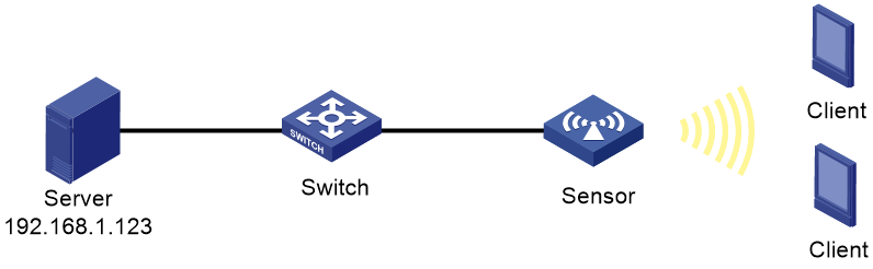

As shown in Figure 1, a WLAN probe system contains the following devices:
·     Sensors—APs enabled with WLAN probe. They scan the channels, collect wireless device information, and report the information to the server.
·     Server—Analyzes the information received from sensors and the AC.
Figure 1 WLAN probe system
Operating mechanism
A WLAN probe system operates as follows:
1.     Wireless devices send 802.11 packets.
2.     Sensors collect wireless device information, such as MAC address, device type, RSSI, and time stamp from the packets.
3.     Sensors send collected device information to the server.
4.     The server analyzes the received information.

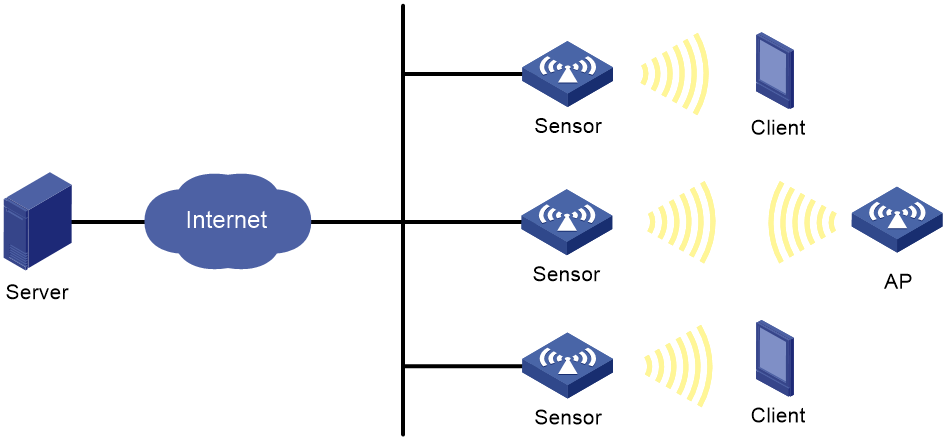

As shown in Figure 2, the sensor provides wireless services for clients as a fat AP.
Enable WLAN probe on radio 1 of the sensor, and configure the sensor to report the received wireless device information to the server.
Figure 2 Network diagram
# Configure wireless service settings on the sensor. (Details not shown.)
For more information, see WLAN access configuration in WLAN Access Configuration Guide.
# Enable WLAN probe.
<Sensor> system-view
[Sensor] interface wlan-radio 1/0/1
[Sensor-WLAN-Radio1/0/1] client-proximity-sensor enable
[Sensor-WLAN-Radio1/0/1] quit
# Configure the sensor to report wireless device information to the UDP server with IP address 192.168.1.123 and port number 1234, and set the report interval to 20 seconds.
[Sensor] client-proximity-sensor udp-server 192.168.1.123 port 1234 interval 20
