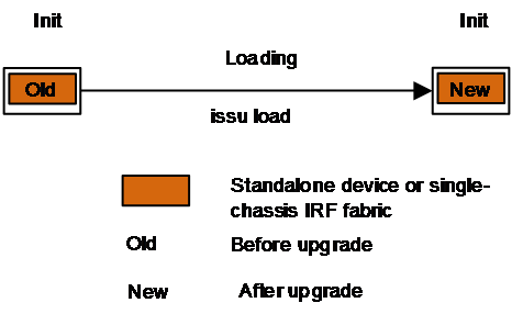

Performing an incremental upgrade on a standalone device (centralized devices) or a single-chassis IRF fabric (centralized IRF devices)
As shown in Figure 1, the upgrade operates as follows:
1.     The device is in Init state before the upgrade and enters Loading state when the issu load command is executed. When the upgrade completes, the device enters Loaded state.
2.     The device enters Accepted state when the issu accept command is executed successfully to accept the upgrade to a compatible version and delete the automatic rollback timer.
3.     The device enters Committing state when the issu commit command is executed to complete the ISSU upgrade to a compatible version, and it enters Init state when the upgrade completes.
IMPORTANT
IMPORTANT:
If a rollback is performed during the upgrade process, the system will roll back to the version before the upgrade.
Figure 1 Performing an incremental upgrade on a standalone device or a single-chassis IRF fabric

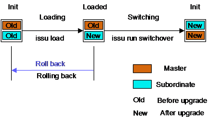

Performing a reboot, ISSU reboot, or incompatible upgrade on a standalone device (centralized devices) or single-chassis IRF fabric (centralized IRF devices)
As shown in Figure 2, the device is in Init state before the upgrade and enters Loading state when the issu load command is executed. When the upgrade completes, the device enters Loaded state.
Figure 2 Performing a reboot, ISSU reboot, or incompatible upgrade on a standalone device or single-chassis IRF fabric

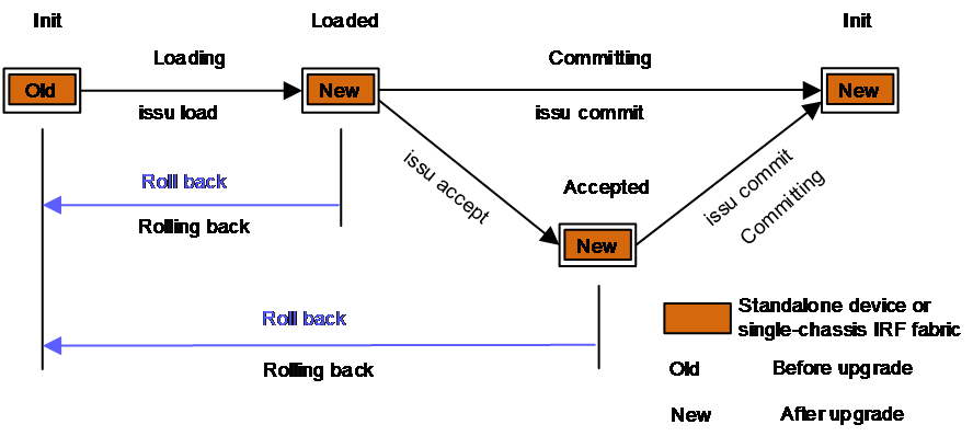

Performing a compatible upgrade on a multichassis IRF fabric
As shown in Figure 3, the upgrade operates as follows:
1.     The device is in Init state before the upgrade and enters Loading state when the issu load command is executed to upgrade a subordinate device in the IRF fabric. When the upgrade completes, the device enters Loaded state.
2.     The device enters Switching state when the issu run switchover command is executed to perform an ISSU switchover. When the switchover completes, the device enters Switchover state.
3.     The device enters Accepted state when the issu accept command is executed successfully to accept the upgrade to a compatible version and delete the automatic rollback timer.
4.     The device enters Committing state when the issu commit command is executed to upgrade all other member devices in the IRF fabric. When the upgrade completes, the device enters Init state.
IMPORTANT
IMPORTANT:
Figure 3 Performing a compatible upgrade on a multichassis IRF fabric

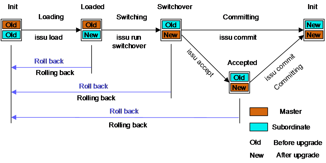

Performing an incompatible upgrade on a multichassis IRF fabric
As shown in Figure 4, the upgrade operates as follows:
2.     The device enters Switching state when the issu run switchover command is executed to perform an ISSU switchover. All the other members will be upgraded. When the switchover completes, the device enters Init state.
IMPORTANT
IMPORTANT:
Figure 4 Performing an incompatible upgrade on a multichassis IRF fabric

# Upgrade the system software on the subordinate member.
<Sysname> issu load file boot flash:/boot-t0001016.bin system flash:/system-t0001016.bin feature flash:/feature-t0001016.bin slot 2
This operation will delete the rollback point information for the previous upgrade and maybe get unsaved configuration lost. Continue? [Y/N]:y
Copying file flash:/boot-t0001016.bin to slot2#flash:/boot-t0001016.bin......Done.
Copying file flash:/system-t0001016.bin to slot2#flash:/system-t0001016.bin........................Done.
Copying file flash:/feature-t0001016.bin to slot2#flash:/feature-t0001016.bin......Done.
Verifying the file flash:/boot-t0001016.bin on slot 2...Done.
Verifying the file flash:/system-t0001016.bin on slot 2............Done.
Verifying the file flash:/feature-t0001016.bin on slot 2...Done.
Identifying the upgrade methods….Done.
Upgrade summary according to following table:
  Running Version             New Version
  Test 0001015                Test 0001016
  Slot                        Upgrade Way
  2                           Reboot
Upgrading software images to compatible versions. Continue? [Y/N]:y
This operation might take several minutes, please wait...Done.
# Verify that the ISSU is in a stable state.
<Sysname> display issu state
ISSU state: Loaded
Compatibility: Compatible
Work state: Normal
Upgrade method: Card by card
Upgraded slot:
  slot 2
Current upgrading slot: None
Previous version list:
  boot: 7.1.070, Test 0001015
  system: 7.1.070, Test 0001015
  feature: 7.1.070, Test 0001015
Previous software images:
  flash:/boot-t0001015.bin
  flash:/system-t0001015.bin
  flash:/feature-t0001015.bin
Upgrade version list:
  boot: 7.1.070, Test 0001016
  system: 7.1.070, Test 0001016
  feature: 7.1.070, Test 0001016
Upgrade software images:
The Loaded state is a stable state, which indicates that the system is waiting for a master/subordinate switchover. Slot 2 has completed the upgrade, and slot 1 has not.
# Perform a master/subordinate switchover.
<Sysname> issu run switchover
  Slot                        Switchover Way
  1                           Master subordinate switchover
This operation might take several minutes, please wait.........
ISSU state: Switchover
Work state: Normal
Upgraded slot:
  slot 2
The Switchover state is a stable state, which indicates that the system has completed the master/subordinate switchover and is waiting for a commit operation to upgrade slot 1.
# Roll back the software images to T0001015.
<Sysname> issu rollback
This command will quit the ISSU process and roll back to the previous version. Continue? [Y/N]:Y
# Verify that the rollback is finished.
ISSU state: Init
Compatibility: Unknown
Work state: Normal
Upgraded slot: None
Current version list:
Current software images:
The ISSU state field displays Init, which indicates that the rollback is finished.
