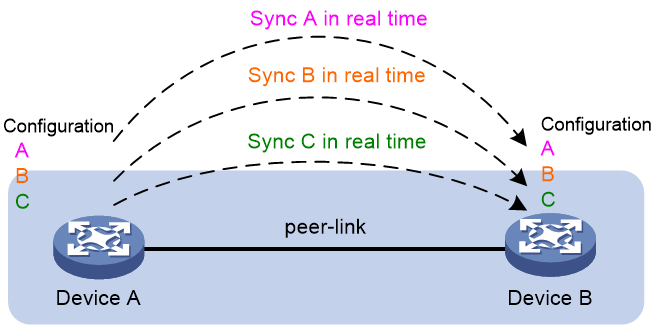

Real-time configuration sync
As shown in Figure 1, settings in multichassis configuration sync view of a member device are synchronized to its peer device in real time.

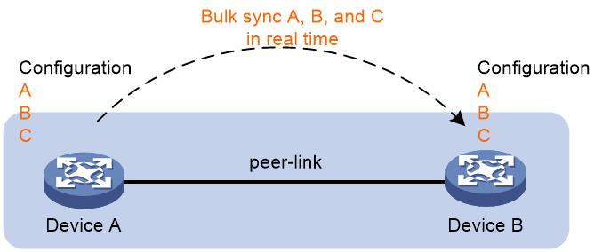

Bulk configuration sync
To fast deploy the services that are required to be consistent across the M-LAG member devices, configure the services on an M-LAG member device before M-LAG system setup. After the M-LAG system is set up and the peer link comes up, you can bulk synchronize settings on the member device to the same view for multichassis configuration sync on the M-LAG peer, as shown in Figure 2.

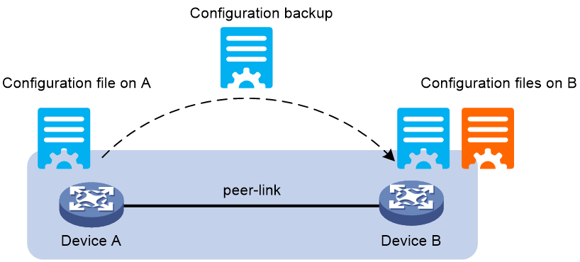

Configuration backup
If you are to update an M-LAG member device, for example, update the software version or replace the device, back up its configuration file to the M-LAG peer in advance as shown in Figure 3. After the update is completed, you can retrieve the previously saved configuration file from the peer device.
