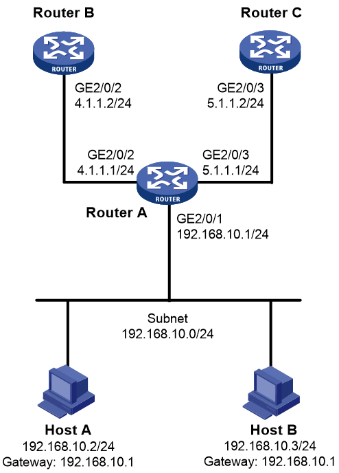

Example: Configuring packet type-based local PBR
As shown in Figure 1, Router B and Router C do not have a route to reach each other.
Configure PBR on Router A to forward all TCP packets to the next hop 1.1.2.2 (Router B).
Figure 1 Network diagram
1.     Configure Router A:
# Configure the IP addresses of GigabitEthernet 2/0/1 and GigabitEthernet 2/0/2.
<RouterA> system-view
[RouterA] interface gigabitethernet 2/0/1
[RouterA-GigabitEthernet2/0/1] ip address 1.1.2.1 24
[RouterA-GigabitEthernet2/0/1] quit
[RouterA] interface gigabitethernet 2/0/2
[RouterA-GigabitEthernet2/0/2] ip address 1.1.3.1 24
[RouterA-GigabitEthernet2/0/2] quit
# Configure ACL 3101 to match TCP packets.
[RouterA] acl advanced 3101
[RouterA-acl-ipv4-adv-3101] rule permit tcp
[RouterA-acl-ipv4-adv-3101] quit
# Configure Node 5 for the policy aaa to forward TCP packets to next hop 1.1.2.2.
[RouterA] policy-based-route aaa permit node 5
[RouterA-pbr-aaa-5] if-match acl 3101
[RouterA-pbr-aaa-5] apply next-hop 1.1.2.2
[RouterA-pbr-aaa-5] quit
# Configure local PBR by applying the policy aaa to Router A.
[RouterA] ip local policy-based-route aaa
2.     On Router B, configure the IP address of GigabitEthernet 2/0/1.
<RouterB> system-view
[RouterB] interface gigabitethernet 2/0/1
[RouterB-GigabitEthernet2/0/1] ip address 1.1.2.2 24
3.     On Router C, configure the IP address of GigabitEthernet 2/0/2.
<RouterC> system-view
[RouterC] interface gigabitethernet 2/0/2
[RouterC-GigabitEthernet2/0/2] ip address 1.1.3.2 24
1.     Perform telnet operations to verify that local PBR on Router A operates as configured to forward the matching TCP packets to the next hop 1.1.2.2 (Router B), as follows:
# Verify that you can telnet to Router B from Router A successfully. (Details not shown.)
# Verify that you cannot telnet to Router C from Router A. (Details not shown.)
2.     Verify that Router A forwards packets other than TCP packets through GigabitEthernet 2/0/2. For example, verify that you can ping Router C from Router A. (Details not shown.)

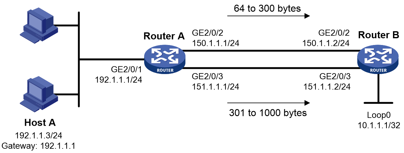

Example: Configuring packet length-based interface PBR
As shown in Figure 3, configure interface PBR to guide the forwarding of packets received on GigabitEthernet 2/0/1 of Router A as follows:
·     Set the next hop of packets with a length of 64 to 300 bytes to 150.1.1.2/24.
·     Set the next hop of packets with a length of 301 to 1000 bytes to 151.1.1.2/24.
Figure 3 Network diagram
1.     Configure IP addresses and unicast routing protocol settings to make sure the devices each have a route to reach one another. (Details not shown.)
2.     Configure Router A:
# Configure Node 10 for the policy lab1 to forward packets with a length of 64 to 300 bytes to the next hop 150.1.1.2.
[RouterA] policy-based-route lab1 permit node 10
[RouterA-pbr-lab1-10] if-match packet-length 64 300
[RouterA-pbr-lab1-10] apply next-hop 150.1.1.2
[RouterA-pbr-lab1-10] quit
# Configure Node 20 for the policy lab1 to forward packets with a length of 301 to 1000 bytes to the next hop 151.1.1.2.
[RouterA] policy-based-route lab1 permit node 20
[RouterA-pbr-lab1-20] if-match packet-length 301 1000
[RouterA-pbr-lab1-20] apply next-hop 151.1.1.2
[RouterA-pbr-lab1-20] quit
# Configure interface PBR by applying the policy lab1 to GigabitEthernet 2/0/1.
[RouterA-GigabitEthernet2/0/1] ip policy-based-route lab1
# Execute the debugging ip policy-based-route command on Router A.
<RouterA> debugging ip policy-based-route
<RouterA> terminal logging level 7
<RouterA> terminal monitor
# Ping Loopback 0 of Router B from Host A, and set the data length to 64 bytes. In this way, the total length of the data packet is in the range of 64 to 300 bytes.
C:\>ping –n 1 -l 64 10.1.1.1
Pinging 10.1.1.1 with 64 bytes of data:
Reply from 10.1.1.1: bytes=64 time=1ms TTL=64
Ping statistics for 10.1.1.1:
    Packets: Sent = 1, Received = 1, Lost = 0 (0% loss),
The debugging information about PBR displayed on Router A is as follows:
<RouterA>
*Jun  26 12:04:33:519 2012 RouterA PBR4/7/PBR Forward Info: -MDC=1; Policy:lab1, Node:
 10,match succeeded.
*Jun  26 12:04:33:519 2012 RouterA PBR4/7/PBR Forward Info: -MDC=1; apply next-hop 150
.1.1.2.
The output shows that Router A sets the next hop for the received packets to 150.1.1.2 according to PBR. The packets are forwarded through GigabitEthernet 2/0/2.
# Ping Loopback 0 of Router B from Host A, and set the data length to 300 bytes. In this way, the total length of the data packet is in the range of 301 to 1000 bytes.
C:\> ping –n 1 -l 300 10.1.1.1
Pinging 10.1.1.1 with 300 bytes of data:
Reply from 10.1.1.1: bytes=300 time=1ms TTL=64
<RouterA>
*Jun  26 12:20:33:610 2012 RouterA PBR4/7/PBR Forward Info: -MDC=1; Policy:lab1, Node:
 20,match succeeded.
*Jun  26 12:20:33:610 2012 RouterA PBR4/7/PBR Forward Info: -MDC=1; apply next-hop 151
.1.1.2.
The output shows that Router A sets the next hop for the received packets to 151.1.1.2 according to PBR. The packets are forwarded through GigabitEthernet 2/0/3.

Example: Configuring packet service-type-based interface PBR
As shown in Figure 6, Router B and Router C do not have a route to reach each other.
Configure interface PBR on Router A to forward all FTP packets received on GigabitEthernet 2/0/1 to the next hop 1.1.2.2/24 (Router B).
Figure 6 Network diagram
1.     Configure IP addresses and unicast routing protocol settings to make sure Router B and Router C can reach Host A. (Details not shown.)
# Configure Node 5 for the policy aaa, and specify the system-predefined service object group ftp for the policy node to forward FTP packets to next hop 1.1.2.2.
[RouterA-pbr-aaa-5] if-match object-group service ftp
# Configure interface PBR by applying the policy aaa to GigabitEthernet 2/0/1.
[RouterA-GigabitEthernet2/0/1] ip policy-based-route aaa
1.     Perform logins through FTP to verify that interface PBR on Router A operates as configured to forward the matching FTP packets to the next hop 1.1.2.2 (Router B), as follows:
# Verify that you can log in to Router B from Host A successfully. (Details not shown.)
# Verify that you cannot log in to Router C from Host A. (Details not shown.)
2.     Verify that Router A forwards packets other than FTP packets through GigabitEthernet 2/0/3. For example, verify that you can ping Router C from Host A. (Details not shown.)
