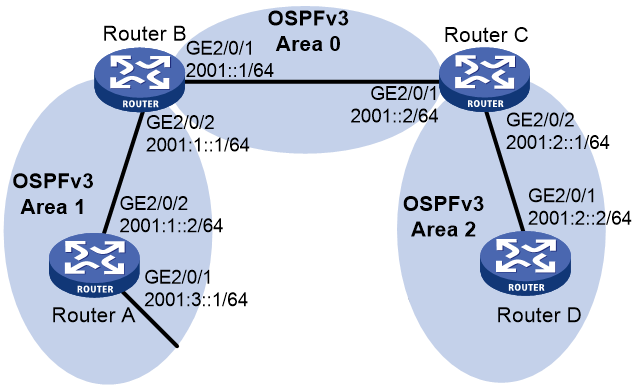

OSPFv3 configuration examples
Example: Configuring OSPFv3 stub area
As shown in Figure 3:
·     Enable OSPFv3 on all routers.
·     Split the AS into three areas.
·     Configure Router B and Router C as ABRs to forward routing information between areas.
·     Configure Area 2 as a stub area to reduce LSAs in the area without affecting route reachability.
Figure 3 Network diagram
1.     Configure IPv6 addresses for interfaces. (Details not shown.)
2.     Configure basic OSPFv3:
# On Router A, enable OSPFv3 and specify the router ID as 1.1.1.1.
<RouterA> system-view
[RouterA] ospfv3 1
[RouterA-ospfv3-1] router-id 1.1.1.1
[RouterA-ospfv3-1] quit
[RouterA] interface gigabitethernet 2/0/1
[RouterA-GigabitEthernet2/0/1] ospfv3 1 area 1
[RouterA-GigabitEthernet2/0/1] quit
[RouterA] interface gigabitethernet 2/0/2
[RouterA-GigabitEthernet2/0/2] ospfv3 1 area 1
[RouterA-GigabitEthernet2/0/2] quit
# On Router B, enable OSPFv3 and specify the router ID as 2.2.2.2.
<RouterB> system-view
[RouterB] ospfv3 1
[RouterB-ospfv3-1] router-id 2.2.2.2
[RouterB-ospfv3-1] quit
[RouterB] interface gigabitethernet 2/0/1
[RouterB-GigabitEthernet2/0/1] ospfv3 1 area 0
[RouterB-GigabitEthernet2/0/1] quit
[RouterB] interface gigabitethernet 2/0/2
[RouterB-GigabitEthernet2/0/2] ospfv3 1 area 1
[RouterB-GigabitEthernet2/0/2] quit
# On Router C, enable OSPFv3 and specify the router ID as 3.3.3.3.
<RouterC> system-view
[RouterC] ospfv3 1
[RouterC-ospfv3-1] router-id 3.3.3.3
[RouterC-ospfv3-1] quit
[RouterC] interface gigabitethernet 2/0/1
[RouterC-GigabitEthernet2/0/1] ospfv3 1 area 0
[RouterC-GigabitEthernet2/0/1] quit
[RouterC] interface gigabitethernet 2/0/2
[RouterC-GigabitEthernet2/0/2] ospfv3 1 area 2
[RouterC-GigabitEthernet2/0/2] quit
# On Router D, enable OSPFv3 and specify the router ID as 4.4.4.4.
<RouterD> system-view
[RouterD] ospfv3 1
[RouterD-ospfv3-1] router-id 4.4.4.4
[RouterD-ospfv3-1] quit
[RouterD] interface gigabitethernet 2/0/2
[RouterD-GigabitEthernet2/0/2] ospfv3 1 area 2
[RouterD-GigabitEthernet2/0/2] quit
# Display OSPFv3 neighbors on Router B.
[RouterB] display ospfv3 peer
               OSPFv3 Process 1 with Router ID 2.2.2.2
 Area: 0.0.0.0
 Router ID       Pri State             Dead-Time InstID Interface
 3.3.3.3         1   Full/BDR          00:00:40  0      GE2/0/1
 Area: 0.0.0.1
 1.1.1.1         1   Full/DR           00:00:40  0      GE2/0/2
# Display OSPFv3 neighbors on Router C.
[RouterC] display ospfv3 peer
               OSPFv3 Process 1 with Router ID 3.3.3.3
 Area: 0.0.0.0
 2.2.2.2         1   Full/DR           00:00:40  0      GE2/0/1
 Area: 0.0.0.2
 4.4.4.4         1   Full/BDR          00:00:40  0      GE2/0/2
# Display OSPFv3 neighbors on Router D.
[RouterD] display ospfv3 routing
               OSPFv3 Process 1 with Router ID 4.4.4.4
 I  - Intra area route,  E1 - Type 1 external route,  N1 - Type 1 NSSA route
 IA - Inter area route,  E2 - Type 2 external route,  N2 - Type 2 NSSA route
 *  - Selected route
*Destination: 2001::/64
  Type       : IA                        Area       : 0.0.0.2
  AdvRouter  : 3.3.3.3                   Preference : 10
  NibID      : 0x23000004                Cost       : 2
  Interface  : GE1/0/2                   BkInterface: N/A
  Nexthop    : FE80::48C0:26FF:FEDA:305
  BkNexthop  : N/A
  Status     : Rely
 *Destination: 2001:1::/64
  NibID      : 0x23000004                Cost       : 3
  BkNexthop  : N/A
  Status     : Rely
 *Destination: 2001:2::/64
  Type       : I                         Area       : 0.0.0.2
  AdvRouter  : 4.4.4.4                   Preference : 10
  NibID      : 0x23000002                Cost       : 1
  Nexthop    : ::
  BkNexthop  : N/A
  Status     : Direct
 *Destination: 2001:3::1/128
  BkNexthop  : N/A
  Status     : Rely
 Total: 4
 Intra area: 1         Inter area: 3         ASE: 0         NSSA: 0

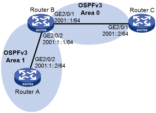

Example: Configuring OSPFv3 NSSA area
As shown in Figure 4:
·     Configure OSPFv3 on all routers and split the AS into three areas.
·     Configure Area 1 as an NSSA area and configure Router A as an ASBR to redistribute static routes into the AS.
Figure 4 Network diagram
2.     Configure basic OSPFv3 (see "Example: Configuring OSPFv3 stub area").
3.     Configure Area 1 as an NSSA area:
# Configure Router A.
[RouterA] ospfv3
[RouterA-ospfv3-1] area 1
[RouterA-ospfv3-1-area-0.0.0.1] nssa
[RouterA-ospfv3-1-area-0.0.0.1] quit
# Configure Router B.
[RouterB] ospfv3
[RouterB-ospfv3-1] area 1
[RouterB-ospfv3-1-area-0.0.0.1] nssa
[RouterB-ospfv3-1-area-0.0.0.1] quit
# Display OSPFv3 routing information on Router D.
[RouterD] display ospfv3 1 routing
 *  - Selected route
  NibID      : 0x23000003                Cost       : 2
  BkNexthop  : N/A
  Status     : Rely
  NibID      : 0x23000003                Cost       : 3
  BkNexthop  : N/A
  Status     : Rely
  NibID      : 0x23000001                Cost       : 1
  Nexthop    : ::
  BkNexthop  : N/A
  Status     : Direct
 *Destination: 2001:3::/64
  NibID      : 0x23000003                Cost       : 4
  BkNexthop  : N/A
  Status     : Rely
 Total: 4
4.     Configure route redistribution:
# Configure an IPv6 static route, and configure OSPFv3 to redistribute the static route on Router A.
[RouterA] ipv6 route-static 1234:: 64 null 0
 *  - Selected route
  NibID      : 0x23000002                Cost       : 2
  BkNexthop  : N/A
  Status     : Rely
  NibID      : 0x23000002                Cost       : 3
  BkNexthop  : N/A
  Status     : Rely
  NibID      : 0x23000004                Cost       : 1
  Nexthop    : ::
  BkNexthop  : N/A
  Status     : Direct
  NibID      : 0x23000002                Cost       : 4
  BkNexthop  : N/A
  Status     : Rely
 *Destination: 1234::/64
  Type       : E2                        Tag        : 1
  AdvRouter  : 2.2.2.2                   Preference : 150
  BkNexthop  : N/A
  Status     : Normal
 Total: 5
 Intra area: 1         Inter area: 3         ASE: 1         NSSA: 0
The output shows an AS external route imported from the NSSA area exists on Router D.

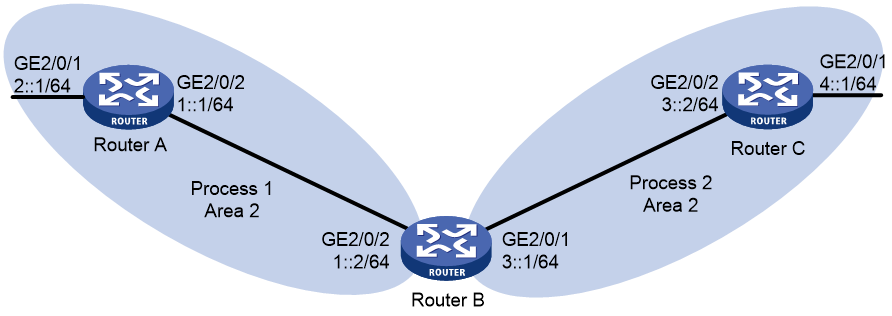

Example: Configuring OSPFv3 route redistribution
As shown in Figure 6:
·     Router A, Router B, and Router C are in Area 2.
·     OSPFv3 process 1 and OSPFv3 process 2 run on Router B. Router B communicates with Router A and Router C through OSPFv3 process 1 and OSPFv3 process 2.
·     Configure OSPFv3 process 2 to redistribute direct routes and the routes from OSPFv3 process 1 on Router B, and set the metric for redistributed routes to 3. Router C can then learn the routes destined for 1::0/64 and 2::0/64, and Router A cannot learn the routes destined for 3::0/64 or 4::0/64.
Figure 6 Network diagram
# Enable OSPFv3 process 1 on Router A.
[RouterA] ospfv3 1
[RouterA-GigabitEthernet2/0/2] ospfv3 1 area 2
[RouterA-GigabitEthernet2/0/1] ospfv3 1 area 2
# Enable OSPFv3 process 1 and OSPFv3 process 2 on Router B.
[RouterB] ospfv3 1
[RouterB-GigabitEthernet2/0/2] ospfv3 1 area 2
[RouterB] ospfv3 2
[RouterB-ospfv3-2] router-id 3.3.3.3
[RouterB-ospfv3-2] quit
[RouterB-GigabitEthernet2/0/1] ospfv3 2 area 2
# Enable OSPFv3 process 2 on Router C.
[RouterC] ospfv3 2
[RouterC-ospfv3-2] router-id 4.4.4.4
[RouterC-ospfv3-2] quit
[RouterC-GigabitEthernet2/0/2] ospfv3 2 area 2
[RouterC-GigabitEthernet2/0/1] ospfv3 2 area 2
# Display the routing table on Router C.
[RouterC] display ipv6 routing-table
Destinations : 7 Routes : 7
Destination: ::1/128                                     Protocol  : Direct
NextHop    : ::1                                         Preference: 0
Interface  : InLoop0                                     Cost      : 0
Destination: 3::/64                                      Protocol  : Direct
NextHop    : ::                                          Preference: 0
Interface  : GE1/0/2                                     Cost      : 0
Destination: 3::2/128                                    Protocol  : Direct
Destination: 4::/64                                      Protocol  : Direct
Interface  : GE1/0/1                                     Cost      : 0
Destination: 4::1/128                                    Protocol  : Direct
Destination: FE80::/10                                   Protocol  : Direct
Interface  : NULL0                                       Cost      : 0
Destination: FF00::/8                                    Protocol  : Direct
3.     Configure OSPFv3 route redistribution:
# Configure OSPFv3 process 2 to redistribute direct routes and the routes from OSPFv3 process 1 on Router B, and set the metric for redistributed routes to 3.
[RouterB] ospfv3 2
[RouterB-ospfv3-2] import-route ospfv3 1 cost 3
[RouterB-ospfv3-2] import-route direct cost 3
Destinations : 9 Routes : 9
Destination: 1::/64                                      Protocol  : O_ASE2
NextHop    : FE80::200:CFF:FE01:1C03                     Preference: 150
Interface  : GE1/0/2                                     Cost      : 3
Destination: 2::/64                                      Protocol  : O_ASE2

Example: Configuring OSPFv3 route summarization
As shown in Figure 7:
·     OSPFv3 process 1 and OSPFv3 process 2 run on Router B. Router B communicates with Router A and Router C through OSPFv3 process 1 and OSPFv3 process 2, respectively.
·     On Router A, configure IPv6 addresses 2:1:1::1/64, 2:1:2::1/64, and 2:1:3::1/64 for GigabitEthernet 2/0/1.
·     On Router B, configure OSPFv3 process 2 to redistribute direct routes and the routes from OSPFv3 process 1. Router C can then learn the routes destined for 2::/64, 2:1:1::/64, 2:1:2::/64, and 2:1:3::/64.
·     On Router B, configure route summarization to advertise only summary route 2::/16 to Router C.
Figure 7 Network diagram
2.     Configure OSPFv3:
[RouterA] ospfv3 1
[RouterA-GigabitEthernet2/0/1] ipv6 address 2:1:1::1 64
[RouterA-GigabitEthernet2/0/1] ipv6 address 2:1:2::1 64
[RouterA-GigabitEthernet2/0/1] ipv6 address 2:1:3::1 64
[RouterB] ospfv3 1
[RouterB] ospfv3 2
[RouterC] ospfv3 2
# Configure OSPFv3 process 2 to redistribute direct routes and the routes from OSPFv3 process 1 on Router B.
[RouterB] ospfv3 2
Destinations : 12 Routes : 12
Interface  : GE1/0/2                                     Cost      : 1
Destination: 2:1:1::/64                                  Protocol  : O_ASE2
Destination: 2:1:2::/64                                  Protocol  : O_ASE2
Destination: 2:1:3::/64                                  Protocol  : O_ASE2
NextHop    : 3::2                                        Preference: 0
NextHop    : 4::1                                        Preference: 0
4.     Configure ASBR route summarization:
# On Router B, configure OSPFv3 process 2 to advertise a summary route 2::/16.
[RouterB] ospfv3 2
[RouterB-ospfv3-2] asbr-summary 2:: 16
Destination: 2::/16                                      Protocol  : O_ASE2

Example: Configuring OSPFv3 IPsec profile
As shown in Figure 12, all routers run OSPFv3, and the AS is divided into two areas.
Configure IPsec profiles on the routers to authenticate OSPFv3 packets.
Figure 12 Network diagram
