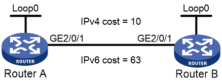

Figure 1 NSAP address format

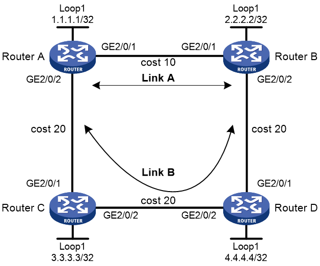

Figure 2 shows one IS-IS network topology. Area 1 is the backbone that comprises a set of Level-2 routers. The other four areas are non-backbone areas connected to the backbone through Level-1-2 routers.
Figure 2 IS-IS topology 1

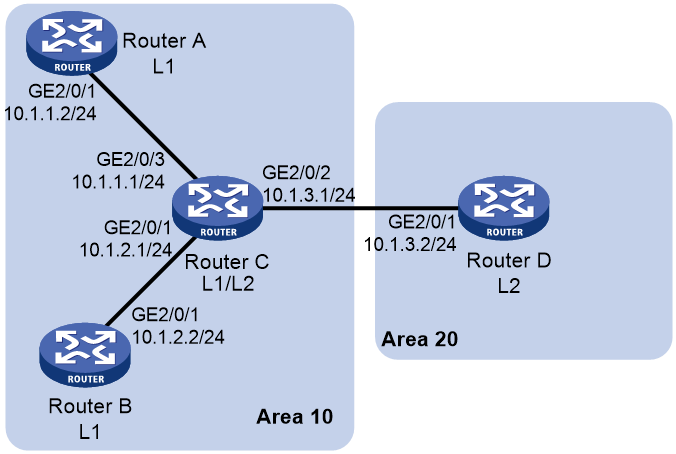

Figure 3 shows another IS-IS topology. No area is defined as the backbone in this topology. The backbone comprises all contiguous Level-2 and Level-1-2 routers in different areas. The IS-IS backbone does not need to be a specific area.
Figure 3 IS-IS topology 2

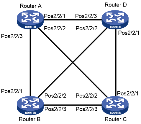

As shown in Figure 4, the same level routers on a network, including non-DIS routers, establish adjacency with each other.
Figure 4 DIS in the IS-IS broadcast network

Configuring IPv6 IS-IS MTR
On a network, IPv4 and IPv6 topologies must be consistent so that both IPv6 IS-IS and IPv4 IS-IS can use the SPF algorithm to perform route calculation. If they are different, routers supporting both IPv4 and IPv6 might send IPv6 packets to routers that do not support IPv6, resulting in packet loss.
To resolve this issue, configure IPv6 IS-IS MTR to perform route calculation separately in IPv4 and IPv6 topologies.
Figure 7 Network diagram
As shown in Figure 7, the numbers refer to the link costs. Router A, Router B, and Router D support both IPv4 and IPv6. Router C supports only IPv4 and cannot forward IPv6 packets.
Enable IPv6 IS-IS MTR on Router A, Router B, Router C, and Router D to make them perform route calculation separately in IPv4 and IPv6 topologies. With this configuration, Router A does not forward IPv6 packets destined to Router D through Router B, avoiding packet loss.
As a best practice to avoid route calculation failures, configure this feature when both IPv4 and IPv6 topologies exist in the network.
2.     Enter IS-IS view.
isis [ process-id ] [ vpn-instance vpn-instance-name ]
3.     Specify an IS-IS cost style.
cost-style { compatible | wide | wide-compatible }
By default, IS-IS only transmits and receives packets using the narrow cost style.
4.     Enter IPv6 address family view.
5.     Enable IPv6 IS-IS MTR.
multi-topology [ compatible ]
By default, IPv6 IS-IS MTR is disabled.

Configuring IS-IS route leaking
By default, the Level-2 router does not advertise the routes of the Level-2 area and other Level-1 areas to a Level-1 area. The Level-1 routers in that Level-1 area sends packets destined for other areas to the nearest Level-1-2 router. As a result, IS-IS cannot use the optimal route to forward these packets. To resolve this issue, perform this task to configure IS-IS route leaking.
After you configure route leaking on a Level-1-2 router, this feature functions as follows:
1.     Filters routes with the specified criteria.
2.     Imports the desired routes from other Level-1 areas and the Level-2 area into the Level-1 area to which the Level-1-2 router belongs.
As shown in Figure 8, the optimal path from Device A to Device F is Device A > Device B > Device D > Device E > Device F and the total cost is 40. By default, the actual path to Device F on Device A is Device A > Device C > Device E > Device F and the total cost is 70. After you configure route leaking on Device C and Device D, IS-IS will use the Device A > Device B > Device D > Device E > Device F path to forward traffic from Device A to Device F.
Figure 8 Route leaking
Perform this task to control route advertisement (route leaking) between Level-1 and Level-2.
You can configure IS-IS to advertise routes from Level-2 to Level-1, and to not advertise routes from Level-1 to Level-2.

As shown in Figure 9, Device A needs to communicate with Device B, Device C, and Device D. For security purposes, other devices in areas 2, 3, and 5 should not receive the packets sent by Device A. To resolve this issue, perform the following task:
1.     Configure the same administrative tag value for the IS-IS interfaces on Device B, Device C, and Device D.
2.     Configure route leaking from Level-2 to Level-1 on the Level-1-2 device in Area 4 and specify the same tag value as the route filter.
As shown in Figure 10, the IS-IS network topology on Device A is updated after you perform the above task.
Figure 9 IS-IS network diagram without the administrative tag
Figure 10 IS-IS network diagram with the administrative tag

As shown in Figure 11, both Device A and Device B support LSP fragment extension. With LSP fragment extension enabled, Device A advertises some route information in the LSPs generated by Device A1 and Device A2. On receipt of these LSPs, Device B reads the IS Alias ID TLVs and determines that Device A is the originating system. The route information received from Device A1 and Device A2 is actually generated by Device A. In this situation, virtual systems do not participate in route calculation.
Figure 11 IS-IS LSP fragment extension

In NBMA networks, many P2P links might exist. As shown in Figure 12, Routers A, B, C and D run IS-IS. When Router A generates an LSP, it floods the LSP out of Pos2/2/1, Pos2/2/2, and Pos2/2/3. After Router D receives the LSP from Pos2/2/3, it floods it out of Pos2/2/1 and Pos2/2/2 to Router B and Router C. However, Router B and Router C have already received the LSP from Router A. Repeated LSP flooding consumes extra bandwidth.
Figure 12 Network diagram of a fully meshed network
To avoid this problem, you can add interfaces to a mesh group or block some interfaces.

A link or router failure on a path can cause packet loss. IS-IS LFA FRR enables fast rerouting to minimize the failover time.
Figure 14 Network diagram for IS-IS LFA FRR
In Figure 14, after you enable LFA FRR on Router B, IS-IS automatically calculates or designates a backup next hop when a link failure is detected. In this way, packets are directed to the backup next hop to reduce traffic recovery time. Meanwhile, IS-IS calculates the shortest path based on the new network topology, and forwards packets over the path after network convergence.
When a primary link failure occurs, BFD can detect and report the link failure to IS-IS for a primary-backup path switchover. This can shorten the duration of service interruption.
You can assign a backup next hop for IS-IS FRR through the following ways:
·     Enable IS-IS LFA FRR to calculate a backup next hop through LFA calculation.
·     Designate a backup next hop with a routing policy for routes matching specific criteria.

In a ring topology where IS-IS LFA FRR cannot calculate the backup path, configure remote LFA FRR to ensure network reliability.
Remote LFA uses the following concepts:
·     P space—Use the source node of the protected link as the root to establish a shortest path tree. All nodes that are reachable from the source node without passing the protected link form the P space. Nodes in the P space are called P nodes.
·     Extended P space—Use the source node of the protected link and its neighbors as the roots to establish shortest path trees. All nodes that are reachable from the source node or one of its neighbors without passing the protected link form the extended P space. The P space is a subset of the extended P space.
·     Q space—Use the destination node of the protected link as the root to establish a reverse shortest path tree. All nodes that are reachable from the root node without passing the protected link form the Q space. Nodes in the Q space are called Q nodes.
·     PQ node—A PQ node refers to a node that resides in both the extended P space and the Q space. Remote LFA uses a PQ node as the destination node of a protected link.
As shown in Figure 15, the traffic forwarding path is PE 1—P 1—P 2—PE 2. To avoid traffic loss caused by link failures between P 1 and P 2, the system establishes an LDP tunnel between P 1 and P 4, which is the PQ node. When the link between P 1 and P 2 fails, P 1 encapsulates IP packets in MPLS packets and sends the MPLS packets to P 4 through the LDP tunnel. After receiving the MPLS packets, P 4 removes the MPLS labels of the packets and then forwards the packets to the next hop based on the IP routing table.
The system determines P 4 as the PQ node as follows:
1.     Uses P 1 (source node of the protected link) and its neighbors except P 2 (which passes the protected link) as the roots to establish shortest path trees.
2.     Finds out all nodes that are reachable from P 1 or one of its neighbors without passing the protected link, which are PE 1, P 1, P 3, and P 4.
These nodes form the extended P space.
3.     Uses P 2 (destination node of the protected link) as the root to establish a reverse shortest path tree.
4.     Finds out all nodes that are reachable from P 2 without passing the protected link, which are PE 2 and P 4.
These nodes form the Q space.
5.     Finds out all nodes that reside in both the extended P space and the Q space.
Only P 4 resides in both the extended P space and the Q space, so P 4 is the PQ node of the protected link.

IS-IS configuration examples
Example: Configuring basic IS-IS
As shown in Figure 16, Router A, Router B, Router C, and Router D reside in an AS.
Router A and Router B are Level-1 routers, Router D is a Level-2 router, and Router C is a Level-1-2 router connecting two areas. Router A, Router B, and Router C are in area 10, and Router D is in area 20.
Figure 16 Network diagram
1.     Configure IP addresses for interfaces. (Details not shown.)
2.     Configure IS-IS:
# Configure Router A
<RouterA> system-view
[RouterA] isis 1
[RouterA-isis-1] is-level level-1
[RouterA-isis-1] network-entity 10.0000.0000.0001.00
[RouterA-isis-1] quit
[RouterA] interface gigabitethernet 2/0/1
[RouterA-GigabitEthernet2/0/1] isis enable 1
[RouterA-GigabitEthernet2/0/1] quit
# Configure Router B.
<RouterB> system-view
[RouterB] isis 1
[RouterB-isis-1] is-level level-1
[RouterB-isis-1] network-entity 10.0000.0000.0002.00
[RouterB-isis-1] quit
[RouterB] interface gigabitethernet 2/0/1
[RouterB-GigabitEthernet2/0/1] isis enable 1
[RouterB-GigabitEthernet2/0/1] quit
# Configure Router C.
<RouterC> system-view
[RouterC] isis 1
[RouterC-isis-1] network-entity 10.0000.0000.0003.00
[RouterC-isis-1] quit
[RouterC] interface gigabitethernet 2/0/3
[RouterC-GigabitEthernet2/0/3] isis enable 1
[RouterC-GigabitEthernet2/0/3] quit
[RouterC] interface gigabitethernet 2/0/1
[RouterC-GigabitEthernet2/0/1] isis enable 1
[RouterC-GigabitEthernet2/0/1] quit
[RouterC] interface gigabitethernet 2/0/2
[RouterC-GigabitEthernet2/0/2] isis enable 1
[RouterC-GigabitEthernet2/0/2] quit
# Configure Router D
<RouterD> system-view
[RouterD] isis 1
[RouterD-isis-1] is-level level-2
[RouterD-isis-1] network-entity 20.0000.0000.0004.00
[RouterD-isis-1] quit
[RouterD] interface gigabitethernet 2/0/1
[RouterD-GigabitEthernet2/0/1] isis enable 1
[RouterD-GigabitEthernet2/0/1] quit
[RouterD] interface gigabitethernet 2/0/2
[RouterD-GigabitEthernet2/0/2] isis enable 1
[RouterD-GigabitEthernet2/0/2] quit
# Display the IS-IS LSDB information.
[RouterA] display isis lsdb
                        Database information for ISIS(1)
                          Level-1 Link State Database
LSPID                 Seq Num      Checksum      Holdtime      Length  ATT/P/OL
0000.0000.0001.00-00* 0x00000004   0xdf5e        1096          68      0/0/0
0000.0000.0002.00-00  0x00000004   0xee4d        1102          68      0/0/0
0000.0000.0002.01-00  0x00000001   0xdaaf        1102          55      0/0/0
0000.0000.0003.00-00  0x00000009   0xcaa3        1161          111     1/0/0

Example: Configuring DIS election
As shown in Figure 17, on a broadcast network (Ethernet), Router A, Router B, Router C, and Router D reside in IS-IS Area 10. Router A and Router B are Level-1-2 routers, Router C is a Level-1 router, and Router D is a Level-2 router.
Change the DIS priority of Router A to make it elected as the Level-1-2 DIS router.
Figure 17 Network diagram
2.     Enable IS-IS:
# Configure Router A.
[RouterA] isis 1
[RouterB] isis 1
[RouterC] isis 1
[RouterC-isis-1] is-level level-1
# Configure Router D.
[RouterD] isis 1
[RouterD-isis-1] network-entity 10.0000.0000.0004.00
# Display information about IS-IS neighbors of Router A.
[RouterA] display isis peer
                          Peer information for IS-IS(1)
 System ID: 0000.0000.0002
 Interface: GE1/0/1                 Circuit Id:  0000.0000.0003.01
 State: Up     HoldTime: 21s        Type: L1(L1L2)     PRI: 64
 System ID: 0000.0000.0003
 State: Up     HoldTime: 6s         Type: L1           PRI: 64
 Interface: GE1/0/1                 Circuit Id:  0000.0000.0004.01
 State: Up     HoldTime: 23s        Type: L2(L1L2)     PRI: 64
 System ID: 0000.0000.0004
 State: Up     HoldTime: 23s        Type: L2           PRI: 64
# Display information about IS-IS interfaces of Router A.
[RouterA] display isis interface
                       Interface information for IS-IS(1)
  Interface:  GigabitEthernet2/0/1
  Index     IPv4 state      IPv6 state     Circuit ID   MTU   Type   DIS
  00001     Up              Down           1            1497  L1/L2  No/No
# Display IS-IS interfaces of Router C.
[RouterC] display isis interface
  00001     Up              Down           1            1497  L1/L2  Yes/No
# Display information about IS-IS interfaces of Router D.
[RouterD] display isis interface
  00001     Up              Down           1            1497  L1/L2  No/Yes

Example: Configuring IS-IS route redistribution
As shown in Figure 18, Router A, Router B, Router C, and Router D reside in the same AS. They use IS-IS to interconnect. Router A and Router B are Level-1 routers, Router D is a Level-2 router, and Router C is a Level-1-2 router.
Redistribute RIP routes into IS-IS on Router D.
Figure 18 Network diagram
2.     Configure basic IS-IS:
[RouterA] isis 1
[RouterB] isis 1
[RouterC] isis 1
[RouterD] isis 1
# Display IS-IS routing information on each router.

Example: Configuring IS-IS authentication
As shown in Figure 19, Router A, Router B, Router C, and Router D reside in the same IS-IS routing domain.
Router A, Router B, and Router C belong to Area 10, and Router D belongs to Area 20.
·     Configure neighbor relationship authentication between neighbors.
·     Configure area authentication in Area 10 to prevent untrusted routes from entering into the area.
·     Configure routing domain authentication on Router C and Router D to prevent untrusted routes from entering the routing domain.
Figure 19 Network diagram
[RouterA] isis 1
[RouterB] isis 1
[RouterC] isis 1
[RouterD] isis 1
[RouterD-isis-1] network-entity 20.0000.0000.0001.00
3.     Configure neighbor relationship authentication between neighbors:
# Set the authentication mode to MD5 and set the plaintext key to eRq on GigabitEthernet 2/0/1 of Router A and on GigabitEthernet 2/0/3 of Router C.
[RouterA-GigabitEthernet2/0/1] isis authentication-mode md5 plain eRg
[RouterC-GigabitEthernet2/0/3] isis authentication-mode md5 plain eRg
# Set the authentication mode to MD5 and set the plaintext key to t5Hr on GigabitEthernet 2/0/1 of Router B and on GigabitEthernet 2/0/1 of Router C.
[RouterB-GigabitEthernet2/0/1] isis authentication-mode md5 plain t5Hr
[RouterC-GigabitEthernet2/0/1] isis authentication-mode md5 plain t5Hr
# Set the authentication mode to MD5 and set the plaintext key to hSec on GigabitEthernet 2/0/1 of Router D and on GigabitEthernet 2/0/2 of Router C.
[RouterC-GigabitEthernet2/0/2] isis authentication-mode md5 plain hSec
[RouterD-GigabitEthernet2/0/1] isis authentication-mode md5 plain hSec
4.     Set the area authentication mode to MD5 and set the plaintext key to 10Sec on Router A, Router B, and Router C.
[RouterA] isis 1
[RouterA-isis-1] area-authentication-mode md5 plain 10Sec
[RouterB] isis 1
[RouterB-isis-1] area-authentication-mode md5 plain 10Sec
[RouterC] isis 1
[RouterC-isis-1] area-authentication-mode md5 plain 10Sec
5.     Set routing domain authentication mode to MD5 and set the plaintext key to 1020Sec on Router C and Router D.
[RouterC] isis 1
[RouterC-isis-1] domain-authentication-mode md5 plain 1020Sec
[RouterD] isis 1
[RouterD-isis-1] domain-authentication-mode md5 plain 1020Sec

Example: Configuring IS-IS NSR
As shown in Figure 21, Router S, Router A, and Router B belong to the same IS-IS routing domain.
·     Run IS-IS on all the routers to interconnect them with each other.
·     Enable IS-IS NSR on Router S to ensure forwarding continuity between Router A and Router B when an active/standby switchover occurs on Router S.
Figure 21 Network diagram

Table 5 Interface and IP address assignment
Device
Interface
IP address
Device
Interface
IP address
Router A
GE2/0/1
192.168.0.102/24
Router B
GE2/0/1
192.168.0.100/24
GE2/0/2
10.1.1.102/24
GE2/0/2
13.1.1.1/24
Loop0
121.1.1.1/32
Loop0
120.1.1.1/32

Example: Configuring IS-IS FRR
As shown in Figure 23, Router A, Router B, and Router C reside in the same IS-IS routing domain.
·     Configure IS-IS FRR so that when Link A fails, traffic can be switched to Link B immediately.
Figure 23 Network diagram
Table 6 Interface and IP address assignment
Device
Interface
IP address
Device

Example: Configuring IS-IS remote LFA FRR
As shown in Figure 23, Router A, Router B, Router C, and Router D reside in the same IS-IS routing domain.
·     Configure MPLS LDP on all the routers.
·     Configure IS-IS remote LFA FRR so that when Link A fails, traffic can be switched to Link B immediately.
Figure 24 Network diagram
Table 7 Interface and IP address assignment
Device
Interface
IP address
Device
Interface
IP address
Router A
GE2/0/1
12.12.12.1/24
Router B
GE2/0/1
12.12.12.2/24
GE2/0/2
13.13.13.1/24
GE2/0/2
15.15.15.1/24
Loop1
1.1.1.1/32
Loop1
2.2.2.2/32
Router C
GE2/0/1
13.13.13.2/24
Router D
GE2/0/1
15.15.15.2/24
GE2/0/2
14.14.14.1/24
GE2/0/2
14.14.14.2/24
Loop1
3.3.3.3/32
Loop1
4.4.4.4/32
1.     Configure IP addresses and subnet masks for interfaces on the routers. (Details not shown.)
2.     Configure IS-IS and MPLS LDP on all the routers:
[RouterA] mpls lsr-id 1.1.1.1
[RouterA] mpls ldp
[RouterA-ldp] accept target-hello all
[RouterA-ldp] quit
[RouterA] isis 1
[RouterA-isis-1] network-entity 00.0000.0000.0001.00
[RouterA] interface gigabitethernet 1/0/1
[RouterA-GigabitEthernet1/0/1] isis enable 1
[RouterA-GigabitEthernet1/0/1] isis cost 10
[RouterA-GigabitEthernet1/0/1] mpls enable
[RouterA-GigabitEthernet1/0/1] mpls ldp enable
[RouterA-GigabitEthernet1/0/1] quit
[RouterA] interface gigabitethernet 1/0/2
[RouterA-GigabitEthernet1/0/2] isis enable 1
[RouterA-GigabitEthernet1/0/2] isis cost 20
[RouterA-GigabitEthernet1/0/2] mpls enable
[RouterA-GigabitEthernet1/0/2] mpls ldp enable
[RouterA-GigabitEthernet1/0/2] quit
[RouterA] interface loopback 1
[RouterA-LoopBack1] isis enable 1
[RouterA-LoopBack1] quit
[RouterB] mpls lsr-id 2.2.2.2
[RouterB] mpls ldp
[RouterB-ldp] accept target-hello all
[RouterB-ldp] quit
[RouterB] isis 1
[RouterB-isis-1] network-entity 00.0000.0000.0002.00
[RouterB-GigabitEthernet1/0/1] isis enable 1
[RouterB-GigabitEthernet1/0/1] isis cost 10
[RouterB-GigabitEthernet1/0/1] mpls enable
[RouterB-GigabitEthernet1/0/1] mpls ldp enable
[RouterB-GigabitEthernet1/0/1] quit
[RouterB] interface gigabitethernet 1/0/2
[RouterB-GigabitEthernet1/0/2] isis enable 1
[RouterB-GigabitEthernet1/0/2] isis cost 20
[RouterB-GigabitEthernet1/0/2] mpls enable
[RouterB-GigabitEthernet1/0/2] mpls ldp enable
[RouterB-GigabitEthernet1/0/2] quit
[RouterB] interface loopback 1
[RouterB-LoopBack1] isis enable 1
[RouterB-LoopBack1] quit
[RouterC] mpls lsr-id 3.3.3.3
[RouterC] mpls ldp
[RouterC-ldp] accept target-hello all
[RouterC-ldp] quit
[RouterC] isis 1
[RouterC-isis-1] network-entity 00.0000.0000.0003.00
[RouterC] interface gigabitethernet 1/0/1
[RouterC-GigabitEthernet1/0/1] isis enable 1
[RouterC-GigabitEthernet1/0/1] isis cost 20
[RouterC-GigabitEthernet1/0/1] mpls enable
[RouterC-GigabitEthernet1/0/1] mpls ldp enable
[RouterC-GigabitEthernet1/0/1] quit
[RouterC] interface gigabitethernet 1/0/2
[RouterC-GigabitEthernet1/0/2] isis enable 1
[RouterC-GigabitEthernet1/0/2] isis cost 20
[RouterC-GigabitEthernet1/0/2] mpls enable
[RouterC-GigabitEthernet1/0/2] mpls ldp enable
[RouterC-GigabitEthernet1/0/2] quit
[RouterC] interface loopback 1
[RouterC-LoopBack1] isis enable 1
[RouterC-LoopBack1] quit
[RouterD] mpls lsr-id 4.4.4.4
[RouterD] mpls ldp
[RouterD-ldp] accept target-hello all
[RouterD-ldp] quit
[RouterD] isis 1
[RouterD-isis-1] network-entity 00.0000.0000.0004.00
[RouterD] interface gigabitethernet 1/0/1
[RouterD-GigabitEthernet1/0/1] isis enable 1
[RouterD-GigabitEthernet1/0/1] isis cost 20
[RouterD-GigabitEthernet1/0/1] mpls enable
[RouterD-GigabitEthernet1/0/1] mpls ldp enable
[RouterD-GigabitEthernet1/0/1] quit
[RouterD] interface gigabitethernet 1/0/2
[RouterD-GigabitEthernet1/0/2] isis enable 1
[RouterD-GigabitEthernet1/0/2] isis cost 20
[RouterD-GigabitEthernet1/0/2] mpls enable
[RouterD-GigabitEthernet1/0/2] mpls ldp enable
[RouterD-GigabitEthernet1/0/2] quit
[RouterD] interface loopback 1
[RouterD-LoopBack1] isis enable 1
[RouterD-LoopBack1] quit
3.     Configure IS-IS remote LFA FRR.
[RouterA] isis 1
[RouterA-isis-1] address-family ipv4
[RouterA-isis-1-ipv4] fast-reroute lfa
[RouterA-isis-1-ipv4] fast-reroute remote-lfa tunnel ldp
[RouterA-isis-1-ipv4] quit
# Display route 2.2.2.2/32 on Router A to view the backup next hop information.
[RouterA] display isis route ipv4 2.2.2.2 32 verbose
                         Route information for IS-IS(1)
                         Level-1 IPv4 Forwarding Table
 IPv4 Dest : 2.2.2.2/32          Int. Cost  : 10               Ext. Cost  : NULL
 Admin Tag : -                   Src Count  : 1                Flag       : R/L/-
 InLabel   : 4294967295          InLabel Flag: -/-/-/-/-/-
 NextHop   :                     Interface  :                  ExitIndex  :
    12.12.12.2                         GE1/0/1                    0x00000002
 Nib ID    : 0x14000008          OutLabel   : 4294967295       OutLabelFlag: -
 LabelSrc  : N/A                 Delay Flag : N/A
 Remote-LFA:
  Interface : GE1/0/2
  BkNextHop : 13.13.13.2         LsIndex    : 0x01000002
  Tunnel destination address: 4.4.4.4
  Backup label: {1149}
      Flags: D-Direct, R-Added to Rib, L-Advertised in LSPs, U-Up/Down Bit Set
      InLabel flags: R-Readvertisement, N-Node SID, P-no PHP
                     E-Explicit null, V-Value, L-Local
      OutLabelFlags: E-Explicit null, I-Implicit null, N-Nomal, P-SR label prefer
                         Level-2 IPv4 Forwarding Table
 Admin Tag : -                   Src Count  : 3                Flag       : -/-/-
Example: Configuring IS-IS multi-instance processes
As shown in Figure 25, the IPv4 and IPv6 costs are different on an interface. Configure IS-IS multi-instance processes to isolate the IPv4 and IPv6 network and avoid IPv6 route calculation errors.
Figure 25 Network diagram
Table 8 Interface and IP address assignment
Device
Interface
IPv4 address
IPv6 address
Router A
GE2/0/1
10.1.1.1/24
2001::1/64
Loop0
1.1.1.1/32
10::1/128
Router B
GE2/0/1
10.1.1.2/24
2001::2/64
Loop0
2.2.2.2/32
20::1/128
Configure IPv4 and IPv6 addresses for the interfaces. (Details not shown.)
1.     Configure traditional IPv4 IS-IS processes:
[RouterA] isis 1
[RouterA] interface loopback 0
[RouterA-LoopBack0] isis enable 1
[RouterA-LoopBack0] quit
[RouterB] isis 1
[RouterB] interface loopback 0
[RouterB-LoopBack0] isis enable 1
[RouterB-LoopBack0] quit
2.     Configure IPv6 IS-IS multi-instance processes:
[RouterA] isis 2
[RouterA-isis-2] network-entity 20.0000.0000.0010.00
[RouterA-isis-2] multi-instance enable iid 1
[RouterA-isis-2] address-family ipv6
[RouterA-isis-2-ipv6] quit
[RouterA-isis-2] quit
[RouterA-LoopBack0] isis ipv6 enable 2
[RouterA-GigabitEthernet2/0/1] isis ipv6 enable 2
[RouterA-GigabitEthernet2/0/1] isis process-id 2 cost 63
[RouterB] isis 2
[RouterB-isis-2] network-entity 20.0000.0000.0020.00
[RouterB-isis-2] multi-instance enable iid 1
[RouterB-isis-2] address-family ipv6
[RouterB-isis-2-ipv6] quit
[RouterB-isis-2] quit
[RouterB-LoopBack0] isis ipv6 enable 2
[RouterB-GigabitEthernet2/0/1] isis ipv6 enable 2
[RouterB-GigabitEthernet2/0/1] isis process-id 2 cost 63
# View information about the IPv4 IS-IS routing table of Router A.
 IPv4 Destination     IntCost    ExtCost ExitInterface   NextHop         Flags
 1.1.1.1/32           0          NULL    Loop0           Direct          D/L/-
 10.1.1.0/24          10         NULL    GE2/0/1         Direct          D/L/-
 2.2.2.2/32           10         NULL    GE2/0/1         10.1.1.2        R/L/-
 10.1.1.0/24          10         NULL    ULL             Direct          D/L/-
 2.2.2.2/32           10         NULL
The output shows that route calculation results are correct.
# View information about the IPv4 IS-IS routing table of Router B.
[RouterB] display isis route ipv4
 1.1.1.1/32           10         NULL    GE2/0/1         10.1.1.1        R/L/-
 2.2.2.2/32           0          NULL    Loop0           Direct          D/L/-
 1.1.1.1/32           10         NULL
# View information about the IPv6 IS-IS routing table of Router A.
[RouterA] display isis route ipv6
                         Route information for IS-IS(2)
                         Level-1 IPv6 forwarding table
 Destination : 10::1                                   PrefixLen: 128
 Flag        : D/L/-                                   Cost     : 0
 Next hop    : Direct                                  Interface: Loop0
 Destination : 2001::                                  PrefixLen: 64
 Flag        : D/L/-                                   Cost     : 63
 Next hop    : Direct                                  Interface: GE2/0/1
 Destination : 20::1                                   PrefixLen: 128
 Flag        : R/L/-                                   Cost     : 63
 Next hop    : FE80::861F:31FF:FE6D:201                Interface: GE2/0/1
                         Level-2 IPv6 forwarding table
 Flag        : -/-/-                                   Cost     : 63
# View information about the IPv6 IS-IS routing table of Router B.
[RouterB] display isis route ipv6
 Next hop    : FE80::861F:29FF:FE93:101                Interface: GE2/0/1

As shown in Figure 26, Router A, Router B, Router C, and Router D, all enabled with IPv6, reside in the same AS. Configure IPv6 IS-IS on the routers so that they can reach each other.
Figure 26 Network diagram
1.     Configure IPv6 addresses for interfaces. (Details not shown.)
2.     Configure IPv6 IS-IS:
[RouterA] isis 1
[RouterA-isis-1] address-family ipv6
[RouterA-isis-1-ipv6] quit
[RouterA-GigabitEthernet2/0/1] isis ipv6 enable 1
[RouterB] isis 1
[RouterB-isis-1] address-family ipv6
[RouterB-isis-1-ipv6] quit
[RouterB-GigabitEthernet2/0/1] isis ipv6 enable 1
[RouterC] isis 1
[RouterC-isis-1] address-family ipv6
[RouterC-isis-1-ipv6] quit
[RouterC-GigabitEthernet2/0/1] isis ipv6 enable 1
[RouterC-GigabitEthernet2/0/2] isis ipv6 enable 1
[RouterC-GigabitEthernet2/0/3] isis ipv6 enable 1
[RouterD] isis 1
[RouterD-isis-1] address-family ipv6
[RouterD-isis-1-ipv6] quit
[RouterD-GigabitEthernet2/0/1] isis ipv6 enable 1
[RouterD-GigabitEthernet2/0/2] isis ipv6 enable 1
# Display the IPv6 IS-IS routing table on Router A.
 Destination : ::                                      PrefixLen: 0
 Flag        : R/-/-                                   Cost     : 10
 Next hop    : FE80::200:FF:FE0F:4                     Interface: GE2/0/1
 Destination : 2001:1::                                PrefixLen: 64
 Flag        : D/L/-                                   Cost     : 10
 Destination : 2001:2::                                PrefixLen: 64
 Flag        : R/-/-                                   Cost     : 20
 Destination : 2001:3::                                PrefixLen: 64
# Display the IPv6 IS-IS routing table on Router B.
# Display the IPv6 IS-IS routing table on Router C.
[RouterC] display isis route ipv6
 Next hop    : Direct                                  Interface: GE2/0/2
 Next hop    : Direct                                  Interface: GE2/0/3
 Destination : 2001:4::                               PrefixLen: 64
# Display the IPv6 IS-IS routing table on Router D.
[RouterD] display isis route ipv6
Example: Configuring BFD for IPv6 IS-IS
As shown in Figure 27:
·     Configure IPv6 IS-IS on Router A, Router B, and Router C so that they can reach each other.
·     Enable BFD on GigabitEthernet 2/0/1 of Router A and Router B.
When the link between Router B and the Layer 2 switch fails, BFD can quickly detect the failure and notify IPv6 IS-IS of the failure. Then Router A and Router B communicate through Router C.
Figure 27 Network diagram
Table 9 Interface and IP address assignment
Device
Interface
IPv6 address
Device
Interface
IPv6 address
Router A
GE2/0/1
2001::1/64
Router B
GE2/0/1
2001::2/64
GE2/0/2
2001:2::1/64
GE2/0/2
2001:3::2/64
Router C
GE2/0/1
2001:2::2/64
GE2/0/2
2001:3::1/64
[RouterA] isis 1
[RouterA] interface gigabitethernet 2/0/2
[RouterA-GigabitEthernet2/0/2] isis ipv6 enable 1
[RouterA-GigabitEthernet2/0/2] quit
[RouterB] isis 1
[RouterB] interface gigabitethernet 2/0/2
[RouterB-GigabitEthernet2/0/2] isis ipv6 enable 1
[RouterB-GigabitEthernet2/0/2] quit
[RouterC] isis 1
[RouterC-GigabitEthernet2/0/1 quit
3.     Configure BFD functions:
# Enable BFD and configure BFD parameters on Router A.
[RouterA] bfd session init-mode active
[RouterA-GigabitEthernet2/0/1] isis ipv6 bfd enable
[RouterA-GigabitEthernet2/0/1] bfd min-transmit-interval 500
[RouterA-GigabitEthernet2/0/1] bfd min-receive-interval 500
[RouterA-GigabitEthernet2/0/1] bfd detect-multiplier 7
[RouterA-GigabitEthernet2/0/1] return
# Enable BFD and configure BFD parameters on Router B.
[RouterB] bfd session init-mode active
[RouterB-GigabitEthernet2/0/1] isis ipv6 bfd enable
[RouterB-GigabitEthernet2/0/1] bfd min-transmit-interval 500
[RouterB-GigabitEthernet2/0/1] bfd min-receive-interval 500
[RouterB-GigabitEthernet2/0/1] bfd detect-multiplier 6
# Display BFD session information on Router A.
<RouterA> display bfd session
 Total sessions: 1     Up sessions: 1     Init mode: Active
 IPv6 session working in control mode:
          Local discr: 1441                       Remote discr: 1450
            Source IP: FE80::20F:FF:FE00:1202 (link-local address of GigabitEthernet2/0/1 on Router A)
       Destination IP: FE80::20F:FF:FE00:1200 (link-local address of GigabitEthernet2/0/1 on Router B)
        Session state: Up                            Interface: GE2/0/1
            Hold time: 2319ms                   Running Up for: 00:00:09
# Display routes destined for 2001:4::0/64 on Router A.
<RouterA> display ipv6 routing-table 2001:4::0 64
Summary count : 2
Destination: 2001:4::/64                                 Protocol  : IS_L1
NextHop    : FE80::20F:FF:FE00:1200                      Preference: 15
Interface  : GE1/0/1                                     Cost      : 10
The output shows that Router A and Router B communicate through GigabitEthernet 2/0/1. Then the link over GigabitEthernet 2/0/1 fails.
Summary count : 1
NextHop    : FE80::BAAF:67FF:FE27:DCD0                   Preference: 15
Interface  : GE1/0/2                                     Cost      : 20
The output shows that Router A and Router B communicate through GigabitEthernet 2/0/2.
Example: Configuring IPv6 IS-IS FRR
As shown in Figure 28, Router A, Router B, and Router C reside in the same IS-IS routing domain.
·     Run IPv6 IS-IS on all the routers to interconnect them with each other.
·     Configure IPv6 IS-IS FRR so that when Link A fails, traffic can be switched to Link B immediately.
Figure 28 Network diagram
Table 10 Interface and IP address assignment
Device
Interface
IPv6 address
Device
Interface
IP address
Router A
GE2/0/1
1::1/64
Router B
GE2/0/1
3::1/64
GE2/0/2
2::1/64
GE2/0/2
2::2/64
Loop0
10::1/128
Loop0
20::1/128
Router C
GE2/0/1
1::2/64
GE2/0/2
3::2/64
1.     Configure IPv6 addresses for interfaces on the routers and enable IPv6 IS-IS. (Details not shown.)
2.     Configure IPv6 IS-IS FRR:
Enable IPv6 IS-IS FRR to calculate a backup next hop through LFA calculation, or designate a backup next hop by using a routing policy.
¡     (Method 1.) Enable IPv6 IS-IS FRR to calculate a backup next hop through LFA calculation:
<RouterA>system-view
[RouterA] isis 1
[RouterA-isis-1-ipv6] fast-reroute lfa
[RouterB] isis 1
[RouterB-isis-1-ipv6] fast-reroute lfa
¡     (Method 2.) Enable IPv6 IS-IS FRR to designate a backup next hop by using a routing policy:
[RouterA] ipv6 prefix-list abc index 10 permit 20::1 128
[RouterA] route-policy frr permit node 10
[RouterA-route-policy-frr-10] if-match ipv6 address prefix-list abc
