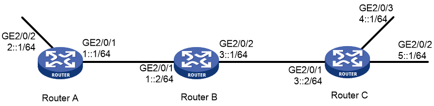

Figure 1 Network diagram for RIPng FRR
As shown in Figure 1, configure FRR on Router B by using a routing policy to specify a backup next hop. When the primary link fails, RIPng directs packets to the backup next hop. At the same time, RIPng calculates the shortest path based on the new network topology. Then, the device forwards packets over that path after network convergence.

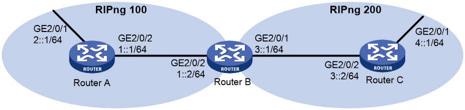

Example: Configuring RIPng route redistribution
As shown in Figure 3, Router B communicates with Router A through RIPng 100 and with Router C through RIPng 200.
Configure route redistribution on Router B, so the two RIPng processes can redistribute routes from each other.
Figure 3 Network diagram

Example: Configuring RIPng GR
As shown in Figure 4, Router A, Router B, and Router C learn IPv6 routing information through RIPng.
Configure Router A as the GR restarter. Configure Router B and Router C as the GR helpers to synchronize their routing tables with Router A by using GR.
Figure 4 Network diagram
1.     Configure IPv6 addresses for the interfaces. (Details not shown.)
2.     Configure RIPng on the routers to ensure the following: (Details not shown.)
¡     Router A, Router B, and Router C can communicate with each other at Layer 3.
¡     Dynamic route update can be implemented among them with RIPng.
3.     Enable RIPng GR on Router A.
<RouterA> system-view
[RouterA] ripng 1
[RouterA-ripng-1] graceful-restart
# Restart RIPng or trigger an active/standby process switchover, and then display GR status on Router A.
<RouterA> display ripng 1 graceful-restart
RIPng process: 1
 Graceful Restart capability    : Enabled
 Current GR state               : Normal
 Graceful Restart period        : 60  seconds
 Graceful Restart remaining time: 0   seconds

Example: Configuring RIPng FRR
As shown in Figure 6, Router A, Router B, and Router C run RIPng. Configure RIPng FRR so that when Link A becomes unidirectional, traffic can be switched to Link B immediately.
Figure 6 Network diagram
Device
Interface
IP address
Router A
GigabitEthernet 2/0/1
1::1/64
Router A
GigabitEthernet 2/0/2
2::1/64
Router A
Loopback 0
10::1/128
Router B
3::1/64
Router B
2::2/64
Router B
Loopback 0
20::1/128
Router C
1::2/64
Router C
3::2/64
1.     Configure IPv6 addresses for the interfaces on the routers. (Details not shown.)
2.     Configure RIPng on the routers to make sure Router A, Router B, and Router C can communicate with each other at the network layer. (Details not shown.)
3.     Configure RIPng FRR:
# Configure Router A.
[RouterA] ipv6 prefix-list abc index 10 permit 20::1 128
[RouterA] route-policy frr permit node 10
[RouterA-route-policy-frr-10] if-match ipv6 address prefix-list abc
[RouterA-route-policy-frr-10] apply ipv6 fast-reroute backup-interface gigabitethernet 2/0/1 backup-nexthop 1::2
[RouterA-route-policy-frr-10] quit
[RouterA] ripng 1
[RouterA-ripng-1] fast-reroute route-policy frr
[RouterA-ripng-1] quit
# Configure Router B.
<RouterB> system-view
[RouterB] ipv6 prefix-list abc index 10 permit 10::1 128
[RouterB] route-policy frr permit node 10
[RouterB-route-policy-frr-10] if-match ipv6 address prefix-list abc
[RouterB-route-policy-frr-10] apply ipv6 fast-reroute backup-interface gigabitethernet 2/0/1 backup-nexthop 3::2
[RouterB-route-policy-frr-10] quit
[RouterB] ripng 1
[RouterB-ripng-1] fast-reroute route-policy frr
[RouterB-ripng-1] quit
# Display the route 20::1/128 on Router A to view the backup next hop information.
[RouterA] display ipv6 routing-table 20::1 128 verbose
Summary count : 1
Destination: 20::1/128
   Protocol: RIPng
  Process ID: 1
   SubProtID: 0x0                        Age: 00h17m42s
        Cost: 1                   Preference: 100
       IpPre: N/A                 QosLocalID: N/A
         Tag: 0                        State: Inactive Adv
   OrigTblID: 0x0                    OrigVrf: default-vrf
     TableID: 0xa                     OrigAs: 0
       NibID: 0x22000003              LastAs: 0
      AttrID: 0xffffffff            Neighbor: FE80::34CD:9FF:FE2F:D02
       Flags: 0x41               OrigNextHop: FE80::34CD:9FF:FE2F:D02
       Label: NULL               RealNextHop: FE80::34CD:9FF:FE2F:D02
     BkLabel: NULL                 BkNextHop: FE80::7685:45FF:FEAD:102
     SRLabel: NULL                 Interface: GigabitEthernet2/0/2
   BkSRLabel: NULL               BkInterface: GigabitEthernet2/0/1
   Tunnel ID: Invalid            IPInterface: GigabitEthernet2/0/2
 BkTunnel ID: Invalid          BKIPInterface: GigabitEthernet2/0/1
     InLabel: NULL            ColorInterface: N/A
    SIDIndex: NULL          BKColorInterface: N/A
    FtnIndex: 0x0            TunnelInterface: N/A
TrafficIndex: N/A          BKTunnelInterface: N/A
   Connector: N/A                     PathID: 0x0
  SRTunnelID: Invalid
    SID Type: N/A                        NID: Invalid
    FlushNID: Invalid                  BkNID: Invalid
  BkFlushNID: Invalid              StatFlags: 0x0
         Exp: N/A
   VpnPeerId: N/A                       Dscp: N/A
         SID: N/A           OrigLinkID: 0x0
       BkSID: N/A           RealLinkID: 0x0
CommBlockLen: 0
