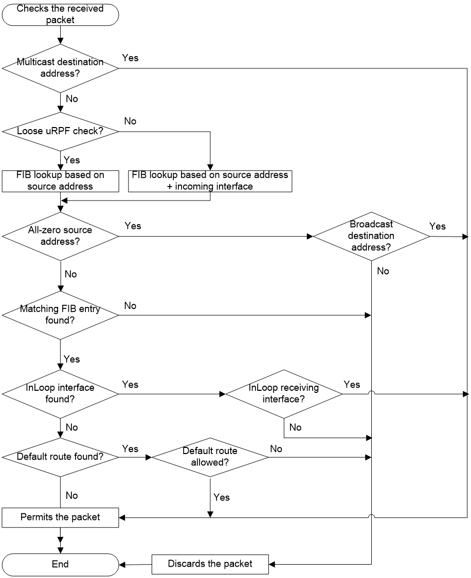

uRPF operation
Figure 2 shows how uRPF works.
Figure 2 uRPF work flow
1.     uRPF checks whether the received packet carries a multicast destination address:
¡     If yes, uRPF permits the packet.
¡     If no, uRPF proceeds to step 2.
2.     uRPF checks whether the uRPF check mode is loose:
¡     If yes, uRPF performs FIB lookup based on the source IP address and then proceeds to step 3.
¡     If no, uRPF performs FIB lookup based on the source IP address and the receiving interface and then proceeds to step 3.
3.     uRPF checks whether the source IP address is an all-zero address:
¡     If yes, uRPF checks whether the destination address of the packet is a broadcast address.
-     If yes, uRPF permits the packet.
-     If no, uRPF discards the packet.
¡     If no, uRPF proceeds to step 4.
4.     uRPF checks whether the source address matches a unicast route:
¡     If yes, uRPF proceeds to step 5.
¡     If no, uRPF discards the packet.
5.     uRPF checks whether the matching route is to the host itself (whether the output interface of the matching route is an InLoop interface):
¡     If yes, uRPF checks whether the receiving interface of the packet is an InLoop interface.
¡     If no, uRPF proceeds to step 6.
6.     uRPF checks whether the matching route is a default route:
¡     If yes, uRPF checks whether the allow-default-route keyword is configured to allow using the default route.
-     If yes, the packet is forwarded.
-     If no, the packet is discarded.
¡     If no, the packet is forwarded.
