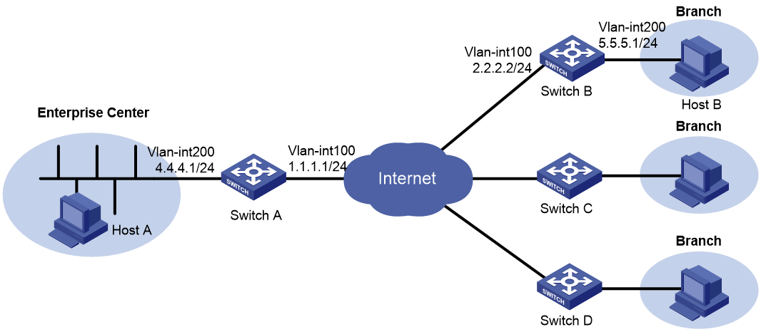

IPsec RRI
IPsec Reverse Route Injection (RRI) enables an IPsec tunnel gateway to automatically add and delete static routes destined for the protected private networks. It automatically adds the static routes when the IPsec SAs are established and deletes the static routes when the IPsec SAs are deleted. This greatly reduces the static route configuration work load on the gateway and increases the scalability of the IPsec VPN.
IPsec RRI is applicable to gateways that must provide many IPsec tunnels (for example, a headquarters gateway).
As shown in Figure 4, the traffic between the enterprise center and the branches are protected by IPsec. The gateway at the enterprise center is configured with static routes to route traffic to the IPsec-protected interfaces. It is difficult to add or modify static routes on the gateway at the enterprise center if the IPsec VPN has a large number of branches or if the network structure changes.
Figure 4 IPsec VPN
After you can enable IPsec RRI on the gateway, the gateway automatically adds a static route to the routing table each time an IPsec tunnel is established. The destination IP address is the protected private network, and the next hop is the remote IP address of the IPsec tunnel. Traffic destined for the peer end is routed to the IPsec tunnel interface and thereby protected by IPsec.
You can advertise the static routes created by IPsec RRI in the internal network, and the internal network device can use them to forward traffic in the IPsec VPN.
You can set preferences for the static routes created by IPsec RRI to implement flexible route management. For example, you can set the same preference for multiple routes to the same destination to implement load sharing, or you can set different preferences to implement route backup.
You can also set tags for the static routes created by IPsec RRI to implement flexible route control through routing policies.

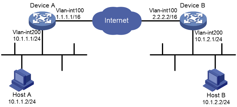

Mirror image ACLs
To make sure SAs can be set up and the traffic protected by IPsec can be processed correctly between two IPsec peers, create mirror image ACLs on the IPsec peers. As shown in Figure 5, ACL rules on Device B are mirror images of the rules on Device A. In this way, SAs can be created successfully for the traffic between Host A and Host C and for the traffic between Network 1 and Network 2.
Figure 5 Mirror image ACLs
If the ACL rules on IPsec peers do not form mirror images of each other, SAs can be set up only when both of the following requirements are met:
·     The range specified by an ACL rule on one peer is covered by its counterpart ACL rule on the other peer. As shown in Figure 6, the range specified by the ACL rule configured on Device A is covered by its counterpart on Device B.
·     The peer with the narrower rule initiates SA negotiation. If a wider ACL rule is used by the SA initiator, the negotiation request might be rejected because the matching traffic is beyond the scope of the responder. As shown in Figure 6, the SA negotiation initiated by Host A to Host C is accepted but the SA negotiations from Host C to Host A, from Host C to Host B, and from Host D to Host A are rejected.
Figure 6 Non-mirror image ACLs

Example: Configuring a manual mode IPsec tunnel for IPv4 packets
As shown in Figure 8, establish an IPsec tunnel between Switch A and Switch B to protect data flows between the switches. Configure the tunnel as follows:
·     Specify the encapsulation mode as tunnel, the security protocol as ESP, the encryption algorithm as AES-CBC-192, and the authentication algorithm as HMAC-SHA1.
·     Manually set up IPsec SAs.
Figure 8 Network diagram
1.     Configure Switch A:
# Configure an IP address for VLAN-interface 1.
<SwitchA> system-view
[SwitchA] interface vlan-interface 1
[SwitchA-Vlan-interface1] ip address 2.2.2.1 255.255.255.0
[SwitchA-Vlan-interface1] quit
# Configure an IPv4 advanced ACL to identify the data flows between Switch A and Switch B.
[SwitchA] acl advanced 3101
[SwitchA-acl-ipv4-adv-3101] rule 0 permit ip source 2.2.2.1 0 destination 2.2.3.1 0
[SwitchA-acl-ipv4-adv-3101] quit
# Create an IPsec transform set named tran1.
[SwitchA] ipsec transform-set tran1
# Specify the encapsulation mode as tunnel.
[SwitchA-ipsec-transform-set-tran1] encapsulation-mode tunnel
# Specify the security protocol as ESP.
[SwitchA-ipsec-transform-set-tran1] protocol esp
# Specify the ESP encryption and authentication algorithms.
[SwitchA-ipsec-transform-set-tran1] esp encryption-algorithm aes-cbc-192
[SwitchA-ipsec-transform-set-tran1] esp authentication-algorithm sha1
[SwitchA-ipsec-transform-set-tran1] quit
# Create a manual IPsec policy entry. Specify the policy name as map1 and set the sequence number to 10.
[SwitchA] ipsec policy map1 10 manual
# Specify ACL 3101.
[SwitchA-ipsec-policy-manual-map1-10] security acl 3101
# Specify IPsec transform set tran1.
[SwitchA-ipsec-policy-manual-map1-10] transform-set tran1
# Specify the remote IP address of the IPsec tunnel as 2.2.3.1.
[SwitchA-ipsec-policy-manual-map1-10] remote-address 2.2.3.1
# Configure inbound and outbound SPIs for ESP.
[SwitchA-ipsec-policy-manual-map1-10] sa spi outbound esp 12345
[SwitchA-ipsec-policy-manual-map1-10] sa spi inbound esp 54321
# Configure the inbound and outbound SA keys for ESP.
[SwitchA-ipsec-policy-manual-map1-10] sa string-key outbound esp simple abcdefg
[SwitchA-ipsec-policy-manual-map1-10] sa string-key inbound esp simple gfedcba
[SwitchA-ipsec-policy-manual-map1-10] quit
# Apply IPsec policy map1 to VLAN-interface 1.
[SwitchA-Vlan-interface1] ipsec apply policy map1
2.     Configure Switch B:
<SwitchB> system-view
[SwitchB] interface vlan-interface 1
[SwitchB-Vlan-interface1] ip address 2.2.3.1 255.255.255.0
[SwitchB-Vlan-interface1] quit
# Configure an IPv4 advanced ACL to identify the data flows between Switch B and Switch A.
[SwitchB] acl advanced 3101
[SwitchB-acl-ipv4-adv-3101] rule 0 permit ip source 2.2.3.1 0 destination 2.2.2.1 0
[SwitchB-acl-ipv4-adv-3101] quit
[SwitchB] ipsec transform-set tran1
[SwitchB-ipsec-transform-set-tran1] encapsulation-mode tunnel
[SwitchB-ipsec-transform-set-tran1] protocol esp
[SwitchB-ipsec-transform-set-tran1] esp encryption-algorithm aes-cbc-192
[SwitchB-ipsec-transform-set-tran1] esp authentication-algorithm sha1
[SwitchB-ipsec-transform-set-tran1] quit
# Create a manual IPsec policy entry. Specify the policy name as use1 and set the sequence number to 10.
[SwitchB] ipsec policy use1 10 manual
# Specify ACL 3101.
[SwitchB-ipsec-policy-manual-use1-10] security acl 3101
[SwitchB-ipsec-policy-manual-use1-10] transform-set tran1
# Specify the remote IP address of the IPsec tunnel as 2.2.2.1.
[SwitchB-ipsec-policy-manual-use1-10] remote-address 2.2.2.1
# Configure the inbound and outbound SPIs for ESP.
[SwitchB-ipsec-policy-manual-use1-10] sa spi outbound esp 54321
[SwitchB-ipsec-policy-manual-use1-10] sa spi inbound esp 12345
[SwitchB-ipsec-policy-manual-use1-10] sa string-key outbound esp simple gfedcba
[SwitchB-ipsec-policy-manual-use1-10] sa string-key inbound esp simple abcdefg
[SwitchB-ipsec-policy-manual-use1-10] quit
# Apply IPsec policy use1 to VLAN-interface 1.
[SwitchB-Vlan-interface1] ipsec apply policy use1
After the configuration is completed, an IPsec tunnel between Switch A and Switch B is established, and the traffic between the switches is IPsec-protected. This example uses Switch A to verify the configuration.
# Use the display ipsec sa command to display IPsec SAs on Switch A.
[SwitchA] display ipsec sa
Interface: Vlan-interface 1
  IPsec policy: map1
  Sequence number: 10
  Mode: manual
    Tunnel id: 549
    Encapsulation mode: tunnel
    Path MTU: 1443
    Tunnel:
        local  address: 2.2.2.1
        remote address: 2.2.3.1
    Flow:
        as defined in ACL 3101
    [Inbound ESP SA]
      SPI: 54321 (0x0000d431)
      Transform set: ESP-ENCRYPT-AES-CBC-192 ESP-AUTH-SHA1
      No duration limit for this SA
    [Outbound ESP SA]
      SPI: 12345 (0x00003039)
Example: Configuring an IKE-based IPsec tunnel for IPv4 packets

[SwitchA-ipsec-policy-isakmp-map1-10] remote-address 2.2.3.1
# Apply IKE profile profile1.
[SwitchA-ipsec-policy-isakmp-map1-10] ike-profile profile1
[SwitchA-ipsec-policy-isakmp-map1-10] quit
# Apply IPsec policy map1 to VLAN interface 1.
# Configure an IPv4 advanced ACL to identify data flows from Switch B to Switch A.
[SwitchB] acl number 3101
[SwitchB-acl-adv-3101] rule 0 permit ip source 2.2.3.1 0 destination 2.2.2.1 0
[SwitchB-acl-adv-3101] quit
# Create an IKE keychain named keychain1.
[SwitchB] ike keychain keychain1
# Specify 12345zxcvb!@#$%ZXCVB in plain text as the preshared key to be used with the remote peer at 2.2.2.1.
[SwitchB-ike-keychain-keychain1] pre-shared-key address 2.2.2.1 255.255.255.0 key simple 12345zxcvb!@#$%ZXCVB
[SwitchB-ike-keychain-keychain1] quit
# Create and configure the IKE profile named profile1.
[SwitchB] ike profile profile1
[SwitchB-ike-profile-profile1] keychain keychain1
[SwitchB-ike-profile-profile1] match remote identity address 2.2.2.1 255.255.255.0
[SwitchB-ike-profile-profile1] quit
# Create an IKE-based IPsec policy entry. Specify the policy name as use1 and set the sequence number to 10.
[SwitchB] ipsec policy use1 10 isakmp
# Apply ACL 3101.
[SwitchB-ipsec-policy-isakmp-use1-10] security acl 3101
# Apply IPsec transform set tran1.
[SwitchB-ipsec-policy-isakmp-use1-10] transform-set tran1
# Specify the local and remote IP addresses of the IPsec tunnel as 2.2.3.1 and 2.2.2.1.
[SwitchB-ipsec-policy-isakmp-use1-10] local-address 2.2.3.1
[SwitchB-ipsec-policy-isakmp-use1-10] remote-address 2.2.2.1
[SwitchB-ipsec-policy-isakmp-use1-10] ike-profile profile1
[SwitchB-ipsec-policy-isakmp-use1-10] quit
# Initiate a connection between Switch A and Switch B to trigger IKE negotiation. After IPsec SAs are successfully negotiated by IKE, the traffic between the two switches is IPsec-protected.

Example: Configuring IPsec RRI
As shown in Figure 11, branches access the enterprise center through an IPsec VPN.
Configure the IPsec VPN as follows:
·     Configure an IPsec tunnel between Switch A and each branch gateway (Switch B, Switch C, and Switch D) to protect traffic between subnets 4.4.4.0/24 and 5.5.5.0/24.
·     Configure the tunnels to use security protocol ESP, encryption algorithm DES, and authentication algorithm SHA1-HMAC-96. Use IKE for IPsec SA negotiation.
·     Configure IKE proposal to use the preshared key authentication method, encryption algorithm 3DES, and authentication algorithm HMAC-SHA1.
·     Configure IPsec RRI on Switch A to automatically create static routes to the branches based on the established IPsec SAs.
Figure 11 Network diagram
1.     Assign IPv4 addresses to the interfaces on the switches according to Figure 11. (Details not shown.)
2.     Configure Switch A:
# Create an IPsec transform set named tran1, and specify ESP as the security protocol, DES as the encryption algorithm, and HMAC-SHA-1-96 as the authentication algorithm.
[SwitchA-ipsec-transform-set-tran1] esp encryption-algorithm des
[SwitchA] ike profile profile1
[SwitchA-ike-profile-profile1] keychain key1
[SwitchA-ike-profile-profile1] match remote identity address 2.2.2.2 255.255.255.0
[SwitchA-ike-profile-profile1] quit
# Create an IPsec policy template named temp1. Specify IPsec transform set tran1 and IKE profile profile1 for the IPsec policy template.
[SwitchA] ipsec policy-template temp1 1
[SwitchA-ipsec-policy-template-temp1-1] transform-set tran1
[SwitchA-ipsec-policy-template-temp1-1] ike-profile profile1
# Enable IPsec RRI, set the preference to 100 and the tag to 1000 for the static routes created by IPsec RRI.
[SwitchA-ipsec-policy-template-temp1-1] reverse-route dynamic
[SwitchA-ipsec-policy-template-temp1-1] reverse-route preference 100
[SwitchA-ipsec-policy-template-temp1-1] reverse-route tag 1000
[SwitchA-ipsec-policy-template-temp1-1] quit
# Create an IKE-based IPsec policy entry by using IPsec policy template temp1. Specify the policy name as map1 and set the sequence number to 10.
[SwitchA] ipsec policy map1 10 isakmp template temp1
# Create an IKE proposal named 1, and specify 3DES as the encryption algorithm, HMAC-SHA1 as the authentication algorithm, and pre-share as the authentication method.
[SwitchA] ike proposal 1
[SwitchA-ike-proposal-1] encryption-algorithm 3des-cbc
[SwitchA-ike-proposal-1] authentication-algorithm sha
[SwitchA-ike-proposal-1] authentication-method pre-share
[SwitchA-ike-proposal-1] quit
# Create an IKE keychain named key1 and specify 123 in plain text as the preshared key to be used with the remote peer at 2.2.2.2.
[SwitchA] ike keychain key1
[SwitchA-ike-keychain-key1] pre-shared-key address 2.2.2.2 key simple 123
[SwitchA-ike-keychain-key1] quit
# Apply IPsec policy map1 to VLAN-interface 100.
[SwitchA-Vlan-interface100] ipsec apply policy map1
3.     Configure Switch B:
[SwitchB-ipsec-transform-set-tran1] esp encryption-algorithm des
# Configure IPv4 advanced ACL 3000 to identify traffic from subnet 5.5.5.0/24 to subnet 4.4.4.0/24.
[SwitchB] acl advanced 3000
[SwitchB-acl-ipv4-adv-3000] rule permit ip source 5.5.5.0 0.0.0.255 destination 4.4.4.0 0.0.0.255
[SwitchB-acl-ipv4-adv-3000] quit
[SwitchB-ike-profile-profile1] keychain key1
[SwitchB-ike-profile-profile1] match remote identity address 1.1.1.1 255.255.255.0
# Create an IKE-based IPsec policy entry named map1 and configure the following settings for the policy entry:
¡     Set the sequence number to 10.
¡     Specify transform set tran1 and ACL 3000.
¡     Specify the remote IP address for the tunnel as 1.1.1.1.
¡     Specify IKE profile profile1.
[SwitchB] ipsec policy map1 10 isakmp
[SwitchB-ipsec-policy-isakmp-map1-10] transform-set tran1
[SwitchB-ipsec-policy-isakmp-map1-10] security acl 3000
[SwitchB-ipsec-policy-isakmp-map1-10] remote-address 1.1.1.1
[SwitchB-ipsec-policy-isakmp-map1-10] ike-profile profile1
[SwitchB-Vlan-interface100] ipsec apply policy map1
Make sure Switch B has a route to the peer private network, with the outgoing interface as VLAN-interface 100.
4.     Configure Switch C and Switch D in the same way Switch B is configured.
1.     Verify that IPsec RRI can automatically create a static route from Switch A to Switch B:
# Initiate a connection from subnet 5.5.5.0/24 to subnet 4.4.4.0/24. IKE negotiation is triggered to establish IPsec SAs between Switch A and Switch B. (Details not shown.)
# Verify that IPsec SAs are established on Switch A.

As shown in Figure 12, IKE negotiates SAs for IPsec and transfers the SAs to IPsec, and IPsec uses the SAs to protect IP packets.
Figure 12 Relationship between IKE and IPsec

Example: Configuring main-mode IKE with preshared key authentication
As shown in Figure 15, configure an IKE-based IPsec tunnel between Switch A and Switch B to secure the communication between the switches.
·     Configure the two switches to use the default IKE proposal for the IKE negotiation.
·     Configure the two switches to use the preshared key authentication method for the IKE negotiation.
Figure 15 Network diagram
1.     Make sure Switch A and Switch B can reach each other.
[SwitchA-vlan-interface1] ip address 1.1.1.1 255.255.0.0
[SwitchA-vlan-interface1] quit
# Configure IPv4 advanced ACL 3101 to identify the traffic from Switch A to Switch B.
[SwitchA-acl-ipv4-adv-3101] rule 0 permit ip source 1.1.1.1 0 destination 2.2.2.2 0
# Set the packet encapsulation mode to tunnel.
# Use the ESP protocol for the IPsec transform set.
# Specify the encryption and authentication algorithms.
[SwitchA] ike keychain keychain1
# Specify 12345zxcvb!@#$%ZXCVB in plain text as the preshared key to be used with the remote peer at 2.2.2.2.
[SwitchA-ike-keychain-keychain1] pre-shared-key address 2.2.2.2 255.255.0.0 key simple 12345zxcvb!@#$%ZXCVB
[SwitchA-ike-keychain-keychain1] quit
# Create an IKE profile named profile1.
# Specify IKE keychain keychain1.
[SwitchA-ike-profile-profile1] keychain keychain1
# Configure a peer ID with the identity type as IP address and the value as 2.2.2.2/16.
[SwitchA-ike-profile-profile1] match remote identity address 2.2.2.2 255.255.0.0
# Create an IKE-based IPsec policy entry. Specify the policy name as map1 and set the sequence number to 10.
# Specify the remote IP address 2.2.2.2 for the IPsec tunnel.
[SwitchA-ipsec-policy-isakmp-map1-10] remote-address 2.2.2.2
# Specify ACL 3101 to identify the traffic to be protected.
[SwitchA-ipsec-policy-isakmp-map1-10] security acl 3101
# Specify IPsec transform set tran1 for the IPsec policy.
[SwitchA-ipsec-policy-isakmp-map1-10] transform-set tran1
# Specify IKE profile profile1 for the IPsec policy.
[SwitchB] interface Vlan-interface1
[SwitchB-Vlan-interface1] ip address 2.2.2.2 255.255.0.0
# Configure IPv4 advanced ACL 3101 to identify the traffic from Switch B to Switch A.
[SwitchB-acl-adv-3101] rule 0 permit ip source 2.2.2.2 0 destination 1.1.1.1 0
[SwitchB]ike keychain keychain1
# Specify 12345zxcvb!@#$%ZXCVB in plain text as the preshared key to be used with the remote peer at 1.1.1.1.
[SwitchB-ike-keychain-keychain1] pre-shared-key address 1.1.1.1 255.255.0.0 key simple 12345zxcvb!@#$%ZXCVB
# Configure a peer ID with the identity type as IP address and the value as 1.1.1.1/16.
[SwitchB-ike-profile-profile1] match remote identity address 1.1.1.1 255.255.0.0
# Specify the remote IP address 1.1.1.1 for the IPsec tunnel.
[SwitchB-ipsec-policy-isakmp-use1-10] remote-address 1.1.1.1

Example: Configuring aggressive-mode IKE with RSA signature authentication
This configuration example is not available when the device is operating in FIPS mode.
As shown in Figure 17, configure an IKE-based IPsec tunnel between Device A and Device B to secure the communication between subnet 10.1.1.0/24 and subnet 10.1.2.0/24.
Configure Device A and Device B to use aggressive mode for IKE negotiation phase 1 and use RSA signature authentication. Device A acts as the initiator, and the subnet where Device A resides uses IP addresses dynamically allocated.
Figure 17 Network diagram
1.     Configure Device A:
# Assign an IP address to each interface. (Details not shown.)
# Configure IPv4 advanced ACL 3101 to identify traffic from subnet 10.1.1.0/24 to subnet 10.1.2.0/24.
<DeviceA> system-view
[DeviceA] acl advanced 3101
[DeviceA-acl-ipv4-adv-3101] rule permit ip source 10.1.1.0 0.0.0.255 destination 10.1.2.0 0.0.0.255
[DeviceA-acl-ipv4-adv-3101] quit
[DeviceA] ipsec transform-set tran1
[DeviceA-ipsec-transform-set-tran1] encapsulation-mode tunnel
[DeviceA-ipsec-transform-set-tran1] protocol esp
[DeviceA-ipsec-transform-set-tran1] esp encryption-algorithm des-cbc
[DeviceA-ipsec-transform-set-tran1] esp authentication-algorithm sha1
[DeviceA-ipsec-transform-set-tran1] quit
# Create a PKI entity named entity1.
[DeviceA] pki entity entity1
# Set the common name to routera for the PKI entity.
[DeviceA-pki-entity-entity1] common-name routera
[DeviceA-pki-entity-entity1] quit
# Create a PKI domain named domain1.
[DeviceA] pki domain domain1
# Set the certificate request mode to auto and set the password to 123 for certificate revocation.
[DeviceA-pki-domain-domain1] certificate request mode auto password simple 123
# Set an MD5 fingerprint for verifying the validity of the CA root certificate.
[DeviceA-pki-domain-domain1] root-certificate fingerprint md5 50c7a2d282ea710a449eede6c56b102e
# Specify the trusted CA 8088.
[DeviceA-pki-domain-domain1] ca identifier 8088
# Specify the URL of the registration server for certificate request through the SCEP protocol. This example uses http://192.168.222.1:446/eadbf9af4f2c4641e685f7a6021e7b298373feb7.
[DeviceA-pki-domain-domain1] certificate request url http://192.168.222.1:446/eadbf9af4f2c4641e685f7a6021e7b298373feb7
# Specify the CA to accept certificate requests.
[DeviceA-pki-domain-domain1] certificate request from ca
# Specify the PKI entity for certificate request as entity1.
[DeviceA-pki-domain-domain1] certificate request entity entity1
# Specify RSA key pair rsa1 with the general purpose for certificate request.
[DeviceA-pki-domain-domain1] public-key rsa general name rsa1
[DeviceA-pki-domain-domain1] quit
[DeviceA] ike profile profile1
# Specify PKI domain domain1 for the IKE profile.
[DeviceA-ike-profile-profile1] certificate domain domain1
# Specify that IKE negotiation operates in aggressive mode.
[DeviceA-ike-profile-profile1] exchange-mode aggressive
# Set the local identity to FQDN name a.example.com.
[DeviceA-ike-profile-profile1] local-identity fqdn a.example.com
# Configure a peer ID with the identity type of FQDN name and the value of @example.com.
[DeviceA-ike-profile-profile1] match remote identity fqdn @example.com
[DeviceA-ike-profile-profile1] quit
# Create an IKE proposal named 10.
[DeviceA] ike proposal 10
# Specify the authentication algorithm as HMAC-MD5.
[DeviceA-ike-proposal-10] authentication-algorithm md5
# Specify the RSA authentication method.
[DeviceA-ike-proposal-10] authentication-method rsa-signature
[DeviceA-ike-proposal-10] quit
[DeviceA] ipsec policy map1 10 isakmp
# Specify remote IP address 2.2.2.2 for the IPsec tunnel.
[DeviceA-ipsec-policy-isakmp-map1-10] remote-address 2.2.2.2
[DeviceA-ipsec-policy-isakmp-map1-10] transform-set tran1
[DeviceA-ipsec-policy-isakmp-map1-10] security acl 3101
[DeviceA-ipsec-policy-isakmp-map1-10] ike-profile profile1
[DeviceA-ipsec-policy-isakmp-map1-10] quit
[DeviceA] interface vlan-interface 100
[DeviceA-Vlan-interface100] ipsec apply policy map1
[DeviceA-Vlan-interface100] quit
# Configure a static route to the subnet where Host B resides. This example uses 2.2.2.1 as the next hop IP address.
[DeviceA] ip route-static 10.1.2.0 255.255.255.0 2.2.2.1

Example: Configuring aggressive-mode IKE with NAT traversal
Device A is behind the NAT device. Hosts behind Device A use public IP address 3.3.3.1 to access the external network.
Configure an IKE-based IPsec tunnel between Device A and Device B to secure the communication between subnet 10.1.1.0/24 and subnet 10.1.2.0/24.
·     Configure Device A and Device B to use the default IKE proposal for the aggressive IKE negotiation to set up the IPsec SAs.
·     Configure the two devices to use the preshared key authentication method for the IKE negotiation phase 1.
Figure 18 Network diagram
# Configure IPv4 advanced ACL 3000 to identify traffic from subnet 10.1.1.0/24 to subnet 10.1.2.0/24.

As shown in Figure 19, IKEv2 uses two exchanges during the initial exchange process: IKE_SA_INIT and IKE_AUTH, each with two messages.
·     IKE_SA_INIT exchange—Negotiates IKE SA parameters and exchanges keys.
·     IKE_AUTH exchange—Authenticates the identity of the peer and establishes IPsec SAs.
After the four-message initial exchanges, IKEv2 sets up one IKE SA and one pair of IPsec SAs. For IKEv1 to set up one IKE SA and one pair of IPsec SAs, it must go through two phases that use a minimum of six messages.
To set up one more pair of IPsec SAs within the IKE SA, IKEv2 goes on to perform an additional two-message exchange—the CREATE_CHILD_SA exchange. One CREATE_CHILD_SA exchange creates one pair of IPsec SAs. IKEv2 also uses the CREATE_CHILD_SA exchange to rekey IKE SAs and Child SAs.
IKEv2 uses the INFORMATIONAL exchange to convey control messages about errors and notifications.
Figure 19 IKEv2 Initial exchange process

IKEv2 configuration examples
Example: IKEv2 with preshared key authentication configuration example
As shown in Figure 20, configure an IKE-based IPsec tunnel between Device A and Device B to secure the communication between subnet 10.1.1.0/24 and subnet 10.1.2.0/24.
·     Configure Device A and Device B to use the default IKEv2 proposal and the default IKEv2 policy in IKEv2 negotiation to set up IPsec SAs.
·     Configure the two devices to use the preshared key authentication method in IKEv2 negotiation.
Figure 20 Network diagram

Example: IKEv2 with RSA signature authentication configuration example
As shown in Figure 21, configure an IKE-based IPsec tunnel between Device A and Device B to secure the communication between subnet 10.1.1.0/24 and subnet 10.1.2.0/24.
Configure Device A and Device B to use IKEv2 negotiation and RSA signature authentication. Device A acts as the initiator, and the subnet where Device A resides uses IP addresses dynamically allocated.
Figure 21 Network diagram

Example: IKEv2 with NAT traversal configuration example
As shown in Figure 22, Device A is behind the NAT device. Configure an IKE-based IPsec tunnel between Device A and Device B to secure the communication between subnet 10.1.1.0/24 and subnet 10.1.2.0/24.
Figure 22 Network diagram
[DeviceA-acl-ipv4-adv-3101] rule 0 permit ip source 10.1.1.0 0.0.0.255 destination 10.1.2.0 0.0.0.255
# Create an IPsec transform set named transform1.
[DeviceA] ipsec transform-set transform1
[DeviceA-ipsec-transform-set-transform1] protocol esp
[DeviceA-ipsec-transform-set-transform1] esp encryption-algorithm 3des-cbc
[DeviceA-ipsec-transform-set-transform1] esp authentication-algorithm md5
[DeviceA-ipsec-transform-set-transform1] quit
# Create an IKEv2 keychain named keychain1.
[DeviceA] ikev2 keychain keychain1
# Create an IKEv2 peer named peer1.
[DeviceA-ikev2-keychain-keychain1] peer peer1
# Specify peer IP address 2.2.2.2/16.
[DeviceA-ikev2-keychain-keychain1-peer-peer1] address 2.2.2.2 16
# Specify the peer ID, which is IP address 2.2.2.2.
[DeviceA-ikev2-keychain-keychain1-peer-peer1] identity address 2.2.2.2
# Specify 123 in plain text as the preshared key to be used with the peer.
[DeviceA-ikev2-keychain-keychain1-peer-peer1] pre-shared-key plaintext 123
[DeviceA-ikev2-keychain-keychain1-peer-peer1] quit
[DeviceA-ikev2-keychain-keychain1] quit
# Create an IKEv2 profile named profile1.
[DeviceA] ikev2 profile profile1
# Specify IKEv2 keychain keychain1.
[DeviceA-ikev2-profile-profile1] keychain keychain1
# Set the local ID to FQDN name a.example.com.
[DeviceA-ikev2-profile-profile1] identity local fqdn a.example.com
# Specify the peer ID that the IKEv2 profile matches. The peer ID is IP address 2.2.2.2/16.
[DeviceA-ikev2-profile-profile1] match remote identity address 2.2.2.2 255.255.0.0
# Set both the local and remote authentication methods to preshared key.
[DeviceA-ikev2-profile-profile1] authentication-method local pre-share
[DeviceA-ikev2-profile-profile1] authentication-method remote pre-share
[DeviceA-ikev2-profile-profile1] quit
# Create an IKE-based IPsec policy entry. Specify the policy name as policy1 and set the sequence number to 1.
[DeviceA] ipsec policy policy1 1 isakmp
[DeviceA-ipsec-policy-isakmp-policy1-1] remote-address 2.2.2.2
# Specify IPsec transform set transform1 for the IPsec policy.
[DeviceA-ipsec-policy-isakmp-policy1-1] transform-set transform1
[DeviceA-ipsec-policy-isakmp-policy1-1] security acl 3101
# Specify IKEv2 profile profile1 for the IPsec policy.
[DeviceA-ipsec-policy-isakmp-policy1-1] ikev2-profile profile1
[DeviceA-ipsec-policy-isakmp-policy1-1] quit
# Apply IPsec policy policy1 to VLAN-interface 100.
[DeviceA-Vlan-interface100] ipsec apply policy policy1
# Configure a static route to the subnet where Host B resides. This example uses 1.1.1.2 as the next hop IP address.
[DeviceA] ip route-static 10.1.2.0 255.255.255.0 1.1.1.2
2.     Configure Device B:
# Configure IPv4 advanced ACL 3101 to identify traffic from subnet 10.1.2.0/24 to subnet 10.1.1.0/24.
[DeviceA-acl-ipv4-adv-3101] rule 0 permit ip source 10.1.2.0 0.0.0.255 destination 10.1.1.0 0.0.0.255
<DeviceB> system-view
[DeviceB] ipsec transform-set transform1
[DeviceB-ipsec-transform-set-transform1] protocol esp
[DeviceB-ipsec-transform-set-transform1] esp encryption-algorithm 3des-cbc
[DeviceB-ipsec-transform-set-transform1] esp authentication-algorithm md5
[DeviceB-ipsec-transform-set-transform1] quit
[DeviceB]ikev2 keychain keychain1
[DeviceB-ikev2-keychain-keychain1] peer peer1
# Specify peer IP address 3.3.3.1/16.
[DeviceB-ikev2-keychain-keychain1-peer-peer1] address 3.3.3.1 16
# Specify the peer ID, which is IP address 1.1.1.1.
[DeviceB-ikev2-keychain-keychain1-peer-peer1] identity address 3.3.3.1
[DeviceB-ikev2-keychain-keychain1-peer-peer1] pre-shared-key plaintext 123
[DeviceB-ikev2-keychain-keychain1-peer-peer1] quit
[DeviceB-ikev2-keychain-keychain1] quit
[DeviceB] ikev2 profile profile1
[DeviceB-ikev2-profile-profile1] keychain keychain1
# Specify the peer ID that the IKEv2 profile matches. The peer ID is FQDN name a.example.com.
[DeviceB-ikev2-profile-profile1] match remote identity fqdn a.example.com
[DeviceB-ikev2-profile-profile1] authentication-method local pre-share
[DeviceB-ikev2-profile-profile1] authentication-method remote pre-share
[DeviceB-ikev2-profile-profile1] quit
# Create an IPsec policy template entry. Specify the template name as template1 and set the sequence number to 1.
[DeviceB] ipsec policy-template template1 1
# Specify remote IP address 3.3.3.1 for the IPsec tunnel.
[DeviceB-ipsec-policy-template-template1-1] remote-address 3.3.3.1
[DeviceB-ipsec-policy-template-template1-1] security acl 3101
# Specify IPsec transform set transform1 for the IPsec policy template.
[DeviceB-ipsec-policy-template-template1-1] transform-set transform1
# Specify IKEv2 profile profile1 for the IPsec policy template.
[DeviceB-ipsec-policy-template-template1-1] ikev2-profile profile1
[DeviceB-ipsec-policy-template-template1-1] quit
# Create an IKE-based IPsec policy entry by using IPsec policy template template1. Specify the policy name as policy1 and set the sequence number to 1.
[DeviceB] ipsec policy policy1 1 isakmp template template1
[DeviceB] interface vlan-interface 100
[DeviceB-Vlan-interface100] ipsec apply policy policy1
[DeviceB-Vlan-interface100] quit
# Configure a static route to the subnet where Host A resides. This example uses 2.2.2.1 as the next hop IP address.
[DeviceB] ip route-static 10.1.1.0 255.255.255.0 2.2.2.1
# Initiate a connection from subnet 10.1.1.0/24 to subnet 10.1.2.0/24 to trigger IKEv2 negotiation. After IPsec SAs are successfully negotiated by IKEv2, traffic between the two subnets is IPsec-protected.
# Display the IKEv2 SA on Device A.
[DeviceA] display ikev2 sa
Tunnel ID   Local                       Remote                      Status
  1        1.1.1.1/4500                  2.2.2.2/4500                  EST
Status:
IN-NEGO: Negotiating, EST: Established, DEL:Deleting
 [DeviceA] display ikev2 sa verbose
  Tunnel ID: 45
  Local IP/Port: 1.1.1.1/4500
  Remote IP/Port: 2.2.2.2/4500
  Outside VRF: -
  Inside VRF: -
  Local SPI: 372228d699a33c63
  Remote SPI: 75c537621b4a7190
  Local ID type: ID_FQDN
  Local ID: a.example.com
  Remote ID type: ID_IPV4_ADDR
  Remote ID: 2.2.2.2
  Auth sign method: Pre-shared key
  Auth verify method: Pre-shared key
  Integrity algorithm: SHA1
  PRF algorithm: SHA1
  Encryption algorithm: AES-CBC-128
  Life duration: 86400 secs
  Remaining key duration: 86177 secs
  Diffie-Hellman group: MODP1536/Group5
  NAT traversal: Detected
  DPD: Interval 0 secs, retry interval 0 secs
  Transmitting entity: Initiator
  Local window: 1
  Remote window: 1
  Local request message ID: 2
  Remote request message ID: 0
  Local next message ID: 2
  Remote next message ID: 0
# Display the IPsec SAs on Device A.
[DeviceA] display ipsec sa
Interface: Vlan-interface100
  IPsec policy: policy1
  Sequence number: 1
  Mode: ISAKMP
    Tunnel id: 0
    Perfect Forward Secrecy:
    Path MTU: 1435
    Tunnel:
        local  address: 1.1.1.1
        remote address: 2.2.2.2
    Flow:
        sour addr: 10.1.1.0/255.255.255.0  port: 0  protocol: ip
        dest addr: 10.1.2.0/255.255.255.0  port: 0  protocol: ip
    [Inbound ESP SAs]
      SPI: 830667426 (0x3182faa2)
      Connection ID: 605590388736
      Transform set: ESP-ENCRYPT-3DES-CBC ESP-AUTH-MD5
      SA duration (kilobytes/sec): 1843200/3600
      SA remaining duration (kilobytes/sec): 1843200/2313
      Max received sequence-number:
      Anti-replay check enable: Y
      Anti-replay window size: 64
      UDP encapsulation used for NAT traversal: Y
      Status: Active
    [Outbound ESP SAs]
      SPI: 3516214669 (0xd1952d8d)
      Connection ID: 227633266689
      Max sent sequence-number:
      Status: Active
