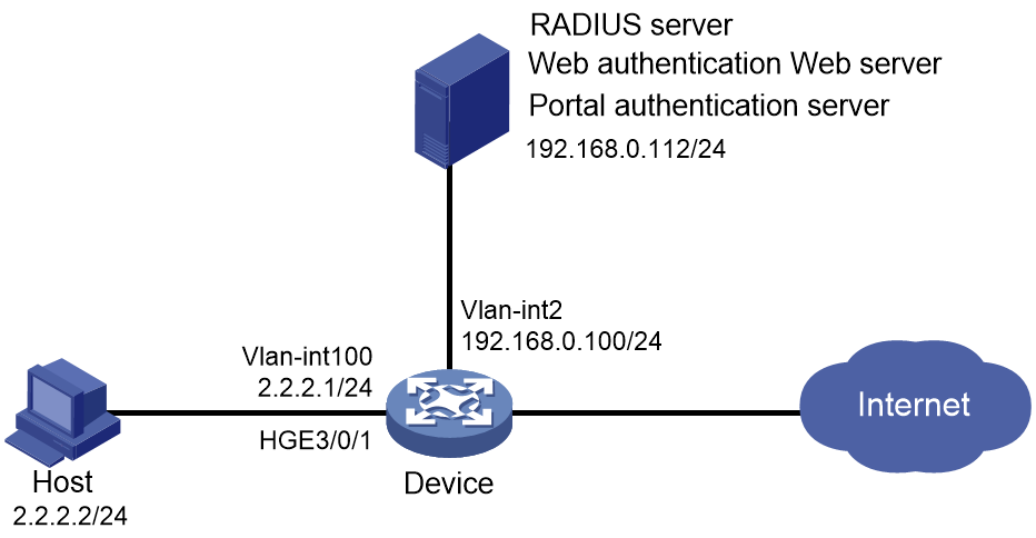

Web authentication system
A typical Web authentication system consists of four basic components: authentication client, access device, Web server for Web authentication, and AAA server.
Figure 1 Web authentication system using the local portal server
Authentication client
An authentication client is a Web browser that runs HTTP or HTTPS on the user endpoint.
Access device
An access device has the following functions:
·     Redirects all user HTTP or HTTPS requests that do not match authentication-free rules to the Web authentication page before authentication.
·     Interacts with the AAA server to complete authentication, authorization, and accounting. For more information about AAA, see "Configuring AAA."
·     Allows users that pass authentication to access authorized network resources.
A Web server pushes the Web authentication page to authentication clients and obtains user authentication information (username and password).
A Web server for Web authentication can be a local Web server or a remote Web server. A local Web server is usually integrated into the access device. A remote Web server is a portal Web server.
Portal authentication server
Web authentication uses a portal authentication server as the authentication server, which exchanges client authentication information with the access device.
AAA server
An AAA server interacts with the access device to implement user authentication, authorization, and accounting. A RADIUS server can perform authentication, authorization, and accounting for Web authentication users. An LDAP server can perform authentication for Web authentication users.

Web authentication configuration examples
Example: Configuring local Web authentication by using the AAA local authentication method
As shown in Figure 5, the host is directly connected to the device through HundredGigE 3/0/1.
Configure local Web authentication on HundredGigE 3/0/1, and configure the device to perform local authentication and authorization for the local Web authentication users.
Configure a local Web server on the device that uses the IP address of Loopback 0 and port 80 for Web authentication. Configure the device to use HTTP to transfer the authentication data.
Figure 5 Network diagram
Create VLANs, assign IP addresses to the VLAN interfaces, and assign interfaces to the VLANs.
1.     Configure a local user:
# Create a local network access user named localuser.
<Device>system-view
[Device] local-user localuser class network
# Set the password for user localuser.
[Device-luser-network-localuser] password simple 123456TESTplat&!
# Authorize the user to use LAN access services.
[Device-luser-network-localuser] service-type lan-access
[Device-luser-network-localuser] quit
2.     Configure an ISP domain:
# Create an ISP domain named local.
[Device] domain local
# Configure the ISP domain to perform local authentication, authorization, and accounting for LAN access users.
[Device-isp-local] authentication lan-access local
[Device-isp-local] authorization lan-access local
[Device-isp-local] accounting lan-access local
[Device-isp-local] quit
3.     Configure a local portal Web service:
# Create an HTTP-based local portal Web service and enter its view.
[Device] portal local-web-server http
# Specify file defaultfile.zip as the default authentication page file for the local portal Web service. (Make sure the authentication page file already exists in the root directory of the storage medium on the device.)
[Device-portal-local-websvr-http] default-logon-page defaultfile.zip
# Specify the HTTP listening port number as 80 for the portal Web service.
[Device–portal-local-websvr-http] tcp-port 80
[Device-portal-local-websvr-http] quit
4.     Configure local Web authentication:
# Create a local Web server named user for Web authentication and enter its view.
[Device] web-auth server user
# Configure the redirection URL for the local Web server as http://20.20.0.1:80/portal/.
[Device-web-auth-server-user] url http://20.20.0.1:80/portal/
# Specify the IP address of the local Web server as 20.20.0.1 (the IP address of Loopback 0) and the port number as 80.
[Device-web-auth-server-user] ip 20.20.0.1 port 80
[Device-web-auth-server-user] quit
# Specify ISP domain local as the Web authentication domain.
[Device] interface hundredgige 3/0/1
[Device-HundredGigE3/0/1] web-auth domain local
# Enable Web authentication that uses local Web server user.
[Device-HundredGigE3/0/1] web-auth enable apply server user
[Device-HundredGigE3/0/1] quit
# Display online Web authentication user information after user localuser passes Web authentication.
[Device] display web-auth user
  Total online web-auth users: 1
User Name: localuser
  MAC address: acf1-df6c-f9ad
  Access interface: HundredGigE3/0/1
  Initial VLAN: 100
  Authorization VLAN: N/A
  Authorization ACL ID: N/A
  Authorization microsegment ID: N/A
