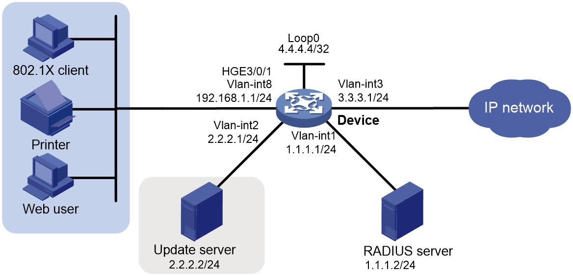

Typical network of triple authentication
Triple authentication is suitable for a LAN that comprises terminals that require different authentication services, as shown in Figure 1. The triple authentication-enabled access port can perform MAC authentication for the printer, 802.1X authentication for the PC installed with the 802.1X client, and Web authentication for the Web user.
Figure 1 Triple authentication network diagram

Triple authentication configuration examples
Example: Configuring basic triple authentication
As shown in Figure 2, the terminals are connected to the device to access the IP network. Configure triple authentication on the device's Layer 2 interface that connects to the terminals. A terminal passing one of the three authentication methods, 802.1X authentication, Web authentication, and MAC authentication, can access the IP network.
·     Assign IP addresses on subnet 192.168.1.0/24 to the terminals.
·     Use the remote RADIUS server to perform authentication, authorization, and accounting. Configure the device to send usernames carrying no ISP domain names to the RADIUS server.
·     Configure the local Web authentication server on the device to use listening IP address 4.4.4.4. Configure the device to send a default authentication page to the Web user and forward authentication data by using HTTP.
Figure 2 Network diagram
1.     Make sure that the terminals, the server, and the device can reach each other. (Details not shown.)
2.     Configure the RADIUS server to provide normal authentication, authorization, and accounting for users. In this example, configure the following on the RADIUS server:
¡     An 802.1X user with username userdot.
¡     A Web authentication user with username userpt.
¡     A MAC authentication user with a username and password both being the MAC address of the printer f07d6870725f.

·     Configure VLAN 2 as the authentication failure VLAN. Users failing authentication are added to this VLAN.
Figure 3 Network diagram
1.     Make sure the terminals, the servers, and the device can reach each other. (Details not shown.)
¡     An authorization VLAN (VLAN 3).
3.     Configure the IP address of the update server as an authentication-free IP address.

1.     Verify that the Web user can pass Web authentication.
# On the Web user terminal, use a Web browser to access an external network and then enter the correct username and password on the authentication page http://4.4.4.4/portal/logon.html. (Details not shown.)
# Use the display web-auth user command to display information about online users.
[Device] display web-auth user
  Total online web-auth users: 1
User Name: userpt
  MAC address: 6805-ca17-4a0b
  Access interface: HundredGigE3/0/1
  Initial VLAN: 8
  Authorization VLAN: 3
  Authorization ACL ID: N/A
2.     Verify that the printer can pass MAC authentication.
# Connect the printer to the network. (Details not shown.)
# Display information about online MAC authentication users.
[Device] display mac-authentication connection
Total connections: 1
Slot ID: 1
User MAC address: f07d-6870-725f
Username: f07d6870725f
User access state: Successful
Authentication domain: triple
Initial VLAN: 8
Authorization untagged VLAN: 3
Authorization tagged VLAN: N/A
Authorization VSI: N/A
Authorization CAR: N/A
Authorization URL: N/A
Termination action: Default
Session timeout period: N/A
Online from: 2015/01/04 18:01:43
Online duration: 0h 0m 2s
3.     Verify that the 802.1X user can pass 802.1X authentication.
# On the 802.1X client, initiate 802.1X authentication and enter the correct username and password. (Details not shown.)
# Display information about online 802.1X users.
[Device] display dot1x connection
Slot ID: 1
User MAC address: 7446-a091-84fe
Username: userdot
IPv4 address: 3.3.3.3
Authentication method: CHAP
Initial VLAN: 8
Authorization tagged VLAN list: N/A
Online from: 2015/01/04 18:13:01
Online duration: 0h 0m 14s
4.     Verify that users that pass authentication have been assigned authorization VLANs.
# Display MAC-VLAN entries of online users.
[Device] display mac-vlan all
  The following MAC VLAN addresses exist:
  S:Static  D:Dynamic
  MAC ADDR         MASK             VLAN ID   PRIO   STATE
  6805-ca17-4a0b   ffff-ffff-ffff   3         0      D
  f07d-6870-725f   ffff-ffff-ffff   3         0      D
  7446-a091-84fe   ffff-ffff-ffff   3         0      D
  Total MAC VLAN address count:3
5.     Verify that online users have been assigned IP addresses.
[Device] display dhcp server ip-in-use
IP address       Client-identifier/    Lease expiration          Type
                  Hardware address
 3.3.3.111        01f0-7d68-7072-5f     Jan  4 18:14:17 2015      Auto:(C)
 3.3.3.2          0168-05ca-174a-0b     Jan  4 18:15:01 2015      Auto:(C)
 3.3.3.3          0174-46a0-9184-fe     Jan  4 18:15:03 2015      Auto:(C)
6.     When a terminal fails authentication, it is added to VLAN 2. You can use the previous display commands to display the MAC-VLAN entry and IP address of the terminal. (Details not shown.)
