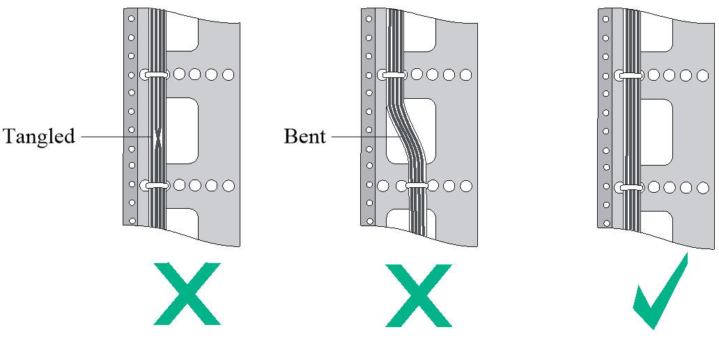

·     Bind and route the cables neatly inside the rack, and make sure the cables are not kinked or bent. Do not tie cables or bundles in a knot.
Figure 8-1 Correct and incorrect cable binding

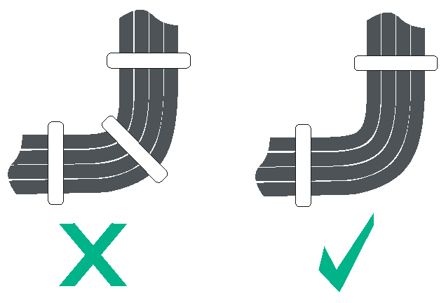

·     When you bend cables, bind cables as shown in Figure 8-2. To avoid cable core break due to excessive stress, do not tie up the cables in the bending area. The cable bend radius at connectors must be at least 5 times the cable diameter, and must be at least twice the cable diameter away from the connectors.
Figure 8-2 Binding the cables

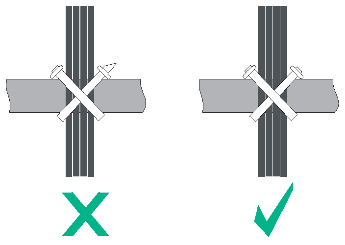

·     After binding the cables, cut the excess from the ties, leaving no sharp or angular tips, as shown in Figure 8-3.
Figure 8-3 Cutting the cable ties

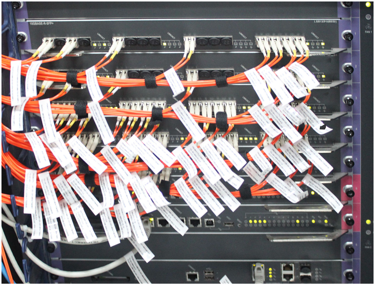

Figure 8-4 Network cable management

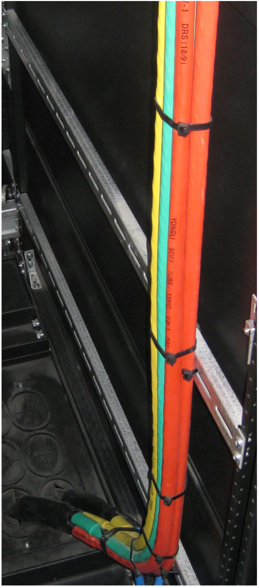

Figure 8-6 Power cord management
