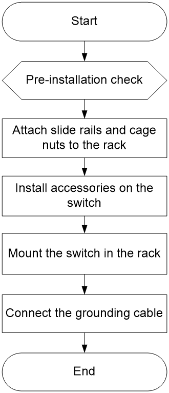

Installation flow
Figure 2-1 Installation flow
Table 2-1 Installation flow description
Step
Remarks
Confirming installation preparations
Preparations before installation
Attaching slide rails and cage nuts to the rack
·     For how to install slide rails, see "Installing slide rails."
·     For how to install cage nuts, see "Installing cage nuts for attaching mounting brackets"
Installing the accessories on the switch
Accessories to be installed on the chassis:
·     For how to mount brackets and cable management brackets, see "Installing mounting brackets and cable management brackets."
·     For how to install an air filter (optional), see "(Optional) Installing an air filter."
Mounting the switch in the rack
N/A
Connecting the grounding cable
N/A

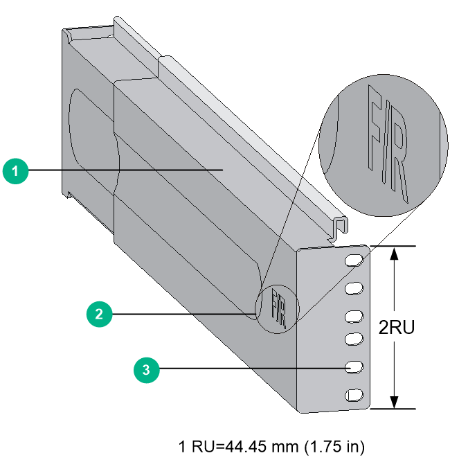

1.     Read the signs on the slide rails (see Table 2-2) to avoid installation mistakes.
Figure 2-2 Right slide rail
(1) Guide rail
(2) Sign
(3) Installation hole
Table 2-2 Description for signs on the slide rails
Sign
Meaning
Remarks
F/L
Front end of the left slide rail
Mount this end to the front left rack post.
F/R
Front end of the right slide rail
Mount this end to the front right rack post.

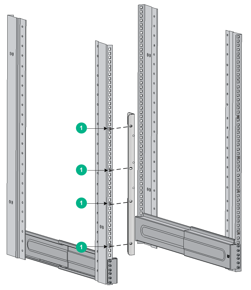

2.     Mark the position on the rack for installing the slide rail.
¡     Make sure the bottom edge of the slide rail aligns with the middle of the narrower metal area between holes on a rack post, as shown in Figure 2-3.
¡     Each rack post requires six screws to secure the slide rail. You only need to mark the uppermost square hole and lowermost square hole for installation.
¡     Mark the square holes at the same height on the other three rack posts.
One rack unit has three holes, the middle of which is an auxiliary installation hole, and the other two are standard installation holes. You can distinguish them by the space between each two holes. The space between a standard installation hole and an auxiliary installation hole is larger than the space between two adjacent standard installation holes.

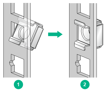

3.     Install six cage nuts on the square holes in each rack post, as shown in Figure 2-4.
Figure 2-4 Installing a cage nut

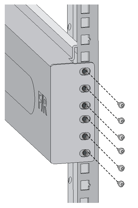

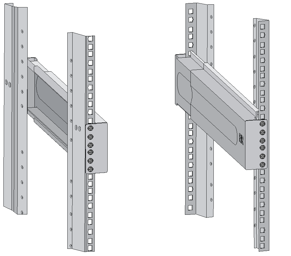

4.     Align the installation holes on the front end of a slide rail with the cage nuts on the front rack post, and secure them with screws, as shown in Figure 2-5.
Figure 2-5 Attaching a slide rail to a front rack post
5.     Keep the slide rail horizontally and adjust its length until the installation holes on the rear end of the slide rail touch the cage nuts on the rear rack post. Then fasten the screws.
TIP
TIP:
Install a screw in each mounting hole of the slide rail to ensure its weight bearing capacity.
6.     Repeat step 4 and step 5 to install the other slide rail. Make sure the two slide rails are at the same height so the device can be placed on them horizontally.
Figure 2-6 Installed slide rails

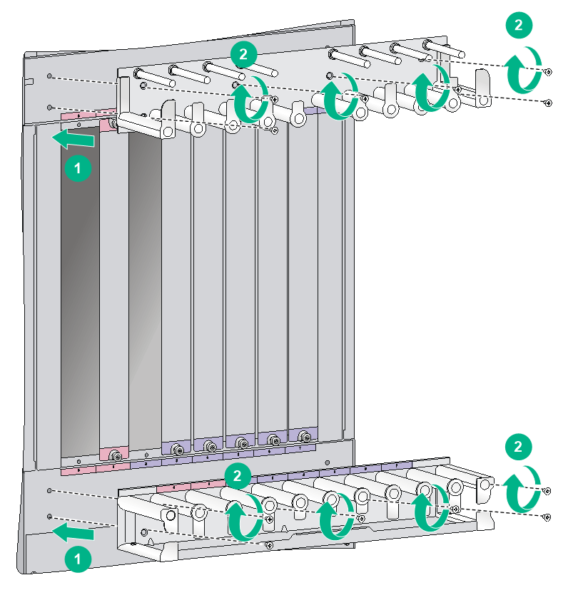

Installing the cable management brackets on the S7506E-V
The S7506E-V has two cable management brackets: the one with a tray is installed at the lower part of the switch, and the one without a tray is installed at the upper part of the switch. They are installed in the same way.
To install a cable management bracket:
1.     Unpack the cable management brackets.
2.     Attach the cable management bracket to the chassis, and align the screws with the screw holes in the chassis, as shown in Figure 2-8.
3.     Fasten the screws.

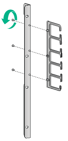

Installing the cable management brackets on other models
For the models except the S7506E-V, install the cable management bracket on the left mounting bracket, as shown in Figure 2-9. The switch is supplied with two mounting brackets, and the one with the cable management bracket screw holes is the left mounting bracket.
Figure 2-9 Attaching the cable management bracket to the left mounting bracket

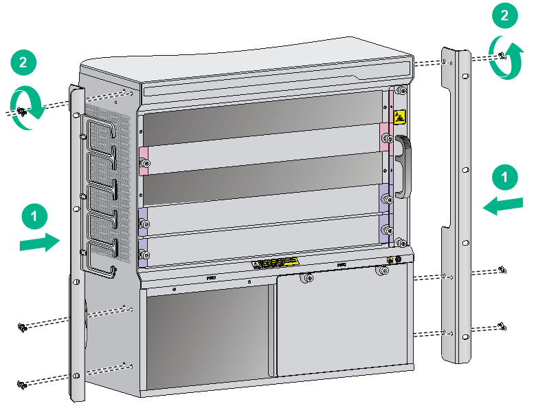

Installing the mounting brackets
Before installing the switch in the rack, install the mounting brackets to the chassis, as shown in Figure 2-10.
·     S7506E-VFacing the front of the switch, mount the left and right mounting brackets to the two sides of the switch.
·     Other modelsFacing the front of the switch, mount the mounting bracket with a cable management bracket to the left of the switch, and mount the mounting bracket without a cable management bracket to the right of the switch (where the fan tray is located).
Figure 2-10 Installing the mounting brackets (S7503E)

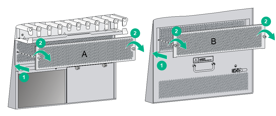

Air filters are optional for the S7500E switches. If you have ordered air filters, install the air filters before mounting the switch in the rack.
·     S7506E-VAn air filter is available at both front and rear of the switch, and can be installed in the same way. For the installation procedures, see "Installing an air filter on an S7506E-V."
·     Other modelsThe air filter is located at the left of the chassis. For the installation procedures, see "Installing an air filter on other chassis models."
1.     Unpack the air filter.
2.     As shown by callout 1 in Figure 2-11, attach the air filter to the intake vents on the front panel or rear panel, and then insert the captive screws into the screw holes on the chassis.
3.     Faster the captive screws, as shown by callout 2 in Figure 2-11.
Figure 2-11 Installing an air filter on an S7506E-V
(1) Front air filter
(2) Rear air filter

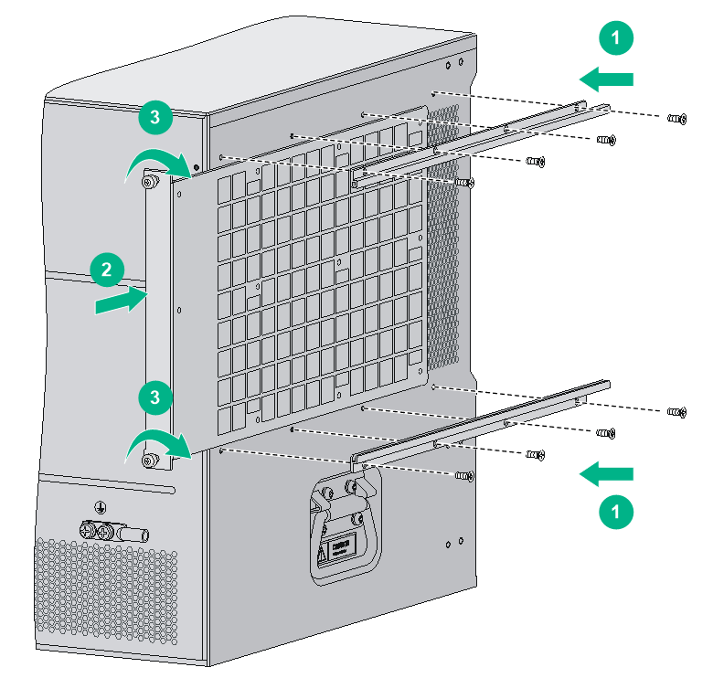

1.     Unpack the air filter and fastening strips.
2.     Align the screw holes in the fastening strip with the screw holes in the chassis, insert the screws into the screw holes, and then fasten the screws clockwise with a screwdriver, as shown in by callout 1 in Figure 2-12.
3.     Push the air filter in between the fastening strips, as shown by callout 2 in Figure 2-12.
4.     Fasten the captive screws, as shown by callout 3 in Figure 2-12.
Figure 2-12 Installing an air filter (S7503E)

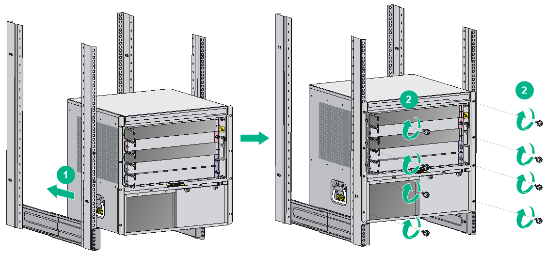

To mount the switch in the rack:
1.     Face the rear of the chassis towards the front of the rack.
2.     Use a minimum of two people to lift the switch until the bottom of the switch is a little higher than the slide rails on the rack.
3.     Place the switch on the slide rails and slide the switch along the slide rails until the mounting brackets on the switch touch the front rack posts.
4.     Secure the chassis to the rack with mounting screws.

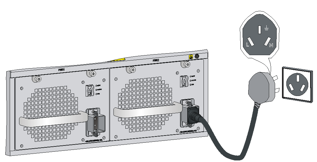

Grounding the switch through the AC power supply
CAUTION
CAUTION:
·     Make sure the AC power supply uses a three-wire cable with a protection wire, and the AC power cord is reliably grounded at the power distribution room or AC power supply transformer side.
·     Make sure the AC receptacle on the switch is correctly connected to the AC power supply.
If the switch is AC powered and no grounding strip is available at the installation site, you can ground the switch through the AC power supply, as shown in Figure 2-15.
Figure 2-15 Grounding the switch through the AC power supply

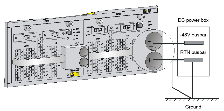

Grounding the switch through the RTN wire of a DC power supply
CAUTION
CAUTION:
Make sure the RTN busbar in the equipment room is reliably grounded.
If the switch is powered by a –48 VDC power supply and no grounding strip is available at the installation site, you can ground the switch through the return (RTN) wire of the DC power supply, as shown in Figure 2-16.
Figure 2-16 Grounding the switch through the RTN wire of the DC power supply
