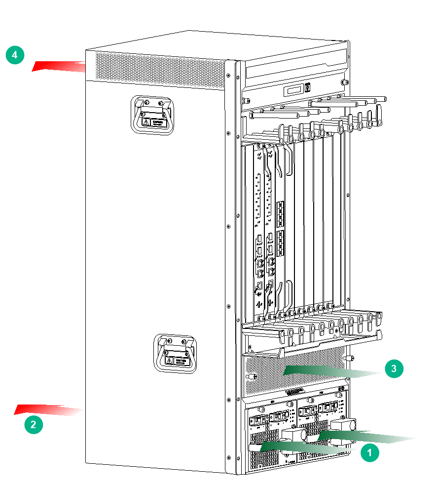

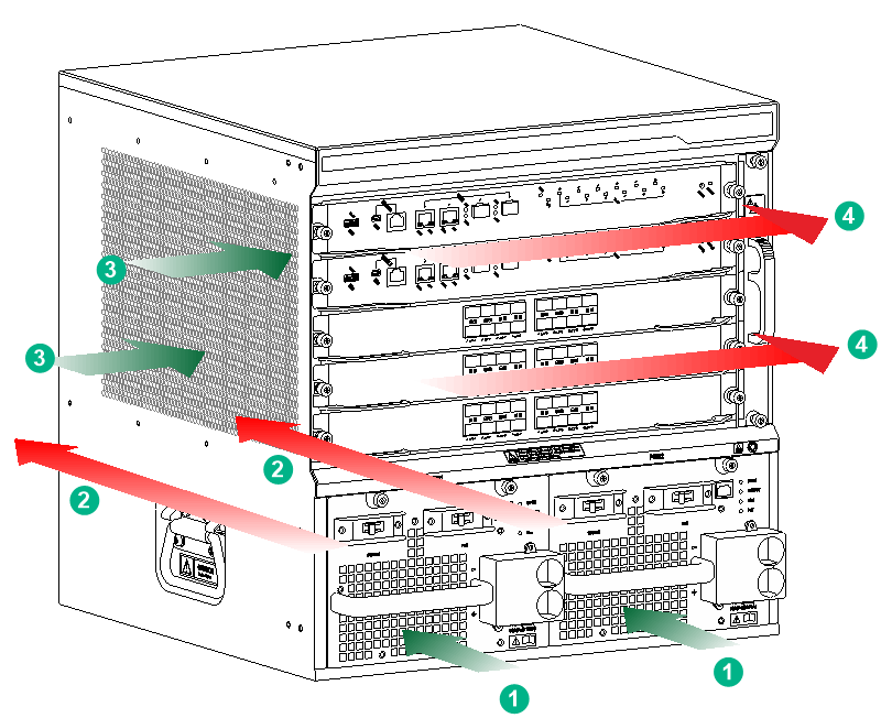

Cooling
For adequate heat dissipation, plan the installation site according to the airflow of your switch, and adhere to the following requirements:
·     Leave a minimum clearance of 10 cm (3.94 in) around the air inlet and outlet vents.
·     The rack for installing the switch has a good cooling system.
·     The installation site has a good cooling system.
Figure 1-1 Airflow through the S7506E-V chassis
(1) Direction of the airflow into the power modules
(2) Direction of the airflow out of the power modules
(3) Direction of the airflow into the chassis
(4) Direction of the airflow out of the chassis
Figure 1-2 Airflow through other models of the S7500E chassis (S7503E)

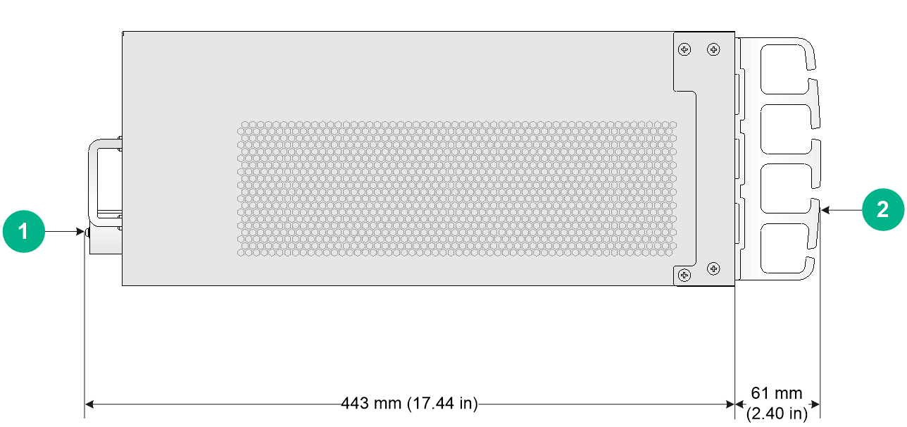

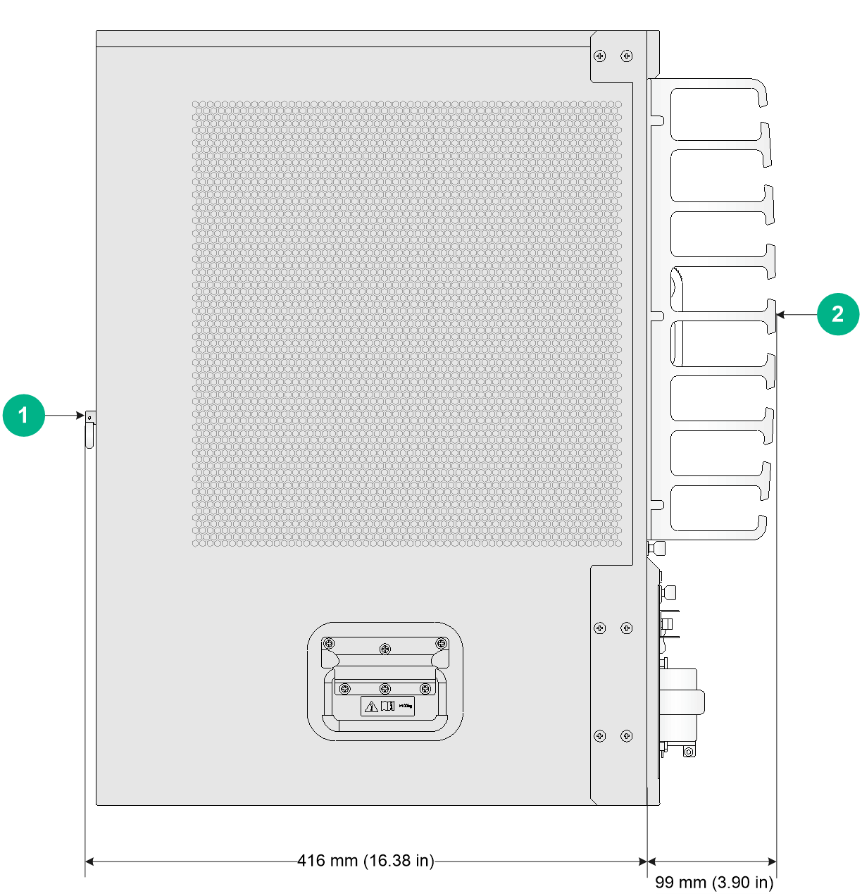

·     Make sure the rack has enough space to accommodate the switch. See Table 1-6 for rack requirements. For more information about chassis dimensions, see H3C S7500E Switch Series Hardware Information and Specifications.
Table 1-6 Switch dimensions and rack requirements
Model
Chassis depth
Rack requirements
S7502E
Total depth of 504 mm (19.84 in)
·     61 mm (2.40 in) from the rack-facing surface of the mounting brackets to the front ends of the cable management brackets
·     443 mm (17.44 in) from the rack-facing surface of the mounting brackets to the PoE terminal block cover at the chassis rear
·     A minimum of 0.8 m (2.62 ft) in depth
·     A minimum of 61 mm (2.40 in) between the front rack posts and the front door.
·     A minimum of 444 mm (17.48 in) between the front rack posts and the rear door.

·     S7506E-S
·     S7506E
·     S7506E (non-PoE)
·     S7506E-MF
·     S7506E-MF (non-PoE)
Total depth of 515 mm (20.28 in)
·     99 mm (3.90 in) from the rack-facing surface of the mounting brackets to the front ends of the cable management brackets
·     416 mm (16.38 in) from the rack-facing surface of the mounting brackets to the handle at the rear of the chassis
·     A minimum of 100 mm (3.94 in) between the front rack posts and the front door.
·     A minimum of 420 mm (16.54 in) between the front rack posts and the rear door.

The signal cables and power cords are routed through the front of the chassis. If you use power cords that have a conductor cross-section area of a minimum of 16 sq mm (0.02 sq in), leave more space between the front rack posts and the front door as appropriate.
Figure 1-3 shows the depth of the S7502E and S7503E-S switches. Figure 1-4 shows the depth of the S7503E-M, S7503E, S7506E-S, S7506E (non-PoE), S7506E, S7506E-MF, S7506E-MF (non-PoE), S7506E-V, and S7510E switches.
Figure 1-3 Switch depth (S7503E-S switch)
(1) PoE terminal block cover at the chassis rear
(2) Cable management bracket
Figure 1-4 Switch depth (S7506E switch)
(1) Handle at the chassis rear
