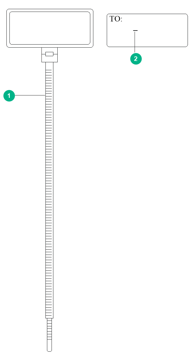

Labels for power cords
A label for power cords should be attached to the identification plate on a cable tie that binds the power cords. The identification plate has an embossment of 0.2 × 0.6 mm (0.008 × 0.02 in) around (symmetric on both sides), and the area in the middle is for affixing the label.
A mark "TO:" is located at the upper left corner of the label to identify the peer end of the cord on which the label is affixed. You can write the position of the peer device, control cabinet, distribution box, or power socket. The meaning of the dividing lines is the same as labels for signal cables.
Figure 7-2 Label for power cords
(1) Cable tie
(2) Dividing line on the label

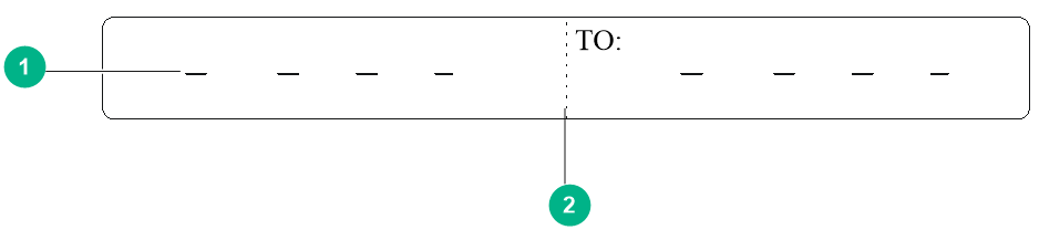

Generic labels
A generic label is bar-shaped with fixed dimensions. It is applicable to both signal cables and power cords. A mark "TO:" is located at the upper left corner in the right area of the label to identify the peer end of the cable on which the label is affixed. The meaning of the dividing lines is the same as labels for signal cables.
Figure 7-3 Generic label
(1) Dividing line on the label
(2) Cut dotted line

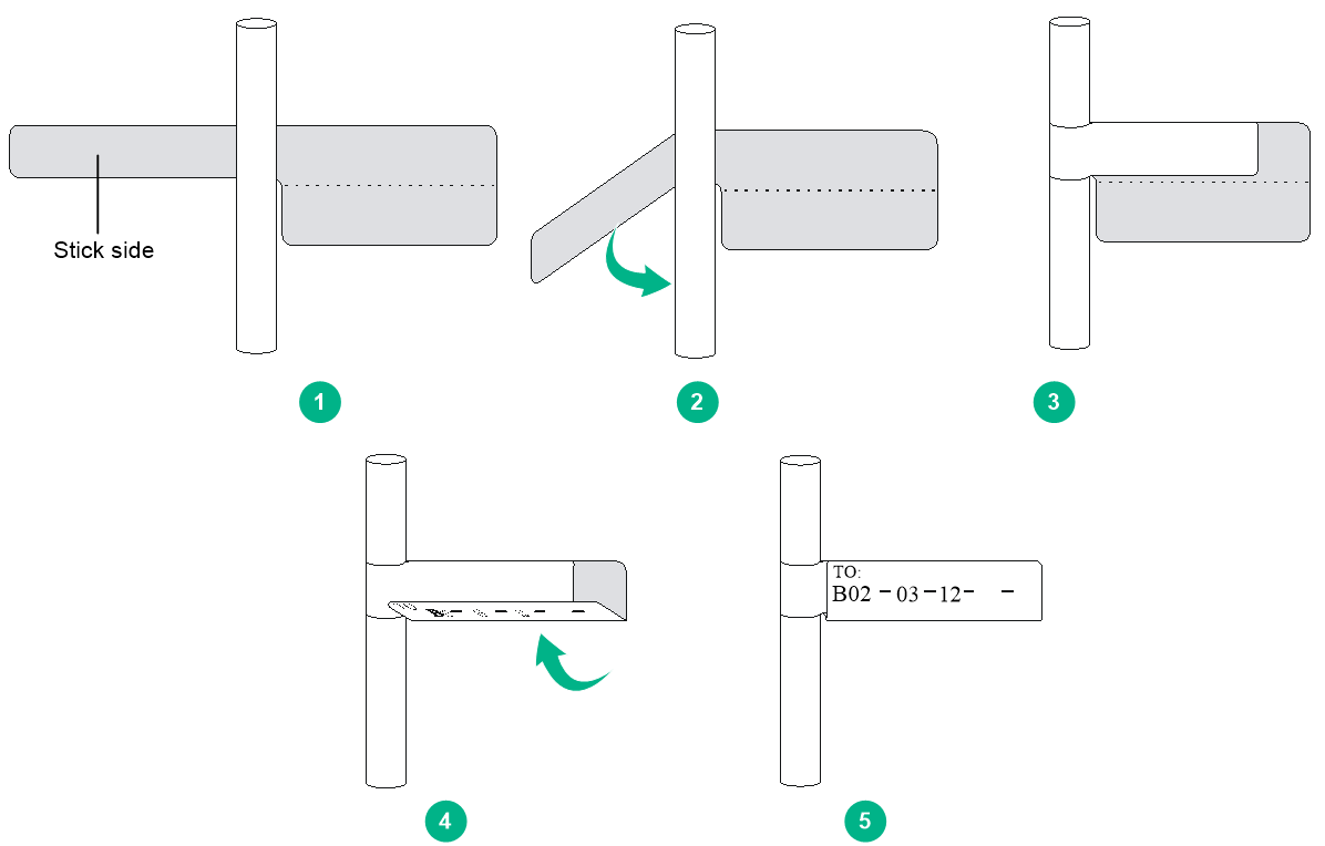

Affixing labels
After printing or writing a label, remove the label from the bottom page and affix it to the signal cable, or the identification plate of the power cord.

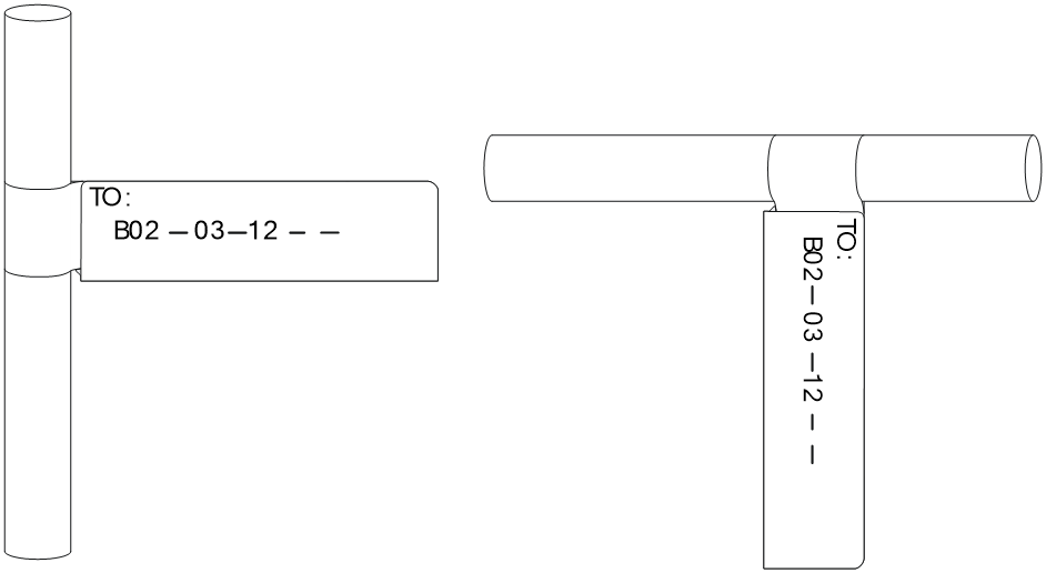

Affixing a label to a signal cable
Typically, a label is affixed 2 cm (0.79 in) away from the connector on a signal cable. You can affix the label to other positions as needed. Figure 7-4 shows how to affix a label when a cable is laid vertically.
Figure 7-4 Affixing a label

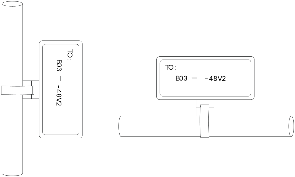

Figure 7-5 shows the affixed labels when the cable is laid vertically and horizontally.
Figure 7-5 Affixed labels

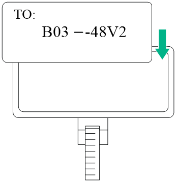

Affixing a label to a power cord
Stick the label to the recessed rectangular area on the identification plate. You can stick the label to either side of the identification plate. Be sure to affix the labels on the same side of the identification plates.
A cable tie is bundled 2 cm (0.79 in) away from the connector. You can affix the label to other positions as needed. Figure 7-4 shows how to affix a label when a cable is laid horizontally.
Figure 7-6 Affixing a label
Bind cable ties on both ends of a cable. After the bundling, the finished identification plate should be on top of the cable in horizontal cabling, or on the right side of the cable in vertical cabling. Make sure the label is facing out, as shown in Figure 7-7.
Figure 7-7 Affixed labels

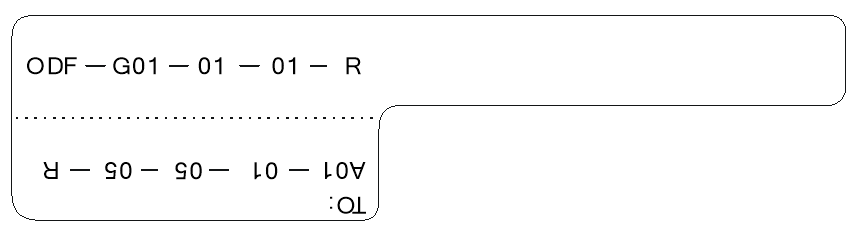

·     Labels for a fiber that connects the device and the optical distribution frame (ODF)
Table 7-3 Information on labels affixed to the fiber between the device and the ODF

Figure 7-11 Example of a label on an optical fiber between the device and the ODF
¡     ODF-G01-01-01-R—The local end of the optical fiber is connected to the optical receiving terminal on Row 01, Column 01 of the ODF in Row G Column 01 in the equipment room.
¡     A01-01-05-05-R—The peer end of the optical fiber is connected to Optical Receiving Interface 5 on Slot 05, Chassis 01 in the cabinet on Row A, Column 01 in the equipment room.

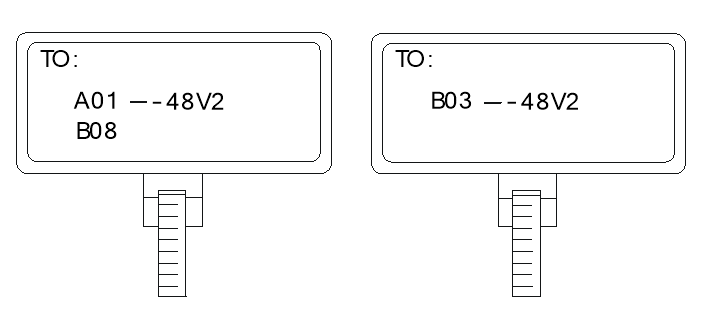

Engineering labels for DC power cords
These labels are affixed to DC cords that provide power for racks, and the protection grounding cables including the –48V, PGND, and BGND cables. The labels for DC power cords are affixed to one side of the identification plates on cable ties.
Table 7-4 Information on labels affixed to DC power cords
Content
Meaning
MN(BC)-–48Vn
·     Loaded cabinet side—Only MN is used to identify the cabinet number (row number and column number in the equipment room).
·     Power cabinet side—MN identifies the row and column number of the power distribution equipment like the control cabinet and distribution box. BC identifies the row and column number of the 48V connector (if there is no row number or column number, or the connector can be identified without them, BC can be omitted). RTN and PGND have no row and column number for identification.
·     n—Power port number in down-top and left-right order, in the range of 1 to 3.
MN(BC)-RTN
MN(BC)-PGND
The label only carries location information about the peer equipment, control cabinet, or distribution box, while the information of the local end is not necessary. Table 7-4 lists the information of two –48V power supplies on the label. The information for other DC voltages (such as 24V, 60V) should be given in similar methods.
Make sure labels are affixed in the correct direction. After the cable ties are bundled onto the cable, the identification plates with the labels should face up. The text on the labels in the same cabinet should be in the same direction, as shown in Figure 7-12.
Figure 7-12 Example of labels on a DC power cord
·     A01/B08––48V2 (loaded cabinet side)—The power cord is –48V2 DC supply, which is from the 8th connecter on the second row of –48V bus bar in the cabinet on Row A, and Column 1 in the equipment room.
·     B03––48V2 (distribution box side)—The power cord is –48V2 DC supply, which is from the loaded cabinet on Row B, Column 03 in the equipment room.
In the power distribution box (or the first power cabinet of a row in the transmission equipment room), every terminal block on the –48V connector bar has a numeric identification. For example, in the above label of "A01/B08--48V2", "08" (or sometimes "8") is the numeric identification of the terminal block.
PGND and RTN are two copper bars, on which the terminal blocks are short-circuited, so which terminal is connected makes no difference. You only need to give the row and column numbers of the power distribution box, instead of giving the specific serial number of the terminal block on the copper bar. For example, if the label on the loaded cabinet side is "A01-RTN", it means that the power cord is an RTN that connects RTN copper bar in the power distribution box on Row A, Column 01 in the equipment room. Information on the labels for PGND cables should be given in the similar way.

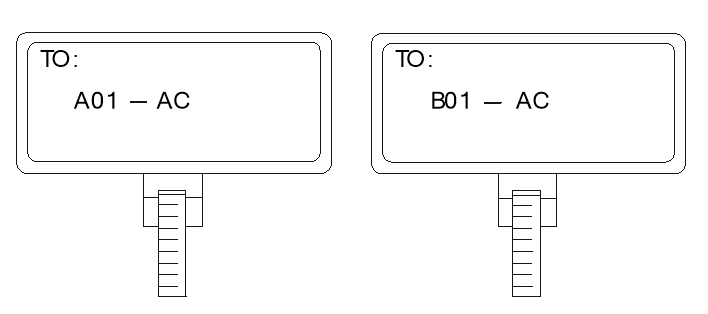

Engineering labels for AC power cords
These labels are affixed to the AC cords that provide power for cabinets and protection grounding cables, including POWER, RTN, and PGND cables. The 220 VAC cables and related PGND and RTN cables are covered with insulating sheath, so the labels only need to contain "AC" and the cabinet number. The labels for AC power cords are affixed to one side of the identification plates on cable ties.
Table 7-5 Information on labels affixed to AC power cords
Content
Meaning
MN-AC
MN: Rack number (row number and column number in the equipment room) or the location of the socket where the power is led in.
The location of the socket is marked according to onsite situation. If the sockets can be identified by row number and column number, they can be numbered following the same rule for the rack number. Otherwise, specify the detailed locations to avoid confusing with other sockets.
The label only carries location information about the peer equipment and the power socket, while information of the local end is not necessary. Make sure labels are affixed in the correct direction. That is, after the cable ties are bundled onto the cable, the identification plates with the labels should face up, and the text on the labels in the same cabinet must be in the same direction, as shown in Figure 7-13:
Figure 7-13 Example of labels on an AC power cord
·     A01-AC (loaded cabinet side)—The power cord is connected to the socket of Row A and Column 01 in the equipment room.
·     B01-AC (power socket side)—The power cord is connected to the loaded cabinet of Row B, Column 01 in the equipment room.

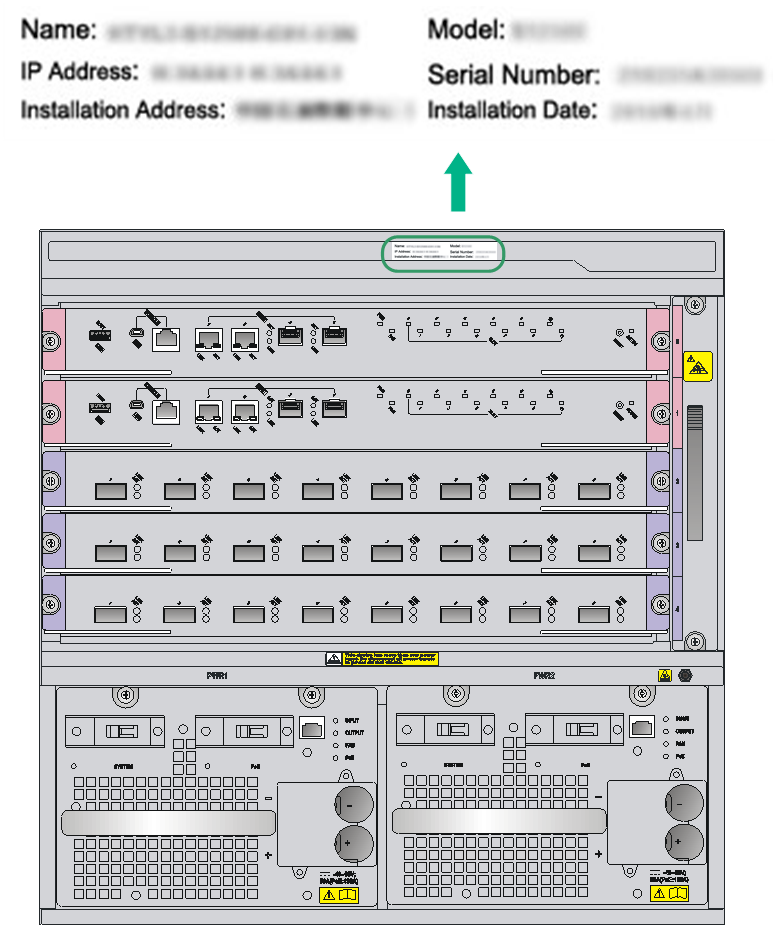

Engineering labels for devices
These labels can be affixed to any device.
You can fill in the device name, model, IP address, serial number, installation address, and installation date on a device label.
Figure 7-14 Example of a device label
