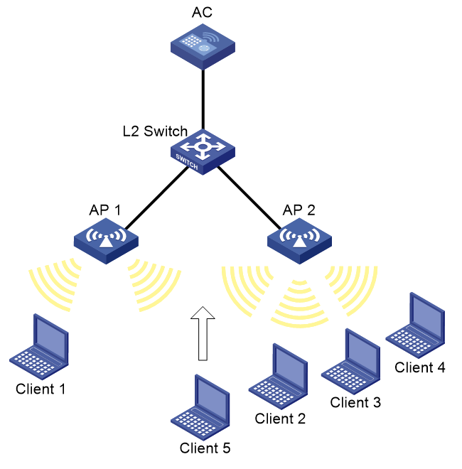

Networking scheme
As shown in Figure 1, AP 1 and AP 2 are managed by the same AC and they each have Radio 1 and Radio 2 enabled. Radio load balancing is enabled in the WLAN. Radio 1 and Radio 2 of AP 1 have reached their maximum load. When Client 6 tries to associate with a radio on AP 1, the AC rejects the association request and directs Client 6 to other radios.
Figure 1 Network diagram

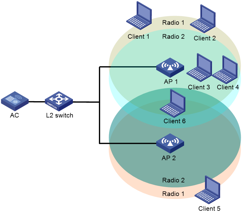

Example: Configuring WLAN radio load balancing
As shown in Figure 2, AP 1 and AP 2 are managed by the AC and the clients can discover the APs. Client 1 associates with AP 1, and Client 2 through Client 4 associate with AP 2.
Configure the AP to perform radio load balancing on radios of AP 1 and AP 2 when the following conditions are met:
·     The number of sessions on a radio of an AP reaches 3.
·     The session gap between the radio and the radio that has the fewest sessions reaches 2.
Figure 2 Network diagram

# Verify that the AC performs radio load balancing on radios of AP 1 and AP 2 when the following conditions are met:
·     The number of sessions on radio 2 of AP 2 reaches 3.
·     The session gap between radio 2 of AP 2 and radio 2 of AP 1 reaches 2. (Details not shown.)
# Verify that radio 2 on AP 1 and radio 2 on AP 2 are load balanced by using the display wlan client command. (Details not shown.)
