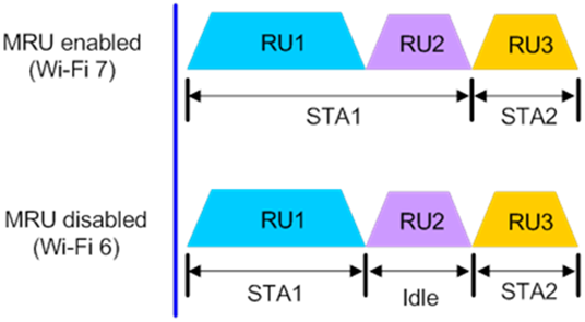

Configuring MRU
Multiple Resource Unit (MRU) is a technology that increases the spectral resource usage rate, mainly used in multi-user scenarios.
In Wi-Fi6, each user can only use one RU. In Wi-Fi7, the concept of MRU is introduced to allow a single user to use multiple RUs. As shown in Figure 4, under the same bandwidth, MRU allows a single client to occupy multiple RUs simultaneously when data is being transmitted to two users at the same time. This improves spectral resource usage and reduces latency. In Wi-Fi 6, a single client can only use the single RU resource allocated to it, resulting in a waste of spectral resources.
This feature takes effect only on 802.11be, 802.11gbe, and 802.11abe radios. Changing the radio mode to another mode cancels the configuration.
1. Enter system view.
2. Enter AP view.
wlan ap ap-name
3. Enter radio view.
radio radio-id
4. Configure MRU.
mru { disable | enable }
By default, MRU is disabled.

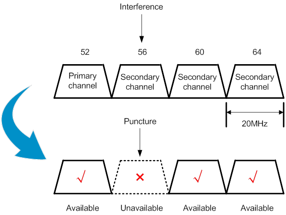

Configuring preamble puncturing
The preamble puncturing technology enables data transmission using discontinuous channels to improve channel utilization efficiency. It is mainly used in scenarios with channel interference.
Without preamble puncturing, as shown in Figure 5, if the bandwidth mode is 80 MHz and interference is encountered on channel 56, the system uses the 20 MHz bandwidth mode instead for transmission. With preamble puncturing enabled, as shown in Figure 6, the interfered portion (channel 56) is punctured and shielded, and the remaining channels 52, 60, and 64 are bundled together for information transmission. Although the AP is still working in the 80 MHz bandwidth mode, the interfered channel is put in Null state (idle state) in actual transmission.
Preamble static puncturing refers to the software designating the puncturing positions based on the bandwidth mode and the position of the primary channel.
Figure 5 Without preamble puncturing
Figure 6 With preamble puncturing
Preamble puncturing takes effect only when the bandwidth mode is 80 MHz or higher.
This feature takes effect only on 802.11be and 802.11abe radios. Changing the radio mode to another mode cancels the configuration.
