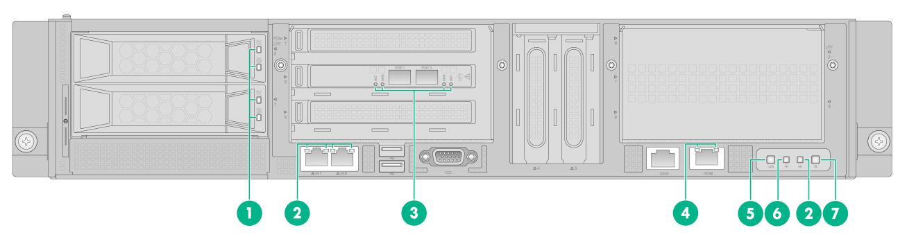

Front panel LEDs
Figure1-1 Front panel LEDs
(1) Drive LEDs (upper: Fault/UID LED, lower: Present/Active LED)
(2) 1000BASE-T port LEDs
(3) SFP+ port LEDS
(4) HDM dedicated network port LED
(5) UID button/LED
(6) Health LED
(7) Power on/standby button and system power LED
Table1-1 Drive LED description
Fault/UID LED status
Present/Active LED status
Description
Flashing amber
Steady green/Flashing green
A drive failure is predicted. Replace the drive immediately.
Steady amber
The drive is faulty. Replace the drive immediately.
Steady blue
The drive is operating correctly and is selected by the RAID controller.
Off
Flashing green
The drive is performing a RAID migration or rebuilding, or the system is reading or writing data to the drive.
Off
Steady green
The drive is present but no data is being read or written to the drive.
Off
Off
The drive is not securely installed or a drive failure has occurred.
Table1-2 SFP+ port LED description
SFP+ port LED
LINK
ACT
Description
Steady on
Flashing
A link is present on the port, and the port is receiving or sending data.
Steady on
Off
A link is present on the port, and the port is not receiving or sending data.
Off
Off
No link is present on the port.
Table1-3 Description for other LEDs and button
Button/LED
Status
1000Base-T Ethernet port LED
·     Steady green—A link is present on the port.
·     Flashing green—The port is receiving or sending data.
·     Off—No link is present on the port.
HMD dedicated network port LED
UID button LED
·     Steady blue—UID LED is activated. The UID LED can be activated by using the following methods:
¡     Press the UID button LED.
¡     Enable UID LED from HDM.
·     Flashing blue:
¡     Slow flashing—The firmware is being upgraded or the system is being managed from HDM.
¡     Fast flashing—HDM is restarting. To restart HDM, press the UID button LED for eight seconds.
·     Off—UID LED is not activated.
Health LED
·     Steady green—The system is operating correctly, or a minor alarm has occurred.
·     Flashing green—Initializing HDM.
·     Slow flashing amber—A pre-alarm has occurred.
·     Fast flashing amber—A general alarm has occurred.
·     Flashing red—A severe alarm has occurred.
·     Steady green—The system has started.
·     Flashing green—The system is starting.
·     Steady amber—The system is in standby state.
·     Off—No power is present. The reasons might be the following:
¡     No power source is connected.
¡     No power supply is present.
¡     The installed power supplies are faulty.
¡     The system power LED is not connected correctly.

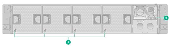

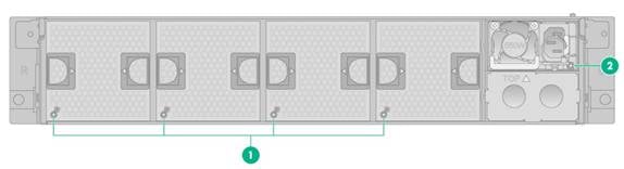

Rear panel LEDs
Figure1-2 Rear panel LEDs
(1) Fan module status LEDs
(2) Power supply status LED
Table1-4 LEDs and buttons on the rear panel
LED
Status
·     Steady green—The fan module is operating correctly.
·     Steady red—The fan module is faulty.
·     Off—The fan module is not installed securely, or no power is present on the fan module.
·     Steady green—The power supply is operating correctly.
·     Fast flashing green—Power is being input correctly but the system is not powered on.
·     Slow flashing green—The power supply is for backup and provides no power output.
·     Steady amber—Either of the following conditions exists:
¡     The power supply is faulty.
¡     The power supply does not have power input, but the other power supply has correct power input.
·     Flashing amber—An alert has occurred.
·     Off—Both power supplies do not have power input, which can be caused by incorrect power cord connection or power source shutdown.
