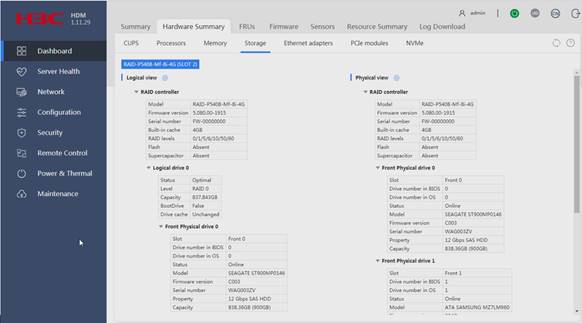

Viewing storage controller models
1.     Sign in to HDM. For information about logging in to HDM, see the firmware update guide for the server.
2.     In the navigation pane, select Dashboard > Hardware Summary.
3.     Click the Storage tab.
Figure 1 Viewing storage controller models

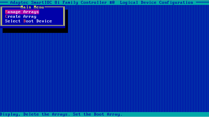

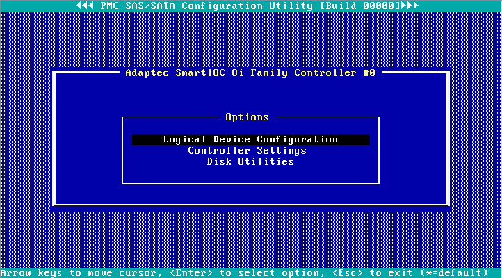

4.     On the screen as shown in Figure 3, select Logical Device Configuration, and press Enter.
Figure 3 Storage controller configuration screen
The screen as shown in Figure 4 opens.
Figure 4 Logical Device Configuration screen

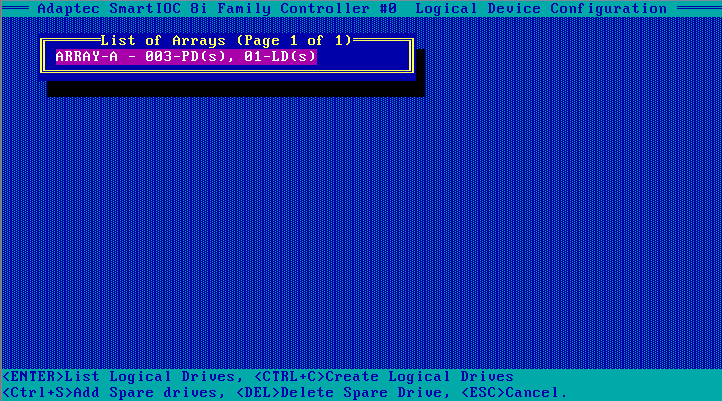

¡     If the operating system is installed on a logical drive, select Manage Arrays and press Enter to open the screen as shown in Figure 5. The first logical drive on the list is the first boot option.
Figure 5 Manage Arrays screen

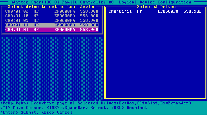

¡     If the operating system is installed on a physical drive, select Select Boot Device and press Enter to open the screen as shown in Figure 6. The first drive in the Selected Drives area on the right is the first boot option.
Figure 6 Select Boot Device

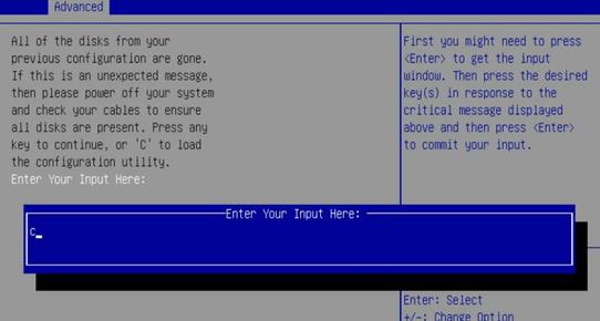

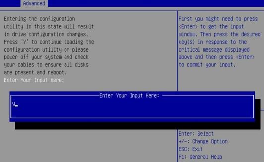

After a replacement, storage controller consistency check might fail if RAID arrays have been built by using the replaced storage controller. This is because RAID configuration information is saved on both the storage controller and drives.
The failure might cause the controller to stop operating if the controller's boot mode is set to Stop on Error. The server cannot identify the new storage controller and the BIOS displays Failed on the Advanced > Driver Health > AVAGO EFI SAS Driver page.
To solve this issue, perform the following tasks:
1.     On the BIOS setup screen, select Advanced > Driver Health > AVAGO EFI SAS Driver, and press Enter.
2.     Select the storage controller, and press Enter.
3.     As shown in Figure 7 and Figure 8, enter C or Y as prompted.
