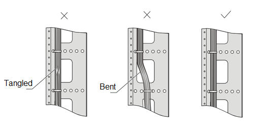

· Bind and route the cables neatly inside the rack, and make sure they are not kinked or bent.
Figure7-1 Correct and incorrect cable binding

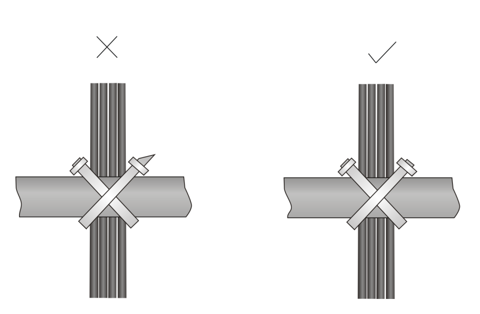

· Use the correct type of ties to bind the cables. Do not bind cables with joined ties. The following types of ties are available: 100 × 2.5 mm (3.94 × 0.10 in), 150 × 3.6 mm (5.91 × 0.14 in), 300 × 3.6 mm (11.81 × 0.14 in), 530 × 9 mm (20.87 × 0.35 in), and 580 × 13 mm (22.83 × 0.51 in).

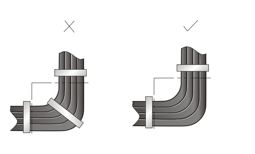

· After binding the cables, cut the excess from the ties, leaving no sharp or angular tips. See Figure7-2.
· When you bend cables, bind them as shown in Figure7-3. To avoid excessive stress causing cable core break, do not tie up the cables in the bending area.

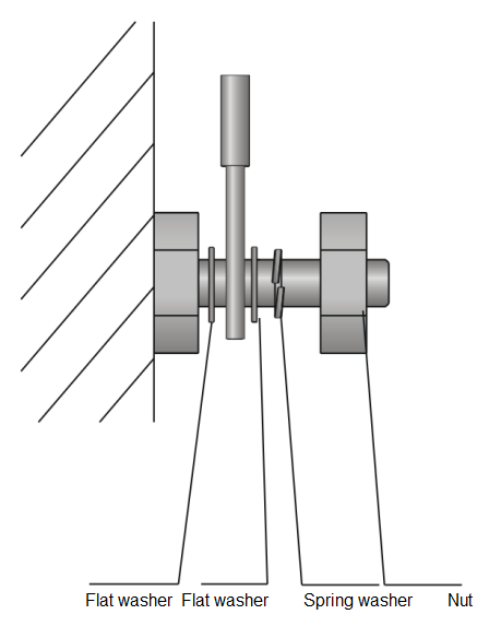

· Securely fasten cables and take adequate measures to prevent loose connections.
Figure7-4 Securely fastening cables
