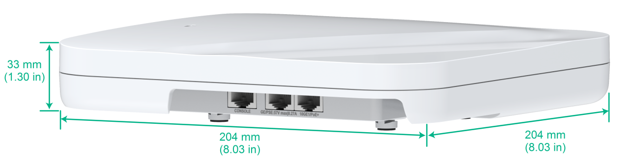

3 Appendix A AP views and technical specifications
WA7320i
AP views
Figure3-1 WA7320i
Ports
The AP provides the following ports:
· One GE/PSE port.
· One 10GE/PoE+ port.
· One 10GE/P+SFP port.
· One console port.
· One power port.
· One USB port.
The AP also has a reset button and a security slot. The security slot is 7 × 3 mm (0.28 × 0.12 in) in size.

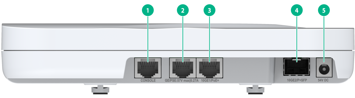

Figure3-2 Ports on the WA7320i AP (1)
(1) Console port |
(2) GE/PSE port |
(3) 10GE1/PoE+ port |
(4) 10GE2/P+SFP port |
(5) Power port |

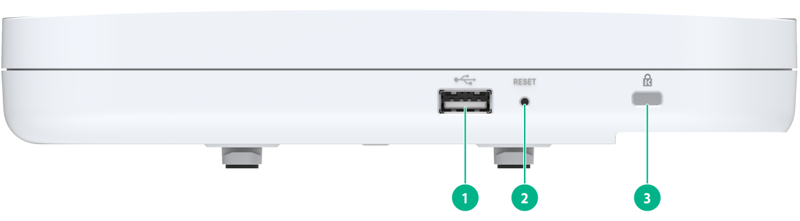

Figure3-3 Ports on the WA7320i AP (2)
(1) USB port |
(2) Reset button |
(3) Security slot |
Technical specifications
Table3-1 Technical specifications
Item |
Description |
Dimensions (H × W × D) (without the mounting bracket) |
33 × 204 × 204 mm (1.30 × 8.03 × 8.03 in) |
Weight |
0.8 kg (1.76 lb) |
Power consumption |
39 W |
Antenna |
Built-in antenna |
Standard compliance |
· IEEE802.11a/b/g/n/ac/ax/be · IEEE802.3at |
Powering option |
IEEE802.3at powering standard-compliant: · Power adapter · PoE · PoE optical transceiver module |
Operating temperature |
0°C to 50°C (32°F to 122°F) |
Storage temperature |
–40°C to +70°C (–40°F to +158°F) |
Operating humidity |
5%RH to 95%RH, non-condensing |
Storage humidity |
Operating altitude |
–60 m to +5000 m (–196.85 ft to +16404.20 ft) |
Console port |
Control port, used for debugging by the maintenance personnel |
10GE2/P+SFP port |
1000M/2.5G/5G/10G photoelectric hybrid port |
10GE1/PoE+ port |
100M/1000M/2.5G/5G/10G Ethernet copper port that can act as the device uplink port to connect to the Internet or MAN and as the standard PoE port at the same time. When the AP operates in fit AP mode, the port is represented by interface number 10GE1/0/1 in the MAP file and Ten-GigabitEthernet 1 for configuration on the AC. |
GE/PSE port |
100M/1000M Ethernet copper port, used for connecting a downlink device. The AP can supply power through this port to a device with a maximum power consumption of 15 W. When the AP operates in fit AP mode, the port is represented by interface number GE1/0/1 in the MAP file and gigabitethernet 1 for configuration on the AC. |
USB port |
USB-compliant USB port. NOTE: By default, the USB port is disabled. To enable the USB port, execute the usb enable command in AP view. |
Power port (54VDC) |
Used for receiving power from a local power source. |
Reset button |
For more information, see "Appendix B LEDs and buttons." |

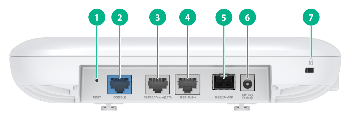

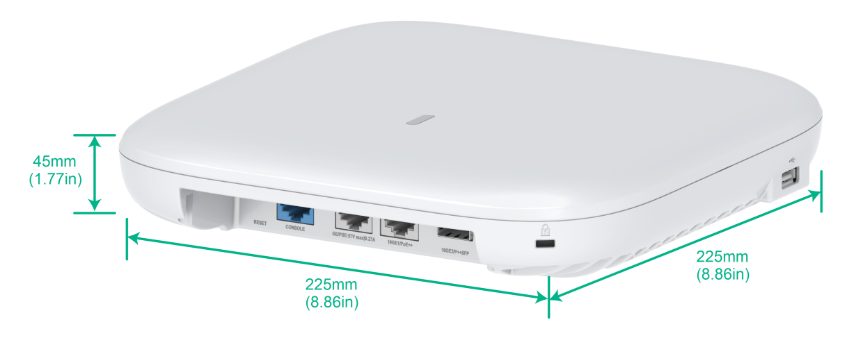

Figure3-5 Ports on the WA7338-HI AP (1)
(1) Reset button |
(2) Console port |
(3) GE/PSE port |
(4) 10GE1/PoE++ port |
(5) 10GE2/P++SFP port |
(6) Power port |
(7) Security slot |

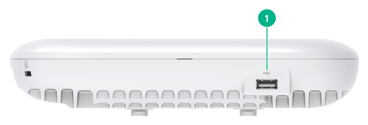

Figure3-6 Ports on the WA7338-HI AP (2)
(1) USB port |

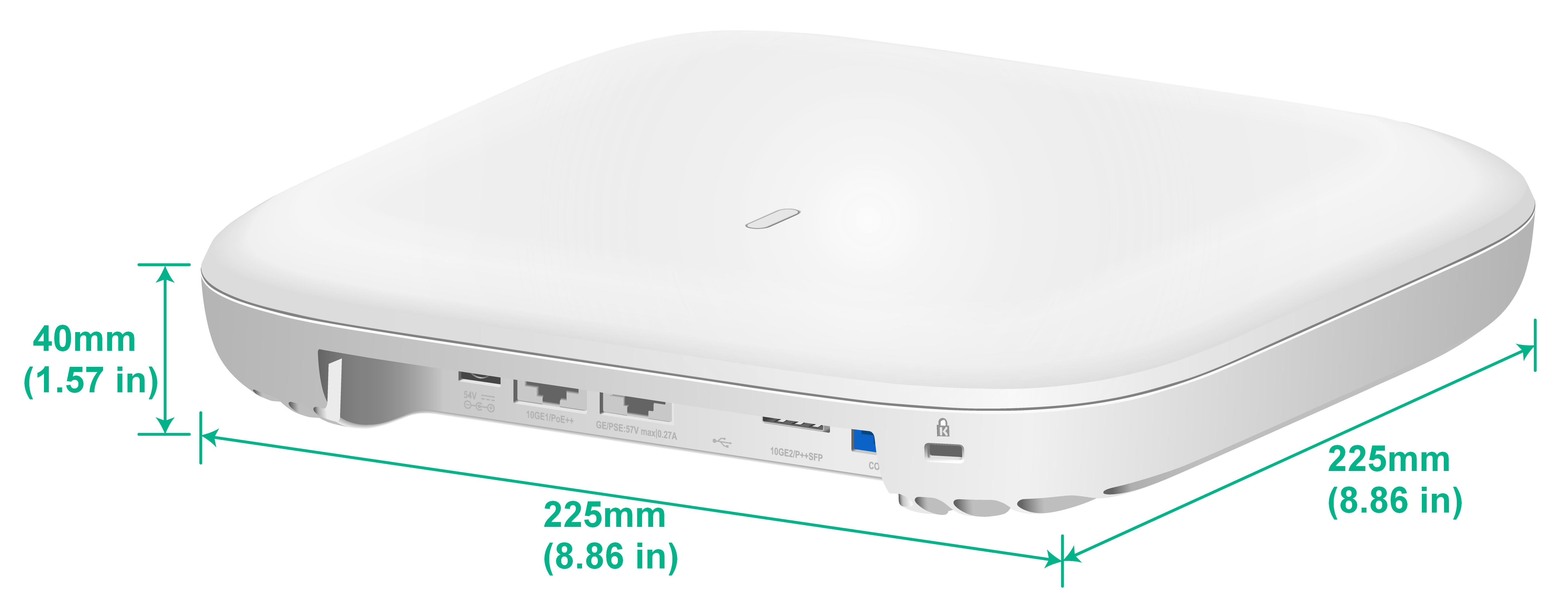

WA7539
AP views
Figure3-7 WA7539
Ports
· One GE/PSE port.
· One 10GE/PoE++ port.
· One 10GE/P++SFP port.
· One console port.
· One power port.
· One USB port.

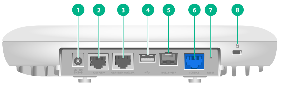

Figure3-8 Ports on the WA7539 AP
(1) Power port |
(2) 10GE1/PoE++ port |
(3) GE/PSE port |
(4) USB port |
(6) Console port |
(7) Reset button |
(8) Security slot |
Table3-3 Technical specifications
Item |
Description |
40 × 225 × 225 mm (1.57 × 8.86 × 8.86 in) |
Weight |
1.5 kg (3.31 lb) |
Power consumption |
≤ 54 W |
Antenna |
Built-in antenna |
· IEEE802.11a/b/g/n/ac/ax/be · IEEE802.3at/bt |
Powering option |
IEEE802.3at/bt powering standard-compliant: · Power adapter · PoE · PoE optical transceiver module |
Storage humidity |
Console port |
10GE2/P++SFP port |
10GE1/PoE++ port |
GE/PSE port |
USB port |
Reset button |

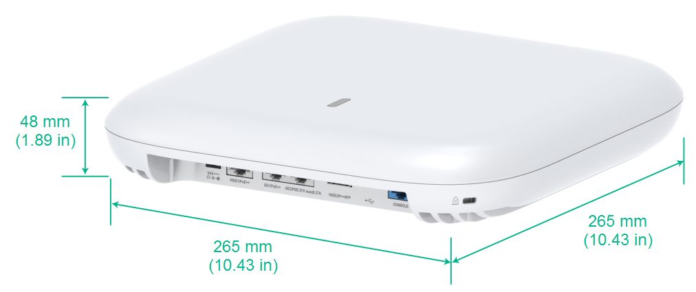

WA7638
AP views
Figure3-9 WA7638
Ports
· One GE/PSE port.
· One GE/PoE++ port.
· One console port.
· One power port.
· One USB port.

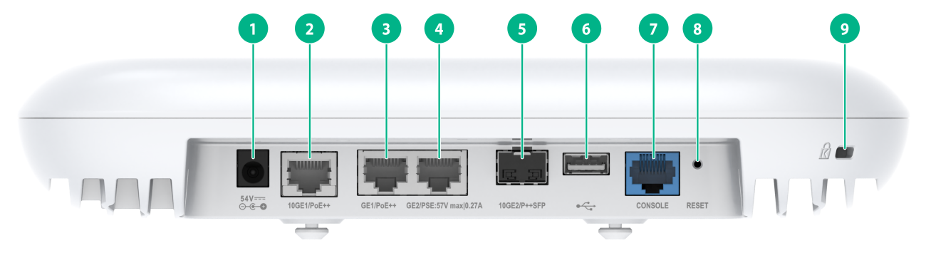

Figure3-10 Ports on the WA7638 AP
(1) Power port |
(3) GE1/PoE++ port |
(4) GE2/PSE port |
(6) USB port |
(7) Console port |
(8) Reset button |
(9) Security slot |
Table3-4 Technical specifications
Item |
Description |
48 × 265 × 265 mm (1.89 × 10.43 × 10.43 in) |
Weight |
1.9 kg (4.19 lb) |
Power consumption in standby state |
≤ 57.9 W (including PoE_OUT/USB) ≤ 40.4 W (excluding PoE_OUT/USB) |
Antenna |
Built-in antenna |
Powering option |
Storage humidity |
Console port |
10GE2/P++SFP |
GE1/PoE++ |
100M/1000M Ethernet copper port, which can act as the uplink interface to connect the device to Internet or the MAN or act as the standard PoE interface. When the AP operates in fit AP mode, the port is represented by interface number GE1/0/1 in the MAP file and GigabitEthernet 1 for configuration on the AC. |
10GE1/PoE++ |
GE2/PSE |
100M/1000M Ethernet copper port, used for connecting a downlink device. The AP can supply power through this port to a device with a maximum power consumption of 15 W. When the AP operates in fit AP mode, the port is represented by interface number GE1/0/2 in the MAP file and GigabitEthernet 2 for configuration on the AC. |
USB port |
Reset button |
