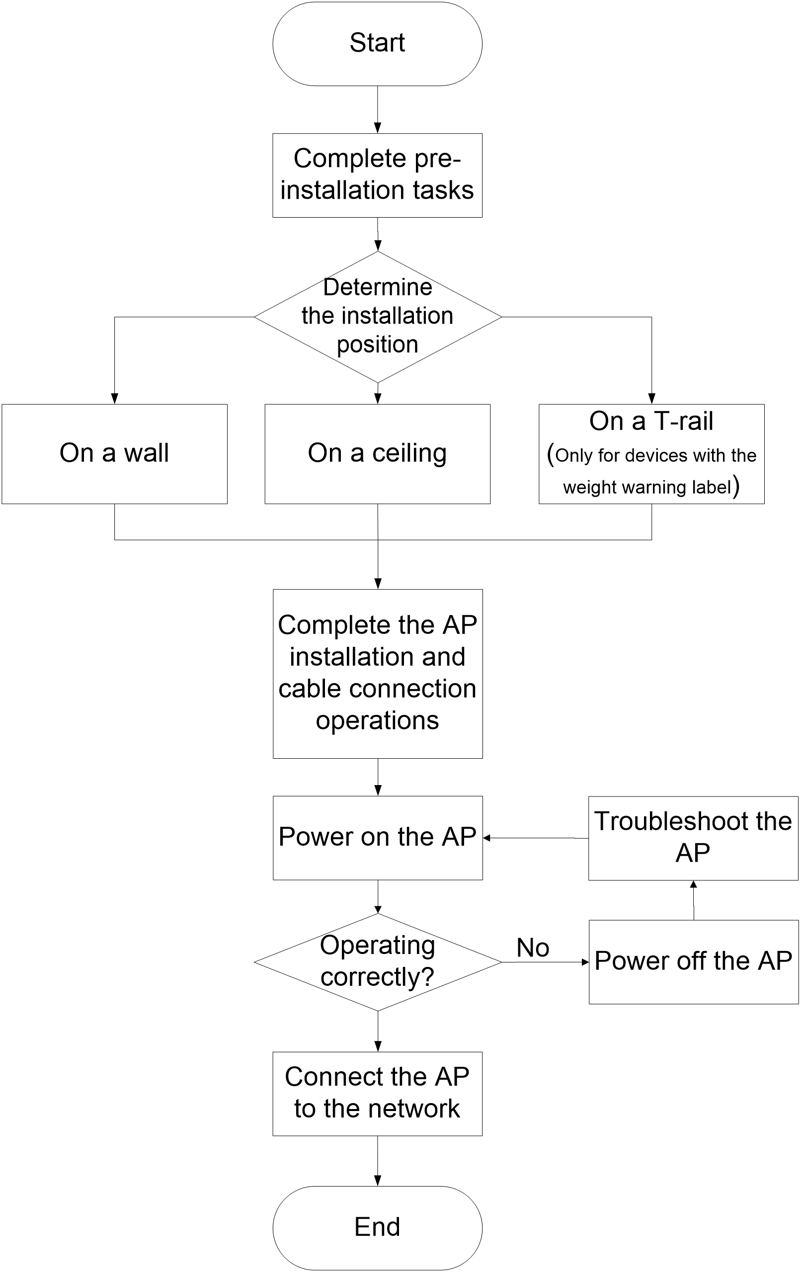

1 Installation flowchart
The H3C Wi-Fi7 indoor wireless APs include the following models:
· WA7320i
· WA7338-HI
· WA7539
· WA7638
Before powering on the device, make sure you have completed all installation steps.
Figure1-1 Installation flowchart

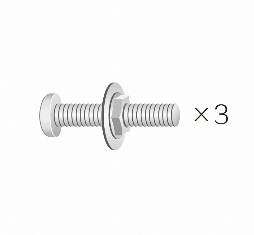

Mounting bracket (provided) |
M3 × 23.5 security screw (provided) |
· WA7320i · WA7338-HI · WA7539 · WA7638 |

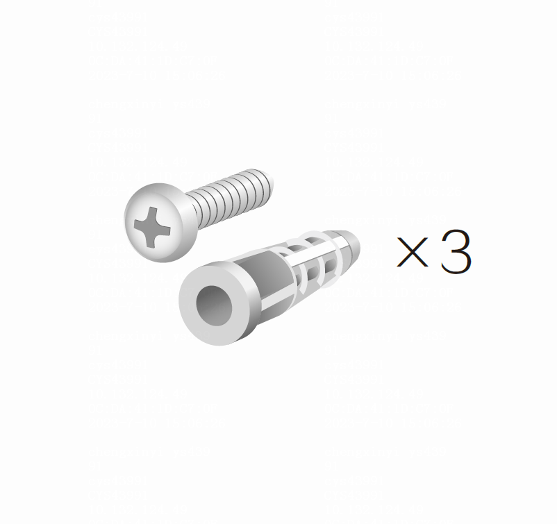

Screw and screw anchor (provided) |
M4 × 30 pan-head screw (provided) |

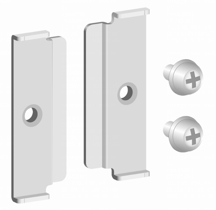

T-rail kit |
Provided: · WA7338-HI · WA7538 · WA7638 Optional: WA7320i |

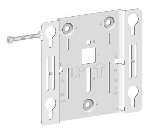

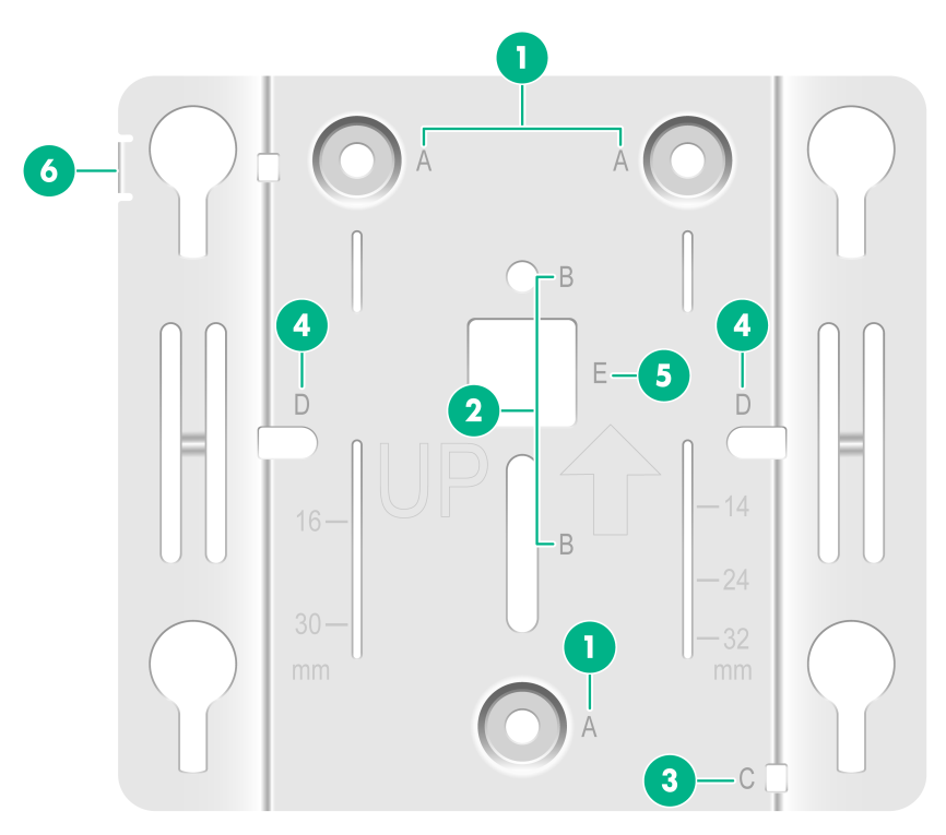

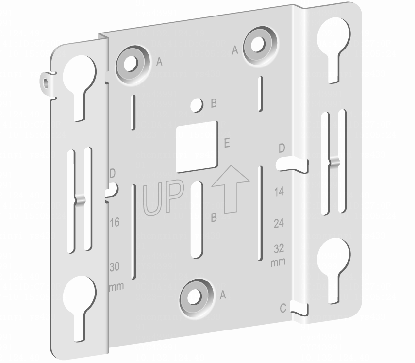

Figure3-1 Mounting bracket
(1) (A holes) Wall/ceiling mounting holes, used for securing the mounting bracket to the wall/ceiling |
(2) (B holes) T-rail mounting holes, used for securing the mounting bracket to a T-rail |
(3) (C hole) Auxiliary cable management hole. Thread a cable tie through the hole to secure cables. |
(4) (D holes) 86 panel mounting holes, used for securing the mounting bracket to an 86 panel. The distance between the two holes is 60 mm (2.36 in). |
(5) (E hole) Thread a cable through the hole to connect the AP |
(6) Security hole, applicable to the M3 × 23.5 security screw |

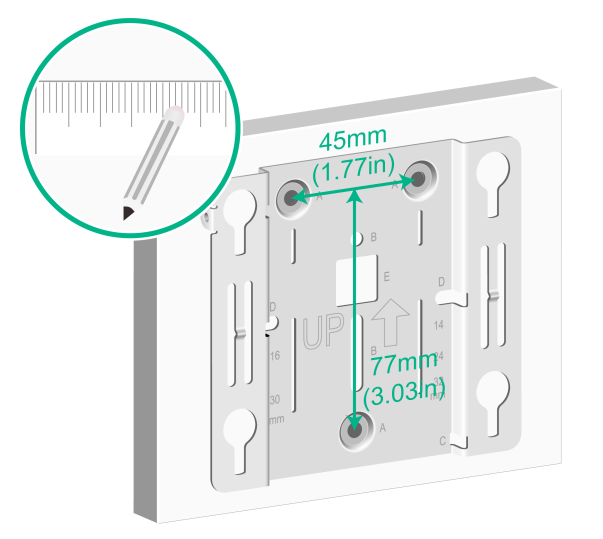

1. Place the mounting bracket against the wall and mark the installation holes on the wall.
Figure3-2 Marking the installation holes on the wall (using the WA7539 as an example)

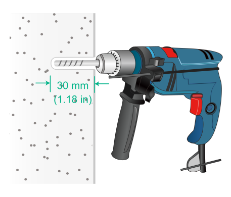

2. Drill three holes with a diameter of 6 mm (0.24 in) and a depth of 30 mm (1.18 in) at the marked locations, as shown in Figure3-3.
Figure3-3 Drilling holes in the wall (using the WA7539 as an example)

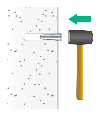

3. Insert a screw anchor into each hole, and tap the screw anchor with a rubber hammer until it is all flush with the wall surface, as shown in Figure3-4.
Figure3-4 Hammering the screw anchor into the wall (using the WA7539 as an example)

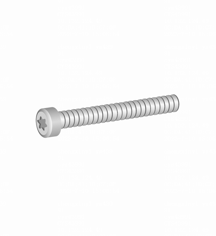

4. Thread the M3 × 23.5 security screw through the security hole in the mounting bracket. Make sure the screw does not block the keyhole slot.
Figure3-5 Inserting the security screw (using the WA7539 as an example)
5. Insert the screws through the installation holes in the mounting bracket into the holes in the wall. Fasten the screws to secure the mounting bracket to the wall, as shown in Figure3-6.
Figure3-6 Attaching the mounting bracket to the wall (using the WA7539 as an example)

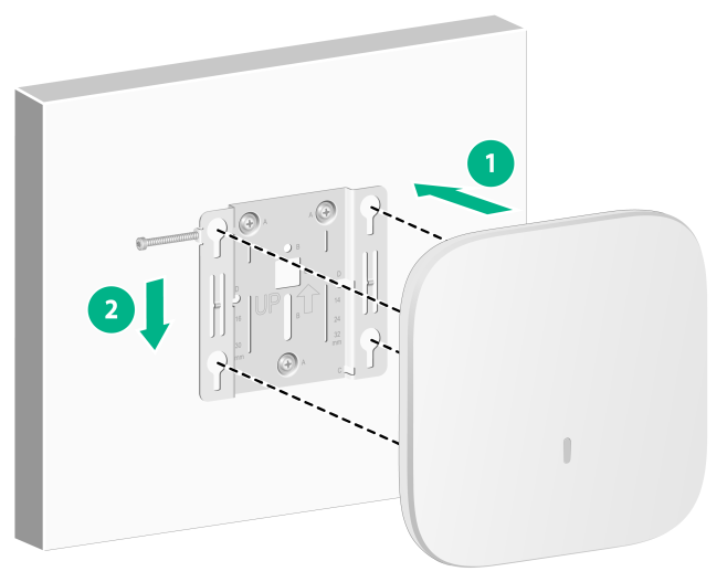

7. Position the four pegs at the AP rear into the keyhole slots in the mounting bracket and then slide the AP down until it sits securely in the keyhole slots, as shown in Figure3-7.
Figure3-7 Attaching the AP to the mounting bracket (using the WA7539 as an example)

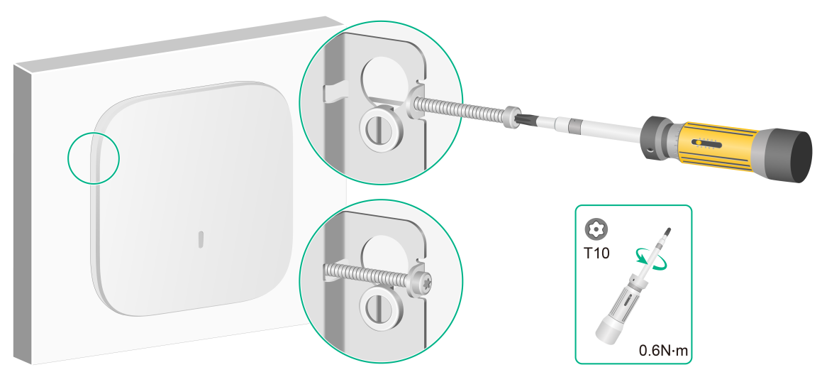

8. Use a security Torx screwdriver to fasten the M3 × 23.5 security screw.
Figure3-8 Fastening the M3 × 23.5 security screw (using the WA7539 as an example)

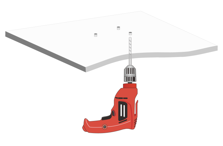

2. Place the mounting bracket against the ceiling tile and mark the installation holes on the ceiling tile. Drill three holes with a diameter of 6 mm (0.24 in) at the marked positions, as shown in Figure3-9.
Figure3-9 Drilling holes in the ceiling tile (using the WA7539 as an example)

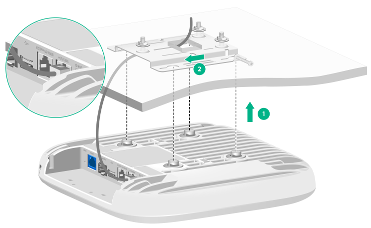

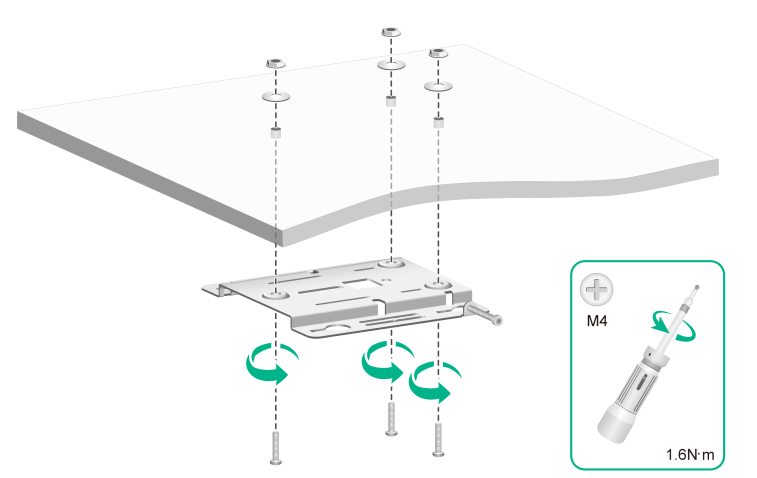

3. Thread the pan-head screws through the installation holes in the mounting bracket and into the holes in the ceiling tile. Fasten washers and nuts at the other side of the ceiling to secure the mounting bracket to the ceiling, as shown in Figure3-10.
Figure3-10 Attaching the mounting bracket to the ceiling (using the WA7539 as an example)
4. Connect the cable to the AP, see "Connecting cables."
5. Then position the four pegs at the AP rear into the keyhole slots in the mounting bracket and slide the AP until it sits securely in the keyhole slots.
Figure3-11 Attaching the AP to the mounting bracket (using the WA7539 as an example)

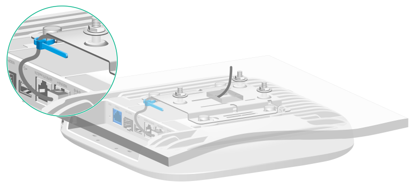

(Optional.) You can use a cable tie to secure the cable before attaching the AP to the mounting bracket. First thread the cable tie through the auxiliary hole in the mounting bracket, leaving the cable tie unfastened, and then adjust the cable length and fasten the cable tie to secure the cable.
No cable tie is provided with the AP. Prepare one yourself as required.
Figure3-12 Using a cable tie to secure the cable (using the WA7539 as an example)

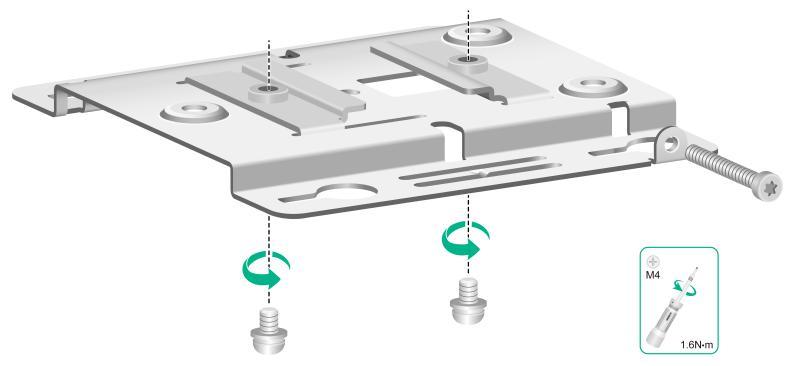

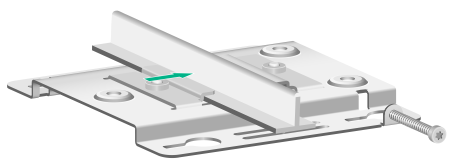

Mounting the AP on a T-rail
CAUTION: · Make sure the T-rail can bear a load of 5 kg (11.02 lb). · Make sure the T-rail has a thickness of not greater than 3.2 mm (0.13 in) and a width in the range of 17.5 to 34 mm (0.69 to 1.34 in). |
The installation method for the M3 × 23.5 security screw is similar when the AP is mounted on the wall and on a T-rail.
To mount the AP on a T-rail:
1. Use M4 T-rail clip screws to secure the T-rail clips to the mounting bracket. Do not fasten the left screw all the way in, leaving a certain space for adjusting the distance between the T-rail clips.
Figure3-13 Installing T-rail clips (using the WA7539 as an example)
2. Adjust the distance between T-rail clips based on the width of the T-rail. Use a Phillips screwdriver to fasten the left M4 T-rail clip screw.
Figure3-14 Adjusting the distance between the T-rail clips (using the WA7539 as an example)
3. Connect the cable to the AP, see "Connecting cables."

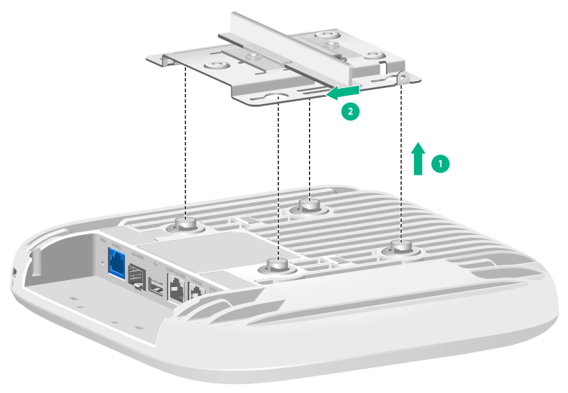

4. Position the four pegs at the AP rear into the keyhole slots in the mounting bracket and slide the AP until it sits securely in the keyhole slots.
Figure3-15 Install the AP (using the WA7539 as an example)
5. Verify that the AP is installed securely to prevent it from falling off.

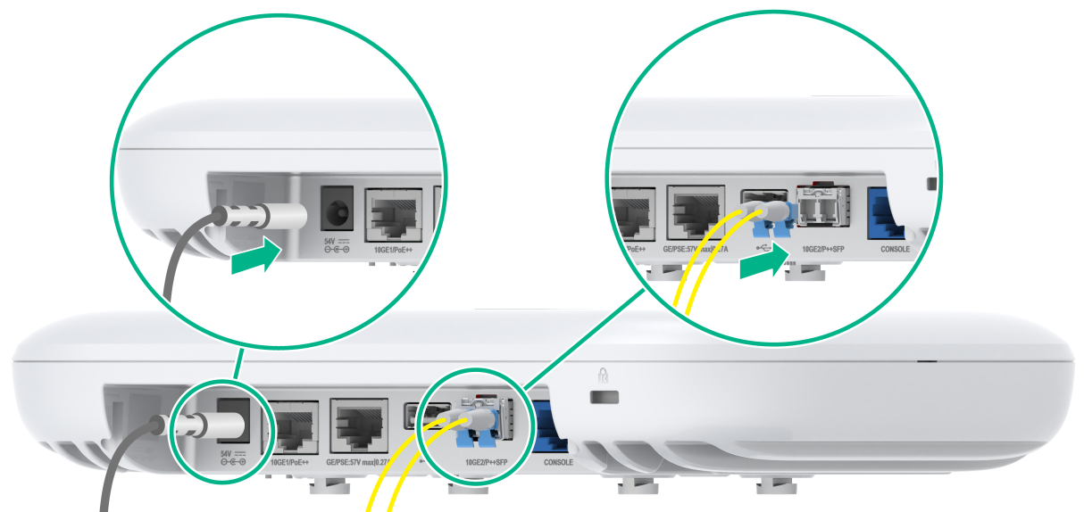

Powering the AP by using a power adapter
· Connect an uplink port on the AP to an Ethernet port for communication and power the AP by using a power adapter.
· Install a common transceiver module in an uplink port on the AP for communication and power the AP by using a power adapter.
Figure4-1 Installing a transceiver module and powering the AP by using a power adapter (using the WA7539 as an example)

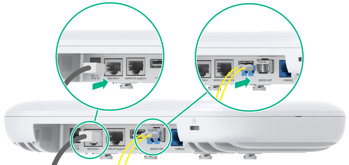

Power the AP through PoE
· Use an Ethernet cable to connect the PoE port on the AP and PoE switch for PoE power supply and communication.
· Install a common transceiver module in an uplink port on the AP for communication and use an Ethernet cable to connect the AP and PoE switch for PoE power supply.
Figure4-2 Installing a transceiver module and powering the AP through PoE (using the WA7539 as an example)
Powering the AP by using a PoE optical transceiver module
An uplink port on the AP uses a PoE optical transceiver module and a hybrid copper-fiber cable for receiving power and communication. You do not need to connect other cables.
Figure4-3 Powering the AP by using a PoE optical transceiver module (using the WA7539 as an example)

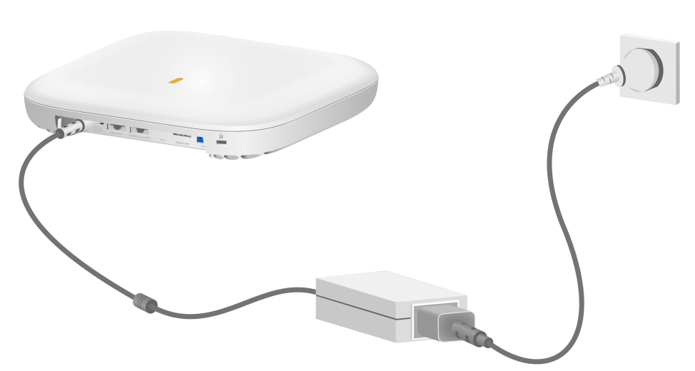

As shown in Figure4-4, you can use a power adapter to connect the AP to a local power source.
Figure4-4 Using a power adapter to connect the AP to a local power source (using the WA7539 as an example)

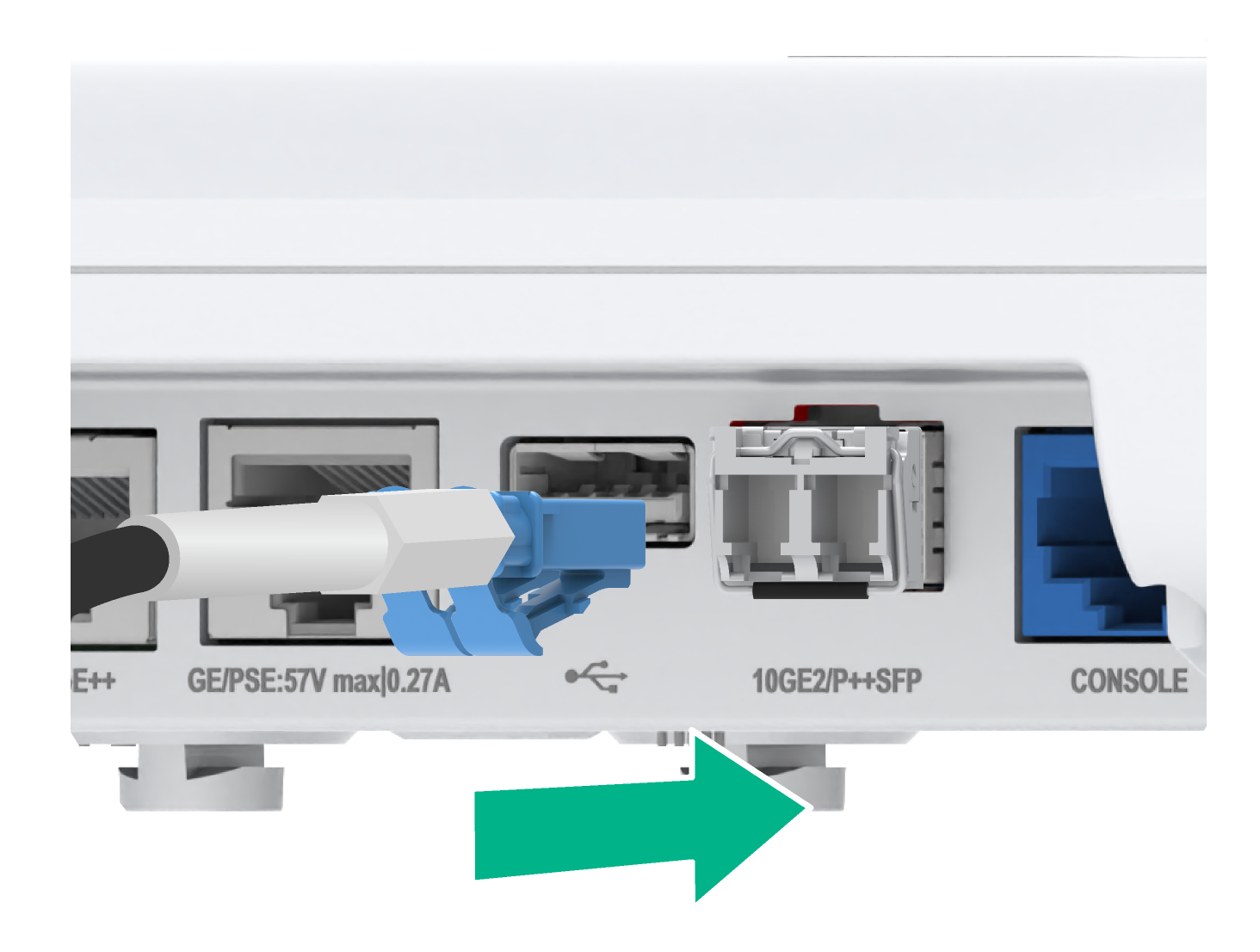

Connecting an Ethernet cable
NOTE: · The WA7338-HI, WA7539 and WA7638 require an 802.3bt-compliant PoE switch for supply power. This power supply method can provide a maximum output of 60 W. · The WA7320i requires an 802.3at-compliant PoE switch for power supply. This power supply method can provide a maximum output of 30 W. |

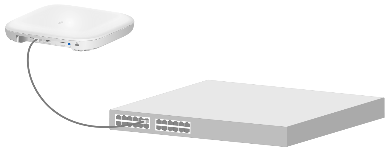

As shown in Figure4-5, use an Ethernet cable to connect the Ethernet port on the PoE switch to the PoE Ethernet port on the AP. The cable provides power supply connection and network access.
Figure4-5 Connecting an Ethernet cable (using the WA7539 as an example)

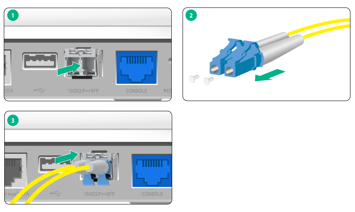

Connecting a common optical fiber

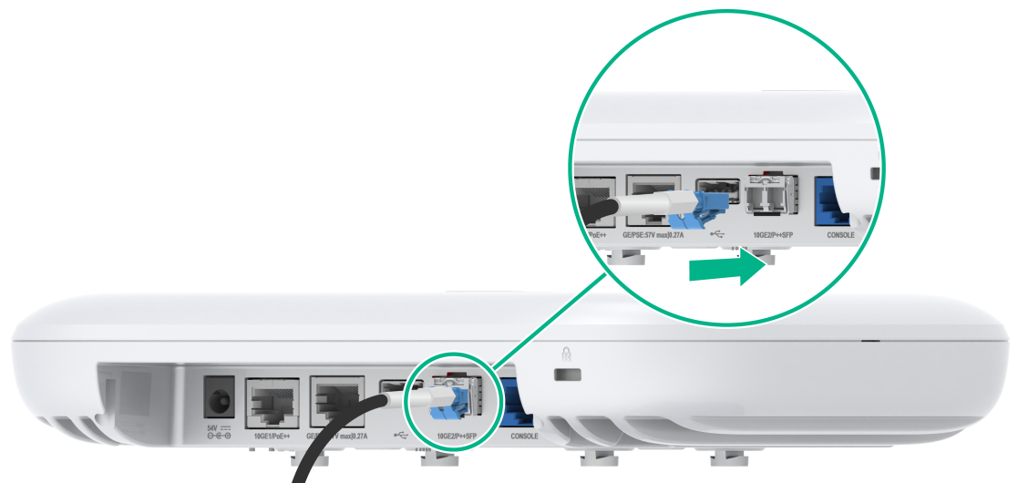

The fiber ports on the AP support only LC connectors. Purchase common transceiver modules yourself as required. For more information about common transceiver modules, see "Appendix C Optional transceiver modules."
To connect common optical fibers:
1. Holding both sides of the common transceiver module, insert the transceiver module slowly into the port.
2. Remove the dust caps from the optical fiber LC connectors.
3. Identify the Rx and Tx ports on the transceiver module. Use optical fibers with LC connectors to connect the Rx port and Tx port on the transceiver module to the Tx port and Rx port on the peer end, respectively.
Figure4-6 Connecting common optical fibers (using the WA7539 as an example)
Connecting a hybrid copper-fiber cable
The AP supports PoE optical transceiver modules. Purchase them yourself as required. For more information about the PoE optical transceiver modules, see "Appendix C Optional transceiver modules."
To connect a hybrid copper-fiber cable:
1. Strip the hybrid copper-fiber cable, fusion splice optical fibers, and splice copper wires. For more information, see "Appendix D Connecting the hybrid copper-fiber cable."
2. Holding both sides of the PoE optical transceiver module, insert the transceiver module slowly into the port.
3. Connect one end of the hybrid copper-fiber cable to the PoE optical transceiver module.
Figure4-7 Connecting a hybrid copper-fiber cable (using the WA7539 as an example)

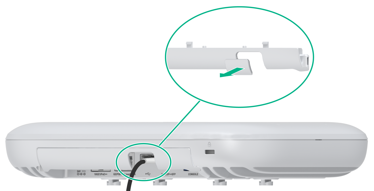

5 (Optional.) Installing the cable management plate
NOTE: This chapter is applicable only to the WA7338-HI, WA7539 and WA7638. |
After connecting all the cables, install the cable management plate. If an optical fiber is connected to the fiber port, you can remove the U-shaped plastic plate to facilitate cable routing as shown in Figure5-1.
Figure5-1 Removing the U-shaped plastic plate (using the WA7539 as an example)

· When you power the AP by using a power adapter, verify that the local AC power source is reliably grounded.
