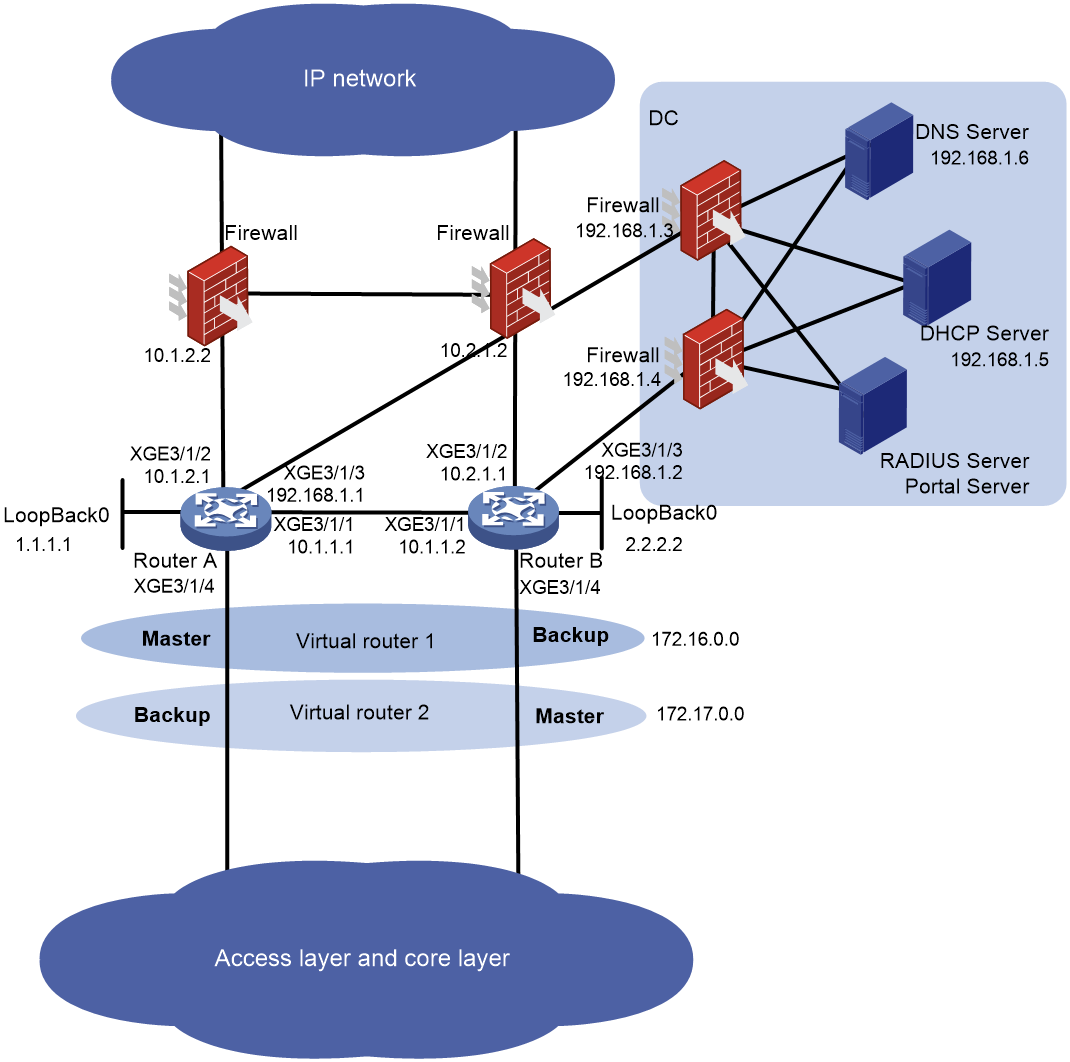

As shown in Figure 1, routers Router A and Router B are gateway devices.
Figure 1 Campus border gateway configuration example
Analysis
·     Configure IP addresses for interfaces on the routers, firewalls, and switches.
·     Configure OSPF for interfaces on the routers, firewalls, and switches.
·     Configure BFD for OSPF on the routers, firewalls, and switches to ensure network availability.
·     Configure VRRP to collaborate with BFD on the routers to improve device availability.
·     Configure QoS and deploy traffic policies on the routers.
·     Configure the DHCP relay agent, and allocate and manage IP addresses on the routers.

[RouterB] traffic classifier SIP
[RouterB-classifier-SIP] if-match acl 2002
[RouterB-classifier-SIP] quit
[RouterB] traffic behavior VIP
[RouterB-behavior-VIP] remark ip-precedence 5
[RouterB-behavior-VIP] quit
[RouterB] traffic behavior SIP
[RouterB-behavior-SIP] remark ip-precedence 4
[RouterB-behavior-SIP] quit
[RouterB] qos policy VIP
[RouterB-qospolicy-VIP] classifier VIP behavior VIP
[RouterB-qospolicy-VIP] quit
[RouterB] qos policy SIP
[RouterB-qospolicy-SIP] classifier SIP behavior SIP
[RouterB-qospolicy-SIP] quit
Applying QoS policies in sharing mode to the subinterfaces connecting to service traffic on Router A
<RouterA> system-view
[RouterA] interface Ten-GigabitEthernet 3/1/4.1
[RouterA-Ten-GigabitEthernet3/1/4.1] qos apply policy VIP inbound share-mode
[RouterA-Ten-GigabitEthernet3/1/4.1] quit
[RouterA] interface Ten-GigabitEthernet 3/1/4.2
[RouterA-Ten-GigabitEthernet3/1/4.2] qos apply policy SIP inbound share-mode
[RouterA-Ten-GigabitEthernet3/1/4.2] quit
Applying QoS policies in sharing mode to the subinterfaces connecting to service traffic on Router B
<RouterB> system-view
[RouterB] interface Ten-GigabitEthernet 3/1/4.1
[RouterB-Ten-GigabitEthernet3/1/4.1] qos apply policy VIP inbound share-mode
[RouterB-Ten-GigabitEthernet3/1/4.1] quit
[RouterB] interface Ten-GigabitEthernet 3/1/4.2
[RouterB-Ten-GigabitEthernet3/1/4.2] qos apply policy SIP inbound share-mode
[RouterB-Ten-GigabitEthernet3/1/4.2] quit
Configuring user access
Configuring Router A
[RouterA] dhcp enable
[RouterA-Ten-GigabitEthernet3/1/4.1] dhcp select relay
[RouterA-Ten-GigabitEthernet3/1/4.1] dhcp relay server-address 192.168.1.5
[RouterA-Ten-GigabitEthernet3/1/4.2] dhcp select relay
[RouterA-Ten-GigabitEthernet3/1/4.2] dhcp relay server-address 192.168.1.5
Configuring Router B
[RouterB] dhcp enable
[RouterB-Ten-GigabitEthernet3/1/4.1] dhcp select relay
[RouterB-Ten-GigabitEthernet3/1/4.1] dhcp relay server-address 192.168.1.5
[RouterB-Ten-GigabitEthernet3/1/4.2] dhcp select relay
[RouterB-Ten-GigabitEthernet3/1/4.2] dhcp relay server-address 192.168.1.5
# Display OSPF route information on Router A.
<RouterA> display ospf routing
         OSPF Process 1 with Router ID 1.1.1.1
                  Routing Table
                Topology base (MTID 0)
 Routing for network
 Destination        Cost     Type    NextHop         AdvRouter       Area
 10.1.2.0/24        2000     Stub    0.0.0.0         1.1.1.1         0.0.0.0
 10.1.1.0/24        10       Stub    0.0.0.0         1.1.1.1         0.0.0.0
 192.168.1.0/24     2000     Stub    0.0.0.0         1.1.1.1         0.0.0.0
 Total nets: 3
 Intra area: 3  Inter area: 0  ASE: 0  NSSA: 0
# Display OSPF route information on Router B.
<RouterB> display ospf routing
         OSPF Process 1 with Router ID 2.2.2.2
                  Routing Table
 Routing for network
 10.1.2.0/24        2010     Stub    10.1.1.1        1.1.1.1         0.0.0.0
 10.1.1.0/24        10       Stub    0.0.0.0         2.2.2.2         0.0.0.0
 192.168.1.0/24     2000     Stub    0.0.0.0         2.2.2.2         0.0.0.0
 Total nets: 3
# Display BFD session information on Router A.
<RouterA> display bfd session
 Total sessions: 1        Up sessions: 1        Init mode: Active
 IPv4 session working in control packet mode:
 LD/RD           SourceAddr      DestAddr        State   Holdtime    Interface
 33793/33793     10.1.1.1        10.1.1.2        Up      294ms       XGE3/1/1
# Display BFD session information on Router B.
<RouterB> display bfd session
 33793/33793     10.1.1.2        10.1.1.1        Up      267ms       XGE3/1/1
# Display VRRP group state information on Router A.
<RouterA> display vrrp
IPv4 virtual router information:
 Running mode : Standard
 Total number of virtual routers : 2
 Interface          VRID  State       Running Adver     Auth    Virtual
                                      pri     timer(cs) type    IP
 XGE3/1/4.1         1     Master      110     100       None    172.16.0.11
 XGE3/1/4.2         2     Backup      100     100       None    172.17.0.11
# Display VRRP group state information on Router B.
<RouterB> display vrrp
 XGE3/1/4.1         1     Backup      100     100       None    172.16.0.11
 XGE3/1/4.2         2     Master      110     100       None    172.17.0.11
Configuration files
·     Router A:
 router id 1.1.1.1
ospf 1
 area 0.0.0.0
  network 10.1.1.0 0.0.0.255
  network 10.1.2.0 0.0.0.255
  network 172.16.0.0 0.0.0.255
  network 172.17.0.0 0.0.0.255
  network 192.168.1.0 0.0.0.255
 dhcp enable
traffic classifier SIP operator and
 if-match acl 2002
traffic classifier VIP operator and
 if-match acl 2001
qos policy SIP
qos policy VIP
interface LoopBack0
 ip address 1.1.1.1 255.255.255.0
interface Ten-GigabitEthernet3/1/1
 ospf cost 10
 ospf network-type p2p
 ospf bfd enable
 bfd min-transmit-interval 100
 bfd min-receive-interval 100
 bfd detect-multiplier 3
interface Ten-GigabitEthernet3/1/2
 ip address 10.1.2.1 255.255.255.0
 ospf cost 2000
 ospf bfd enable
interface Ten-GigabitEthernet3/1/3
 ospf cost 2000
 ospf bfd enable
interface Ten-GigabitEthernet3/1/4.1
 ip address 172.16.0.9 255.255.255.0
 ospf cost 2000
 vrrp vrid 1 virtual-ip 172.16.0.11
 vrrp vrid 1 priority 110
 dhcp select relay
interface Ten-GigabitEthernet3/1/4.2
 ip address 172.17.0.9 255.255.255.0
 ospf cost 2000
 vrrp vrid 2 virtual-ip 172.17.0.11
 dhcp select relay
acl basic 2001
 rule 1 permit source 172.16.0.0 0.0.255.255
acl basic 2002
 rule 1 permit source 172.17.0.0 0.0.255.255
·     Router B:
ospf 1
 area 0.0.0.0
 dhcp enable
 if-match acl 2002
 if-match acl 2001
qos policy SIP
qos policy VIP
interface LoopBack0
 ip address 2.2.2.2 255.255.255.0
 ip address 10.1.1.2 255.255.255.0
 ospf cost 10
 ospf bfd enable
 ip address 10.2.1.1 255.255.255.0
 ospf cost 2000
 ospf bfd enable
 ip address 192.168.1.2 255.255.255.0
 ospf cost 2000
 ospf bfd enable
 ip address 172.16.0.10 255.255.255.0
 ospf cost 2000
 dhcp select relay
 ip address 172.17.0.10 255.255.255.0
 ospf cost 2000
 vrrp vrid 2 priority 110
 dhcp select relay
acl basic 2001
acl basic 2002
Related documentation
·     H3C SR8800-F Router OSPF Service Configuration Guide-R8385P09
·     H3C SR8800-F Router OSPF Service Command Reference-R8385P09
·     H3C SR8800-F Router BFD Service Configuration Guide-R8385P09
·     H3C SR8800-F Router BFD Service Command Reference-R8385P09
·     H3C SR8800-F Router VRRP Service Configuration Guide-R8385P09
·     H3C SR8800-F Router VRRP Service Command Reference-R8385P09
·     H3C SR8800-F Router ACL Service Configuration Guide-R8385P09
·     H3C SR8800-F Router ACL Service Command Reference-R8385P09
·     H3C SR8800-F Router QoS Service Configuration Guide-R8385P09
·     H3C SR8800-F Router QoS Service Command Reference-R8385P09
·     H3C SR8800-F Router DHCP Service Configuration Guide-R8385P09
·     H3C SR8800-F Router DHCP Service Command Reference-R8385P09
