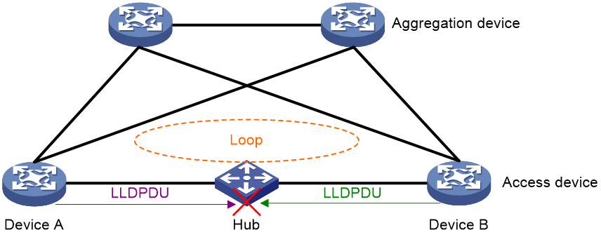

As shown in Figure 5, Device A and Device B are connected through a hub, causing a loop in the network. However, since LLDP packets are point-to-point packets, they are terminated at the next node after being sent from the device. Therefore, the hub acts as a black hole for LLDP packets and LLDP packets cannot be transmitted between Device A and Device B through the HUB. As a result, Device A and Device B cannot use LLDP to learn about the physical link between them and the formed loop, and therefore the loop cannot be eliminated in time. In order to eliminate potential loop risks, it required to detect LLDP packet black holes and block the links leading to the black holes.
Figure 5 LLDP black hole detection application scenario
The LLDP black hole detection feature can detect the presence of LLDP black holes in links on ports. The operating mechanism is as follows:

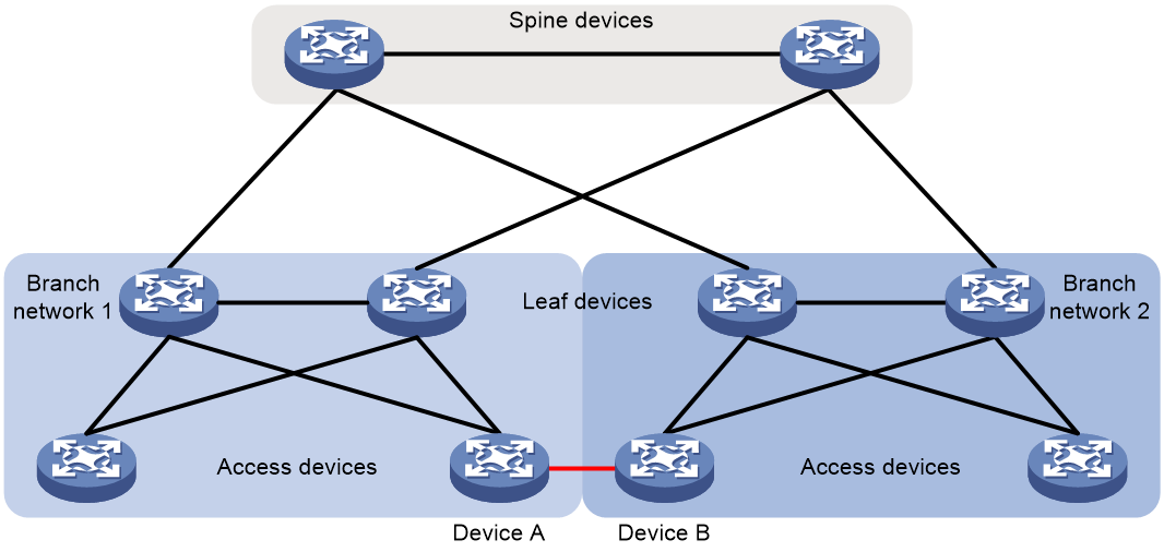

As shown in Figure 6, Device A and Device B belongs to different branch networks. If a link exists between Device A and Device B, a loop might occur in the network. After configuring LLDP cross-domain detection, you can manually assign the devices to different domains, and use LLDP to detect whether the specified LLDP neighbor is in the local domain. In addition, you can block the link to neighbors in other domains to eliminate the potential loop risk.
Figure 6 LLDP cross-domain detection application scenario

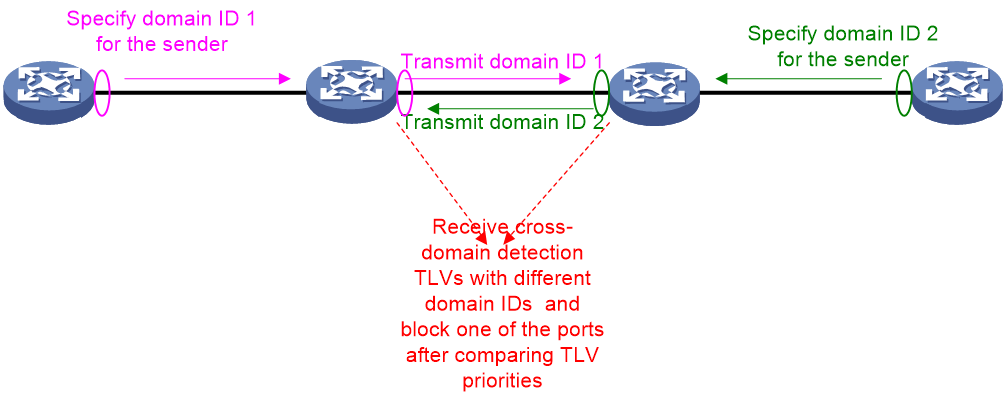

The LLDP cross-domain detection feature defines a private type of TLV for LLDP, that is, the cross-domain detection TLV. This TLV is used to advertise the local domain to the LLDP neighbor at the peer end. The LLDP cross-domain detection feature takes effect on a port only after you execute the lldp global cross-domain-detection enable or lldp cross-domain-detection command to enable LLDP cross-domain detection. Then, LLDP packets sent by the device will carry cross-domain detection TLVs.
The domain ID in a cross-domain detection TLV is key information, because it indicates the domain to which the port that sends the cross-domain detection TLV belongs. If you execute the lldp cross-domain-detection domain-id command to specify a domain ID for a port, the cross-domain detection TLVs sent by this port must carry the specified domain ID. If you do not specify a domain ID for a port, the cross-domain detection TLVs sent by this port carry a domain ID in the cross-domain detection TLVs received by the device. If the device has received multiple cross-domain detection TLVs with different domain IDs, it will compare the priorities of these TLVs. When sending a cross-domain detection TLV, the device will carry only the domain ID of the optimal TLV it received, and block ports that receive non-optimal TLVs with different domain IDs. This will help eliminating potential loops in the network, as shown in Figure 7. A blocked port can restore normal forwarding status when LLDP cross-domain detection is disabled or it does not receive any cross-domain detection TLV that carries a different domain ID.
Figure 7 Domain ID transmission
As a best practice, enable LLDP cross-domain detection only on a port of the start device of a domain ID (typically the spine device in a spine-leaf architecture), and do not enable LLDP cross-domain detection globally. If you fail to do so, LLDP cross-domain detection might fail to take effect.
If the domain ID is not configured for LLDP cross-domain detection, or the port is not enabled with the cross-domain detection TLV advertisement capability, the cross-domain detection feature cannot take effect on the port. In this case, the device cannot identify cross-domain detection TLVs carried in LLDP packets or add cross-domain detection TLVs to LLDP packets.
You can use the lldp global cross-domain-detection enable or lldp cross-domain-detection command to enable LLDP cross-domain detection for a port. If the lldp cross-domain-detection command is not command for the port, the global setting (configured with the lldp global cross-domain-detection enable command) applies. If both commands are configured for the port, the port-specific setting (configured with the lldp cross-domain-detection command) applies.

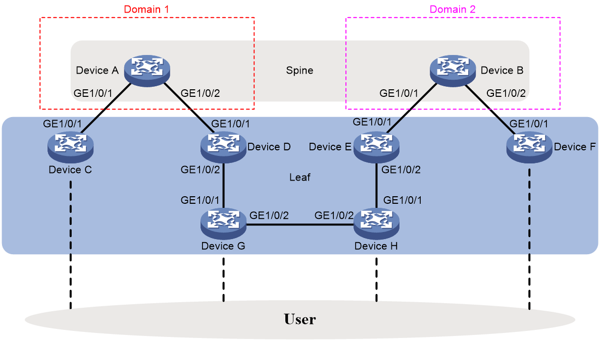

Example: Configuring LLDP cross-domain detection
As shown in Figure 9, in a spine-leaf architecture, Device A, Device C, Device D, and Device G belong to the same branch, and Device B, Device E, Device F, and Device H belong to the other. To prevent loops caused by incorrect wiring between devices, make sure only the devices within the same branch can exchange data. To meet these requirements, configure LLDP cross-domain detection. Assign Device A and its downstream devices to one domain and Device B and its downstream devices to another. Then, the ports that connect different domains will be blocked to prevent data traffic between different branches.

1.     Configure Device A:
# Enable LLDP globally.
<DeviceA> system-view
[DeviceA] lldp global enable
# Enable LLDP on Ten-GigabitEthernet 3/0/1 and Ten-GigabitEthernet 3/0/2 separately. By default, LLDP is enabled on ports.
[DeviceA] interface ten-gigabitethernet 3/0/1
[DeviceA-Ten-GigabitEthernet3/0/1] lldp enable
[DeviceA-Ten-GigabitEthernet3/0/1] quit
[DeviceA] interface ten-gigabitethernet 3/0/2
[DeviceA-Ten-GigabitEthernet3/0/2] lldp enable
[DeviceA-Ten-GigabitEthernet3/0/2] quit
# Specify domain ID 1 for Ten-GigabitEthernet 3/0/1 and Ten-GigabitEthernet 3/0/2 and enable LLDP cross-domain detection.
[DeviceA-Ten-GigabitEthernet3/0/1] lldp cross-domain-detection domain-id 1
[DeviceA-Ten-GigabitEthernet3/0/1] lldp cross-domain-detection enable
[DeviceA-Ten-GigabitEthernet3/0/2] lldp cross-domain-detection domain-id 1
[DeviceA-Ten-GigabitEthernet3/0/2] lldp cross-domain-detection enable
2.     Configure Device B:
<DeviceB> system-view
[DeviceB] lldp global enable
[DeviceB] interface ten-gigabitethernet 3/0/1
[DeviceB-Ten-GigabitEthernet3/0/1] lldp enable
[DeviceB-Ten-GigabitEthernet3/0/1] quit
[DeviceB] interface ten-gigabitethernet 3/0/2
[DeviceB-Ten-GigabitEthernet3/0/2] lldp enable
[DeviceB-Ten-GigabitEthernet3/0/2] quit
[DeviceB-Ten-GigabitEthernet3/0/1] lldp cross-domain-detection domain-id 2
[DeviceB-Ten-GigabitEthernet3/0/1] lldp cross-domain-detection enable
[DeviceB-Ten-GigabitEthernet3/0/2] lldp cross-domain-detection domain-id 2
[DeviceB-Ten-GigabitEthernet3/0/2] lldp cross-domain-detection enable
3.     Configure Device C:
<DeviceC> system-view
[DeviceC] lldp global enable
# Enable LLDP cross-domain detection globally.
[DeviceC] lldp global cross-domain-detection enable
# Enable LLDP on Ten-GigabitEthernet 3/0/1. By default, LLDP is enabled on ports.
[DeviceC] interface ten-gigabitethernet 3/0/1
[DeviceC-Ten-GigabitEthernet3/0/1] lldp enable
[DeviceC-Ten-GigabitEthernet3/0/1] quit
4.     Configure Device D
<DeviceD> system-view
[DeviceD] lldp global enable
[DeviceD] lldp global cross-domain-detection enable
# Enable LLDP on Ten-GigabitEthernet 3/0/1 and Ten-GigabitEthernet 3/0/2. By default, LLDP is enabled on ports.
[DeviceD] interface ten-gigabitethernet 3/0/1
[DeviceD-Ten-GigabitEthernet3/0/1] lldp enable
[DeviceD-Ten-GigabitEthernet3/0/1] quit
[DeviceD] interface ten-gigabitethernet 3/0/2
[DeviceD-Ten-GigabitEthernet3/0/2] lldp enable
[DeviceD-Ten-GigabitEthernet3/0/2] quit
5.     Configure Device G in the same steps as Device D.
6.     Configure Device E:
<DeviceE> system-view
[DeviceE] lldp global enable
[DeviceE] lldp global cross-domain-detection enable
[DeviceE] interface ten-gigabitethernet 3/0/1
[DeviceE-Ten-GigabitEthernet3/0/1] lldp enable
[DeviceE-Ten-GigabitEthernet3/0/1] quit
[DeviceE] interface ten-gigabitethernet 3/0/2
[DeviceE-Ten-GigabitEthernet3/0/2] lldp enable
[DeviceE-Ten-GigabitEthernet3/0/2] quit
7.     Configure Device H in the same steps as Device E.
8.     Configure F:
<DeviceF> system-view
[DeviceF] lldp global enable
[DeviceF] lldp global cross-domain-detection enable
[DeviceF] interface ten-gigabitethernet 3/0/1
[DeviceF-Ten-GigabitEthernet3/0/1] lldp enable
[DeviceF-Ten-GigabitEthernet3/0/1] quit

Interface Ten-GigabitEthernet 3/0/2 on Device H is blocked by cross-domain detection.

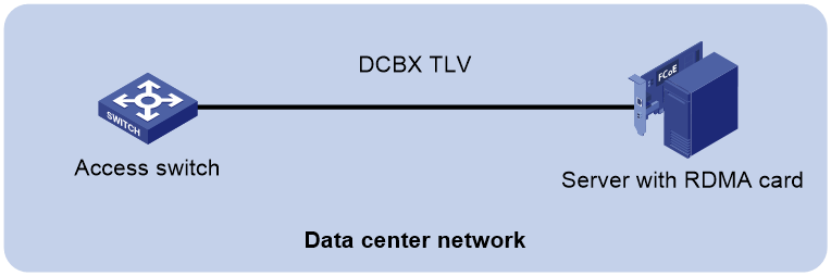

DCBX application scenario
Figure 10 DCBX application scenario
DCBX enables lossless packet transmission on DCE networks.
As shown in Figure 10, DCBX applies to an RoCE-based data center network, and operates on an access switch. DCBX enables the switch to control the server or storage adapter, and simplifies the configuration and guarantees configuration consistency. DCBX extends LLDP by using the IEEE 802.1 organizationally specific TLVs (DCBX TLVs) to transmit DCBX data, including:
·     In DCBX Rev 1.00 and DCBX Rev 1.01:
¡     Enhanced Transmission Selection (ETS).
¡     Priority-based Flow Control (PFC).
·     In IEEE Std 802.1Qaz-2011:
¡     ETS Configuration.
¡     ETS Recommendation.
¡     PFC.
H3C devices can send these types of DCBX information to a server or storage adapter. However, H3C devices cannot accept these types of DCBX information.
