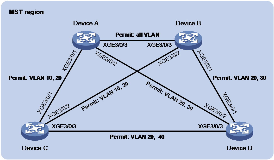

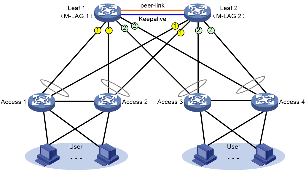

Figure 9 shows a switched network that contains four MST regions, each MST region containing four MSTP devices. Figure 10 shows the networking topology of MST region 3.
Figure 9 Basic concepts in MSTP
Figure 10 Network diagram and topology of MST region 3
MST region
A multiple spanning tree region (MST region) consists of multiple devices in a switched network and the network segments among them. All these devices have the following characteristics:
·     A spanning tree protocol enabled

MSTI
MSTP can generate multiple independent spanning trees in an MST region, and each spanning tree is mapped to the specific VLANs. Each spanning tree is referred to as a multiple spanning tree instance (MSTI).
In Figure 10, MST region 3 contains three MSTIs, MSTI 1, MSTI 2, and MSTI 0.
VLAN-to-instance mapping table
As an attribute of an MST region, the VLAN-to-instance mapping table describes the mapping relationships between VLANs and MSTIs.
In Figure 10, the VLAN-to-instance mapping table of MST region 3 is as follows:
·     VLAN 1 to MSTI 1.
·     VLAN 2 and VLAN 3 to MSTI 2.
·     Other VLANs to MSTI 0.
MSTP achieves load balancing by means of the VLAN-to-instance mapping table.

Ignoring the specified VLANs
Traffic of a VLAN on a complex network might be blocked by the spanning tree, as shown in Figure 16.
·     Port A1 on Device A allows the traffic of VLAN 1 to pass through.
·     Port A2 on Device A allows the traffic of VLAN 2 to pass through.
·     Port B1 on Device B allows the traffic of VLAN 1 to pass through.
·     Port B2 on Device B allows the traffic of VLAN 2 to pass through.
·     Device A and Device B run a spanning tree protocol. Device A is the root bridge, and Port A1 and Port A2 are designated ports. On Device B, Port B1 is the root port, and Port B2 is the blocked port. Traffic of VLAN 2 is blocked.
Figure 16 VLAN connectivity blocked by MSTP
Ignoring a VLAN can make ports of the VLAN forward frames correctly rather than comply with the spanning tree calculation result.
2.     Ignore the specified VLANs.
stp ignored vlan vlan-id-list
By default, no VLAN is ignored.

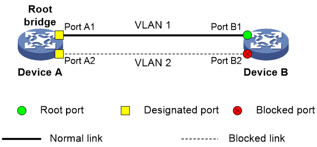

Figure 18 Rapid state transition of an RSTP designated port
If the upstream device is a third-party device, the rapid state transition implementation might be limited as follows:
·     The upstream device uses a rapid transition mechanism similar to that of RSTP.
·     The downstream device runs MSTP and does not operate in RSTP mode.
In this case, the following occurs:
1.     The root port on the downstream device receives no agreement from the upstream device.
2.     It sends no agreement to the upstream device.
As a result, the designated port of the upstream device can transit to the forwarding state only after a period twice the forward delay.
To enable the designated port of the upstream device to transit its state rapidly, enable No Agreement Check on the downstream device's port.

As shown in Figure 19, an IRF fabric connects to two user networks through double links.
·     Device A and Device B form the IRF fabric.
·     The spanning tree feature is disabled on Device A and Device B and enabled on all devices in user network 1 and user network 2.
·     The IRF fabric transparently transmits BPDUs for both user networks and is not involved in the calculation of spanning trees.
When the network topology changes, it takes time for the IRF fabric to update its MAC address table and ARP table. During this period, traffic in the network might be interrupted.
Figure 19 TC Snooping application scenario
image14.emf
To avoid traffic interruption, you can enable TC Snooping on the IRF fabric. After receiving a TC-BPDU through a port, the IRF fabric updates MAC address table and ARP table entries associated with the port's VLAN. In this way, TC Snooping prevents topology change from interrupting traffic forwarding in the network. For more information about the MAC address table and the ARP table, see "Configuring the MAC address table" and Layer 3—IP Services Configuration Guide.

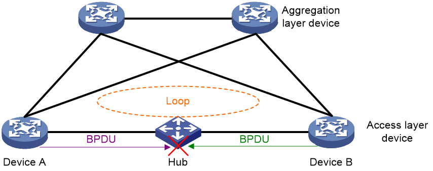

Enabling loop guard
Configure loop guard on the root port and alternate ports of a device.
By continuing to receive BPDUs from the upstream device, a device can maintain the state of the root port and blocked ports. However, link congestion or unidirectional link failures might cause these ports to fail to receive BPDUs from the upstream devices. In this situation, the device reselects the following port roles:
·     Those ports in forwarding state that failed to receive upstream BPDUs become designated ports.
·     The blocked ports transit to the forwarding state.
As a result, loops occur in the switched network. The loop guard feature can suppress the occurrence of such loops.
The initial state of a loop guard-enabled port is discarding in every MSTI. When the port receives BPDUs, it transits its state. Otherwise, it stays in the discarding state to prevent temporary loops.
Do not enable loop guard on a port that connects user terminals. Otherwise, the port stays in the discarding state in all MSTIs because it cannot receive BPDUs.
On a port, the loop guard feature is mutually exclusive with the root guard feature or the edge port setting.
A loop guard-enabled interface can receive BPDUs and transit from the discarding state to the forwarding state after two forward delays if one of the following events occurs:

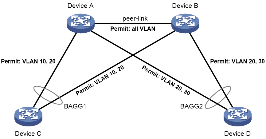

Disabling dispute guard
Dispute guard can be triggered by unidirectional link failures. If an upstream port receives inferior BPDUs from a downstream designated port in forwarding or learning state because of a unidirectional link failure, a loop appears. Dispute guard blocks the upstream designated port to prevent the loop.
As shown in Figure 20, in normal conditions, the spanning tree calculation result is as follows:
·     Device A is the root bridge, and Port A1 is a designated port.
·     Port B1 is blocked.
When the link between Port A1 and Port B1 fails in the direction of Port A1 to Port B1 and becomes unidirectional, the following events occur:
1.     Port A1 can only receive BPDUs and cannot send BPDUs to Port B1.
2.     Port B1 does not receive BPDUs from Port A1 for a certain period of time.
3.     Device B determines itself as the root bridge.
4.     Port B1 sends its BPDUs to Port A1.
5.     Port A1 determines the received BPDUs are inferior to its own BPDUs. A dispute is detected.
6.     Dispute guard is triggered and blocks Port A1 to prevent a loop.

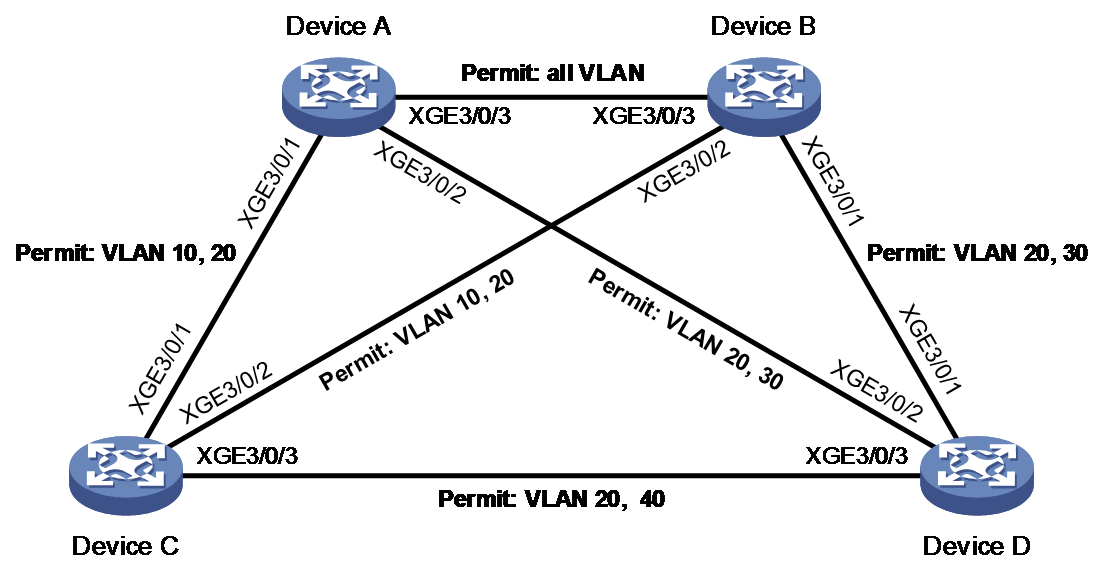

As shown in Figure 21, in normal conditions, Device A is the root bridge, and Port B1 and Port C1 are root ports. When the links between Device A and Device B become unidirectional (the links fail in the direction of Port A1 to Port B1), the following events occur:
1.     Device B cannot receive BPDUs from Device A.
2.     Device B determines itself as the root bridge.
3.     Port B1 sends BPDUs in which the root bridge is Device B to Port C1.
4.     Port C1 receives BPDUs from two root bridges, Device A and Device B. A dispute is detected.
5.     Dispute guard is triggered and blocks Port C1 to avoid a loop.
Figure 21 Dispute guard triggering scenario (on a root port)
However, dispute guard might disrupt the network connectivity. You can disable dispute guard to avoid connectivity loss in VLAN networks. As shown in Figure 22, the spanning tree feature is disabled on Device B and enabled on Device A and device C. Device B transparently transmits BPDUs.
Device C cannot receive superior BPDUs of VLAN 1 from Device A because Port B1 of Device B is configured to deny packets of VLAN 1. Device C determines itself as the root bridge after a certain period of time. Then, Port C1 sends an inferior BPDU of VLAN 100 to Device A.
When Device A receives the inferior BPDU, dispute guard blocks Port A1, which causes traffic interruption. To ensure service continuity, you can disable dispute guard on Device A to prevent the link from being blocked.
Figure 22 Disabling dispute guard application scenario
You can disable dispute guard if the network does not have unidirectional link failures.

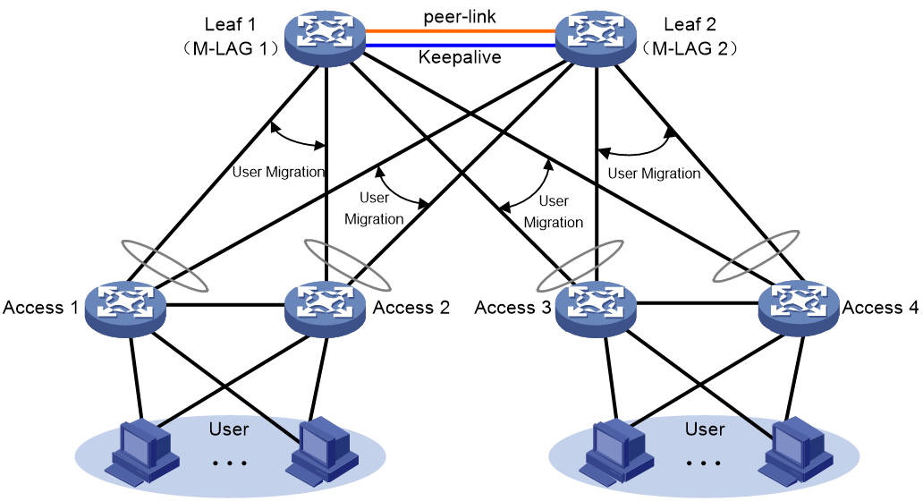

Configuring TC groups
As shown in Figure 23, two devices at the leaf tier form an M-LAG system. The M-LAG system is connected to two loops (Access 1 — Access 2 — M-LAG and Access 3 — Access 4 — M-LAG), and STP runs on all devices. By default, any topology change by a device causes TC-BPDUs to be sent to both loops and create excessive TC-BPDUs in the network, which impacts system stability. If the topology changes, the interfaces for the user onboarding service on the leaf devices might change. In this case, users must be re-authenticated on other interfaces of the leaf devices to come online. During the re-authentication process, service traffic might be lost.
Figure 23 Network diagram
To address this issue, you can configure topology change (TC) groups. A TC group is a logical combination of multiple interfaces on a device, and supports a maximum of two interfaces. As shown in Figure 24, the two M-LAG interfaces connecting to Access 1 and Access 2 are added to TC group 1, and the two M-LAG interfaces connecting to Access 3 and Access 4 are added to TC group 2 on the leaf devices.
Figure 24 Network diagram
After TC groups are configured, the network can achieve the following functions:
·     When an M-LAG interface in a TC group receives a TC-BPDU, it forwards it only to the other M-LAG interface in the same TC group. This mechanism reduces the number of TC-BPDUs in the entire network, isolating the TC-BPDUs of the Access 1—Access 2—M-LAG loop and those of the Access 3—Access 4—M-LAG loop. When leaf devices are connected to many loops, this mechanism reduces the impact of exchanging TC-BPDU packets among loops.
·     When the network topology changes, static users, MAC authentication users, and 802.1X users in the same TC group can migrate between the two M-LAG interfaces in the TC group without authentication, enabling users to quickly come online again. For more information about the configuration procedures, migration conditions, and migration rules for authentication-free migration, see port security configuration in Security Configuration Guide.

As shown in Figure 25, Device A and Device B are connected via a HUB, which creates a loop in the network. Since BPDUs are point-to-point frames, once they are transmitted from a device and received by the next node, their transmission is terminated. The HUB acts as a blackhole for BPDUs. BPDUs cannot be transmitted between Device A and Device B through the HUB, and Device A and Device B cannot eliminate the loop through correct spanning tree topology calculation. Therefore, a method to detect BPDU blackholes is crucial for devices to block links to blackholes when detecting them, effectively eliminating potential loop risks.
Figure 25 Network diagram
Spanning tree blackhole detection feature can detect the presence of BPDU blackholes in the port links. Its working mechanism is as follows.
1.     Blackhole verification phase.
A port enabled with spanning tree blackhole detection will start the BPDU reception timer of the blackhole detection feature. If the port receives a BPDU before the BPDU reception timer expires, the port resets the BPDU reception timer. If the BPDU reception timer expires, BPDU blackholes might exist on the network. As a result, the device fails to receive BPDUs for a long time, and the port starts to send spanning tree blackhole detection packets continuously.
Spanning tree blackhole detection packet is a type of Layer 2 packets defined by H3C. Different from the BPDU, the spanning tree blackhole detection packet can be transparently transmitted by the HUB, and will be sent continuously at a fixed time interval after being triggered to send.
Use the stp global blackhole-detection rx-bpdu timeout command to set the BPDU reception timer. Use the stp timer blackhole-detection-interval or stp global timer blackhole-detection-interval command to set the interval for sending spanning tree blackhole detection packets.
2.     Blackhole confirmation phase.
If the port is triggered to send spanning tree blackhole detection packets and receives a BPDU, it proves that no BPDU blackhole exist between the devices. The port stops transmitting the spanning tree blackhole detection packets and resets the BPDU reception timer.
If a port with the spanning tree blackhole detection feature enabled receives a blackhole detection frame while its BPDU reception timer is in a timeout state, it indicates that the link between the local and remote devices is connected. Both devices are capable of sending BPDUs, but neither device receives BPDUs. The local device determines that a BPDU blackhole exists between the two ends of the link.
3.     Blackhole handling phase.
After the device discovers a BPDU blackhole, it blocks the port that receives the spanning tree blackhole detection packet. Loops in the network are eliminated by preventing ports from sending and receiving any user data packets. You can use the stp timer rx-blackhole-timeout or stp global timer rx-blackhole-timeout command to specify the timeout period of the blocked port for spanning tree blackhole detection. If the port does not receive the spanning tree blackhole detection packet again within the timeout period, it means that the BPDU blackhole is eliminated, and the port returns to the normal forwarding state. Otherwise, the port continues to retain the blocking state.
The stp timer blackhole-detection-interval and stp global timer blackhole-detection-interval commands affect the frequency at which the specified port sends spanning tree blackhole detection packets. Set an appropriate packet sending interval as needed.
·     When the sending interval is short, the port sends spanning tree blackhole packets more frequently. The advantage is that the network is more sensitive in detection and response to BPDU blackholes. The disadvantage is that it takes up more device CPU resources. Set a short sending interval in scenarios with strong device performance or a strong need to prevent loops.
·     When the sending interval is long, the port sends spanning tree blackhole packets slowly. The advantage is that it occupies less CPU resources of the device. The disadvantage is that the network detects and responds more slowly to BPDU blackholes. Set a long sending interval in the scenario where the device performance is weak or tolerant of loops.
The spanning tree blackhole detection feature takes effect when the following conditions are met:
·     On the devices at both ends of a link, the spanning tree blackhole detection is enabled both globally and on ports.
·     The link status of the port on which the spanning tree blackhole detection is enabled is up, and the spanning tree feature is enabled.
If the spanning tree blackhole detection is disabled on the port, or the BPDU reception timer on the port has not expired, the port does not perform any processing after receiving the spanning tree blackhole detection packet.
On a device with a long interval for sending BPDUs, set a longer value for the BPDU reception timer to prevent the device port from being blocked when no BPDU blackhole exists on the network. On the device with a short interval for sending BPDUs, set a shorter value for the BPDU reception timer to improve the network's detection speed of BPDU blackholes.
You can use the stp timer blackhole-detection-interval and stp global timer blackhole-detection-interval commands to modify the interval for sending spanning tree blackhole detection packets on a port. When both commands are configured at the same time, the configuration of the stp timer blackhole-detection-interval command takes effect. If no command is configured on the port, the port inherits the configuration of the stp global timer blackhole-detection-interval command.
You can use the stp timer rx-blackhole-timeout and stp global timer rx-blackhole-timeout commands to modify the timeout timer for receiving spanning tree blackhole detection packets on a port. When both commands are configured at the same time, the configuration of the stp timer rx-blackhole-timeout command takes effect. If no command is configured on the port, the port inherits the configuration of the stp global timer rx-blackhole-timeout command.

As shown in Figure 26, all devices on the network are in the same MST region. Device A and Device B work at the distribution layer. Device C and Device D work at the access layer.
Configure MSTP so that frames of different VLANs are forwarded along different spanning trees.
·     VLAN 10 frames are forwarded along MSTI 1.
·     VLAN 30 frames are forwarded along MSTI 3.
·     VLAN 40 frames are forwarded along MSTI 4.
·     VLAN 20 frames are forwarded along MSTI 0.
VLAN 10 and VLAN 30 are terminated on the distribution layer devices, and VLAN 40 is terminated on the access layer devices. The root bridges of MSTI 1 and MSTI 3 are Device A and Device B, respectively, and the root bridge of MSTI 4 is Device C.
Figure 26 Network diagram

In this example, Device B has the lowest root bridge ID. As a result, Device B is elected as the root bridge in MSTI 0.
When the network is stable, you can use the display stp brief command to display brief spanning tree information on each device.
# Display brief spanning tree information on Device A.
[DeviceA] display stp brief
 MST ID      Port                         Role  STP State     Protection
 0           Ten-GigabitEthernet3/0/1     ALTE  DISCARDING    NONE
 0           Ten-GigabitEthernet3/0/2     DESI  FORWARDING    NONE
 0           Ten-GigabitEthernet3/0/3     ROOT  FORWARDING    NONE
 1           Ten-GigabitEthernet3/0/1     DESI  FORWARDING    NONE
 1           Ten-GigabitEthernet3/0/3     DESI  FORWARDING    NONE
 3           Ten-GigabitEthernet3/0/2     DESI  FORWARDING    NONE
 3           Ten-GigabitEthernet3/0/3     ROOT  FORWARDING    NONE
# Display brief spanning tree information on Device B.
[DeviceB] display stp brief
 0           Ten-GigabitEthernet3/0/1     DESI  FORWARDING    NONE
 0           Ten-GigabitEthernet3/0/3     DESI  FORWARDING    NONE
 1           Ten-GigabitEthernet3/0/2     DESI  FORWARDING    NONE
 1           Ten-GigabitEthernet3/0/3     ROOT  FORWARDING    NONE
 3           Ten-GigabitEthernet3/0/1     DESI  FORWARDING    NONE
 3           Ten-GigabitEthernet3/0/3     DESI  FORWARDING    NONE
# Display brief spanning tree information on Device C.
[DeviceC] display stp brief
 0           Ten-GigabitEthernet3/0/2     ROOT  FORWARDING    NONE
 1           Ten-GigabitEthernet3/0/1     ROOT  FORWARDING    NONE
 1           Ten-GigabitEthernet3/0/2     ALTE  DISCARDING    NONE
 4           Ten-GigabitEthernet3/0/3     DESI  FORWARDING    NONE
# Display brief spanning tree information on Device D.
[DeviceD] display stp brief
 0           Ten-GigabitEthernet3/0/1     ROOT  FORWARDING    NONE
 0           Ten-GigabitEthernet3/0/2     ALTE  DISCARDING    NONE
 0           Ten-GigabitEthernet3/0/3     ALTE  DISCARDING    NONE
 3           Ten-GigabitEthernet3/0/1     ROOT  FORWARDING    NONE
 3           Ten-GigabitEthernet3/0/2     ALTE  DISCARDING    NONE
 4           Ten-GigabitEthernet3/0/3     ROOT  FORWARDING    NONE
Based on the output, you can draw each MSTI mapped to each VLAN, as shown in Figure 27.
Figure 27 MSTIs mapped to different VLANs
Example: Configuring PVST
As shown in Figure 28, Device A and Device B work at the distribution layer, and Device C and Device D work at the access layer.
Configure PVST to meet the following requirements:
·     Frames of a VLAN are forwarded along the spanning trees of the VLAN.
·     VLAN 10, VLAN 20, and VLAN 30 are terminated on the distribution layer devices, and VLAN 40 is terminated on the access layer devices.
·     The root bridge of VLAN 10 and VLAN 20 is Device A.
·     The root bridge of VLAN 30 is Device B.
·     The root bridge of VLAN 40 is Device C.
Figure 28 Network diagram
 VLAN ID     Port                         Role  STP State     Protection
 10          Ten-GigabitEthernet3/0/1     DESI  FORWARDING    NONE
 10          Ten-GigabitEthernet3/0/3     DESI  FORWARDING    NONE
 20          Ten-GigabitEthernet3/0/1     DESI  FORWARDING    NONE
 20          Ten-GigabitEthernet3/0/2     DESI  FORWARDING    NONE
 20          Ten-GigabitEthernet3/0/3     DESI  FORWARDING    NONE
 30          Ten-GigabitEthernet3/0/2     DESI  FORWARDING    NONE
 30          Ten-GigabitEthernet3/0/3     ROOT  FORWARDING    NONE
 10          Ten-GigabitEthernet3/0/2     DESI  FORWARDING    NONE
 10          Ten-GigabitEthernet3/0/3     ROOT  FORWARDING    NONE
 20          Ten-GigabitEthernet3/0/3     ROOT  FORWARDING    NONE
 30          Ten-GigabitEthernet3/0/1     DESI  FORWARDING    NONE
 30          Ten-GigabitEthernet3/0/3     DESI  FORWARDING    NONE
 10          Ten-GigabitEthernet3/0/1     ROOT  FORWARDING    NONE
 10          Ten-GigabitEthernet3/0/2     ALTE  DISCARDING    NONE
 20          Ten-GigabitEthernet3/0/1     ROOT  FORWARDING    NONE
 20          Ten-GigabitEthernet3/0/2     ALTE  DISCARDING    NONE
 40          Ten-GigabitEthernet3/0/3     DESI  FORWARDING    NONE
 20          Ten-GigabitEthernet3/0/1     ALTE  DISCARDING    NONE
 20          Ten-GigabitEthernet3/0/2     ROOT  FORWARDING    NONE
 20          Ten-GigabitEthernet3/0/3     ALTE  DISCARDING    NONE
 30          Ten-GigabitEthernet3/0/1     ROOT  FORWARDING    NONE
 30          Ten-GigabitEthernet3/0/2     ALTE  DISCARDING    NONE
 40          Ten-GigabitEthernet3/0/3     ROOT  FORWARDING    NONE
Based on the output, you can draw a topology for each VLAN spanning tree, as shown in Figure 29.
Figure 29 VLAN spanning tree topologies

As shown in Figure 30, Device A and Device B work at the distribution layer, and Device C and Device D work at the access layer.
Configure M-LAG on Device A and Device B. In the M-LAG system, Device A is the primary M-LAG device, and Device B is the secondary M-LAG device.
Configure PVST on the devices to meet the following requirements:
·     VLAN 10, VLAN 20, and VLAN 30 are terminated on the distribution layer devices.
·     The root bridge of VLAN 10, VLAN 20, and VLAN 30 is the M-LAG system formed by Device A and Device B.
·     As a best practice, do not connect ports on Device A and Device B that have the same port ID with each other, for example Layer 2 aggregate ports. Otherwise, when Device A and Device B communicate through the link, the spanning tree protocol determines that the device receives its own BPDUs. Loop guard will block the link, though spanning tree features are not affected.
·     You can view port IDs of interfaces on the device by using the display stp interface command.
·     The preceding restrictions do not apply to peer-link interfaces and their member ports.
Figure 30 Network diagram
