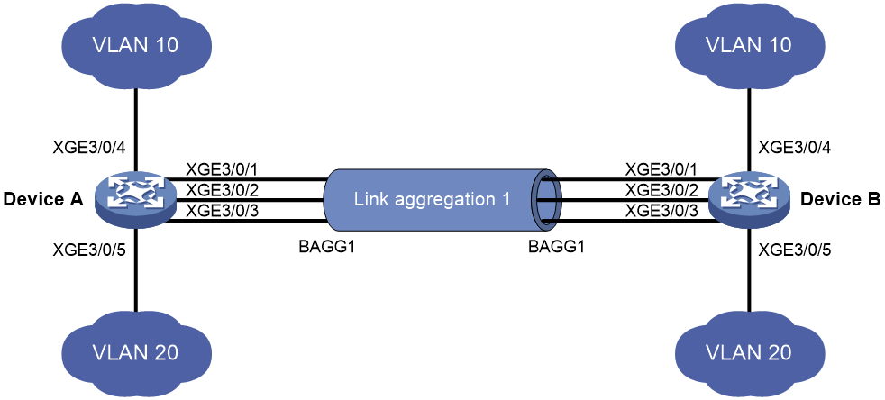

As shown in Figure 3, an interface enabled with automatic assignment joins a dynamic aggregation group based on the peer information in the LACPDUs received from the aggregation peer. If none of the existing dynamic aggregation groups is qualified, the device automatically creates a new dynamic aggregation group, Then, the device assigns the interface to that group and synchronizes the interface's attribute configurations to the aggregate interface.
A dynamic aggregation group that contains automatically assigned member ports selects a reference port and Selected ports as described in "How dynamic link aggregation works." The assignment methods of member ports do not change the processes of reference port selection and Selected port selection.
Figure 3 Automatic member port assignment process
Automatic link aggregation
Automatic link aggregation enables two devices to automatically create a dynamic link aggregation between them by using LLDP.
After you enable automatic link aggregation and LLDP on two connected devices, they automatically establish a dynamic link aggregation based on the information in incoming LLDP frames. The devices each automatically create a dynamic aggregate interface and assign the redundant ports connected to the peer to the aggregation group of that interface. When assigning the first member port to the aggregate group, the device synchronizes the member port's attribute configuration to the aggregate interface.
An automatically created dynamic aggregation group selects a reference port and Selected ports as described in "How dynamic link aggregation works." The aggregation group creation methods do not change the processes of reference port selection and Selected port selection.

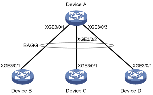

S-MLAG
Simple multichassis link aggregation (S-MLAG) enhances dynamic link aggregation to establish an aggregation that spans multiple standalone devices to a remote device.
An S-MLAG multichassis aggregation connects one dynamic Layer 2 aggregate interface on each S-MLAG device to the remote device, as shown in Figure 5.
S-MLAG uses an S-MLAG group to manage the aggregate interfaces for each aggregation, and it runs LACP to maintain each aggregation as does dynamic link aggregation. To the remote device, the S-MLAG devices appear as one peer aggregation system.
Use S-MLAG only to establish aggregate links with servers.
Figure 5 S-MLAG application scenario

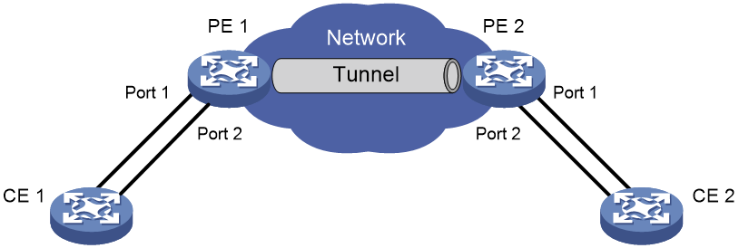

Enabling transparent LACPDU transmission
To establish a dynamic aggregation between two remote CEs in an L2VPN network, use transparent LACPDU transmission on the PEs to which the CEs are attached, as shown in Figure 6.
This feature enables the PEs to forward LACPDUs for the CEs to establish a dynamic aggregation.
If this feature is disabled, the PEs terminate the LACPDUs. The remote CEs cannot establish dynamic aggregations.
Figure 6 Application scenario of transparent LACPDU transmission
Perform the following tasks on PEs:
1.     Configure the untagged or default frame match criterion for the Ethernet service instances on the interfaces connected to CEs.
2.     Map the Ethernet service instances to different VSIs and set the access mode to Ethernet for the VSIs.
For more information about L2VPN and Ethernet service instances, see L2VPN configuration in MPLS Configuration Guide.
When you use this feature on the PEs, follow these guidelines:
·     Enable transparent LACPDU transmission on the interfaces that transmit traffic between CEs and PEs and between PEs.
·     Since transparent LACPDU transmission can affect the selection of member ports, this feature can only be configured on a single inbound and outbound port of the PEs, not on multiple inbound and outbound ports.
·     Aggregation member ports do not support this feature.
·     LSCM1GT48SC0 modules do not support this feature.

On the network shown in Figure 8, perform the following tasks:
·     Configure a Layer 2 static aggregation group on both Device A and Device B.
·     Enable VLAN 10 at one end of the aggregate link to communicate with VLAN 10 at the other end.
·     Enable VLAN 20 at one end of the aggregate link to communicate with VLAN 20 at the other end.
Figure 8 Network diagram
1.     Configure Device A:
# Create VLAN 10, and assign port Ten-GigabitEthernet 3/0/4 to VLAN 10.
<DeviceA> system-view
[DeviceA] vlan 10
[DeviceA-vlan10] port ten-gigabitethernet 3/0/4
[DeviceA-vlan10] quit
# Create VLAN 20, and assign port Ten-GigabitEthernet 3/0/5 to VLAN 20.
[DeviceA] vlan 20
[DeviceA-vlan20] port ten-gigabitethernet 3/0/5
[DeviceA-vlan20] quit
# Create Layer 2 aggregate interface Bridge-Aggregation 1.
[DeviceA] interface bridge-aggregation 1
[DeviceA-Bridge-Aggregation1] quit
# Assign ports Ten-GigabitEthernet 3/0/1 through Ten-GigabitEthernet 3/0/3 to link aggregation group 1.
[DeviceA] interface ten-gigabitethernet 3/0/1
[DeviceA-Ten-GigabitEthernet3/0/1] port link-aggregation group 1
[DeviceA-Ten-GigabitEthernet3/0/1] quit
[DeviceA] interface ten-gigabitethernet 3/0/2
[DeviceA-Ten-GigabitEthernet3/0/2] port link-aggregation group 1
[DeviceA-Ten-GigabitEthernet3/0/2] quit
[DeviceA] interface ten-gigabitethernet 3/0/3
[DeviceA-Ten-GigabitEthernet3/0/3] port link-aggregation group 1
[DeviceA-Ten-GigabitEthernet3/0/3] quit
# Configure Layer 2 aggregate interface Bridge-Aggregation 1 as a trunk port and assign it to VLANs 10 and 20.
[DeviceA-Bridge-Aggregation1] port link-type trunk
[DeviceA-Bridge-Aggregation1] port trunk permit vlan 10 20
2.     Configure Device B in the same way Device A is configured. (Details not shown.)

Example: Configuring S-MLAG
Device B, Device C, and Device D are standalone devices. As shown in Figure 13, configure Device B, Device C, and Device D as S-MLAG devices to establish a multidevice aggregate link with Device A.
Figure 13 Network diagram
