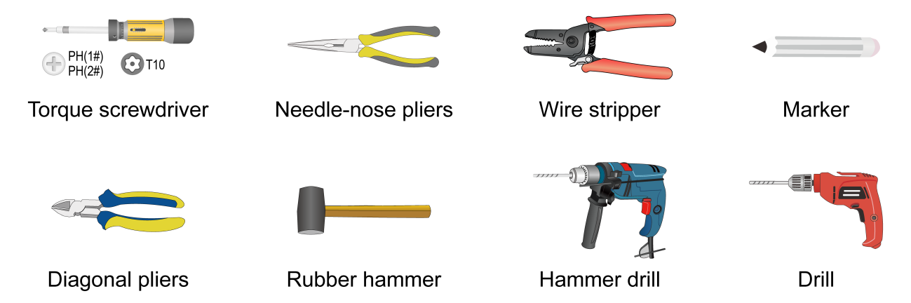

Installation tools
When installing the AP, you might need the following tools. Prepare the installation tools yourself as required.
Figure2-1 Installation tools

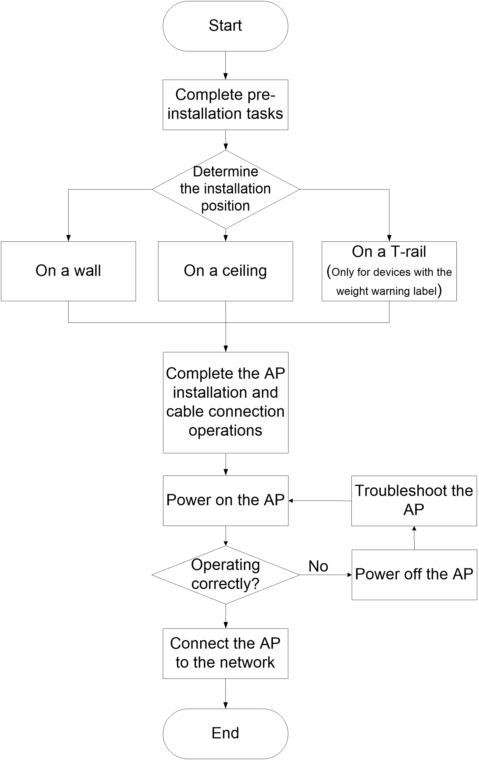

Determining the installation position
Determine the installation position by observing the following principles:
·     Few obstacles such as wall exist between the AP and clients.
·     The AP is far away from electronic devices (such as microwave oven) that might generate radio frequency (RF) noise.
·     The AP does not hinder people’s daily work and life.
·     The place is not water seeping, water soaking, and condensing.
3 Installing the AP
IMPORTANT
IMPORTANT:
·     Plan the order of cable connections according to the installation scenario of the device. When installing at a higher position, connect the cables to the device before installation as a best practice.
·     For models with a weight-warning label, use wall mounting or T-rail mounting as a best practice.

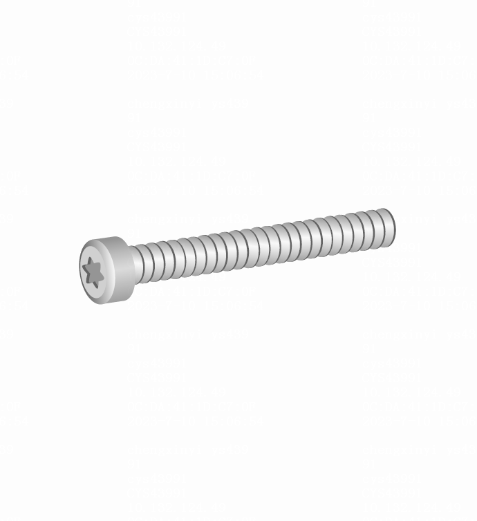

·     Install an M3 × 23.5 security screw as required.
·     Since the installation steps are the same, the following illustrations are only provided as an example for one model. For illustrations of other models, see the corresponding quick installation guide.

M3 × 23.5 security screw (provided)

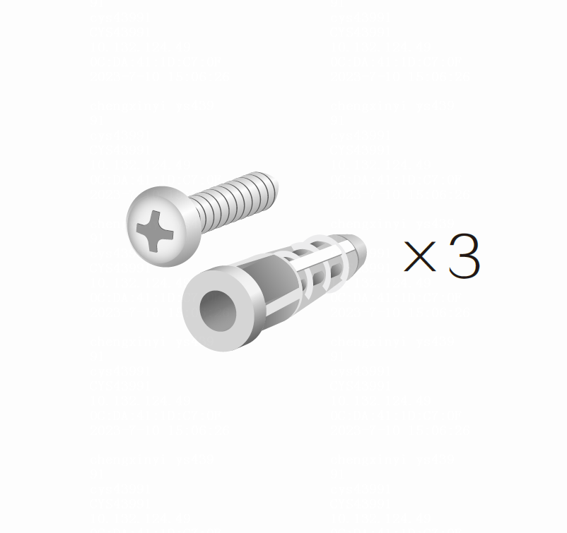

Screw and screw anchor (provided)
M4 × 30 pan-head screw (provided)

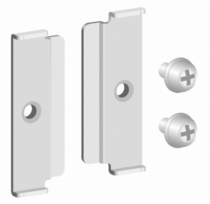

T-rail kit
Supported:
·     WA7538
·     WA7638
Not supported:
WA7320i

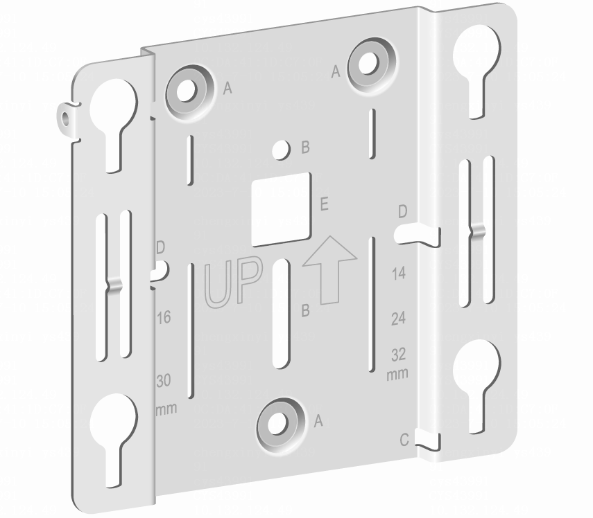

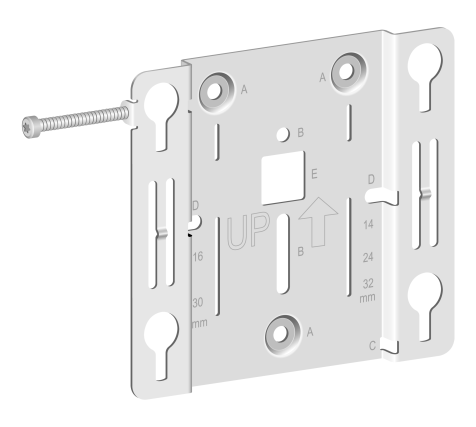

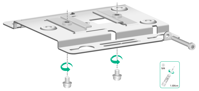

Figure3-1 Mounting bracket
(1) (A holes) Wall/ceiling mounting holes, used for securing the mounting bracket to the wall/ceiling
(2) (B holes) T-rail mounting holes, used for securing the mounting bracket to a T-rail
(3) (C hole) Auxiliary cable management hole. Thread a cable tie through the hole to secure cables.
(4) (D holes) 86 panel mounting holes, used for securing the mounting bracket to an 86 panel. The distance between the two holes is 60 mm (2.36 in).
(5) (E hole) Thread a cable through the hole to connect the AP
(6) Security hole, applicable to the M3 × 23.5 security screw

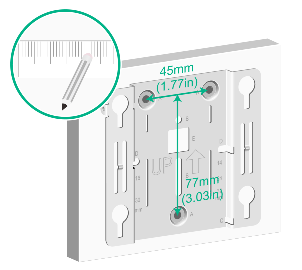

Mounting the AP on a wall
1.     Place the mounting bracket against the wall and mark the installation holes on the wall.
Figure3-2 Marking the installation holes on the wall (using the WA7539 as an example)

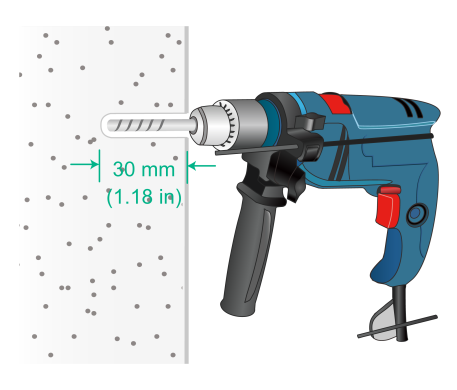

2.     Drill three holes with a diameter of 6 mm (0.24 in) and a depth of 30 mm (1.18 in) at the marked locations, as shown in Figure3-3.
Figure3-3 Drilling holes in the wall (using the WA7539 as an example)

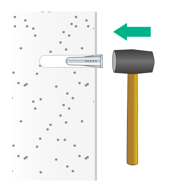

3.     Insert a screw anchor into each hole, and tap the screw anchor with a rubber hammer until it is all flush with the wall surface, as shown in Figure3-4.
Figure3-4 Hammering the screw anchor into the wall (using the WA7539 as an example)
4.     Thread the M3 × 23.5 security screw through the security hole in the mounting bracket. Make sure the screw does not block the keyhole slot.

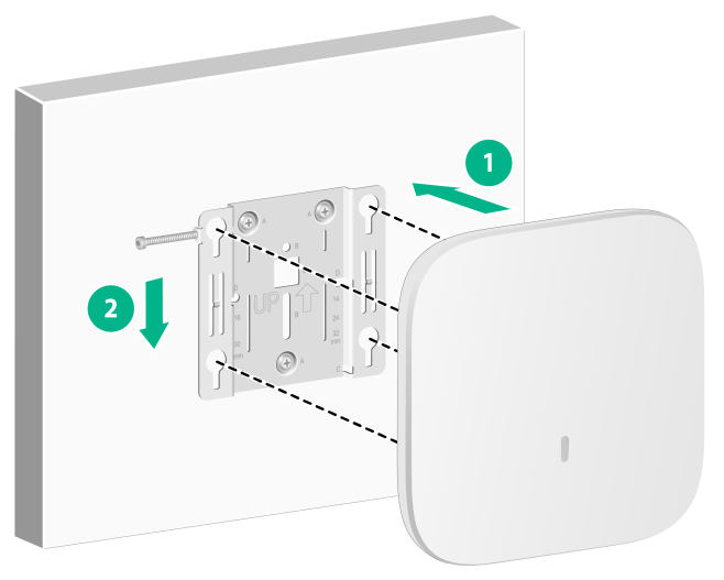

6.     Position the four pegs at the AP rear into the keyhole slots in the mounting bracket and then slide the AP down until it sits securely in the keyhole slots, as shown in Figure3-7.
Figure3-7 Attaching the AP to the mounting bracket (using the WA7539 as an example)
7.     Use a security Torx screwdriver to fasten the M3 × 23.5 security screw.
Figure3-8 Fastening the M3 × 23.5 security screw (using the WA7539 as an example)

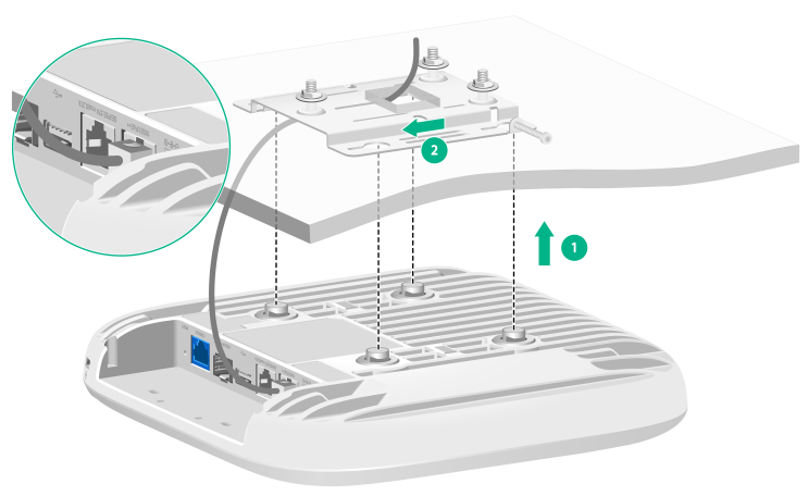

Mounting the AP on a ceiling
CAUTION
CAUTION:
The ceiling for installing the AP must be less than 18 mm (0.71 in) in thickness, and can bear a load of 5 kg (11.02 lb). If you must install the AP on a ceiling not strong enough, use boards to reinforce the ceiling.
The installation method for the M3 × 23.5 security screw is similar when the AP is mounted on the wall and on the ceiling.
To mount the AP on a ceiling:
1.     Remove the ceiling tile.

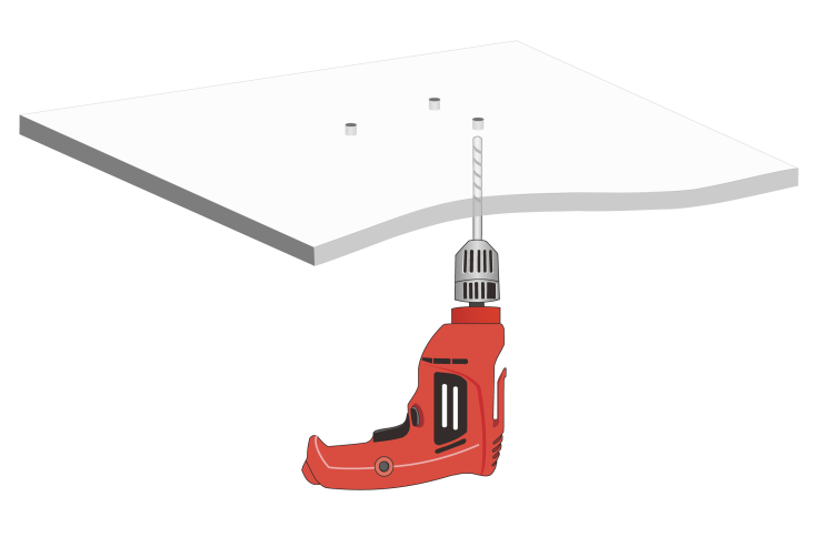

2.     Place the mounting bracket against the ceiling tile and mark the installation holes on the ceiling tile. Drill three holes with a diameter of 6 mm (0.24 in) at the marked positions, as shown in Figure3-9.
Figure3-9 Drilling holes in the ceiling tile (using the WA7539 as an example)

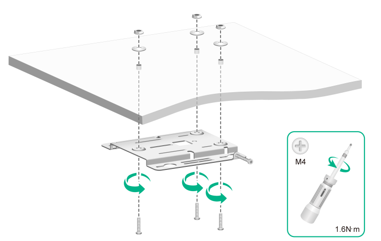

3.     Thread the pan-head screws through the installation holes in the mounting bracket and into the holes in the ceiling tile. Fasten washers and nuts at the other side of the ceiling to secure the mounting bracket to the ceiling, as shown in Figure3-10.
Figure3-10 Attaching the mounting bracket to the ceiling (using the WA7539 as an example)
4.     Connect a cable to the AP. Then position the four pegs at the AP rear into the keyhole slots in the mounting bracket and slide the AP until it sits securely in the keyhole slots.
Figure3-11 Attaching the AP to the mounting bracket (using the WA7539 as an example)

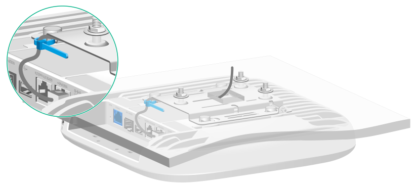

(Optional.) You can use a cable tie to secure the cable before attaching the AP to the mounting bracket. First thread the cable tie through the auxiliary hole in the mounting bracket, leaving the cable tie unfastened, and then adjust the cable length and fasten the cable tie to secure the cable.
No cable tie is provided with the AP. Prepare one yourself as required.
Figure3-12 Using a cable tie to secure the cable (using the WA7539 as an example)
5.     Verify that the AP is installed securely to prevent it from falling off.

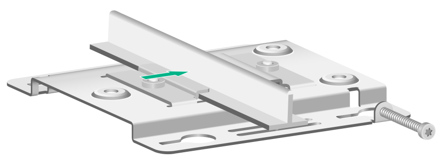

1.     Use M4 T-rail clip screws to secure the T-rail clips to the mounting bracket. Do not fasten the left screw all the way in, leaving a certain space for adjusting the distance between the T-rail clips.
Figure3-13 Installing T-rail clips (using the WA7539 as an example)
2.     Adjust the distance between T-rail clips based on the width of the T-rail. Use a Phillips screwdriver to fasten the left M4 T-rail clip screw.
Figure3-14 Adjusting the distance between the T-rail clips (using the WA7539 as an example)

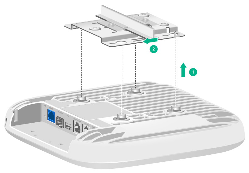

3.     Position the four pegs at the AP rear into the keyhole slots in the mounting bracket and slide the AP until it sits securely in the keyhole slots.
Figure3-15 Install the AP (using the WA7539 as an example)

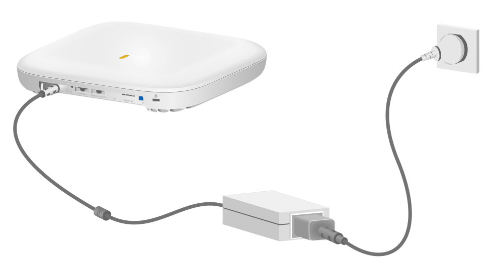

As shown in Figure4-1, you can use a power adapter to connect the AP to a local power source.
Figure4-1 Using a power adapter to connect the AP to a local power source (using the WA7539 as an example)

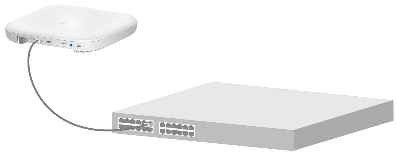

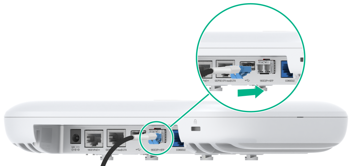

Connecting an Ethernet cable
·     The WA7539 and WA7638 require an 802.3bt-compliant PoE switch for supply power. This power supply method can provide a maximum output of 60 W.
·     The WA7320i requires an 802.3at-compliant PoE switch for power supply. This power supply method can provide a maximum output of 30 W.
As shown in Figure4-2, use an Ethernet cable to connect the Ethernet port on the PoE switch to the PoE Ethernet port on the AP. The cable provides power supply connection and network access.
Figure4-2 Connecting an Ethernet cable (using the WA7539 as an example)

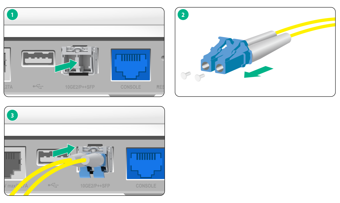

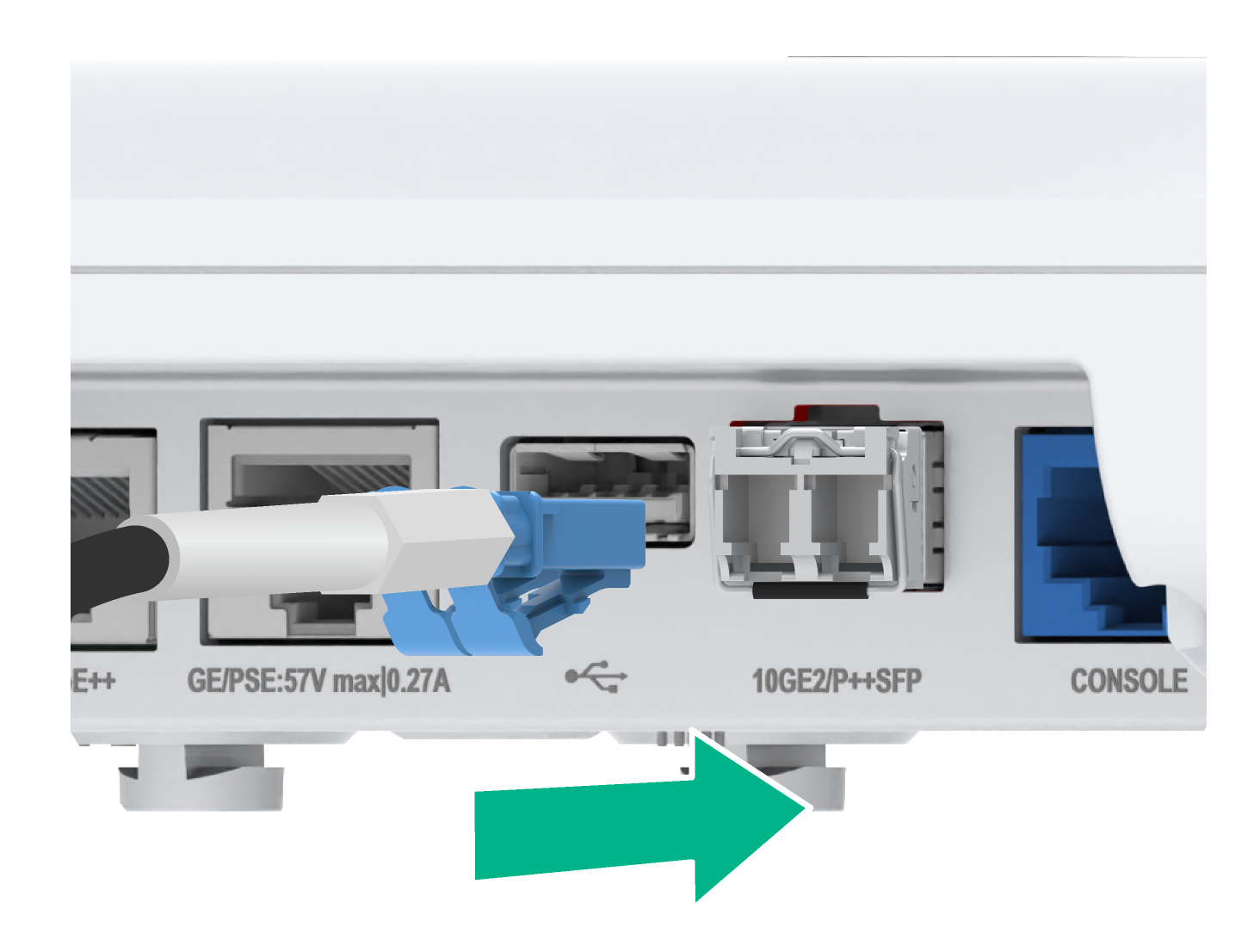

Connecting a common optical fiber
The fiber ports on the AP support only LC connectors. Purchase common transceiver modules yourself as required. For more information about common transceiver modules, see "Appendix C  Optional transceiver modules."
To connect common optical fibers:
1.     Holding both sides of the common transceiver module, insert the transceiver module slowly into the port.
2.     Remove the dust caps from the optical fiber LC connectors.
3.     Identify the Rx and Tx ports on the transceiver module. Use optical fibers with LC connectors to connect the Rx port and Tx port on the transceiver module to the Tx port and Rx port on the peer end, respectively.
Figure4-3 Connecting common optical fibers (using the WA7539 as an example)

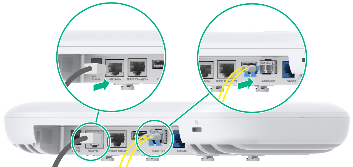

Cable connection schemes
The AP supports different powering and communication options. Read chapters from "Connecting a power adapter" to "Connecting a hybrid copper-fiber cable" and see Table4-1 before you select a cable connection scheme as required.
The following figures are only for your reference.
Powering the AP by using a power adapter
·     Connect an uplink port on the AP to an Ethernet port for communication and power the AP by using a power adapter.
·     Install a common transceiver module in an uplink port on the AP for communication and power the AP by using a power adapter.
Figure4-5 Installing a transceiver module and powering the AP by using a power adapter (using the WA7539 as an example)
Power the AP through PoE
·     Use an Ethernet cable to connect the PoE port on the AP and PoE switch for PoE power supply and communication.
·     Install a common transceiver module in an uplink port on the AP for communication and use an Ethernet cable to connect the AP and PoE switch for PoE power supply.
Figure4-6 Installing a transceiver module and powering the AP through PoE (using the WA7539 as an example)
Powering the AP by using a PoE optical transceiver module
An uplink port on the AP uses a PoE optical transceiver module and a hybrid copper-fiber cable for receiving power and communication. You do not need to connect other cables.
Figure4-7 Powering the AP by using a PoE optical transceiver module (using the WA7539 as an example)
5 (Optional.) Installing the cable management plate
This chapter is applicable only to the WA7539 and WA7638.
After connecting all the cables, install the cable management plate. If an optical fiber is connected to the fiber port, you can remove the U-shaped plastic plate to facilitate cable routing as shown in Figure5-1.
Figure5-1 Removing the U-shaped plastic plate (using the WA7539 as an example)

·     When you power the AP by using a power adapter, verify that the local AC power source is reliably grounded.
