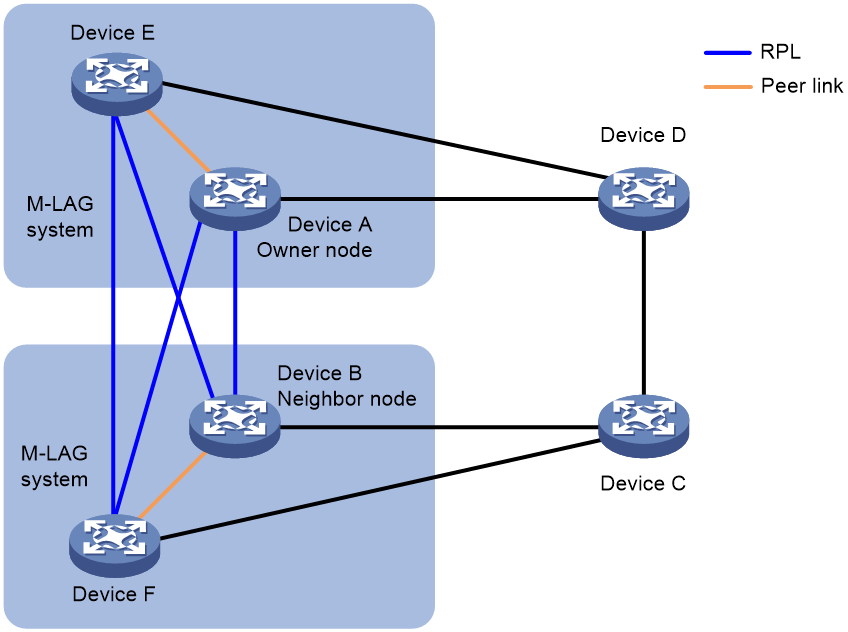

ERPS with M-LAG
M-LAG allows you to virtualize the devices in an ERPS ring into one system through multichassis link, thereby achieving device-level redundancy and load balancing.
You can use the display erps detail ring command to determine whether ERPS works correctly in an M-LAG network. For more information about M-LAG, see Layer 2—LAN Switching Configuration Guide.
Figure 11 ERPS with M-LAG
