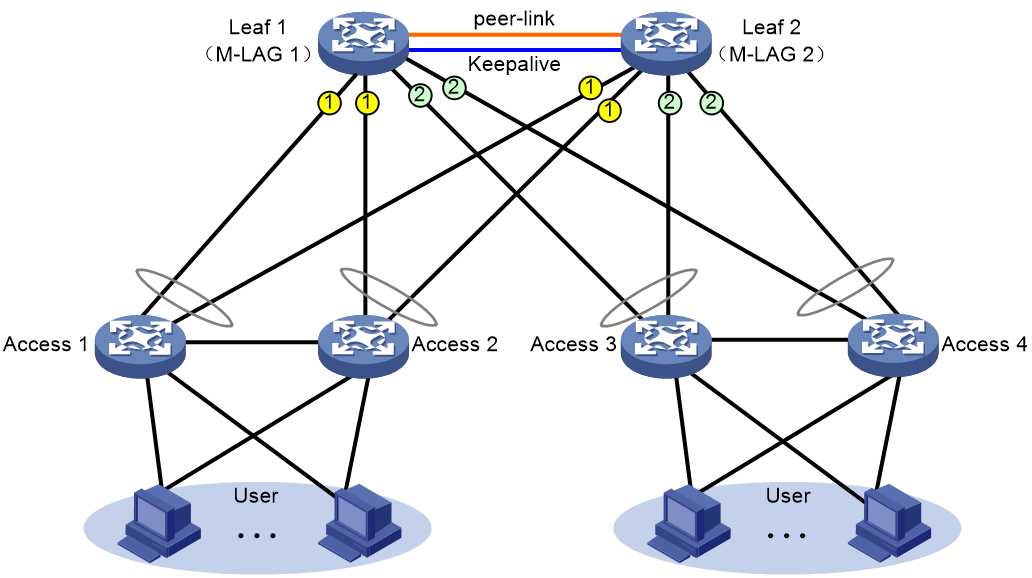

Traffic of a VLAN on a complex network might be blocked by the spanning tree, as shown in Figure 16.
· Port A1 on Device A allows the traffic of VLAN 1 to pass through.
· Port A2 on Device A allows the traffic of VLAN 2 to pass through.
· Port B1 on Device B allows the traffic of VLAN 1 to pass through.
· Port B2 on Device B allows the traffic of VLAN 2 to pass through.
· Device A and Device B run a spanning tree protocol. Device A is the root bridge, and Port A1 and Port A2 are designated ports. On Device B, Port B1 is the root port, and Port B2 is the blocked port. Traffic of VLAN 2 is blocked.
Figure 16 VLAN connectivity blocked by MSTP
Ignoring a VLAN can make ports of the VLAN forward frames correctly rather than comply with the spanning tree calculation result.

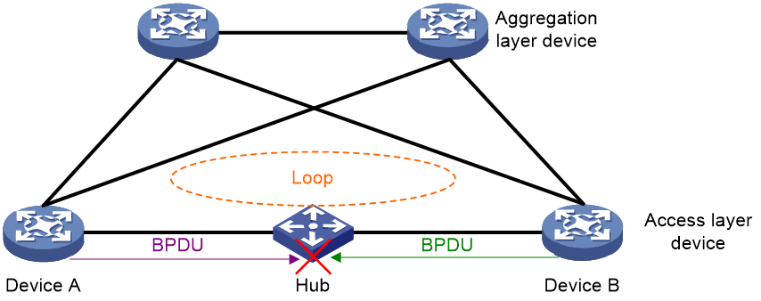

Figure 17 Rapid state transition of an MSTP designated port
Figure 18 Rapid state transition of an RSTP designated port
If the upstream device is a third-party device, the rapid state transition implementation might be limited as follows:
· The upstream device uses a rapid transition mechanism similar to that of RSTP.
· The downstream device runs MSTP and does not operate in RSTP mode.
In this case, the following occurs:
1. The root port on the downstream device receives no agreement from the upstream device.
2. It sends no agreement to the upstream device.
As a result, the designated port of the upstream device can transit to the forwarding state only after a period twice the forward delay.
To enable the designated port of the upstream device to transit its state rapidly, enable No Agreement Check on the downstream device's port.

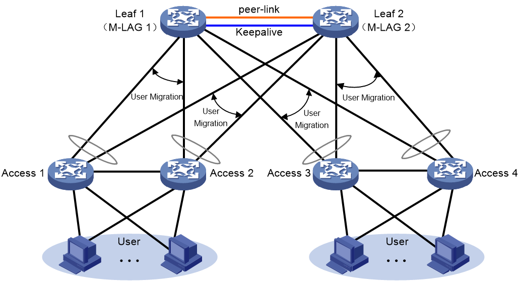

As shown in Figure 19, an IRF fabric connects to two user networks through double links.
· Device A and Device B form the IRF fabric.
· The spanning tree feature is disabled on Device A and Device B and enabled on all devices in user network 1 and user network 2.
· The IRF fabric transparently transmits BPDUs for both user networks and is not involved in the calculation of spanning trees.
When the network topology changes, it takes time for the IRF fabric to update its MAC address table and ARP table. During this period, traffic in the network might be interrupted.
Figure 19 TC Snooping application scenario
To avoid traffic interruption, you can enable TC Snooping on the IRF fabric. After receiving a TC-BPDU through a port, the IRF fabric updates MAC address table and ARP table entries associated with the port's VLAN. In this way, TC Snooping prevents topology change from interrupting traffic forwarding in the network. For more information about the MAC address table and the ARP table, see "Configuring the MAC address table" and Layer 3—IP Services Configuration Guide.

Configuring TC groups
As shown in Figure 23, two devices at the leaf tier form an M-LAG system. The M-LAG system is connected to two loops (Access 1 — Access 2 — M-LAG and Access 3 — Access 4 — M-LAG), and STP runs on all devices. By default, any topology change by a device causes TC-BPDUs to be sent to both loops and create excessive TC-BPDUs in the network, which impacts system stability. If the topology changes, the interfaces for the user onboarding service on the leaf devices might change. In this case, users must be re-authenticated on other interfaces of the leaf devices to come online. During the re-authentication process, service traffic might be lost.
To address this issue, you can configure topology change (TC) groups. A TC group is a logical combination of multiple interfaces on a device, and supports a maximum of two interfaces. As shown in Figure 24, the two M-LAG interfaces connecting to Access 1 and Access 2 are added to TC group 1, and the two M-LAG interfaces connecting to Access 3 and Access 4 are added to TC group 2 on the leaf devices.
After TC groups are configured, the network can achieve the following functions:
· When an M-LAG interface in a TC group receives a TC-BPDU, it forwards it only to the other M-LAG interface in the same TC group. This mechanism reduces the number of TC-BPDUs in the entire network, isolating the TC-BPDUs of the Access 1—Access 2—M-LAG loop and those of the Access 3—Access 4—M-LAG loop. When leaf devices are connected to many loops, this mechanism reduces the impact of exchanging TC-BPDU packets among loops.
· When the network topology changes, static users, MAC authentication users, and 802.1X users in the same TC group can migrate between the two M-LAG interfaces in the TC group without authentication, enabling users to quickly come online again. For more information about the configuration procedures, migration conditions, and migration rules for authentication-free migration, see port security configuration in Security Configuration Guide.
You can add interfaces to a TC group in either of the following methods:
· Execute the port stp tc-group command in interface view.
· Execute the port command in TC group view.
Both methods have the same effect, but their configurations cannot conflict with each other. Once an interface is added to a TC group in one method, it can be removed from the TC group in the other method. However, you cannot directly modify the TC group to which the interface belongs in the other method.

Configuring spanning tree blackhole detection
As shown in Figure 25, Device A and Device B are connected via a HUB, which creates a loop in the network. Since BPDUs are point-to-point frames, once they are transmitted from a device and received by the next node, their transmission is terminated. The HUB acts as a blackhole for BPDUs. BPDUs cannot be transmitted between Device A and Device B through the HUB, and Device A and Device B cannot eliminate the loop through correct spanning tree topology calculation. Therefore, a method to detect BPDU blackholes is crucial for devices to block links to blackholes when detecting them, effectively eliminating potential loop risks.
Spanning tree blackhole detection feature can detect the presence of BPDU blackholes in the port links. Its working mechanism is as follows.
1. Blackhole verification phase.
A port enabled with spanning tree blackhole detection will start the BPDU reception timer of the blackhole detection feature. If the port receives a BPDU before the BPDU reception timer expires, the port resets the BPDU reception timer. If the BPDU reception timer expires, BPDU blackholes might exist on the network. As a result, the device fails to receive BPDUs for a long time, and the port starts to send spanning tree blackhole detection packets continuously.
Spanning tree blackhole detection packet is a type of Layer 2 packets defined by H3C. Different from the BPDU, the spanning tree blackhole detection packet can be transparently transmitted by the HUB, and will be sent continuously at a fixed time interval after being triggered to send.
Use the stp global blackhole-detection rx-bpdu timeout command to set the BPDU reception timer. Use the stp timer blackhole-detection-interval or stp global timer blackhole-detection-interval command to set the interval for sending spanning tree blackhole detection packets.
2. Blackhole confirmation phase.
If the port is triggered to send spanning tree blackhole detection packets and receives a BPDU, it proves that no BPDU blackhole exist between the devices. The port stops transmitting the spanning tree blackhole detection packets and resets the BPDU reception timer.
If a port with the spanning tree blackhole detection feature enabled receives a blackhole detection frame while its BPDU reception timer is in a timeout state, it indicates that the link between the local and remote devices is connected. Both devices are capable of sending BPDUs, but neither device receives BPDUs. The local device determines that a BPDU blackhole exists between the two ends of the link.
3. Blackhole handling phase.
After the device discovers a BPDU blackhole, it blocks the port that receives the spanning tree blackhole detection packet. Loops in the network are eliminated by preventing ports from sending and receiving any user data packets. You can use the stp timer rx-blackhole-timeout or stp global timer rx-blackhole-timeout command to specify the timeout period of the blocked port for spanning tree blackhole detection. If the port does not receive the spanning tree blackhole detection packet again within the timeout period, it means that the BPDU blackhole is eliminated, and the port returns to the normal forwarding state. Otherwise, the port continues to retain the blocking state.
The stp timer blackhole-detection-interval and stp global timer blackhole-detection-interval commands affect the frequency at which the specified port sends spanning tree blackhole detection packets. Set an appropriate packet sending interval as needed.
· When the sending interval is short, the port sends spanning tree blackhole packets more frequently. The advantage is that the network is more sensitive in detection and response to BPDU blackholes. The disadvantage is that it takes up more device CPU resources. Set a short sending interval in scenarios with strong device performance or a strong need to prevent loops.
· When the sending interval is long, the port sends spanning tree blackhole packets slowly. The advantage is that it occupies less CPU resources of the device. The disadvantage is that the network detects and responds more slowly to BPDU blackholes. Set a long sending interval in the scenario where the device performance is weak or tolerant of loops.
The spanning tree blackhole detection feature takes effect when the following conditions are met:
· On the devices at both ends of a link, the spanning tree blackhole detection is enabled both globally and on ports.
· The link status of the port on which the spanning tree blackhole detection is enabled is up, and the spanning tree feature is enabled.
If the spanning tree blackhole detection is disabled on the port, or the BPDU reception timer on the port has not expired, the port does not perform any processing after receiving the spanning tree blackhole detection packet.
On a device with a long interval for sending BPDUs, set a longer value for the BPDU reception timer to prevent the device port from being blocked when no BPDU blackhole exists on the network. On the device with a short interval for sending BPDUs, set a shorter value for the BPDU reception timer to improve the network's detection speed of BPDU blackholes.
You can use the stp timer blackhole-detection-interval and stp global timer blackhole-detection-interval commands to modify the interval for sending spanning tree blackhole detection packets on a port. When both commands are configured at the same time, the configuration of the stp timer blackhole-detection-interval command takes effect. If no command is configured on the port, the port inherits the configuration of the stp global timer blackhole-detection-interval command.
You can use the stp timer rx-blackhole-timeout and stp global timer rx-blackhole-timeout commands to modify the timeout timer for receiving spanning tree blackhole detection packets on a port. When both commands are configured at the same time, the configuration of the stp timer rx-blackhole-timeout command takes effect. If no command is configured on the port, the port inherits the configuration of the stp global timer rx-blackhole-timeout command.
