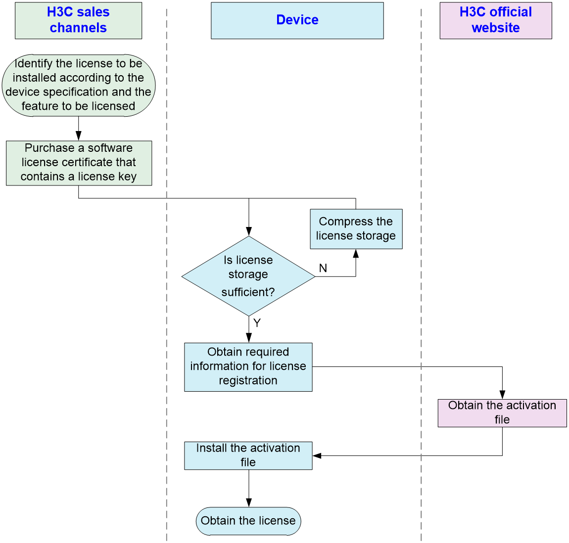

Registering and installing a license
License registration and installation workflow
The procedures for installing formal licenses and trial licenses are the same, as shown in Figure 2.
This chapter only describes the operations performed on the device. For more information, see the licensing guide for the device.
Figure 2 License registration and installation workflow

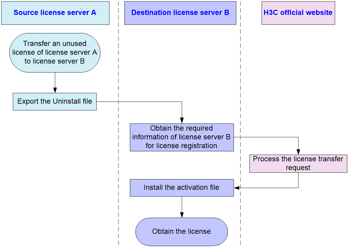

Transferring a license
Perform this task to transfer a license that has not expired from one device to another in the same product series.
License transferring workflow
To transfer licenses from one device to another, use the workflow in Figure 3.
This chapter describes only the operations performed on the source device. For the operations performed on the target device, see "Registering and installing a license." For more information about license transferring, see the licensing guide for the device.
Figure 3 License transferring workflow

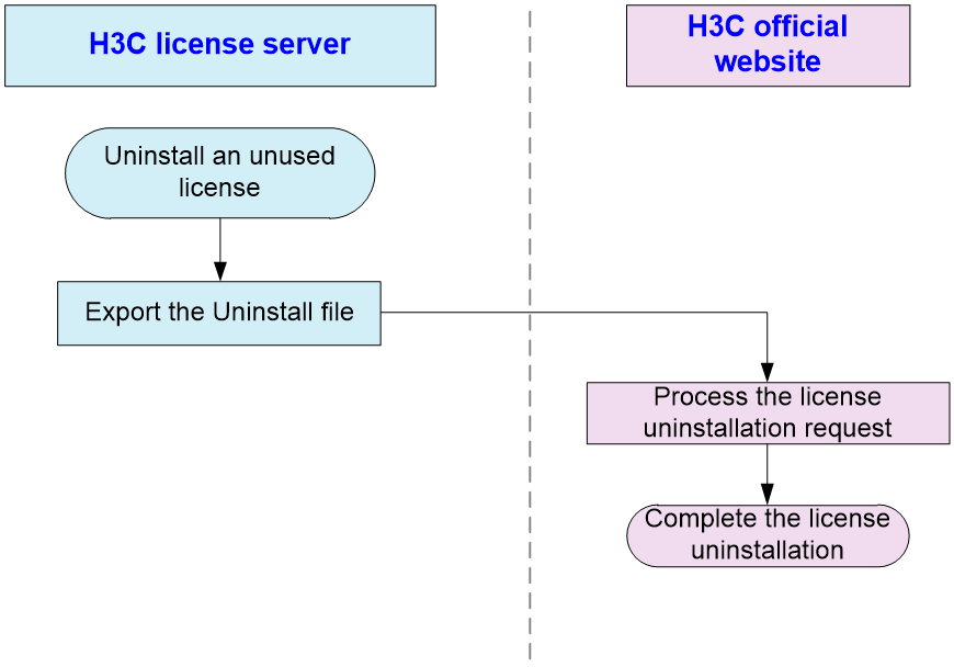

Uninstalling a license
About license uninstallation
A license key is bound to a device once you activate the license key on H3C License Management Platform. You cannot bind this license key to another device. To unbind a license key for a license that has not expired from a device, obtain the Uninstall key or Uninstall file for the license on the device. Then, request for license uninstallation on H3C License Management Platform.
After license uninstallation is requested successfully, you can use this license key to request a new activation file on H3C License Management Platform.
The new activation file can be installed on another device for license transfer or on the local device for license restoration.
License uninstallation workflow
For information about obtaining the Uninstall file, see "Obtaining an Uninstall file."For more information about license uninstallation, see the licensing guide for the device.
Figure 4 License uninstallation workflow

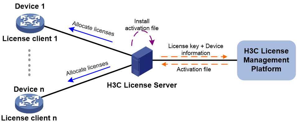

Configuring remote licensing
About remote licensing
Remote licensing is based on the client-server architecture and applicable to large-sized networks. Remote licensing simplifies license installation and management. With remote licensing, you install licenses, uninstall licenses, or transfer licenses for all license clients from the license server.
The following is the procedure to set up remote licensing:
1. Install the H3C license server on a host.
The H3C license server provides centralized management on licensing and license distribution.
2. Install the licenses required by license clients on the license server.
If license clients request for licenses, the license server will assign the licenses to the license clients.
3. Enable a license client on each managed device and configure the parameters for communicating with the license server. The parameters include the IP address and port number of the license server and the username and password for accessing the license server.
The managed devices can then connect to the license server to obtain licenses as license clients.
Figure 5 Remote licensing
The procedures for registering and installing formal licenses and trial licenses are the same, as shown in Figure 6.
This chapter only describes the license client configuration. For more information about the complete procedures, see the licensing guide for the device.
Figure 6 License registration and installation workflow
Configuring a license client
In remote licensing, licenses are installed on the license server and are assigned to a requesting license client.
You can uninstall a license on a license client whether the license has expired or not. After a license is uninstalled and released from the license client, the license server withdraws the license. The withdrawn license can be assigned to other requesting license clients if the license is within the validity period.
Perform this task to transfer a license that has not expired from one license server to another.
For more information about the complete license transferring procedures, see the licensing guide for the device.
Figure 7 License transferring workflow
A license is bound to a license server once you obtain an activation file based on the license key and hardware information of the license server on H3C License Management Platform. You can bind a license only to one license server.
To transfer or restore the license before it expires, you must first uninstall its activation file from the license server, and then request license uninstallation on H3C License Management Platform.
After license uninstallation is approved, the license key is available for use again. You can use it to obtain a new activation file on H3C License Management Platform to transfer the license to another license server or restore the license on the original license server.
For the support of the product for license uninstallation, see its license matrixes document.
For more information about the complete license uninstallation procedures, see the licensing guide for the device.
Figure 8 License uninstallation workflow
