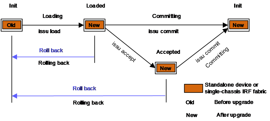

Performing an incremental upgrade on a standalone device (centralized devices) or a single-chassis IRF fabric (centralized IRF devices)
As shown in Figure 1, the upgrade operates as follows:
1.     The device is in Init state before the upgrade and enters Loading state when the issu load command is executed. When the upgrade completes, the device enters Loaded state.
2.     The device enters Accepted state when the issu accept command is executed successfully to accept the upgrade to a compatible version and delete the automatic rollback timer.
3.     The device enters Committing state when the issu commit command is executed to complete the ISSU upgrade to a compatible version, and it enters Init state when the upgrade completes.
IMPORTANT
IMPORTANT:
If a rollback is performed during the upgrade process, the system will roll back to the version before the upgrade.
Figure 1 Performing an incremental upgrade on a standalone device or a single-chassis IRF fabric

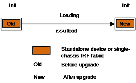

Performing a reboot, ISSU reboot, or incompatible upgrade on a standalone device (centralized devices) or single-chassis IRF fabric (centralized IRF devices)
As shown in Figure 2, the device is in Init state before the upgrade and enters Loading state when the issu load command is executed. When the upgrade completes, the device enters Loaded state.
Figure 2 Performing a reboot, ISSU reboot, or incompatible upgrade on a standalone device or single-chassis IRF fabric

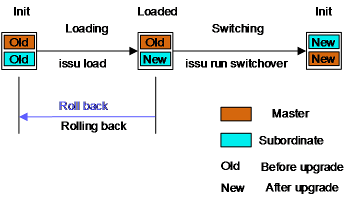

Performing a compatible upgrade on a multichassis IRF fabric
As shown in Figure 3, the upgrade operates as follows:
1.     The device is in Init state before the upgrade and enters Loading state when the issu load command is executed to upgrade a subordinate device in the IRF fabric. When the upgrade completes, the device enters Loaded state.
2.     The device enters Switching state when the issu run switchover command is executed to perform an ISSU switchover. When the switchover completes, the device enters Switchover state.
3.     The device enters Accepted state when the issu accept command is executed successfully to accept the upgrade to a compatible version and delete the automatic rollback timer.
4.     The device enters Committing state when the issu commit command is executed to upgrade all other member devices in the IRF fabric. When the upgrade completes, the device enters Init state.
IMPORTANT
IMPORTANT:
Figure 3 Performing a compatible upgrade on a multichassis IRF fabric
Upgrade a subordinate member device first. Then, upgrade the remaining member devices, including the original master.
1.     (Optional.) Configure automatic rollback:
a.     Enter system view.
b.     Set the automatic rollback timer.
issu rollback-timer minutes
By default, the automatic rollback timer is set to 45 minutes.
The automatic rollback timer starts when you execute the issu run switchover command.
c.     Return to user view.
2.     Verify that the system is stable.
display system stable state
The system is stable if the System State field displays Stable. For a successful ISSU, you must make sure the system is stable before you proceed to the next step.
3.     Load the upgrade images as startup images on a subordinate member.
¡     Use .bin files:
issu load file { boot filename | system filename | feature filename&<1-30> | patch filename&<1-30> } * slot slot-number&<1-9> [ reboot ]
¡     Use an .ipe file:
issu load file ipe ipe-filename [ patch filename&<1-30> ] slot slot-number&<1-9> [ reboot ]
The software images for the device are digitally signed. The system verifies the digital signatures of the specified software images for authenticity and integrity before it sets or loads them as main startup images. If the digital signature verification fails, the system will not set or load the specified images as main startup images and you will receive a digital signature verification failure message.
4.     Verify that the system is stable.
The system is stable if the System State field displays Stable. For a successful ISSU, you must make sure the system is stable before you proceed to the next step. If the system reported an error in the previous step, verify that the system is stable and then use the issu rollback command to roll back the upgrade.
5.     Perform an ISSU switchover.
issu run switchover
This command also starts the automatic rollback timer. When the timer expires, the system automatically rolls back to the original software images.
6.     (Optional.) Accept the upgrade and delete the automatic rollback timer.
issu accept
Execute this command before the automatic rollback timer expires.
7.     Verify that the system is stable.
The system is stable if the System State field displays Stable. For a successful ISSU, you must make sure the system is stable before you proceed to the next step. If the system reported an error in the previous two steps, verify that the system is stable and then use the issu rollback command to roll back the upgrade.
8.     Upgrade the remaining members to complete the ISSU.
issu commit slot slot-number
CAUTION
CAUTION:
Repeat the previous step and this step to upgrade the remaining member devices, including the original master device. After you execute this command for one member device, wait for the member device to start up and join the IRF fabric again before you upgrade another member device. This practice ensures a successful ISSU.
9.     Verify that the ISSU is finished.
display issu state
If the ISSU state field displays Init, the ISSU is finished.

# Perform a master/subordinate switchover.
<Sysname> issu run switchover
Upgrade summary according to following table:
flash:/boot-t0001016.bin
  Running Version             New Version
  Test 0001015                Test 0001016
flash:/system-t0001016.bin
flash:/feature-t0001016.bin
  Slot                        Switchover Way
  1                           Master subordinate switchover
Upgrading software images to compatible versions. Continue? [Y/N]:y
This operation might take several minutes, please wait.........
# Verify that the ISSU is in a stable state.
<Sysname> display issu state
ISSU state: Switchover
Compatibility: Compatible
Work state: Normal
Upgrade method: Card by card
Upgraded slot:
  slot 2
Current upgrading slot: None
Previous version list:
  boot: 7.1.070, Test 0001015
  system: 7.1.070, Test 0001015
  feature: 7.1.070, Test 0001015
Previous software images:
  flash:/boot-t0001015.bin
  flash:/system-t0001015.bin
  flash:/feature-t0001015.bin
Upgrade version list:
  boot: 7.1.070, Test 0001016
  system: 7.1.070, Test 0001016
  feature: 7.1.070, Test 0001016
Upgrade software images:
The Switchover state is a stable state, which indicates that the system has completed the master/subordinate switchover and is waiting for a commit operation to upgrade slot 1.
# Roll back the software images to T0001015.
<Sysname> issu rollback
This command will quit the ISSU process and roll back to the previous version. Continue? [Y/N]:Y
# Verify that the rollback is finished.
ISSU state: Init
Compatibility: Unknown
Work state: Normal
Upgraded slot: None
Current version list:
Current software images:
The ISSU state field displays Init, which indicates that the rollback is finished.
