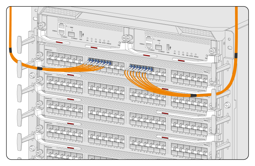

The cable management brackets are installed on the two sides of the service module section. As a best practice, route signal cables as shown in Figure9-1.
Figure9-1 Routing signal cables (S10506X-G)

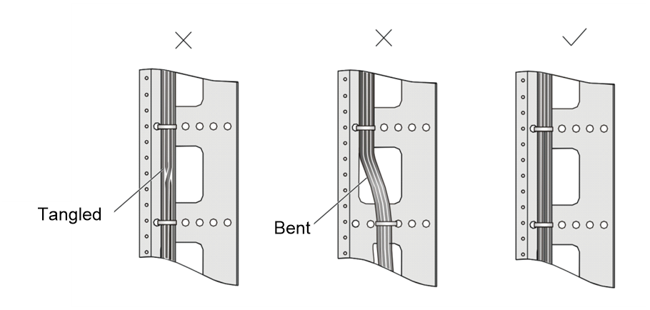

·     Bind and route the cables neatly inside the rack, and make sure they are not kinked or bent.
Figure9-2 Correct and incorrect cable binding

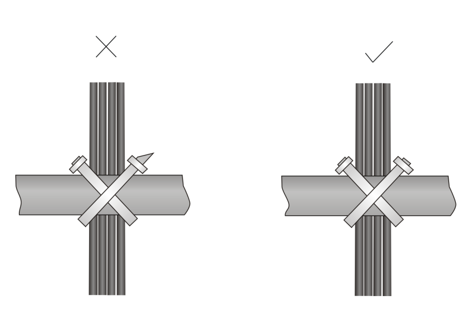

·     After binding the cables, cut the excess from the ties, leaving no sharp or angular tips. See Figure9-3.
Figure9-3 Cutting cable ties

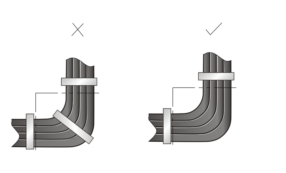

·     When you bend cables, bind them as shown in Figure9-4. To avoid excessive stress causing cable core break, do not tie up the cables in the bending area.
Figure9-4 Binding cables where they must be bent
