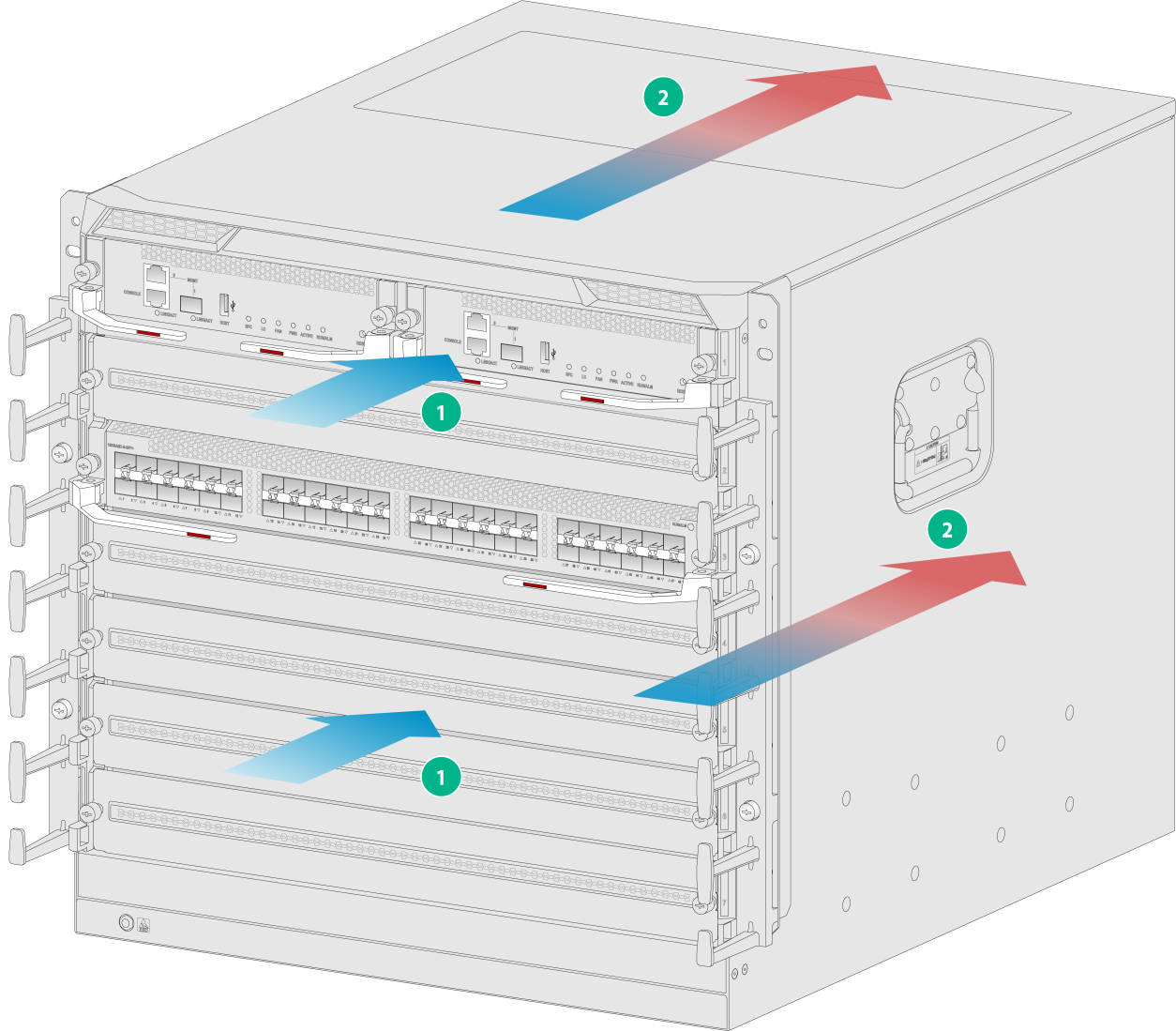

Cooling
Plan the installation site for adequate ventilation:
·     Reserve a minimum clearance of 30 cm (11.81 in) around the inlet and outlet air vents.
·     The rack for the switch has a good cooling system.
·     The installation site has a good cooling system.
·     Verify that the airflow design of the chassis meets the airflow design of the installation site.
Figure2-1 Airflow through an S10506X-G switch
(1) Chassis air intake direction
(2) Chassis air exhaust direction

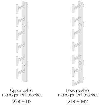

Installation accessories
Before installation, make sure you have all the required installation accessories.
Table2-3 Installation accessories
Product code
Description
Quantity
Applicable device models
2150A0HM
S10506X-G cable management bracket
1 pair
S10506X-G
2150A0J0
S10508X-G cable management bracket
1 pair
S10508X-G
2150A0J5
2150A0HM
S10512X-G cable management brackets
2150A0J5: One pair
2150A0HM: One pair
S10512X-G
·     26020141
·     26020075
M6 screw and cage nut
·     S10506X-G: 10 sets
·     S10508X-G: 16 sets
·     S10512X-G: 24 sets
All S10500X-G models

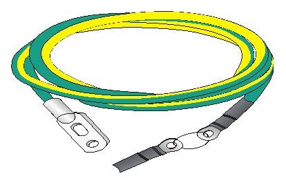

Grounding cable
1
28050001
ESD wrist strap
1
·     0221A003
·     0221A004
Tweezers for installing and removing transceiver modules
1 set
The accessories shown in the table are required for the installation process. Some accessories are shipped with the mainframe, while others need to be provided by the user. You can see the packaging list of the mainframe for the exact information on whether the installation accessories are included in the shipment.
