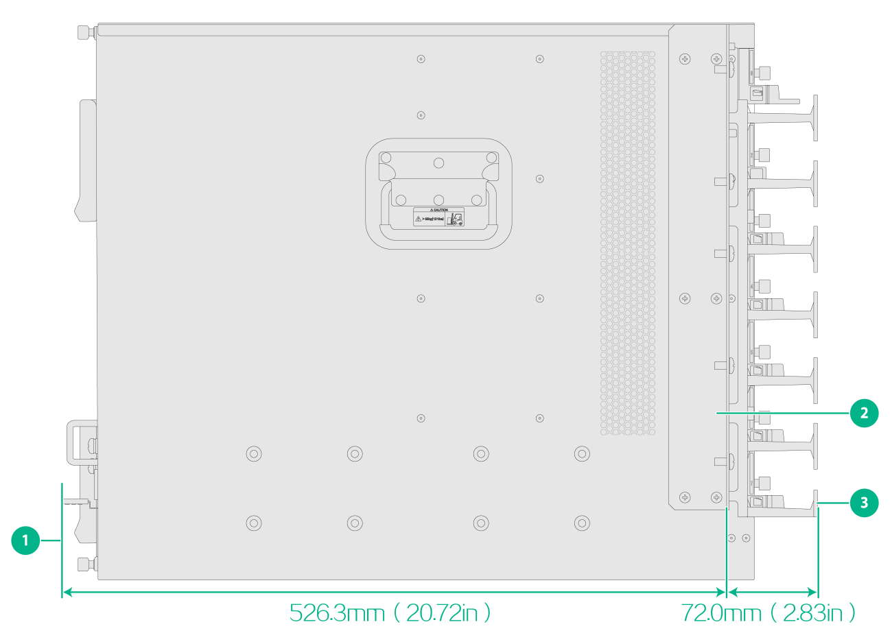

Switch dimensions and rack requirements
Figure3-1 S10506X-G switch dimensions
(1) Power supply latch
(2) Mounting bracket
(3) Cable management bracket
To mount the switch in an enclosed rack, make sure the rack meets the requirements described in Table3-1.
Table3-1 Switch dimensions and rack requirements
Model
Chassis depth
Rack requirements
S10506X-G
Total depth of 598.3 mm (23.56 in)
·     72.0 mm (2.83 in) from the rack-facing surface of the mounting brackets to the front ends of the cable management brackets
·     526.3 mm (20.72 in) from the rack-facing surface of the mounting brackets to the power supply latch
·     A minimum of 0.8 m (2.62 ft) in depth (recommended)
·     A minimum of 130.0 mm (5.12 in) between the front rack post and the front door
·     A minimum of 558.0 mm (21.97 in) between the front rack post and the rear door

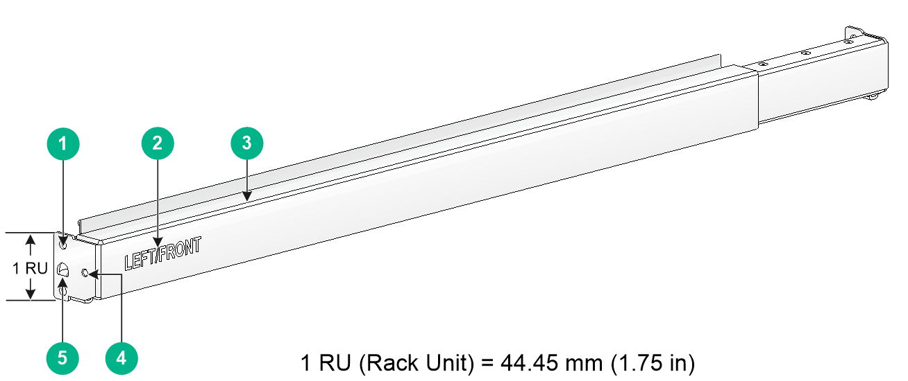

1.     Read the signs on the slide rails to identify the right and left slide rails and their front and rear ends.
Figure3-2 Left slide rail
(1) Guide rail
(2) Sign
(3) Installation hole

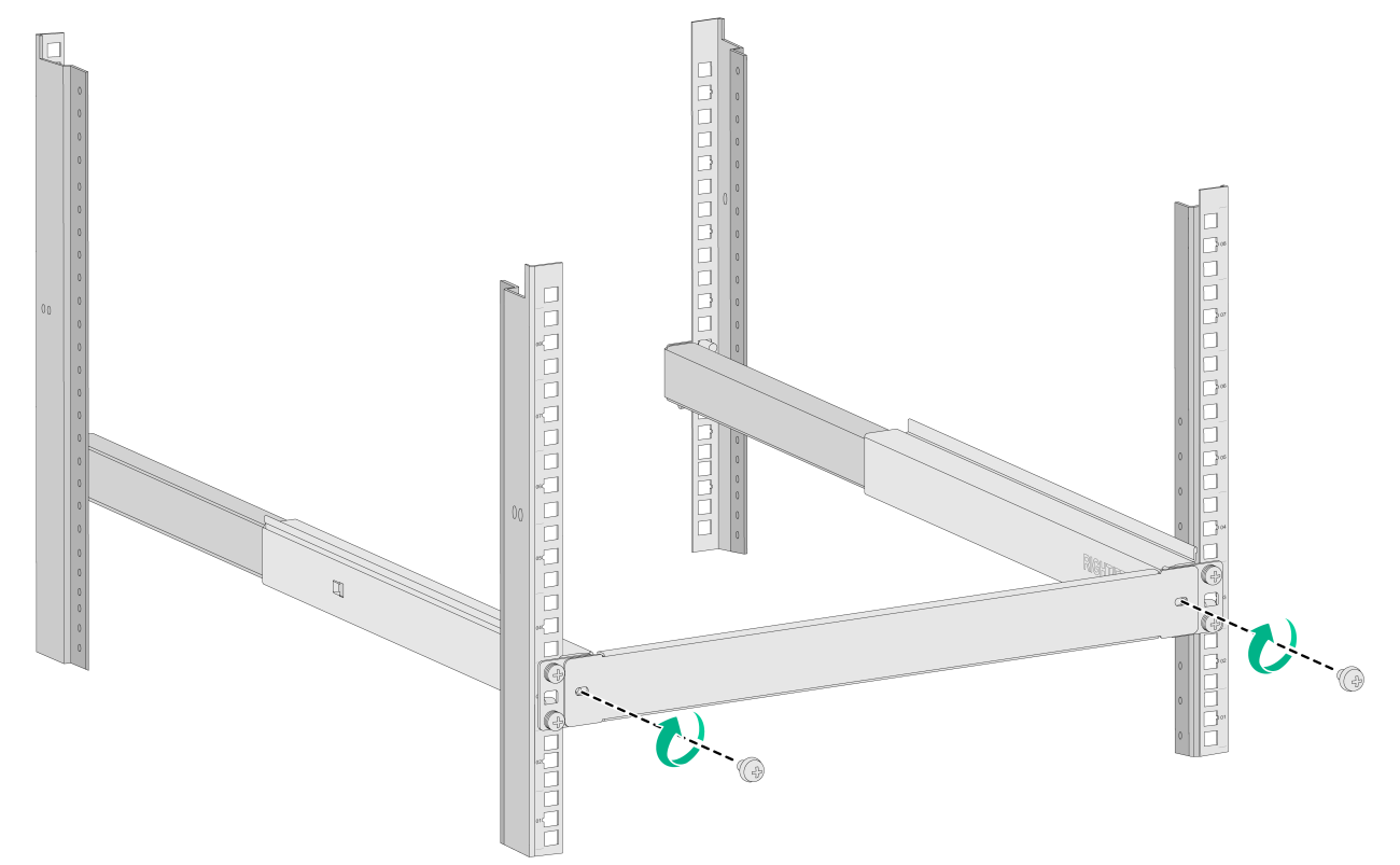

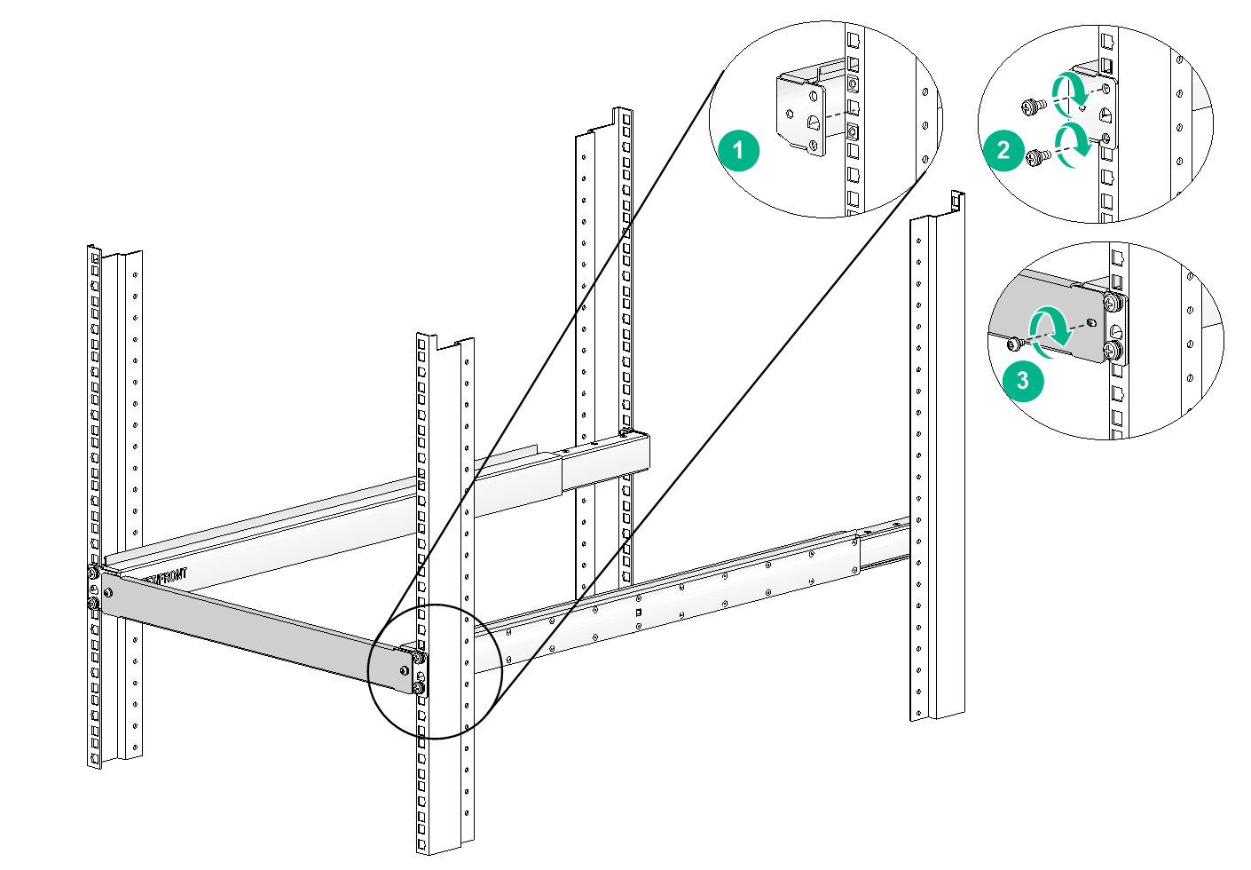

3.     Align the installation holes on the front end of the slide rail with the holes in a front rack post, and then use two M6 screws to attach the slide rail to the rack post, as shown by callout 2 in Figure3-3.
4.     Keep the slide rail horizontal and adjust its length until the installation holes on the rear end of the slide rail engage the holes on the rear rack post. Use screws to attach the slide rail to the rear rack post.
Install a screw in each installation hole of the slide rail to ensure its weight bearing capacity.
5.     Repeat steps 3 and 4 to install the other slide rail.
Figure3-3 Installing the LSEM1BSR slide rails

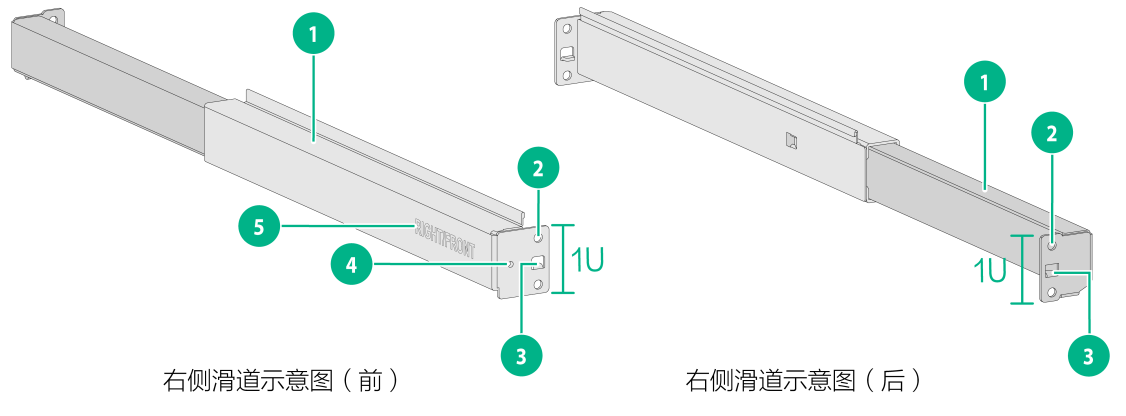

Figure3-4 Right slide rail
(1) Guide rail
(2) Installation hole
(3) Locating hole
(4) Front plate installation hole
(5) Sign

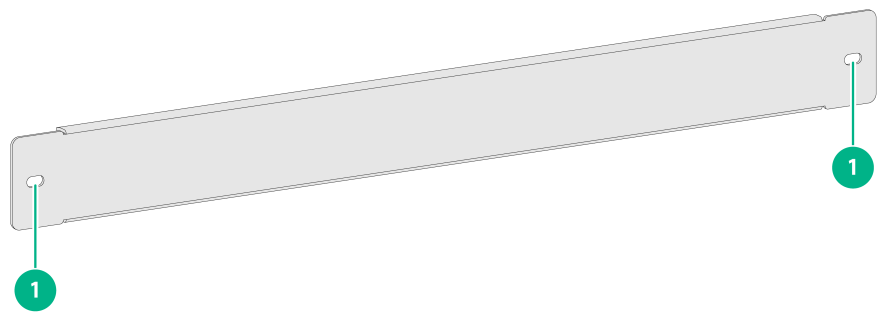

7.     Align the installation holes in the front plate with the front plate installation holes in the slide rails, and fasten the screws, as shown in Figure3-6.
Figure3-6 Installing the front plate
Orient the front plate so that the front of the plate faces outward. Figure3-7 shows the rear of the plate.
Figure3-7 Rear of the plate
(1) Installation holes in the front plate

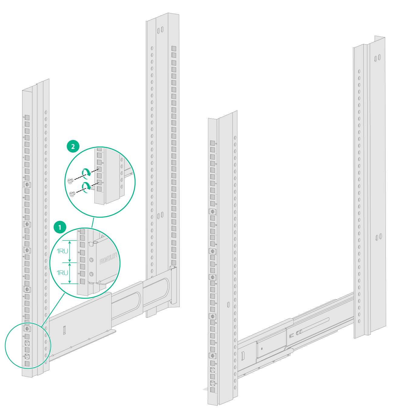

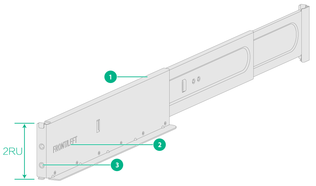

Attaching the LSXM1BSR slide rails
Figure3-8 Left slide rail
(1) Slide rail installation hole
(2) Sign
(3) Guide rail
(5) Locating tongue
Table3-4 Description for signs on the slide rails
Sign
Meaning
Remarks
LEFT/FRONT
Front end of the left slide rail
Mount this end to the front left rack post.
RIGHT/FRONT
Front end of the right slide rail
Mount this end to the front right rack post.
·     The LSXM1BSR slide rail accessories include the left slide rail, right slide rail, and front plate.
·     One rack unit (RU) has two standard installation holes and one auxiliary installation hole in the middle. The space between a standard installation hole and an auxiliary installation hole is wider than the space between two adjacent standard installation holes.
2.     Mark the slide rail installation positions on the rack posts.
¡     Align the locating tongues of the slide rails with the target auxiliary holes in the rack posts, as shown by callout 1 in Figure3-10.
¡     Mark the start installation hole at the same height on each rack post.

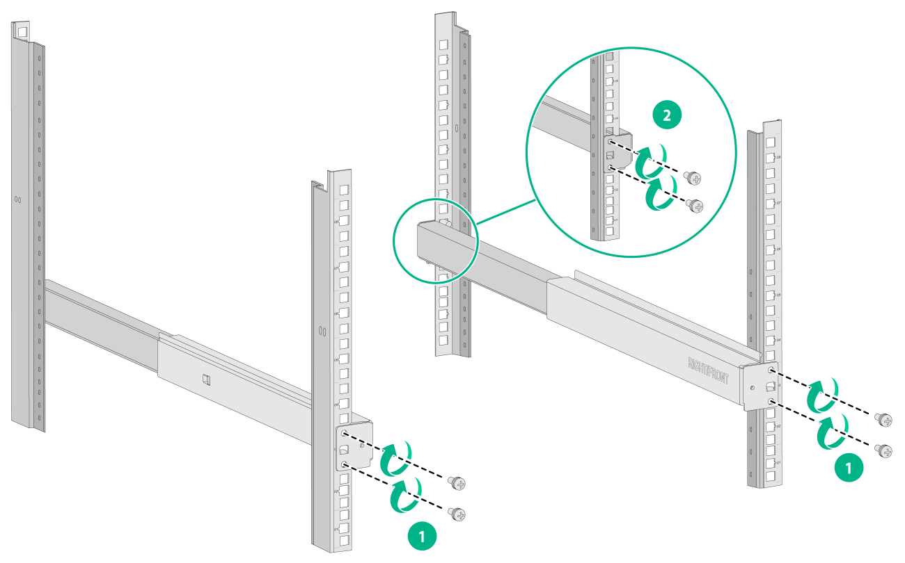

3.     Install cage nuts in the marked standard hole and the standard hole within the same RU. A total of eight cage nuts are required, with two cage nuts for each rack post.
4.     Align the installation holes on the front end of the slide rail with the cage nuts on a front rack post.
5.     Keep the slide rail horizontal and adjust its length until the locating tongues on the slide rail are attached to the auxiliary holes on the rack posts.
6.     Use M6 screws to secure the slide rail to the front and back rack posts, as shown by callout 2 in Figure3-10.
To ensure load bearing, each installation hole of the slide rail requires a screw. A total of four M6 screws are required to secure the slide rail to the rack.
7.     Repeat steps 4, 5, and 6 to install the other slide rail.

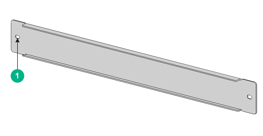

8.     Attach the front plate to the rack:
a.     Orient the front plate so that the front of the plate faces outward. Figure3-9 shows the rear of the plate.
Figure3-9 Rear of a front plate
b.     Align the installation holes in the front plate with the front plate installation holes in the slide rails, and fasten the screws, as shown by callout 3 in Figure3-10.
Two M4 screws are required to secure the front plate to the rack.
Figure3-10 Installing the LSXM1BSR slide rails

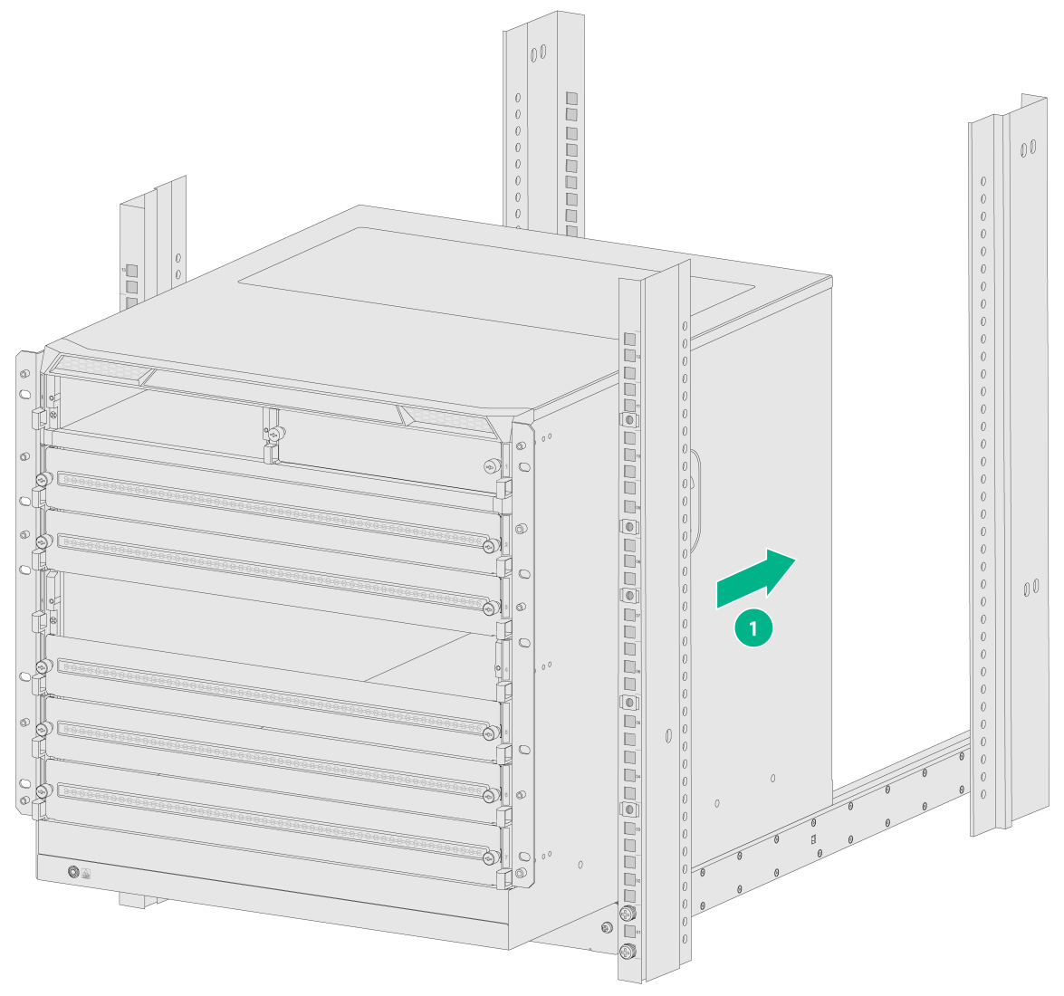

To mount the switch in a rack:
1.     Orient the chassis with its rear facing towards the front of the rack.
2.     Lift the chassis until the switch bottom is a little higher than the slide rails on the rack.
3.     Facing the front of the rack, place the switch on the slide rails and slide the switch into the rack along the slide rails until the mounting brackets are flush against the front rack posts, as shown in Figure3-12 and Figure3-13.
After placing the switch on the slide rails, do not leave go of your hands immediately because this might tip the switch, damaging the switch or even causing bodily injury.
4.     Use M6 screws provided with the switch to attach the mounting brackets to the rack posts.
If the mounting holes in the mounting brackets cannot align with the cage nuts on the rack, verify the following items:
¡     The top flange of the slide rail aligns with the middle of the narrower metal area between holes.
¡     The cage nuts are installed in the correct holes.
Figure3-12 Mounting the S10506X-G switch in the rack (1)
Figure3-13 Mounting the S10506X-G switch in the rack (2)

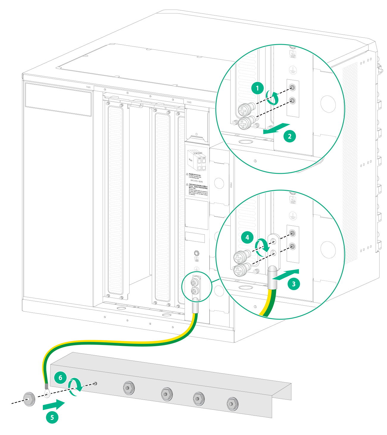

Grounding the switch
CAUTION
CAUTION:
·     Reliably grounding the switch is crucial to lightning protection and EMI protection. Ground the switch reliably before you use it.
·     Use the grounding cable (yellow-green grounding cable) provided with the switch.
·     Connect the grounding cable to the earthing system in the equipment room. Do not connect it to a fire main or lightning rod.
You can ground the switch by connecting the grounding cable to a grounding strip in the equipment room or the grounding strip on the rack.
To connect the grounding cable to a grounding strip:
1.     Unpack the grounding cable.
The grounding cable provided with the switch is compliant with the NEBS standards. The two-hole grounding lug of the grounding cable is used for connecting the chassis. The ring terminal of the grounding cable is used for connecting the grounding strip.
2.     As shown by callouts 1 and 2 in Figure3-14, remove the grounding screws from the grounding holes at the rear of the chassis.
A grounding sign is provided with the grounding holes.
3.     Use grounding screws to attach the two-hole grounding lug of the grounding cable to the chassis, as shown by callouts 3 and 4 in Figure3-14.
The recommended torque for the grounding screws is 30 kgf-cm (2.94 Nm).
4.     As shown by callouts 5 and 6 in Figure3-14, connect the ring terminal of the grounding cable to a grounding post of the grounding strip, and fasten the grounding cable to the grounding strip with the hex nut.
Figure3-14 Connecting the grounding cable to a grounding strip (S10506X-G)
