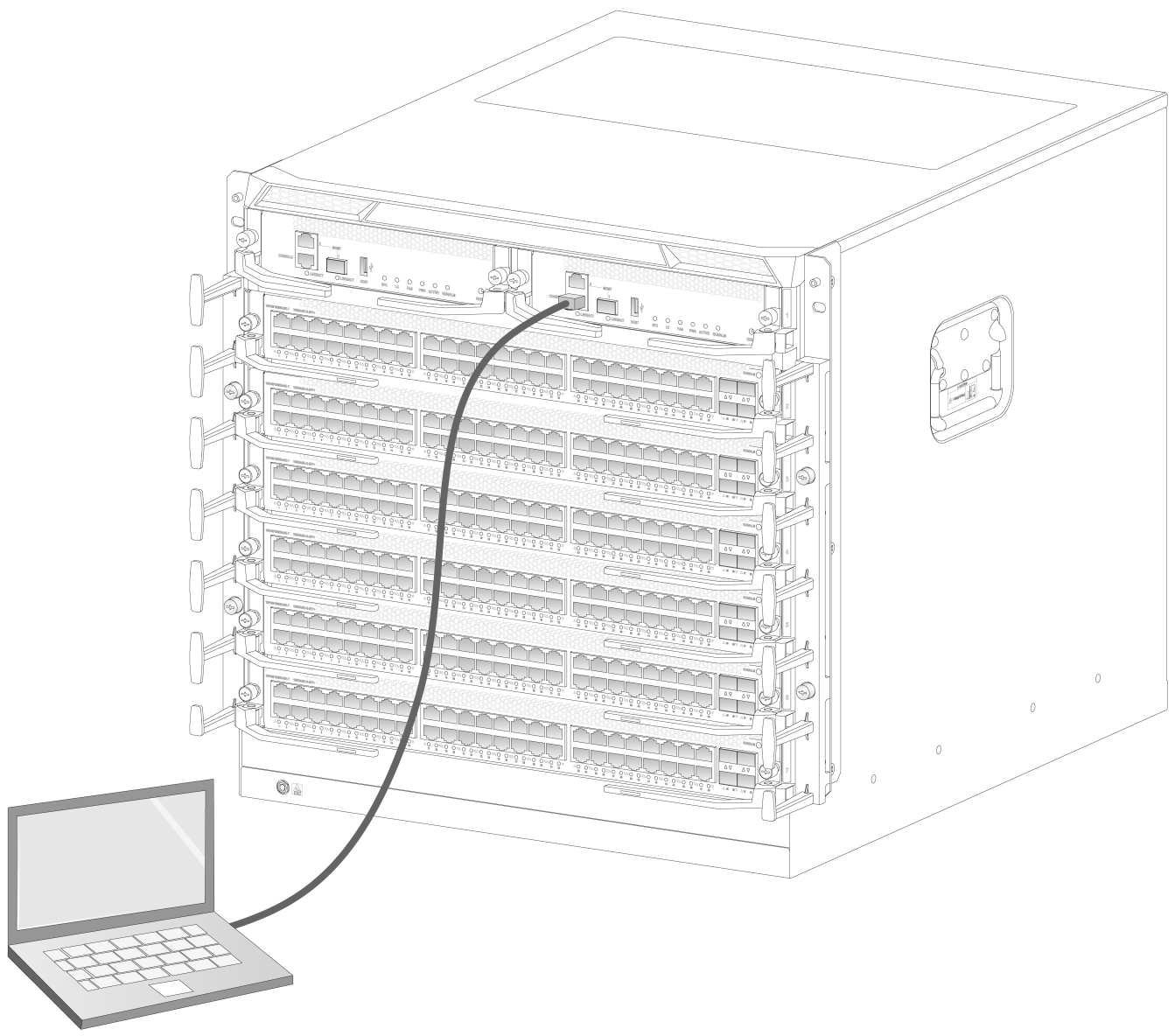

The first time you access the switch you must use a console cable to connect a console terminal, for example, a PC, to the console port on the switch.
Setting up the configuration environment
To connect a terminal (for example, a PC) to the switch:
1.     Plug the DB-9 female connector of the console cable to the serial port of the PC.
2.     Plug the RJ-45 connector of the console cable to the console port of the switch.
3.     Power on the PC.
·     Identify the mark on the console port and make sure you are connecting to the correct port.
·     The serial ports on PCs do not support hot swapping. To connect a PC to an operating switch, first connect the PC end. To disconnect a PC from an operating switch, first disconnect the switch end.
Figure5-1 Connecting a terminal to the switch (S10506X-G)

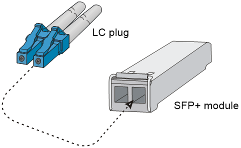

You can install a transceiver module (see "Installing an SFP+/SFP transceiver module") in a fiber port and use an optical fiber to connect the port to the network. For more information about optical fibers, see "Cables" in H3C S10500X-G Switch Series Hardware Information and Specifications.
To connect a fiber port to a peer device through an optical fiber:
1.     Install a transceiver module into the port.
2.     Remove the dust cover of the optical fiber connector, and clean the end of the optical fiber.
3.     Remove the dust plug of the transceiver module, plug one end of the optical fiber into the transceiver module, and plug the other end into the transceiver module in the peer device.
¡     For how to connect an LC connector, see Figure5-2.
¡     For how to connect an MPO connector, see Figure5-3.
Figure5-2 Using an LC optical fiber connector to connect an SFP+ transceiver module
Figure5-3 Using an MPO optical fiber connector to connect a QSFP+ module
