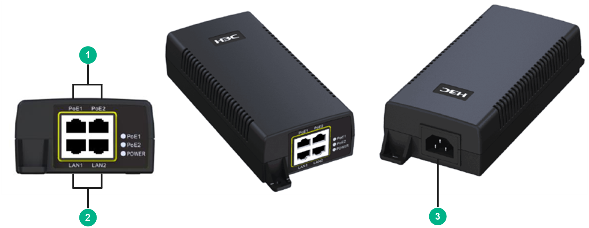

The ADP060-55V-PoE-GL (part number: 9801A1PJ) is a two-port PoE adapter. It delivers optimum performance over a wide range of temperatures and can be used indoors and outdoors (because it is not waterproof, waterproof measures must be taken for outdoor use). You can use it to provide PoE power to a network endpoint over a Category 5e cable on a 10/100/1000M network.
IMPORTANT
IMPORTANT:
As a best practice, do not connect it to two APs simultaneously.
Figure 1 ADP060-55V-PoE-GL PoE adapter views
(1) PoE ports
(2) 10/100/1000M Ethernet ports
(13) AC power input receptacle
Table 1 ADP060-55V-PoE-GL PoE adapter ports description
Port type
Compliant standards and protocols
Description
PoE1/PoE2
N/A
Signal & power output port, used for connecting a PD such as AP.
LAN1/LAN2
·     IEEE802.3
·     IEEE802.3u
Signal input port, used for connecting an Ethernet switch.
N/A
Used for connecting the local power source.

Connecting the PoE adapter
The signal input port works in conjunction with the signal & power output port numbered the same. LAN 1 must work in conjunction with PoE 1 and LAN 2 must work in conjunction with PoE 2.
To connect a signal & power output port to an AP, make sure you connect the signal input port numbered the same with the signal & power output port to the Ethernet switch.
Figure 2 Connecting the ADP060-55V-PoE-GL PoE adapter
