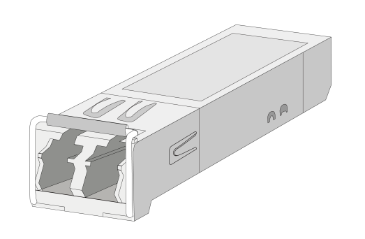

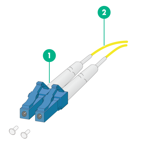

You must use an SFP transceiver module and optical fiber with an LC connector to connect the fiber port on the AC.
Figure1-1 SFP transceiver module
Figure1-2 Optical fibers with LC connectors
(1) LC connector |
(2) Optical fiber |
