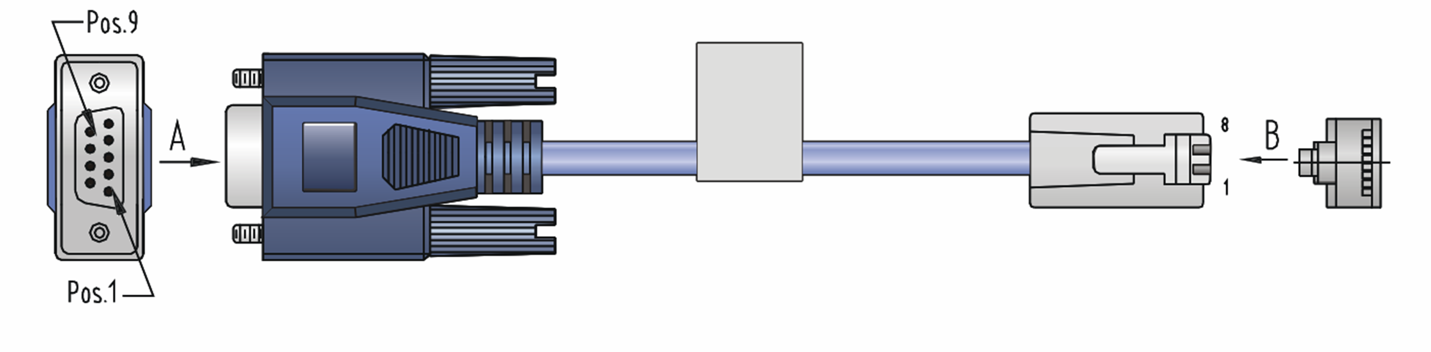

Console cable
A Console cable connects the console port on a device and the serial port on a terminal.
Figure3-1 Console cable
Table3-2 Console cable specifications
Item |
Description |
RJ-45 connector |
RJ-45 Connector-Registered Jack-8PIN-8bit-Shielded-Connector |
DB-9 connector |
Cable Connector-D Connector-9PIN-Female Socket |
Cable model |
Twisted-Pair Cable-UL2464-0.32mm-28AWG-2P-PANTONE WARM GRAY 1U-Only For OEM |
Cores |
4 |
Flame retardant grade |
VW-1 |
Length |
3 m (9.84 ft) |
The console cable has an 8-core crimped RJ-45 connector for connecting to the console port of the router, and a DB-9 connector for connecting to the 9-core serial port of the terminal.
Figure3-2 shows the console cable and Table3-3 shows its pinouts.
Figure3-2 Console cable connecting the serial port and the console port
Table3-3 Pinouts for the console cable connecting the serial port and the console port
RJ-45 pin |
Signal |
DB-9 pin |
Signal |
1 |
RTS |
8 |
CTS |
2 |
DTR |
6 |
DSR |
3 |
TXD |
2 |
RXD |
4 |
CD |
5 |
SG |
5 |
GND |
5 |
SG |
6 |
RXD |
3 |
TXD |
7 |
DSR |
4 |
DTR |
8 |
CTS |
7 |
RTS |

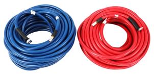

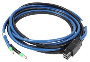

DC power cord
A DC power cord connects a DC power supply to an external DC power source. Power cords supported by the PSR2400-12D, PSR2400-D, and PSR2500B-12AHD-F power supplies are as shown in Table3-4.
Table3-4 Compatible power cords
Item |
Power cord code |
Cable length |
Wire diameter |
Remarks |
Description |
DC power cord |
0404A0E1 |
3 m (9.84 ft) |
6 AWG |
Black and blue power cord (ring terminal included) |
Used for the PSR2400-12D power supply on the CR16000-M |
DC power cord |
0404A0E2 |
15 m (49.21 ft) |
6 AWG |
DC power cord |
0404A1M5 |
20 m (65.62 ft) |
4 AWG |
Blue and red power cord (ring terminal included) |
Used for the PSR2400-D power supply on the CR16000-M |
DC power cord |
0404A1M6 |
15 m (49.21 ft) |
4 AWG |
DC power cord |
0404A1M7 |
10 m (32.81 ft) |
6 AWG |
DC power cord |
0404A1MD |
30 m (98.43 ft) |
4 AWG |
High-voltage DC power cord |
0404A0RL |
3 m (9.84 ft) |
3*2.5 mm2 |
Black power cord (ring terminal included) |
Used for the PSR2500B-12AHD-F power supply on the CR16000-M |
Figure3-3 PSR2400-12D DC power cord (black and blue cable as an example)
Figure3-4 Ring terminal
Figure3-5 PSR2400-D DC power cords

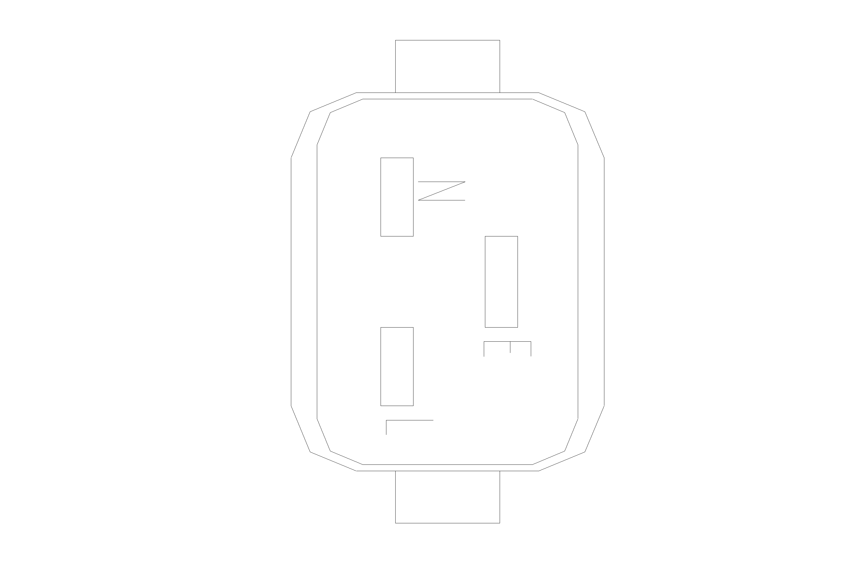

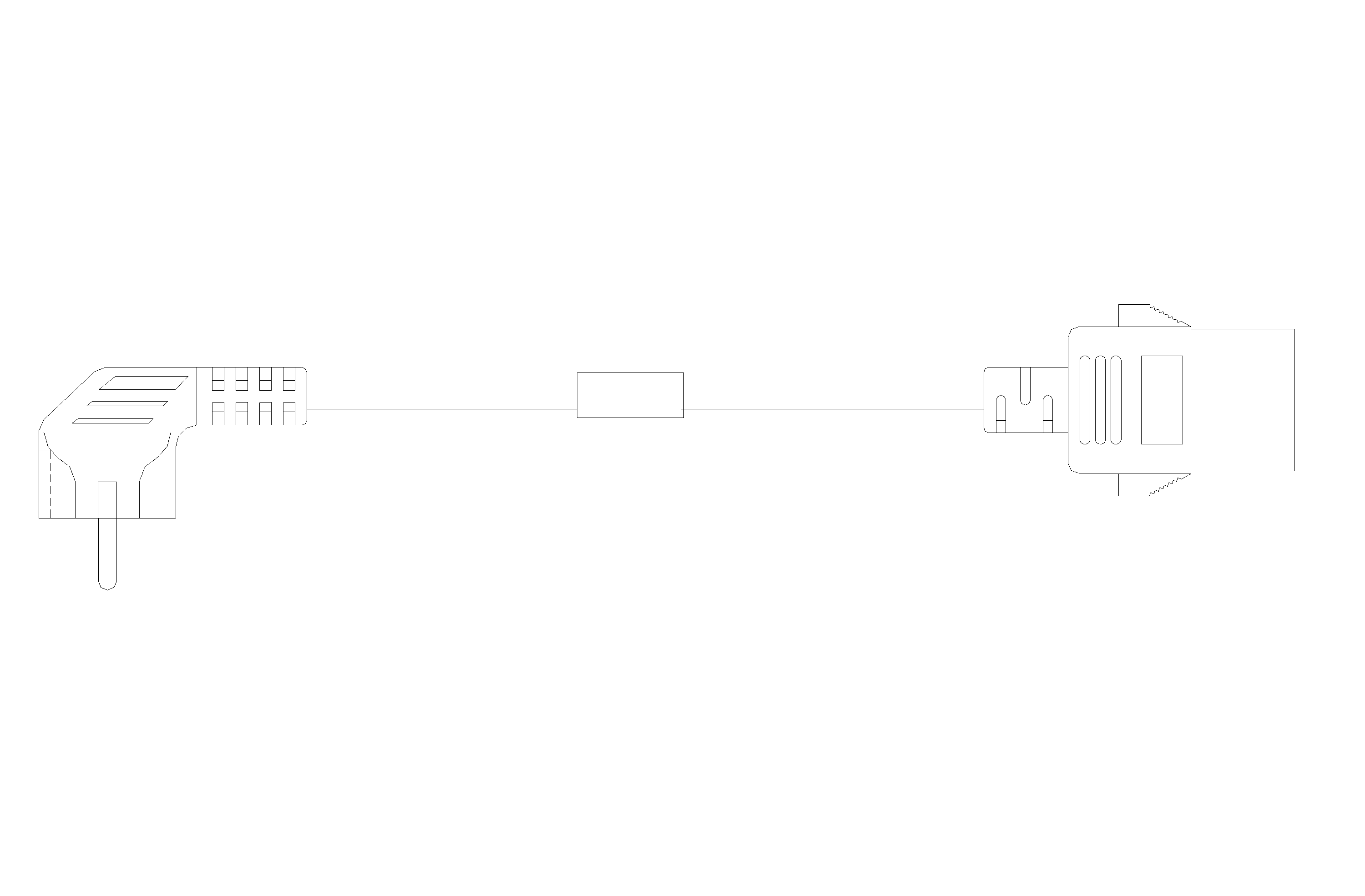

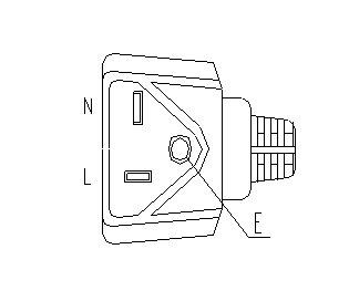

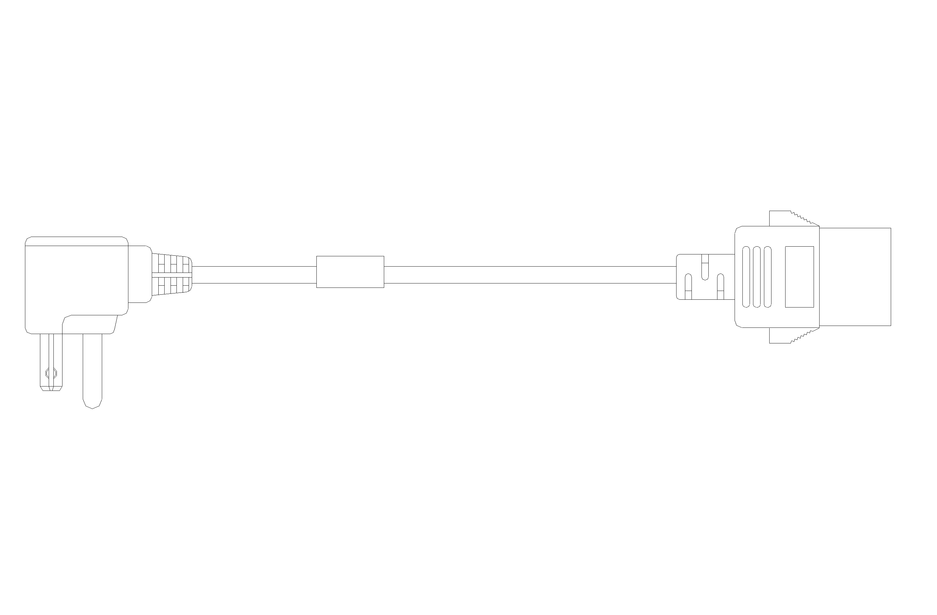

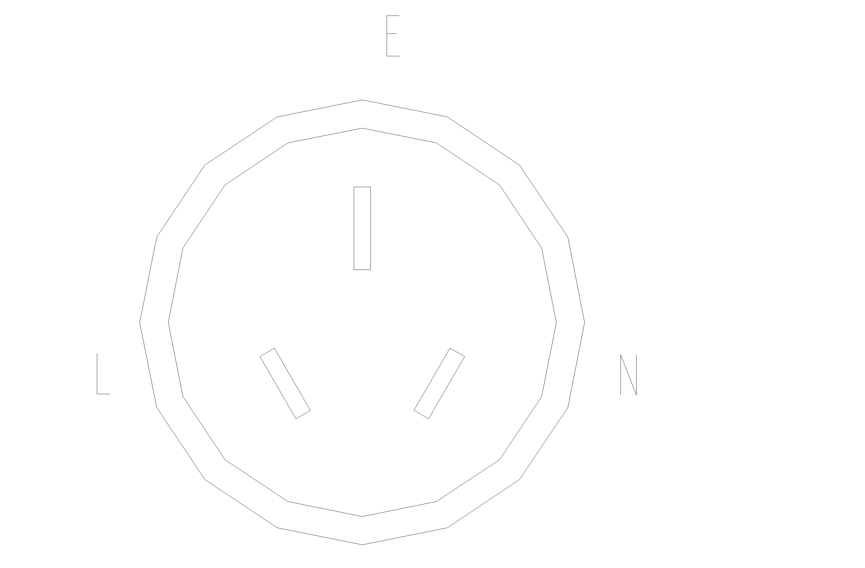

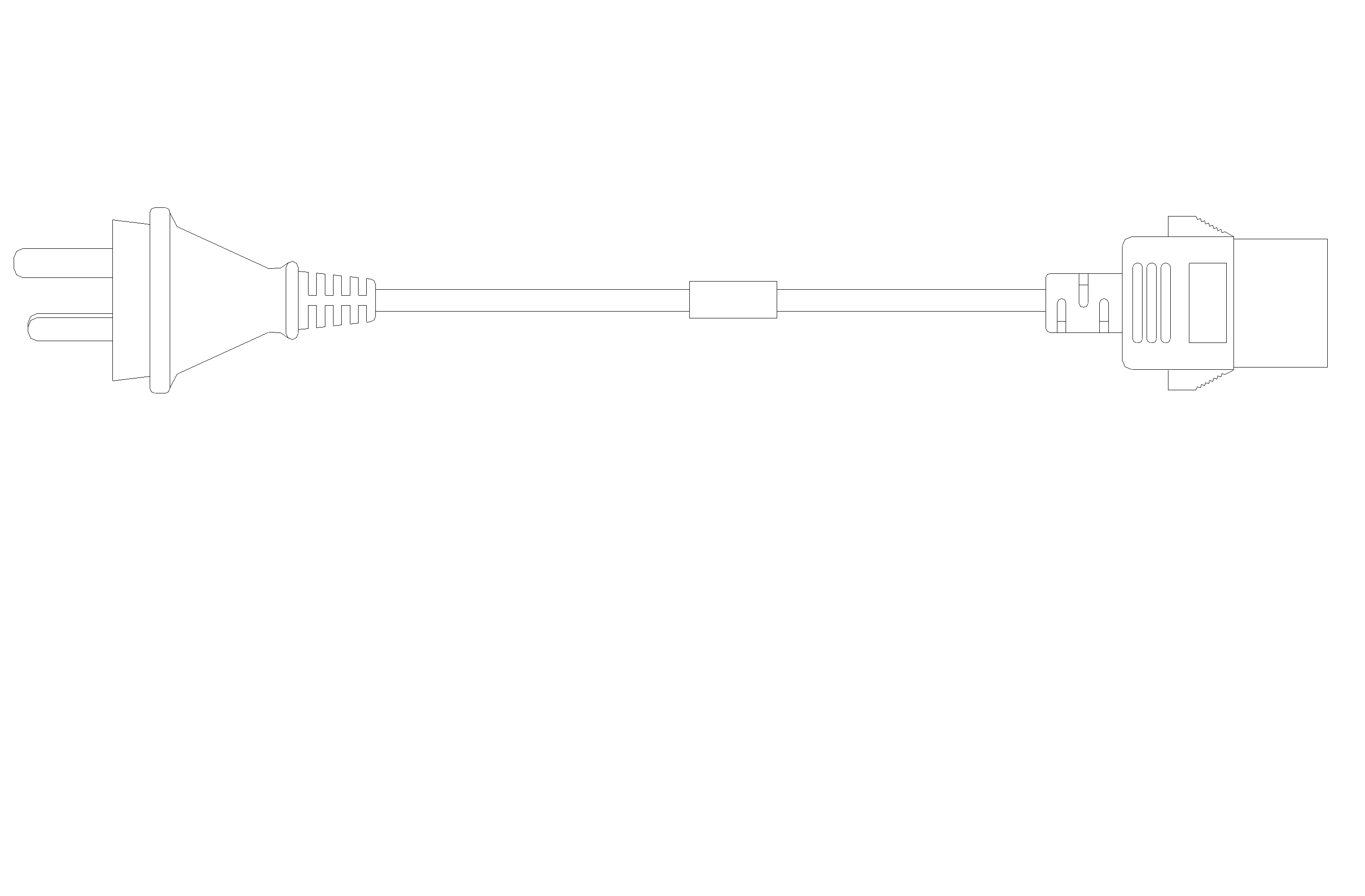

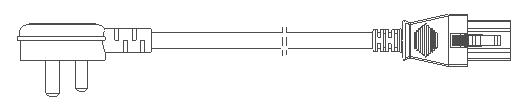

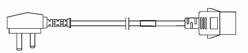

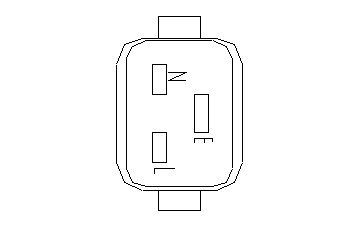

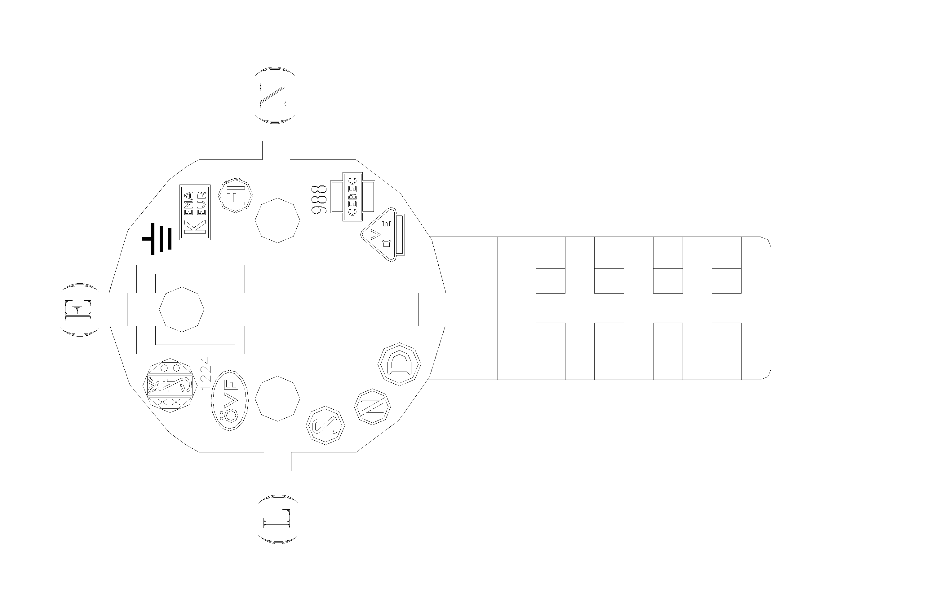

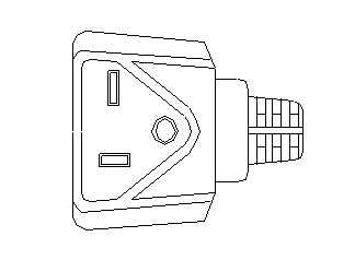

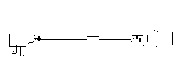

AC power cord
An AC power cord connects an AC power supply to an external AC power source.
· The power of a power supply has requirements on the current-carrying capacity of the AC power cord. Select an appropriate AC power cord based on the actual requirements.
· Available power plugs vary by country or region. Select the AC power cord that meets the requirements of the plug standard.
· AC power supplies of the CR16000-M require 16A AC power cords. For power plugs required by different countries or regions, see Table3-5.
Code |
Description |
Power cord appearance (User side plug-Device side plug) |
04043396 |
External Power Cable-China AC 220V16A-3m-3*1.5mm^2-Black-(PI-Angle Male)-(227IEC53-1.5^2(3C))-(C19-Straight Female) |
0404A0C2 |
External Power Cable-China AC 220V16A-3m-3*1.5mm^2-Black-(C20-Straight Male)-(227IEC53-1.5^2(3C))-(C19-Straight Female)-PDU |
0404A063 |
America AC Power Cable 125V20A-3m-3X3.30mm^2-Black-(PM-Angle Male)-(12SJT(3C)Black)-(C19-Straight Female) |
0404A061 |
Europe AC Power Cable 250V16A-3m-3*1.50mm^2-Black-(PF-Angle Male)-(H05VV-F-1.5^2(3C)Black)-(C19 Straight Female) |
0404A062 |
External AC Power Cable-Japan AC Power Cable 125V20A-3m-3*3.50mm^2-Black-(PM-Angle Male)-(HVCTF-3.5^2(3C))-(C19 Straight Female) |
0404A01A |
Australia AC Power Cable 250V16A-3m-3*1.5mm^2-Black-(PI-Straight Male)-(H05VVF 3*1.5mm^2)-(C19 Straight Female) |
0404A0RQ |
External AC Power Cable-3m-3*1.5mm^2-Black-(PW3C-16A450V)-(227IEC53(RVV)3*1.5mm^2 Black)-(PI-16A250V-Straight Male) |
NOTE: Select the power cord according to the country or region. |

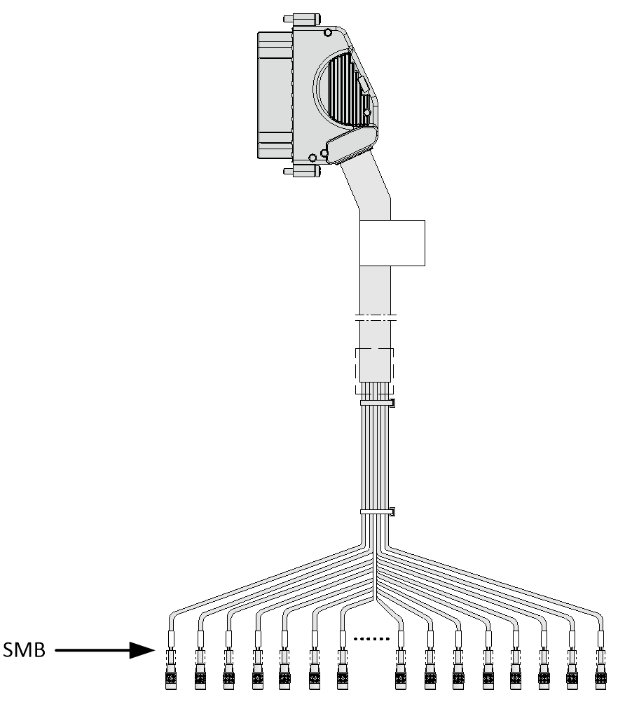

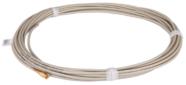

Clock cable
Clock cable for common MPUs
If connected to the clock interface of an external device through a clock cable, a router can receive 2-way 2.048MHz/2.048Mbit/s clock synchronization signals from the uplink device and provides 2-way 2.048MHz/2.048Mbit/s signals to the downlink.
A clock cable for common MPUs has an SMB connector at one end for connecting the clock interface on a router. The connector at the other end varies by the clock interface type on the external device.
Clock cable for 1588v2-capable MPUs
If connected to the clock interface of an external device through a clock cable, a router can receive 2Mbps/2MHz/1PPS+TOD clock signals from the uplink device and provides 2Mbps/2MHz/1PPS+TOD signals to the downlink.
75ohm clock cables and 120ohm clock cables are available for 1588v2-capable MPUs. A 75ohm clock cable is used to transmit 2Mbps and 2MHz clock signals and a 120ohm clock cable is used to transmit 1PPS+TOD clock signals.
At the router end, a 75ohm clock cable provides an SMB connector and a 120ohm clock cable provides an RJ-45 connector. The connector at the other end varies by the clock interface type on the external device.
Figure3-7 75ohm clock cable
Figure3-8 75ohm clock cable connector at the route side
(1) Coaxial connector-SMB |
(2) Label |

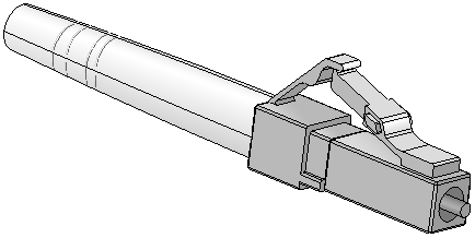

Optical fiber
CAUTION: Use the same types of transceiver modules, pigtail cords, patch cords, and fiber cables. If you use single-mode optical fibers, the transceiver modules, pigtail cords, patch cords, and fiber cables must be single-mode. |
Optical fiber
Optical fibers are widely used in fiber-optic communications, which are advantageous for long-distance communications.

Fiber connector
When you plug or unplug an LC optical connector, follow these restrictions and guidelines:
· Do not rotate the connector.
· When insert the connector into a fiber port, carefully align the connector with the port and gently insert it into the port without using any excessive force.
· When unplug the connector from a fiber port, pinch the clip on the connector, slightly press the connector into the port, and then pull the connector out.
Figure3-13 MPO connector
When you plug or unplug an MPO optical connector, follow these restrictions and guidelines:
· When unplug the connector from a fiber port, pull the unlocking sleeve, and then pull the connector out.
Precautions
· Make sure the fiber connector and fiber type match the transceiver module type.
· The fiber ports on some cards have shielded covers. Remove the shielded covers before using the fiber ports. Fiber interfaces must be installed with shielded covers when they are not in use. Keep them safely.
· Fiber connectors must be protected under safe and reliable outer packing, and be fitted with dust caps. Fiber connectors must be installed with dust caps when they are not in use. Take care not to scratch their end face. Replace the dust cap if it is loose or polluted.
· Before connecting a fiber, use dust free paper and absolute alcohol to clean the end face of the fiber connector. You can brush the end face only in one direction. You also need to brush the end face of the fiber port.
· If the fiber has to pass through a metallic board hole, the hole must have a sleek and fully filleted surface (the filleting radius must be not less than 2 mm). When passing through a metallic board hole or bending along the acute side of mechanical parts, the fiber must wear jackets or cushions.
· Insert and remove a plug with care. Never exert a fierce force to the fiber or plug; otherwise the plug might be damaged or the fiber might be broken. Never pull, press or extrude the fiber fiercely. For the allowed maximum tensile load and crush load, see Table3-11.

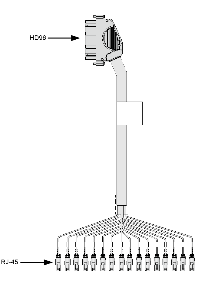

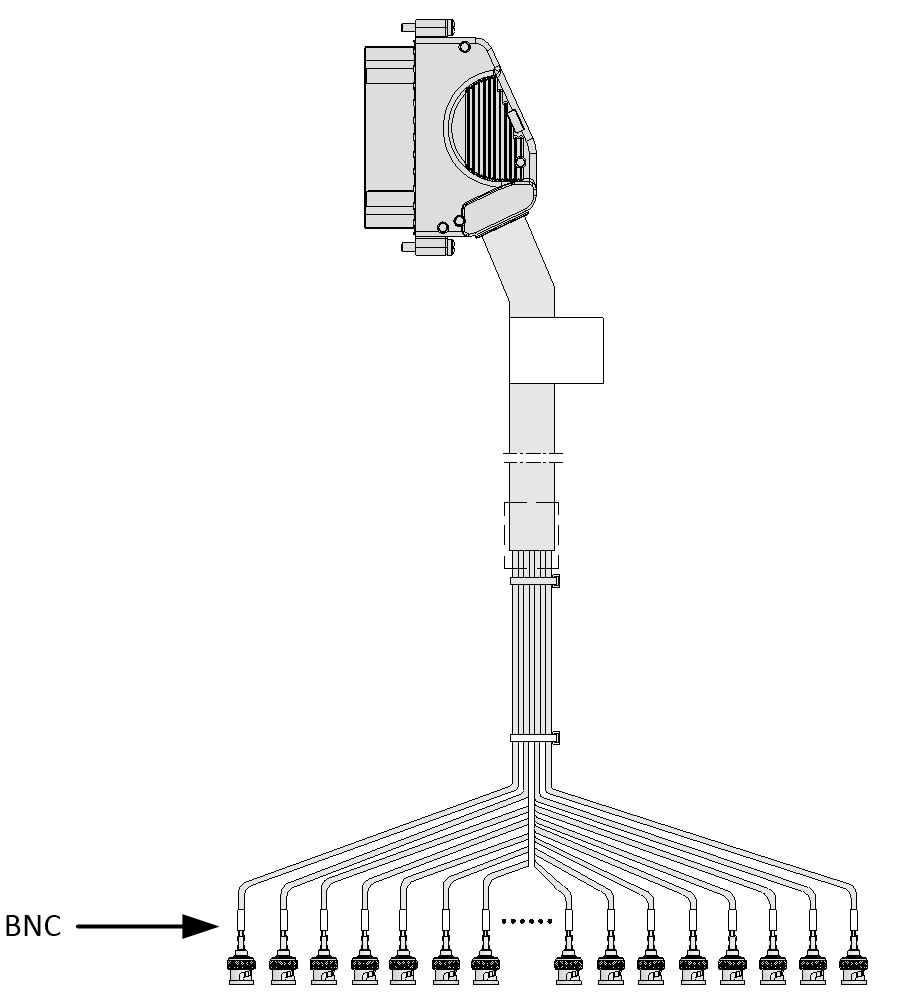

E1 cable
You can use an E1 cable to connect E1-HM96 Ethernet copper ports.
Figure3-14 E1 cable (1)
Figure3-15 E1 cable (2)
Figure3-16 E1 cable (3)
