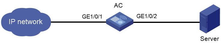

Example: Configuring local port mirroring
As shown in Figure 2, configure local port mirroring to enable the server to monitor the bidirectional traffic of the marketing and technical departments.
Figure 2 Network diagram
# Create local mirroring group 1.
<AC> system-view
[AC] mirroring-group 1 local
# Configure the source port and the monitor port in local mirroring group 1.
[AC] mirroring-group 1 mirroring-port gigabitethernet 1/0/1 both
[AC] mirroring-group 1 monitor-port gigabitethernet 1/0/2
# Verify the mirroring group configuration.
[AC] display mirroring-group 1
Mirroring group 1:
    Type: Local
    Status: Active
    Mirroring port: GigabitEthernet1/0/1  both
    Monitor port: GigabitEthernet1/0/2
