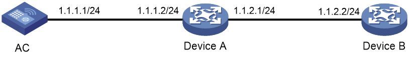

As shown in Figure 2, determine if the AC and Device B can reach each other.
# Test the connectivity between the AC and Device B.
<AC> ping 1.1.2.2
Ping 1.1.2.2 (1.1.2.2): 56 data bytes, press CTRL+C to break
56 bytes from 1.1.2.2: icmp_seq=0 ttl=254 time=2.137 ms
56 bytes from 1.1.2.2: icmp_seq=1 ttl=254 time=2.051 ms
56 bytes from 1.1.2.2: icmp_seq=2 ttl=254 time=1.996 ms
56 bytes from 1.1.2.2: icmp_seq=3 ttl=254 time=1.963 ms
56 bytes from 1.1.2.2: icmp_seq=4 ttl=254 time=1.991 ms
--- Ping statistics for 1.1.2.2 ---
round-trip min/avg/max/std-dev = 1.963/2.028/2.137/0.062 ms
The output shows the following information:
· The AC sends five ICMP packets to Device B and the AC receives five ICMP packets.
· No ICMP packet is lost.
· The route is reachable.

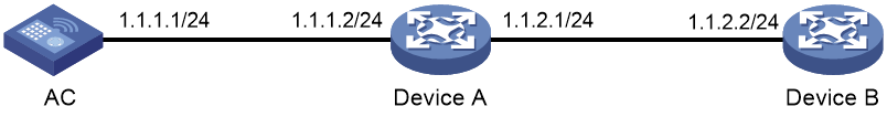

As shown in Figure 4, the AC failed to Telnet to Device B.
Test the network connectivity between the AC and Device B. If they cannot reach each other, locate the failed nodes in the network.
1. Configure IP addresses for the AC, Device A, and Device B, as shown in Figure 4.
2. Configure a static route on the AC.
<AC> system-view
[AC] ip route-static 0.0.0.0 0.0.0.0 1.1.1.2
3. Test the connectivity between the AC and Device B.
[AC] ping 1.1.2.2
Request time out
Request time out
Request time out
Request time out
Request time out
5 packet(s) transmitted, 0 packet(s) received, 100.0% packet loss
The output shows that the AC and Device B cannot reach each other.
4. Identify failed nodes:
# Enable sending of ICMP timeout packets on Device A.
<DeviceA> system-view
[DeviceA] ip ttl-expires enable
# Enable sending of ICMP destination unreachable packets on Device B.
<DeviceB> system-view
[DeviceB] ip unreachables enable
# Identify failed nodes.
[AC] tracert 1.1.2.2
traceroute to 1.1.2.2 (1.1.2.2), 30 hops at most, 40 bytes each packet, press CTRL+C to break
1 1.1.1.2 (1.1.1.2) 1 ms 2 ms 1 ms
2 * * *
3 * * *
4 * * *
5
The output shows that the AC can reach Device A but cannot reach Device B. An error has occurred on the connection between Device A and Device B.
5. To identify the cause of the issue, execute the following commands on the AC and Device B:
¡ Execute the debugging ip icmp command and verify that the AC and Device B can send and receive the correct ICMP packets.
¡ Execute the display ip routing-table command to verify that the AC and Device B have a route to each other.
