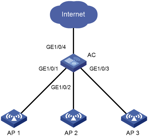

Network requirements
As shown in Figure 1, AP 1, AP 2, and AP 3 are connected to GigabitEthernet 1/0/1, GigabitEthernet 1/0/2, and GigabitEthernet 1/0/3 on the AC, respectively. The AC connects to the Internet through GigabitEthernet 1/0/4.
Configure the AC to provide Internet access for the APs, and isolate APs from one another.
Configuration procedure
# Assign ports GigabitEthernet 1/0/1, GigabitEthernet 1/0/2, and GigabitEthernet 1/0/3 to the isolation group.
<AC> system-view
[AC] interface gigabitethernet 1/0/1
[AC-GigabitEthernet1/0/1] port-isolate enable
[AC-GigabitEthernet1/0/1] quit
[AC] interface gigabitethernet 1/0/2
[AC-GigabitEthernet1/0/2] port-isolate enable
[AC-GigabitEthernet1/0/2] quit
[AC] interface gigabitethernet 1/0/3
[AC-GigabitEthernet1/0/3] port-isolate enable
[AC-GigabitEthernet1/0/3] quit
# Display information about the isolation group.
[AC] display port-isolate group
Port isolation group information:
Group ID: 1
Group members:
GigabitEthernet1/0/1 GigabitEthernet1/0/2 GigabitEthernet1/0/3
The output shows that ports GigabitEthernet 1/0/1, GigabitEthernet 1/0/2, and GigabitEthernet 1/0/3 are assigned to the isolation group. As a result, the APs are isolated from one another at Layer 2.
