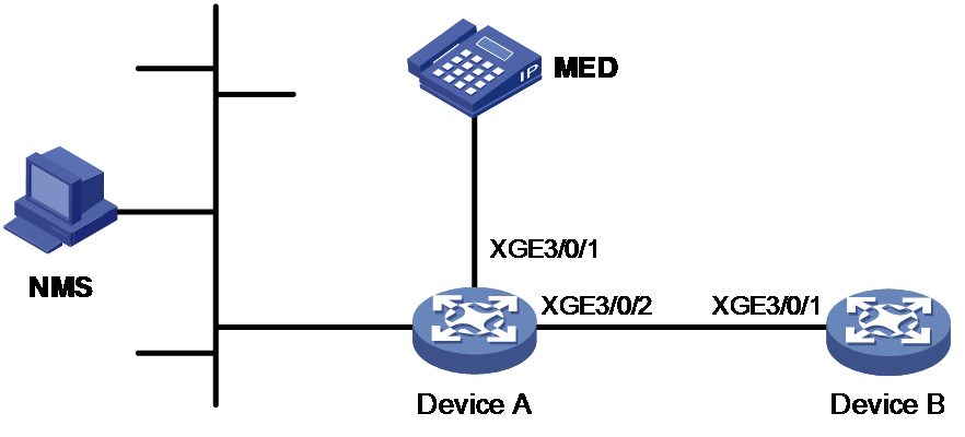

LLDP configuration examples
Example: Configuring basic LLDP functions
As shown in Figure 5, enable LLDP globally on Switch A and Switch B to perform the following tasks:
·     Monitor the link between Switch A and Switch B on the NMS.
·     Monitor the link between Switch A and the MED device on the NMS.
Figure 5 Network diagram
1.     Configure Switch A:
# Enable LLDP globally.
<SwitchA> system-view
[SwitchA] lldp global enable
# Enable LLDP on Ten-GigabitEthernet 3/0/1. By default, LLDP is enabled on ports.
[SwitchA] interface ten-gigabitethernet 3/0/1
[SwitchA-Ten-GigabitEthernet3/0/1] lldp enable
# Set the LLDP operating mode to Rx on Ten-GigabitEthernet 3/0/1.
[SwitchA-Ten-GigabitEthernet3/0/1] lldp admin-status rx
[SwitchA-Ten-GigabitEthernet3/0/1] quit
# Enable LLDP on Ten-GigabitEthernet 3/0/2. By default, LLDP is enabled on ports.
[SwitchA] interface gigabitethernet1/2
[SwitchA-Ten-GigabitEthernet3/0/2] lldp enable
# Set the LLDP operating mode to Rx on Ten-GigabitEthernet 3/0/2.
[SwitchA-Ten-GigabitEthernet3/0/2] lldp admin-status rx
[SwitchA-Ten-GigabitEthernet3/0/2] quit
2.     Configure Switch B:
<SwitchB> system-view
[SwitchB] lldp global enable
[SwitchB] interface ten-gigabitethernet 3/0/1
[SwitchB-Ten-GigabitEthernet3/0/1] lldp enable
# Set the LLDP operating mode to Tx on Ten-GigabitEthernet 3/0/1.
[SwitchB-Ten-GigabitEthernet3/0/1] lldp admin-status tx
[SwitchB-Ten-GigabitEthernet3/0/1] quit
# Verify the following items:
·     Ten-GigabitEthernet 3/0/1 of Switch A connects to a MED device.
·     Ten-GigabitEthernet 3/0/2 of Switch A connects to a non-MED device.
·     Both ports operate in Rx mode, and they can receive LLDP frames but cannot send LLDP frames.

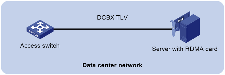

DCBX application scenario
Figure 6 DCBX application scenario
DCBX enables lossless packet transmission on DCE networks.
As shown in Figure 6, DCBX applies to an RoCE-based data center network, and operates on an access switch. DCBX enables the switch to control the server or storage adapter, and simplifies the configuration and guarantees configuration consistency. DCBX extends LLDP by using the IEEE 802.1 organizationally specific TLVs (DCBX TLVs) to transmit DCBX data, including:
