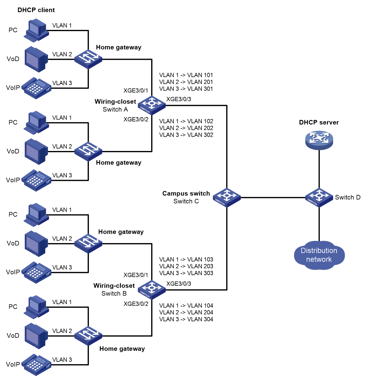

One-to-one VLAN mapping
One-to-one VLAN mapping are typically used by a community for broadband Internet access, as shown in Figure 1.
Figure 1 Application scenario of one-to-one VLAN mapping
As shown in Figure 1, the network is implemented as follows:
·     Each home gateway uses different VLANs to transmit the PC, VoD, and VoIP services.
·     To further subclassify each type of traffic by customer, configure one-to-one VLAN mapping on the wiring-closet switches. This feature assigns a separate VLAN to each type of traffic from each customer. The required total number of VLANs in the network can be very large.

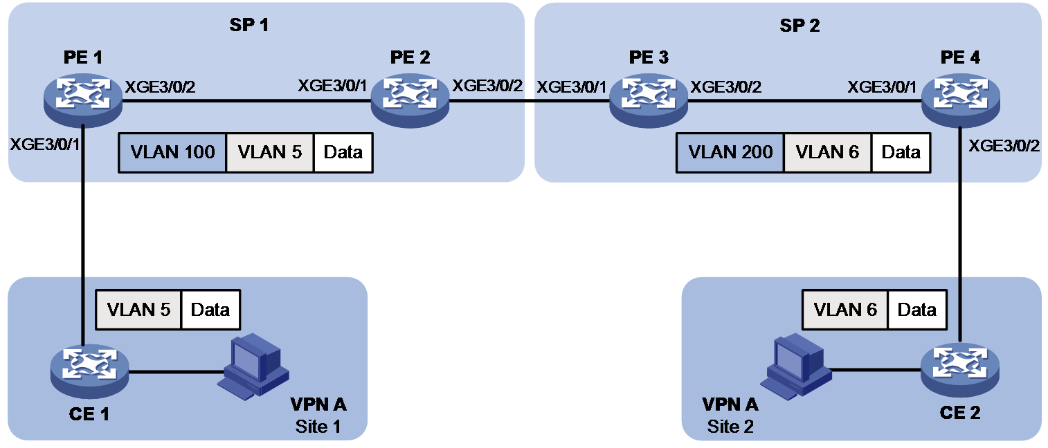

One-to-two and two-to-two VLAN mapping
One-to-two and two-to-two VLAN mapping are typically used to implement communication across different SP networks, as shown in Figure 2.
Figure 2 Application scenario of one-to-two and two-to-two VLAN mapping
As shown in Figure 2, Site 1 and Site 2 of VPN A are in VLAN 2 and VLAN 3, respectively. The SP 1 network assigns SVLAN 10 to Site 1. The SP 2 network assigns SVLAN 20 to Site 2. When the packet from Site 1 arrives at PE 1, PE 1 tags the packet with SVLAN 10 by using one-to-two VLAN mapping.
When the double-tagged packet from the SP 1 network arrives at the SP 2 network interface, PE 3 processes the packet as follows:
·     Replaces SVLAN tag 10 with SVLAN tag 20.
·     Replaces CVLAN tag 2 with CVLAN tag 3.
One-to-two VLAN mapping provides the following benefits:
·     Enables a customer network to plan its CVLAN assignment without conflicting with SVLANs.
·     Adds a VLAN tag to a tagged packet and expands the number of available VLANs to 4094 × 4094.
·     Reduces the stress on the SVLAN resources, which were 4094 VLANs in the SP network before the mapping process was initiated.

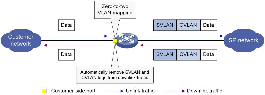

Zero-to-two VLAN mapping
The application scenario of zero-to-two VLAN mapping is similar to the scenario of one-to-two VLAN mapping. Zero-to-two VLAN mapping is used on the customer-side port of a PE to add double tags to untagged packets.
As shown in Figure 8, zero-to-two VLAN mapping is implemented on the customer-side port to add double tags to untagged uplink traffic. For zero-to-two VLAN mapping to take effect, the port PVID must be VLAN 1.
For correct downlink traffic transmission, the downlink traffic must be double-tagged. Then, the customer-side port removes both SVLAN and CVLAN tags from the traffic.
Use one of the following methods to ensure that the downlink traffic contains double tags on the customer-side port:
·     Configure the port as a trunk port and assign it to the SVLAN, which must be different from the port PVID (VLAN 1).
·     Configure the port as a hybrid port and assign it to the SVLAN as a tagged member.
Figure 8 Zero-to-two VLAN mapping implementation

·     Configuring one-to-two VLAN mapping
Configure one-to-two VLAN mapping on PE 1 and PE 4, as shown in Figure 2, through which traffic from customer networks enters the service provider networks.
·     Configuring zero-to-two VLAN mapping
Configure zero-to-two VLAN mapping on PE 1 and PE 4, as shown in Figure 2, through which traffic from customer networks enters the service provider networks.
·     Configuring two-to-two VLAN mapping
Configure two-to-two VLAN mapping on PE 3, as shown in Figure 2, which is an edge device of the SP 2 network.
As a best practice, set the MTU to a minimum of 1504 bytes for ports on the forwarding path of the double-tagged packet in the service provider network.

Example: Configuring one-to-one VLAN mapping
As shown in Figure 10:
·     Each household subscribes to PC, VoD, and VoIP services.
·     On the home gateways, VLANs 1, 2, and 3 are assigned to PC, VoD, and VoIP traffic, respectively.
To isolate traffic of the same service type from different households, configure one-to-one VLAN mappings on the wiring-closet switches. This feature assigns one VLAN to each type of traffic from each household.
Figure 10 Network diagram

Example: Configuring one-to-two and two-to-two VLAN mapping
As shown in Figure 11:
·     Two VPN A branches, Site 1 and Site 2, are in VLAN 5 and VLAN 6, respectively.
·     The two sites use different VPN access services from different service providers, SP 1 and SP 2.
·     SP 1 assigns VLAN 100 to Site 1 and Site 2. SP 2 assigns VLAN 200 to Site 1 and Site 2.
Configure one-to-two VLAN mappings and two-to-two VLAN mappings to enable the two branches to communicate across networks SP 1 and SP 2.
Figure 11 Network diagram
1.     Configure PE 1:
# Create VLANs 5 and 100.
<PE1> system-view
[PE1] vlan 5
[PE1-vlan5] quit
[PE1] vlan 100
[PE1-vlan100] quit
# Configure a one-to-two VLAN mapping on the customer-side port (Ten-GigabitEthernet 3/0/1) to add SVLAN tag 100 to packets from VLAN 5.
[PE1] interface ten-gigabitethernet 3/0/1
[PE1-Ten-GigabitEthernet3/0/1] vlan mapping nest single 5 nested-vlan 100
# Configure Ten-GigabitEthernet 3/0/1 as a hybrid port.
[PE1-Ten-GigabitEthernet3/0/1] port link-type hybrid
# Assign Ten-GigabitEthernet 3/0/1 to VLAN 100 as an untagged member.
[PE1-Ten-GigabitEthernet3/0/1] port hybrid vlan 100 untagged
[PE1-Ten-GigabitEthernet3/0/1] quit
# Configure the network-side port (Ten-GigabitEthernet 3/0/2) as a trunk port.
[PE1] interface ten-gigabitethernet 3/0/2
[PE1-Ten-GigabitEthernet3/0/2] port link-type trunk
# Assign Ten-GigabitEthernet 3/0/2 to VLAN 100.
[PE1-Ten-GigabitEthernet3/0/2] port trunk permit vlan 100
[PE1-Ten-GigabitEthernet3/0/2] quit
2.     Configure PE 2:
# Create VLAN 100.
<PE2> system-view
[PE2] vlan 100
[PE2-vlan100] quit
# Configure Ten-GigabitEthernet 3/0/1 as a trunk port.
[PE2] interface ten-gigabitethernet 3/0/1
[PE2-Ten-GigabitEthernet3/0/1] port link-type trunk
# Assign Ten-GigabitEthernet 3/0/1 to VLAN 100.
[PE2-Ten-GigabitEthernet3/0/1] port trunk permit vlan 100
[PE2-Ten-GigabitEthernet3/0/1] quit
# Configure Ten-GigabitEthernet 3/0/2 as a trunk port.
[PE2] interface ten-gigabitethernet 3/0/2
[PE2-Ten-GigabitEthernet3/0/2] port link-type trunk
[PE2-Ten-GigabitEthernet3/0/2] port trunk permit vlan 100
[PE2-Ten-GigabitEthernet3/0/2] quit
3.     Configure PE 3:
# Create VLANs 5, 6, 100, and 200.
<PE3> system-view
[PE3] vlan 5 to 6
[PE3] vlan 100
[PE3-vlan100] quit
[PE3] vlan 200
[PE3-vlan200] quit
[PE3] interface ten-gigabitethernet 3/0/1
[PE3-Ten-GigabitEthernet3/0/1] port link-type trunk
# Assign Ten-GigabitEthernet 3/0/1 to VLANs 100 and 200.
[PE3-Ten-GigabitEthernet3/0/1] port trunk permit vlan 100 200
# Configure a two-to-two VLAN mapping on Ten-GigabitEthernet 3/0/1 to map SVLAN 100 and CVLAN 5 to SVLAN 200 and CVLAN 6.
[PE3-Ten-GigabitEthernet3/0/1] vlan mapping tunnel 100 5 translated-vlan 200 6
[PE3-Ten-GigabitEthernet3/0/1] quit
[PE3] interface ten-gigabitethernet 3/0/2
[PE3-Ten-GigabitEthernet3/0/2] port link-type trunk
# Assign Ten-GigabitEthernet 3/0/2 to VLAN 200.
[PE3-Ten-GigabitEthernet3/0/2] port trunk permit vlan 200
[PE3-Ten-GigabitEthernet3/0/2] quit
4.     Configure PE 4:
# Create VLANs 6 and 200.
<PE4> system-view
[PE4] vlan 6
[PE4-vlan6] quit
[PE4] vlan 200
[PE4-vlan200] quit
# Configure the network-side port (Ten-GigabitEthernet 3/0/1) as a trunk port.
[PE4] interface ten-gigabitethernet 3/0/1
[PE4-Ten-GigabitEthernet3/0/1] port link-type trunk
# Assign Ten-GigabitEthernet 3/0/1 to VLAN 200.
[PE4-Ten-GigabitEthernet3/0/1] port trunk permit vlan 200
[PE4-Ten-GigabitEthernet3/0/1] quit
# Configure the customer-side port (Ten-GigabitEthernet 3/0/2) as a hybrid port.
[PE4] interface ten-gigabitethernet 3/0/2
# Assign Ten-GigabitEthernet 3/0/2 to VLAN 200 as an untagged member.
[PE4-Ten-GigabitEthernet3/0/2] port link-type hybrid
[PE4-Ten-GigabitEthernet3/0/2] port hybrid vlan 200 untagged
# Configure a one-to-two VLAN mapping on Ten-GigabitEthernet 3/0/2 to add SVLAN tag 200 to packets from VLAN 6.
[PE4-Ten-GigabitEthernet3/0/2] vlan mapping nest single 6 nested-vlan 200
[PE4-Ten-GigabitEthernet3/0/2] quit
# Verify VLAN mapping information on PE 1.
[PE1] display vlan mapping
Interface Ten-GigabitEthernet3/0/1:
  Outer VLAN    Inner VLAN    Translated Outer VLAN    Translated Inner VLAN
  5             N/A           100                      5
# Verify VLAN mapping information on PE 3.
[PE3] display vlan mapping
  100           5             200                      6
# Verify VLAN mapping information on PE 4.
[PE4] display vlan mapping
Interface Ten-GigabitEthernet3/0/2:
  6             N/A           200                      6
