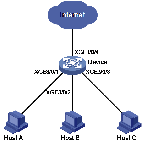

As shown in Figure 1:
·     LAN users Host A, Host B, and Host C are connected to Ten-GigabitEthernet 3/0/1, Ten-GigabitEthernet 3/0/2, and Ten-GigabitEthernet 3/0/3 on the device, respectively.
·     The device connects to the Internet through Ten-GigabitEthernet 3/0/4.
Configure the device to provide Internet access for the hosts, and isolate them from one another at Layer 2.
Figure 1 Network diagram

The output shows that Ten-GigabitEthernet 3/0/1, Ten-GigabitEthernet 3/0/2, and Ten-GigabitEthernet 3/0/3 are assigned to isolation group 2. As a result, Host A, Host B, and Host C are isolated from one another at layer 2.
